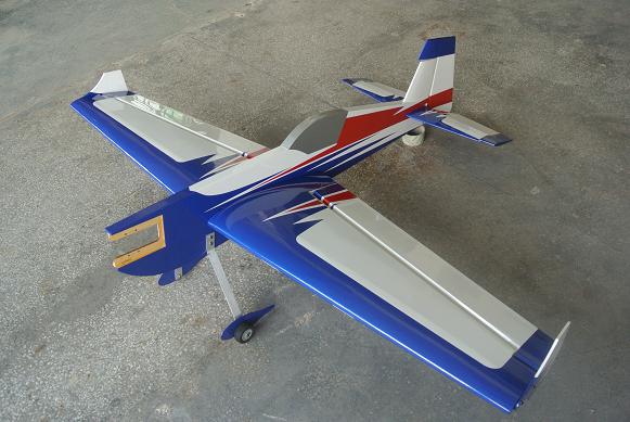

This is the all new 65" Extra 330 profile, a great additional to our popular 20cc profile lineup. They will arrive by the end of July.
This new model will incorporate the same new features we have on all the newer versions such as reinforced motor mount area and optional SFG.
Here are the specs:
Wing span:65in
Length: 61.7in
Wing area:1113 sq.in
AUW: 7-7.5Lbs
More info about these Extra 330 will be coming so stay tuned.

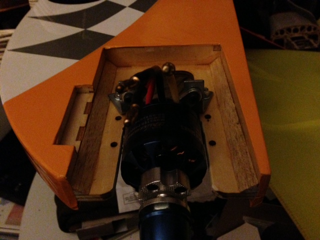

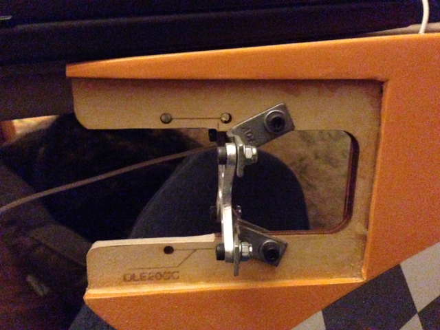

I'm planning to run mine on electric. I should have it for this weekend, so I'll be able to assess what it will take.

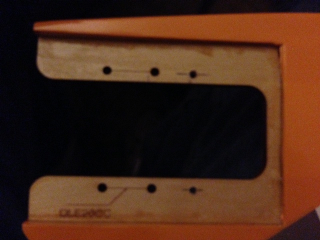

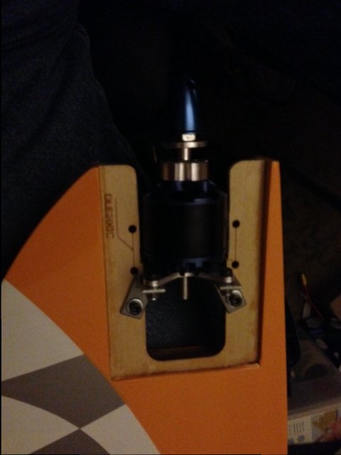

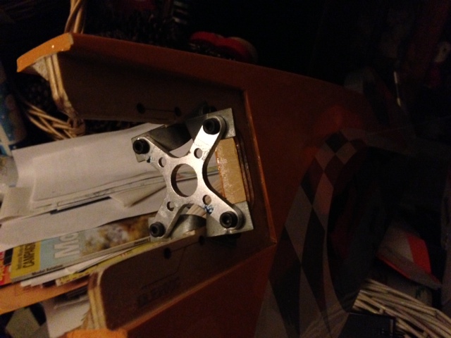

Here's my conversion to electric so far. Sorry about the quality of the pics... they were taken in the living room that is loaded with stuff as we rearrange, but I was able to do some work anyway.
I used some standard corner brackets that I put a twist into. I drilled a third hole in the mounting area and bolted the brackets together through that hole and then bolted them to the X bracket that came with the motor. The motor I chose was on my shelf; an Exceed Monster Power Series, 670 kv. Not sure yet whether I'll run this on 5S or 6S, it depends on how the CG works out and what kind of power I get from the two options.
At least the plane is started!
