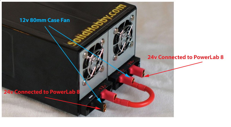

I'm currently building a portable charging station and will be using 2 Power24+ supplies to power 2 PowerLab 8 chargers. I'm stuffing all that into a Pelican Storm 23 and would like to add an intake and exhaust fan in the case for cooling, however I'm not electrician. I've included an image of how I "think" I would wire this up so I could utilize the 24v for my charger but also run the fans off 12v at the same time. I was also wonder if it would be ok to splice into the main cord running into the switch and connect it to an AC case adapter like the one you see here. http://www.progressiverc.com/ac-adap...ine-cases.html I would use this adapter to connect the two. http://www.progressiverc.com/power-s...ine-cases.html Any suggestions and input would be greatly appreciated.

I've done something similar with 24v server power supplies. Personally I use the positive and negative terminals on the first PSU (12v psu) but your way will likely work as well. Just use a cheap volt meter on the inputs to make sure you are actually getting 12v before connecting the fans or you will burn them up. The power draw from the fans should be very minimal (assuming you aren't running a box fan) and won't hurt the operation of the PSU.
The ProgressiveRC folks have a lot of experience building these types of cases and their accessories are top notch. Just make sure if you get a switched outlet that you get one that supports at least 15A, 20A is better. I purchased this one http://www.digikey.com/product-search/en?lang=en&site=us&KeyWords=CCM1916-ND&x=0&y=0
