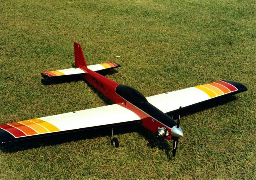

Fellow member @Whiskey Joe asked me where he might find replacement rings for a Rossi .60 that is in an airplane he acquired.

Lol we will see. I think I will end up having to get a regular muffler for it though. The plane I feel is just to pretty to have the big ass pipe running down the side of the fuse.
HRRC Flyer
:eek:. . . . I beg to differ. . . . . LOL. Putting a stock muffler on a Rossi is like putting stock exhaust system on a 429 Cobrajet. Test something when you get the engine and see how you like it. This is a trick the old pattern flyers used. When you are looking at the front of the plane, rotate the engine mount on the firewall so the cylinder is at approximately 8 o'clock. The header will then exit the bottom of the cowl and the pipe can run right down the centerline of the fuse. You will have to play with the angle depending on which header you use. An added benefit is the weight of the pipe will not affect the lateral balance of the plane. If you must use a muffler, consider getting something like a Jett performance muffler for your Rossi. It will thank you for it.
