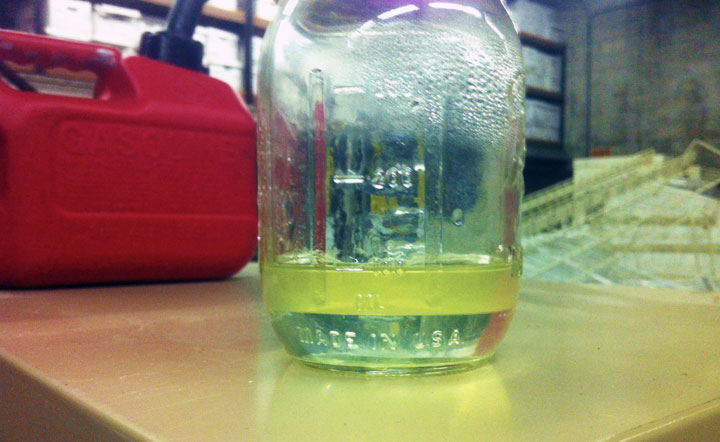

It's easy you add water to fuel and wait till the ethanol separates than drain off the water, the water will attach to the ethanol and sink to the bottom.
