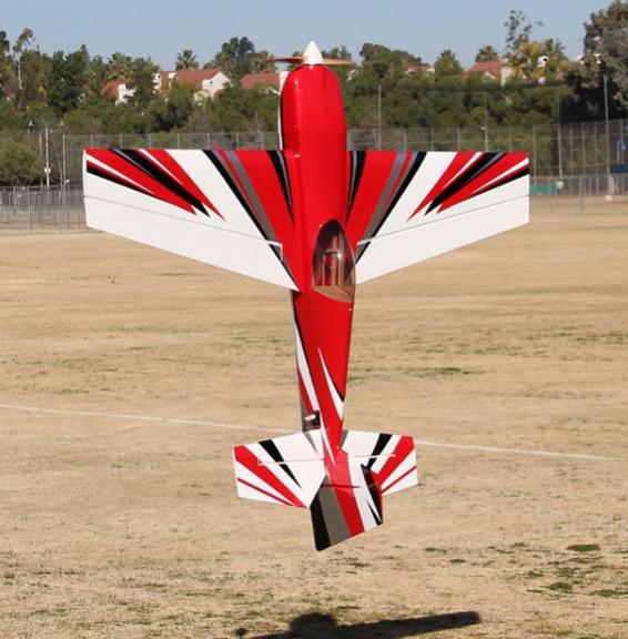

A hover is performed by putting the plane at exactly 90 degrees angle of attack so that the nose points straight up. Just enough throttle is applied to keep the plane at a steady altitude. Good pilots will make the maneuver look easy, but since fixed-wing airframes are inherently unstable in a hover, constant adjustments on aileron, rudder, elevator and throttle are needed.
