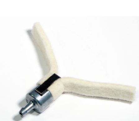

Still curious on how this would perform?
http://www.ebay.com/itm/221871291297?_trksid=p2060353.m1438.l2649&ssPageName=STRK:MEBIDX:IT

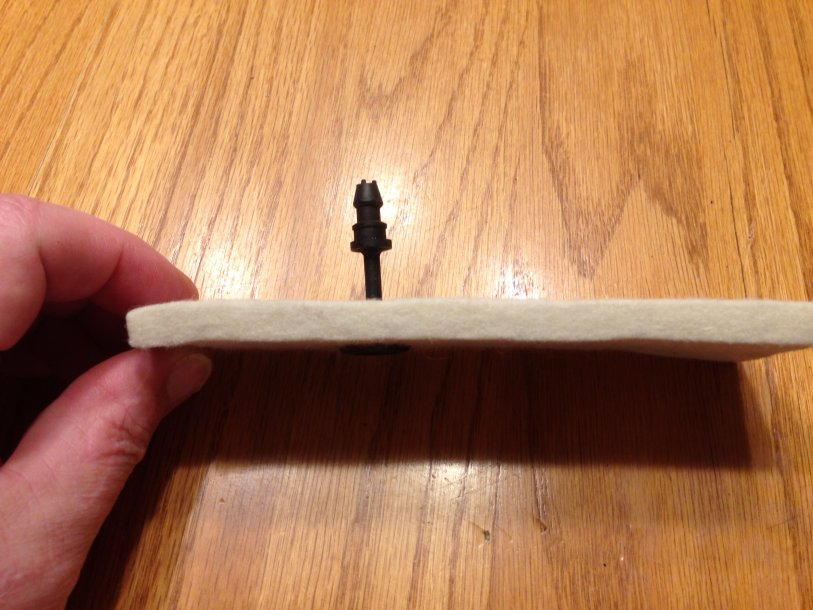

While I don't have that specific clunk/felt I did pick up something very similar that used to be standard in chain saw gas tanks (see pics).......pretty much works on the same principle.
I tested the old school felt pickup pad out in a similar fashion to Taz and unfortunately what will happen is that if/when any portion of the felt is not immersed in fluid (ie gasoline) it will start 'pulling air' in along with gas......how it impacts a running gas engine I cannot say.
In the end the solution would have to be something like the Holley Hydramat, specifically designed to suck up every last drop of gasoline as long as the Hydramat is in contact with it!
