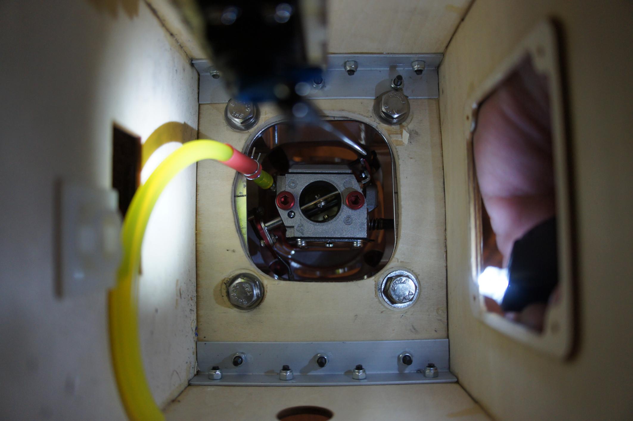

Yes, it looks a little different right now (old pic). But the hole is the same size.
Av8r RC
I haven't gotten to the plumbing or wires yet. But last night I took the covers off the carb. The screen looked pretty good only two little specs of something in there, nothing that would cause it not to get enough fuel.
