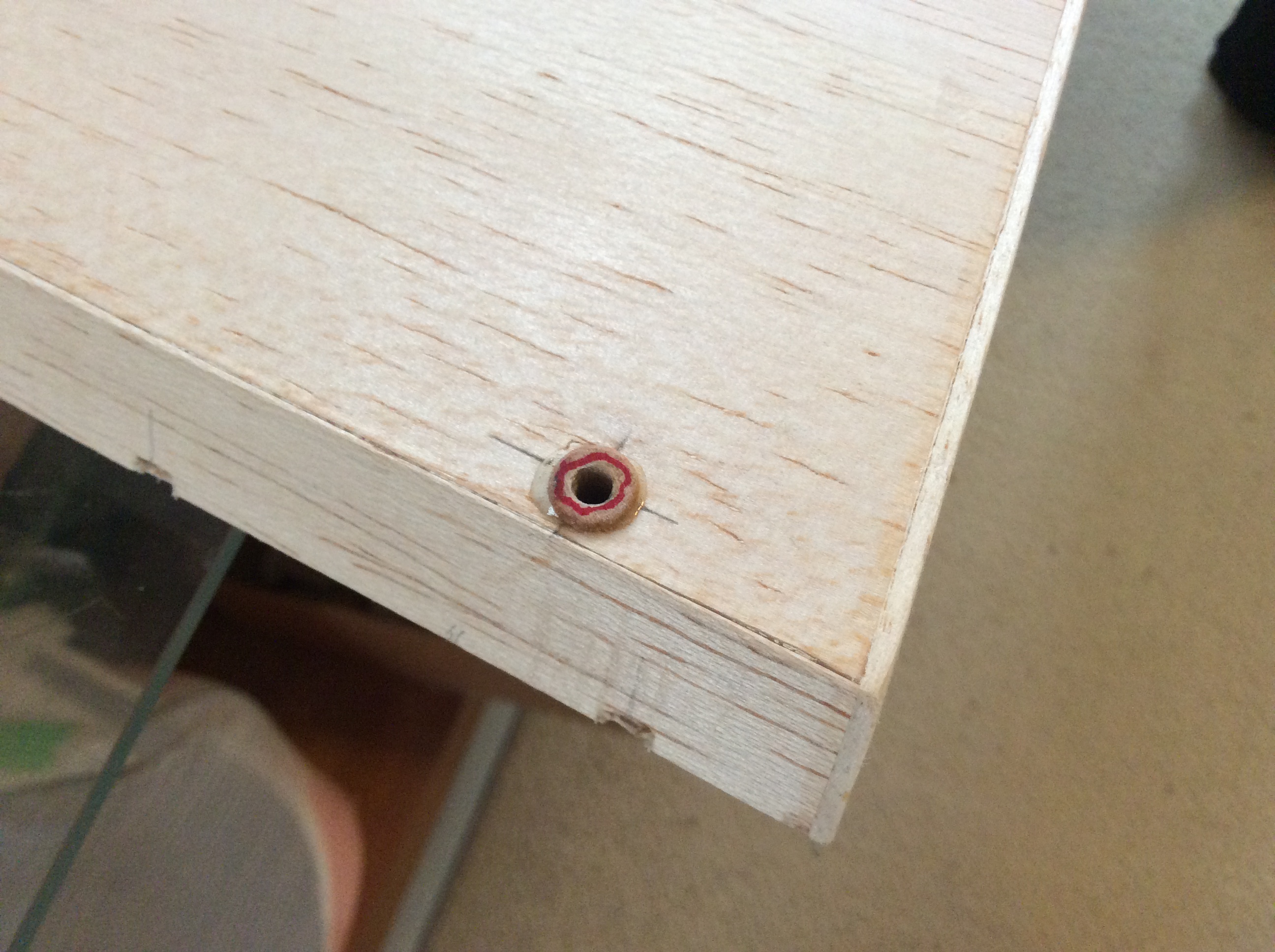

Well changed direction decided to go with a 3/8 hardwood bushing that is threaded all the way through the rudder and with 8-32 threaded rod and then the standard HD connections. From the picture just have wait for the polyurethaning Gorilla glue cure and then sand it all smooth and then it will be done.
