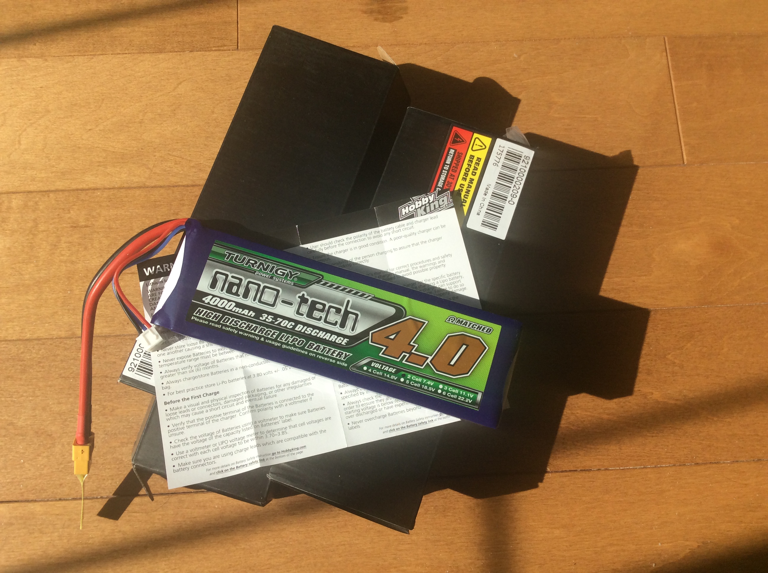

Ok got them at last you will not believe how long it took and the hassle-and cost I had with FedX. Hopefully I never have to deal with them again. So that will be two 4000mAh for the radio system. One thing I will never do again is to use a so called RX battery for my radio in the plane, bad idea.

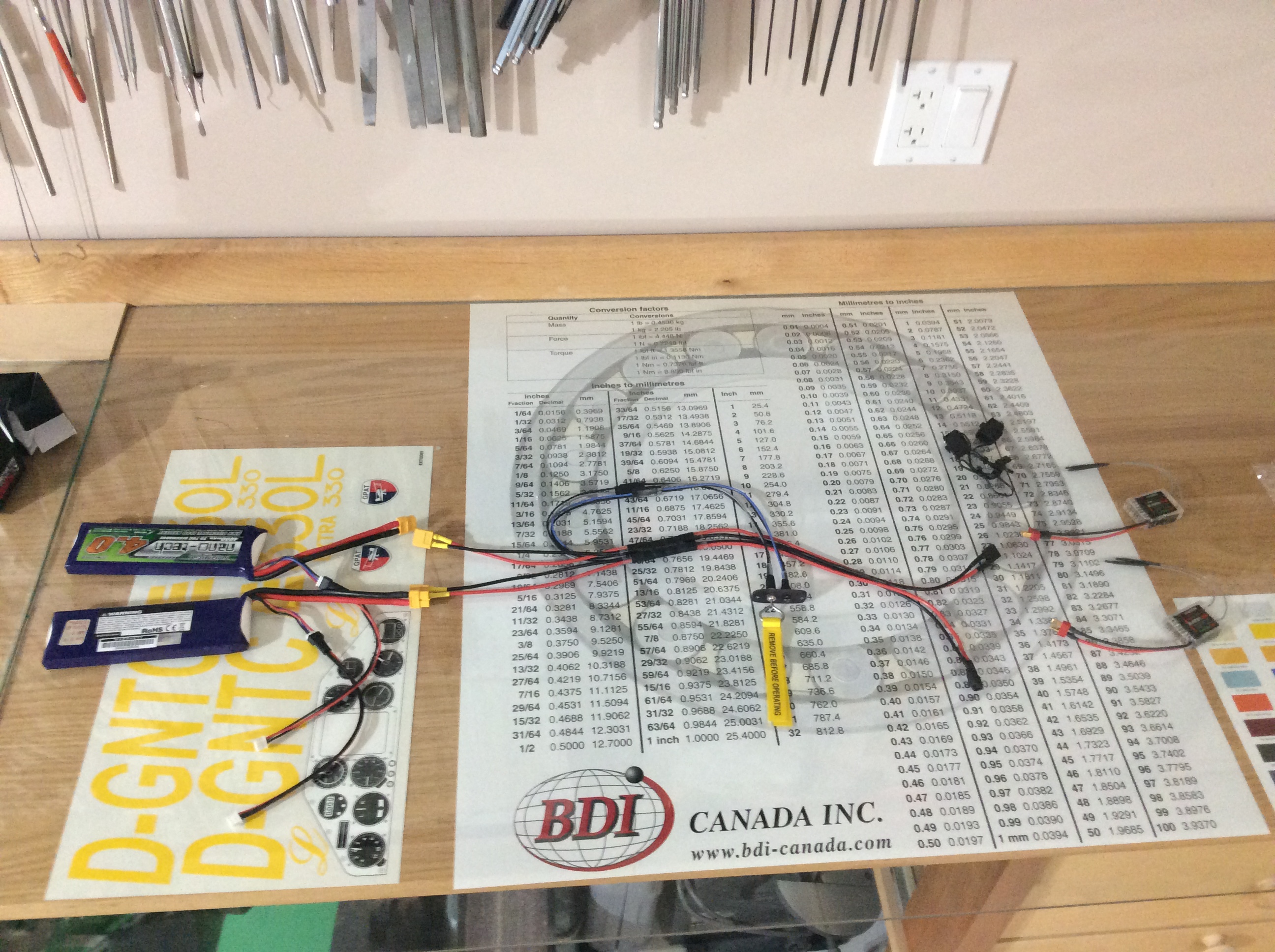

Now that I have the batteries I have laid out how it is going fit into plane and the distances for wire length and also which plugs at what location.
Decided to go with a battery fail safe switch and pin switch. This little device has fail safely switch and will isolate a bad battery if needed and or use the battery with the heist voltage. Just one step closer to done.

Ok got them at last you will not believe how long it took and the hassle-and cost I had with FedX. Hopefully I never have to deal with them again. So that will be two 4000mAh for the radio system. One thing I will never do again is to use a so called RX battery for my radio, bad idea.

Was this due to import/export with Canada or some restriction with FedEx? Curious minds want to know...
Actually both for some reason FedX decided that it was hazardous material on its way to me at one of their sorting stations and had to drive 100 miles to pick up my batteries. So after lot Emails to the top brass they were told to ship it to me. But then they attached every import tax to the batteries they could. Which I am going fight and we will see what happens.
WMcNabb
Wow! Really unbelievable. Best of luck with the fight!
