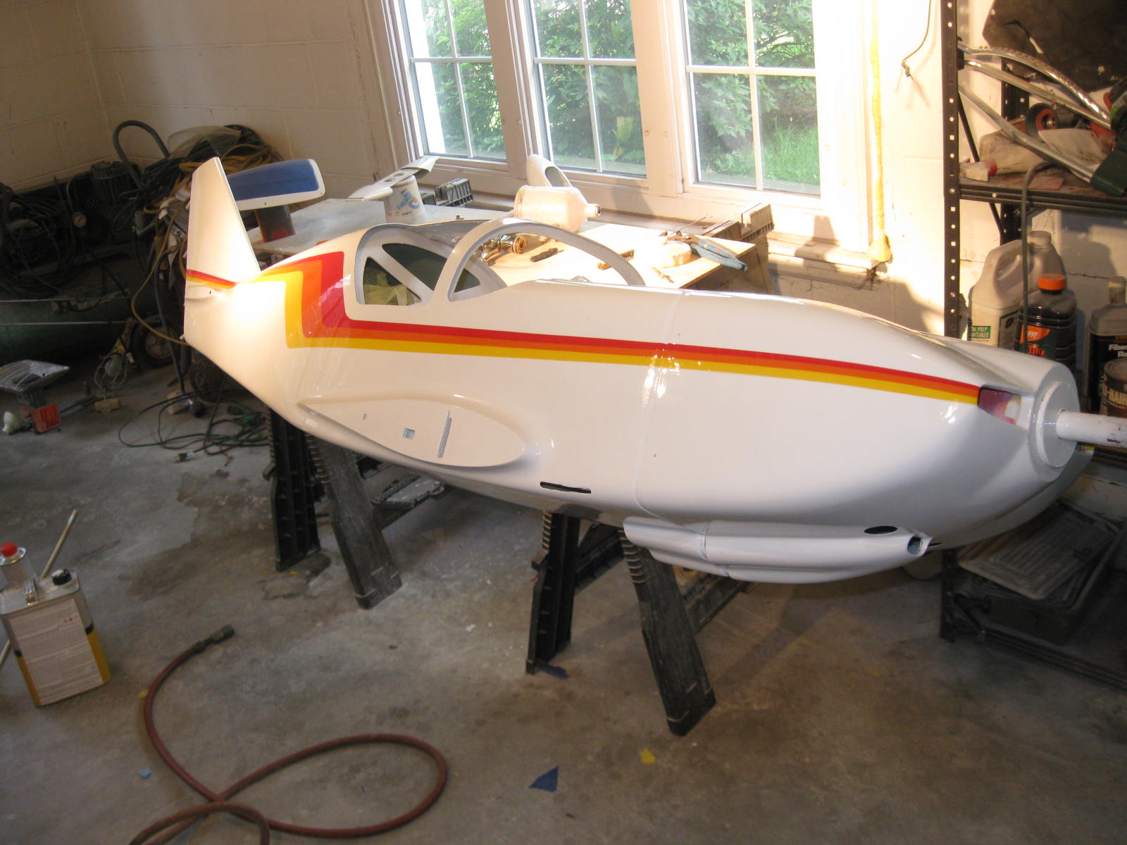

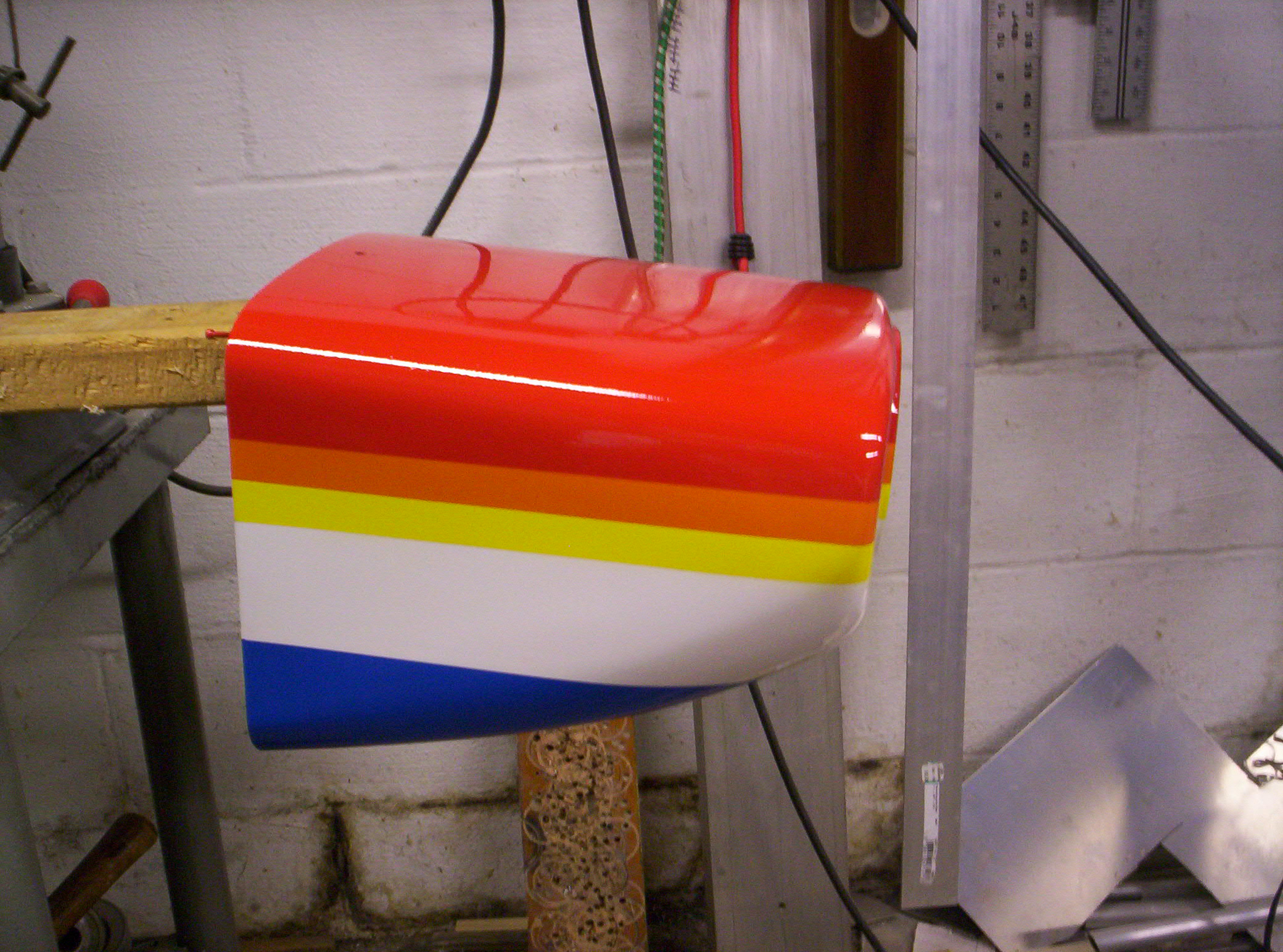

  6. Where I'm going with this is do yourself a favor and take a wing to the auto body supply store and have them color match a base coat clear coat paint. I use Omni brand, it is PPG lower cost brand, works great a RC airplane, a pint might be $30-$40 bucks for the base color. Attached are two photos one painted in 2005 the second from 2019 from the same can of yellow and orange. Could do another paint job from what is left. The initial outlay may seem high but if you use the same colors, the cost will be spread over several airplanes. These colors were Monokote colors. It hurt a little in 2005 when I had to but 5 base colors but that was an exception.
    2005
    2019

    Ok you convince me going to look for a body shop and see what I can find thanks for help and advice.
