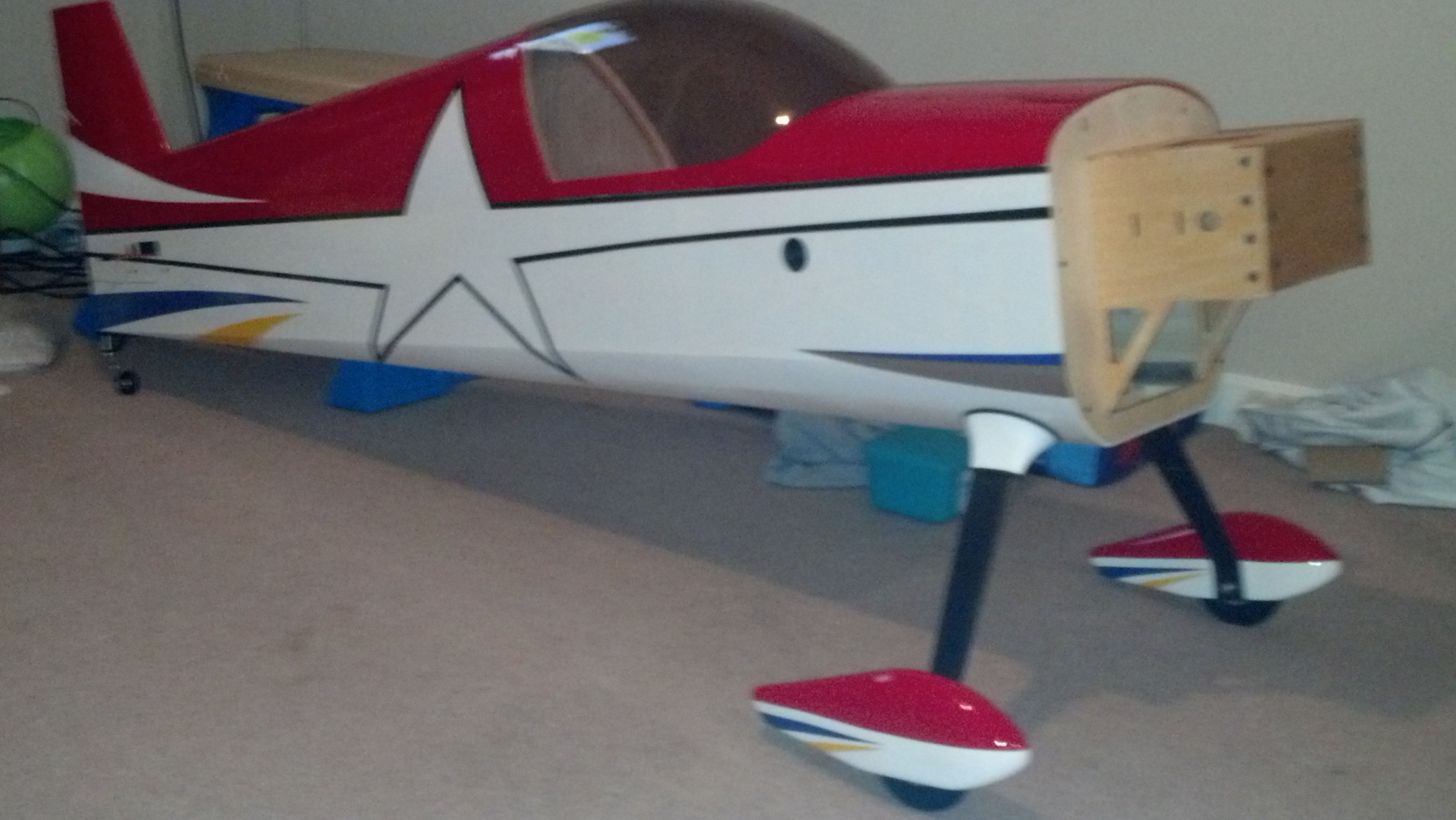

Just thought I would share some information on my rudder servo. I went with a single BLS157HV for the rudder and after 20 flights I can say with confidence that I'm getting blow back with one servo. I was really trying to get away just having one but no luck. I do have the DA 120 as the power plant so it Looks like I'm going with a two servo setup on the rudder. Think I'm going with two more Savox 2270's to match the rest of the plane and just sell the BLS157.

Build so far
