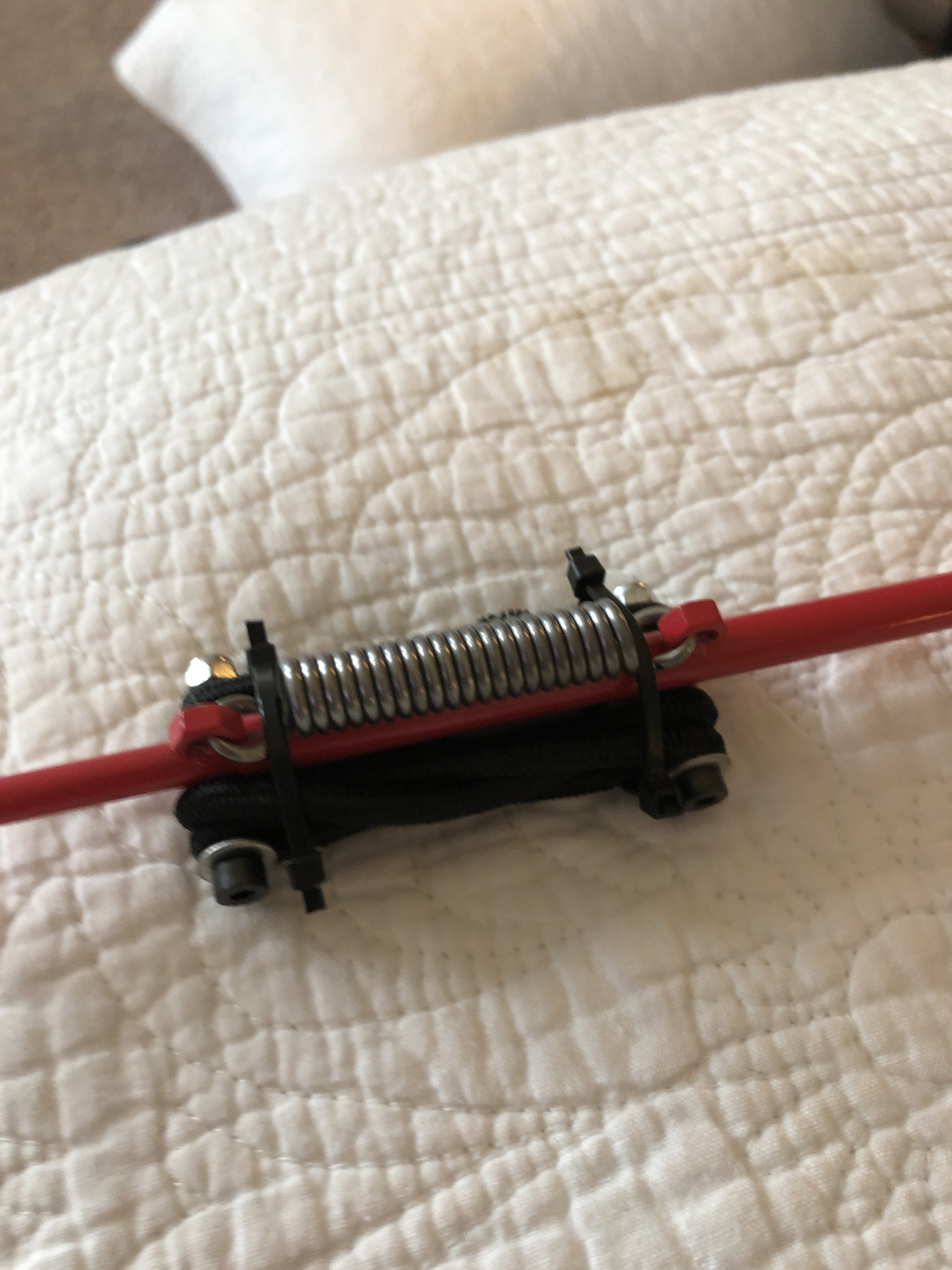

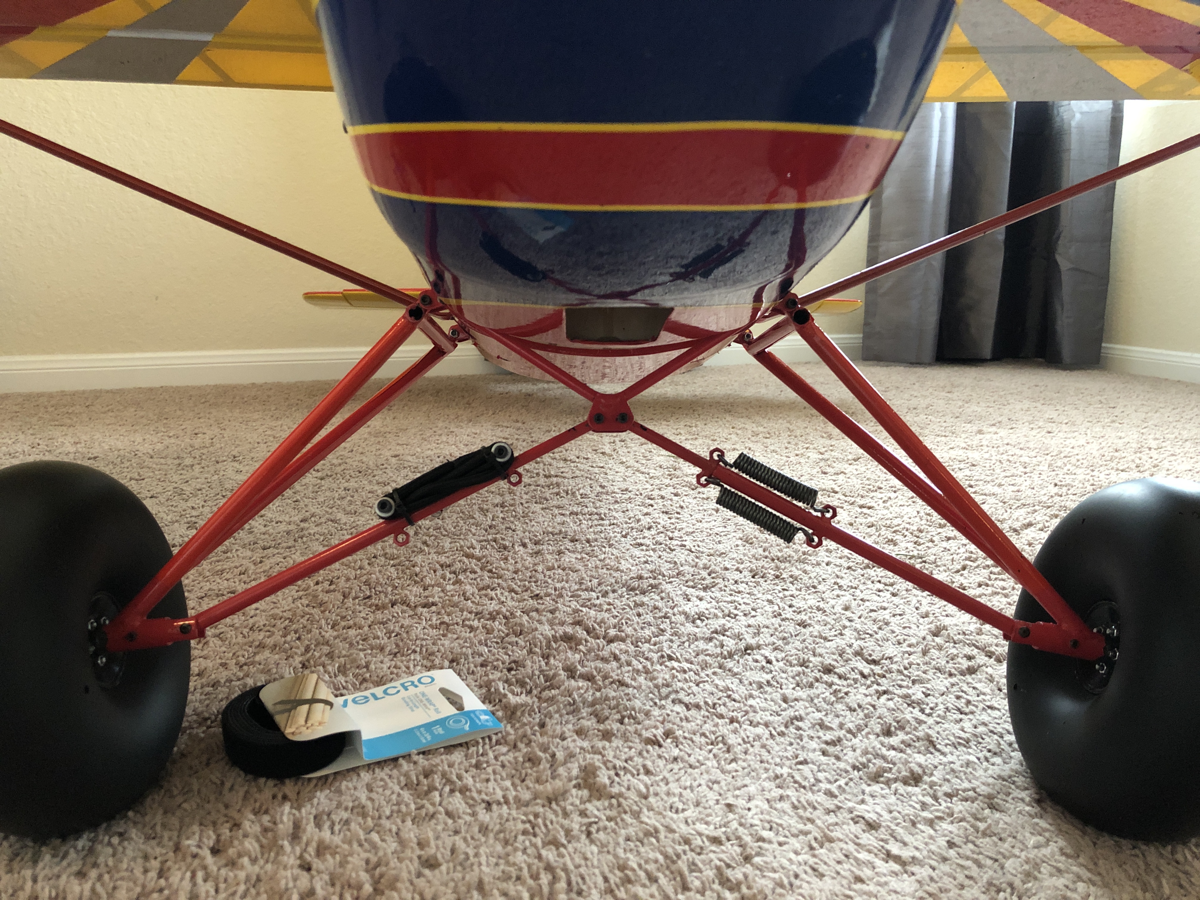

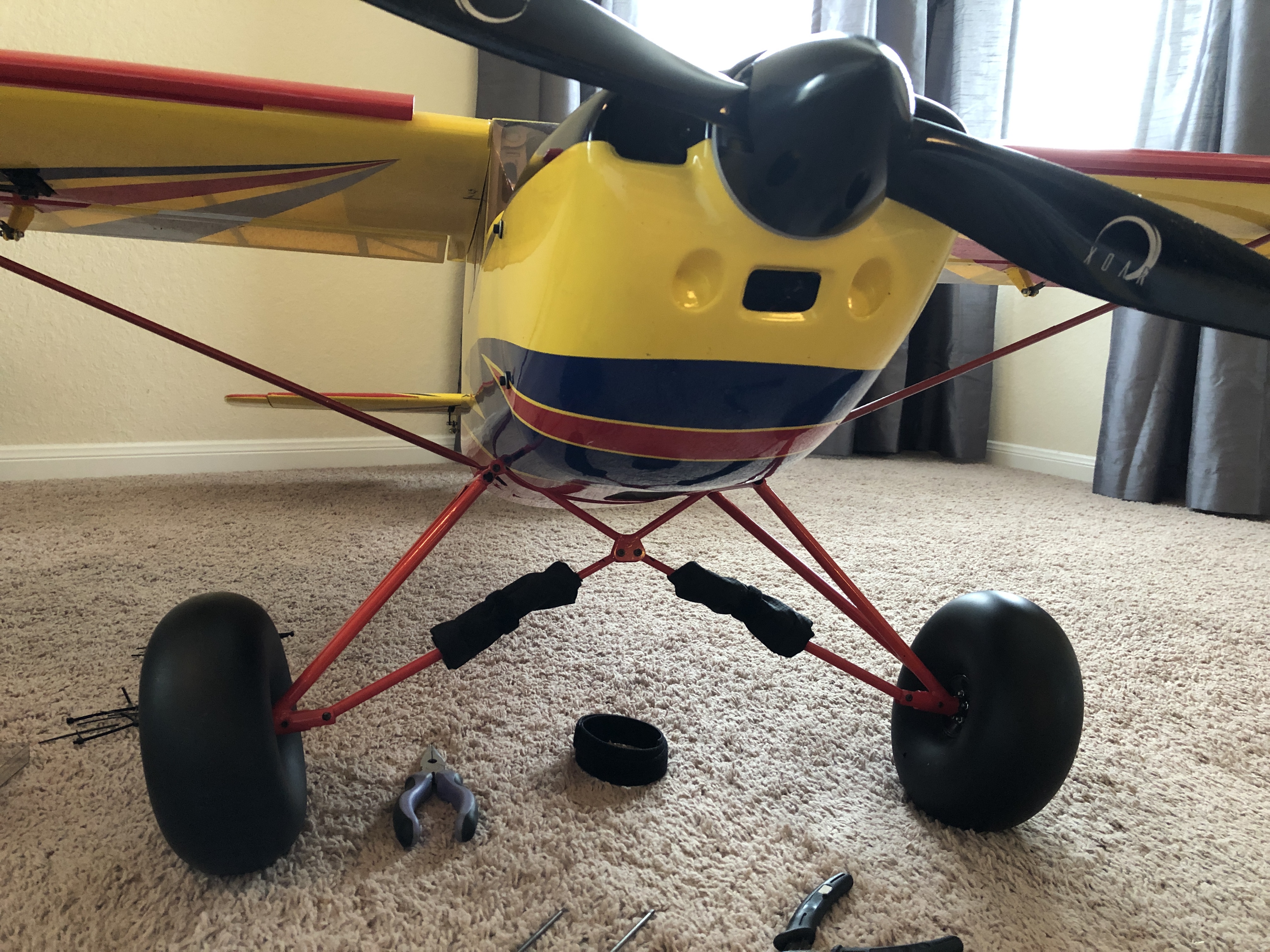

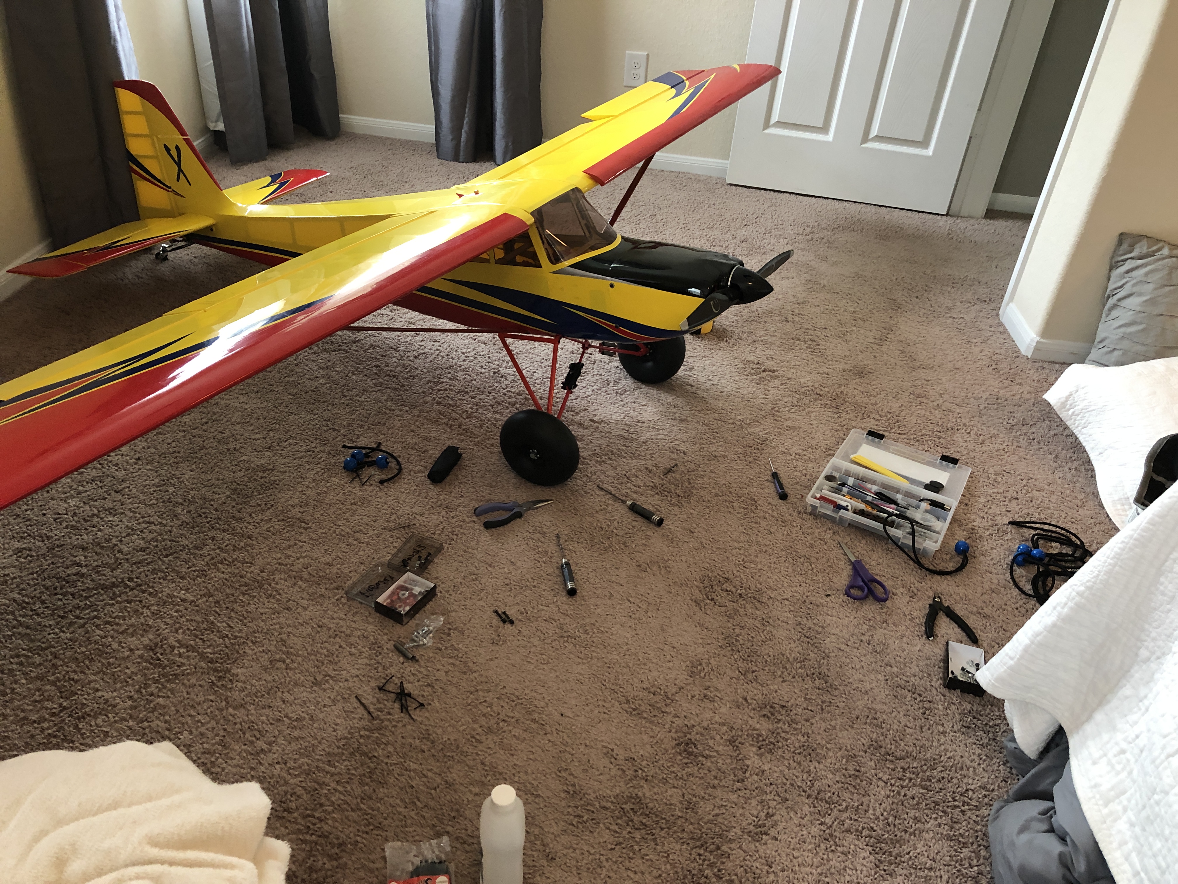

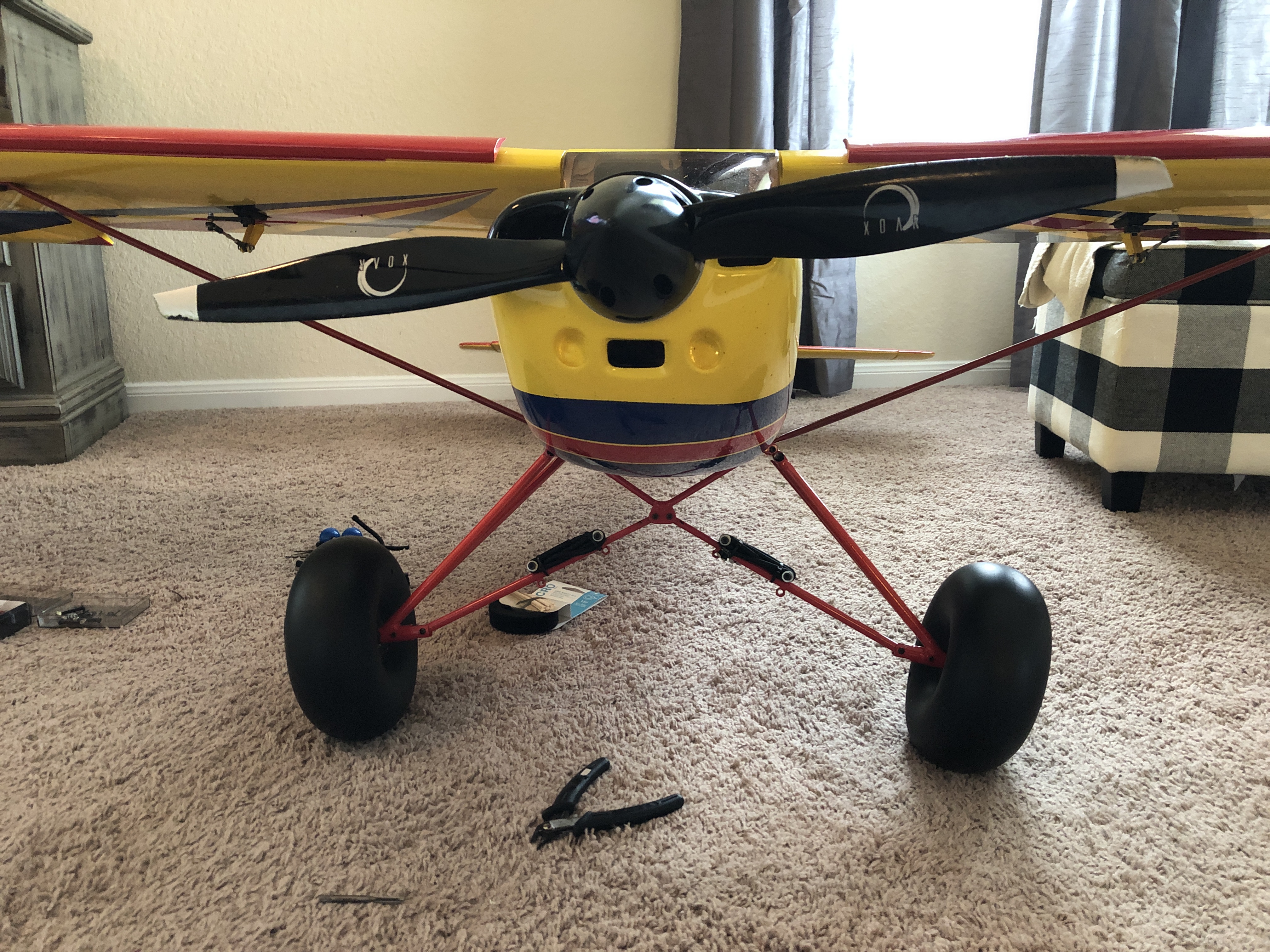

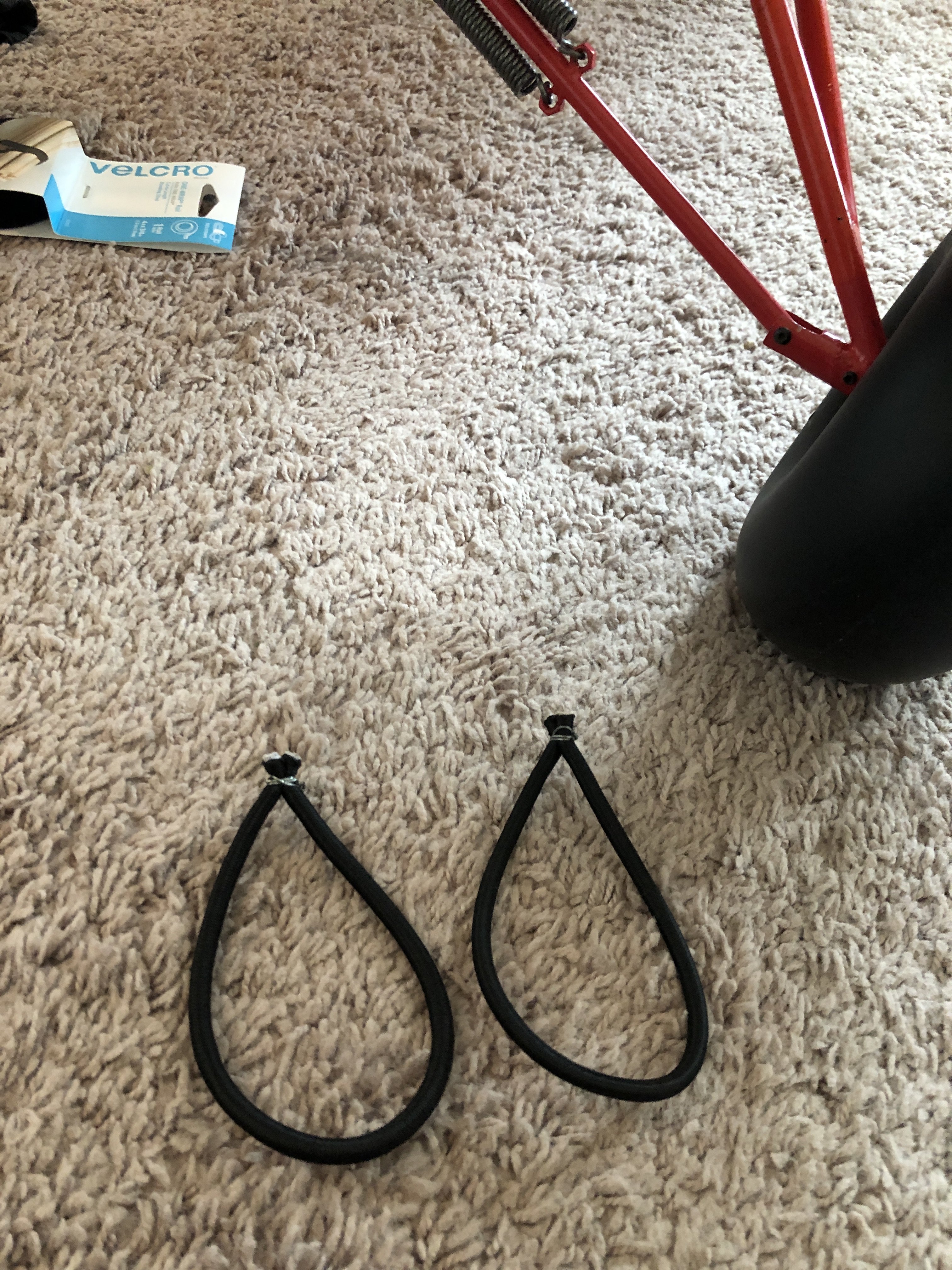

I wanted to share with you guys my success today modifying the Xcub gear. I absolutely hated these gear when I first got them! They are WAY to stiff and unforgiving when left stock. So after chopping and drilling the lower tubes yesterday to make the gear sit up a little taller, I tried the bungee cord mod today. I couldn't find the 3mm bungees, so I opted to use some 5mm bungees from Ace. I ended up using 4mm X 30MM bolts. I tried numerous configurations to see which one would give me the best absorption and rebound while also keeping firm enough to hold the plane up under it's weight. First I tried bungees mixed with the original metal spring (that was still too stiff). I did one arm at a time and NUMEROUS taxi tests. I finally landed (pardon the pun) on using bungees on only one side of the strut, wrapped twice. In this configuration it still allows for the gear to stay completely extended while parked or taxiing, but flex VERY easily under normal load and rough terrain. Now it is MUCH more like full scale gear, absorbing all the bumps and nasty stuff, while not causing the plane to bounce around or back in to the air on a fast and hard landing. I probably tore the gear apart 6 times today while doing this mod, but it was TOTALLY worth it. Now I absolutely LOVE these gear and they are exactly how I wanted them to be from the start. I was even able to use the original shock boots to cover the bungees to keep with the scale look. Check out the build pics and let me know what you guys think. I am waiting for the wind to die down, so that I can go officially put her in the air and do some crazy STOL drop in landings!

Hi, do you remember hom long you have chopped down the lower tubes?

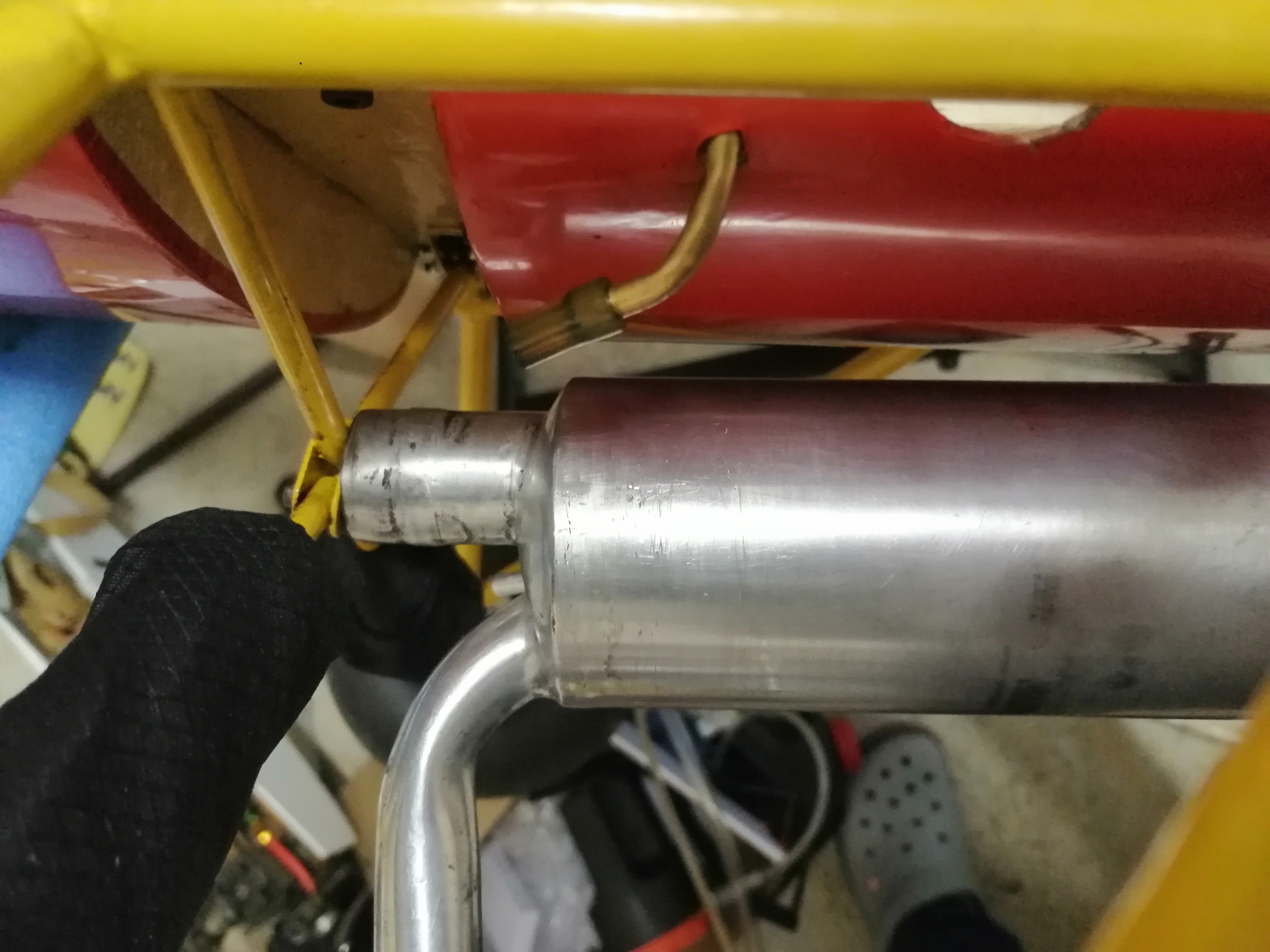

I'll do the same upgrade on mine for ground clearance as i will have a canister under the fuse .
Thanks for your reply.
Laurent

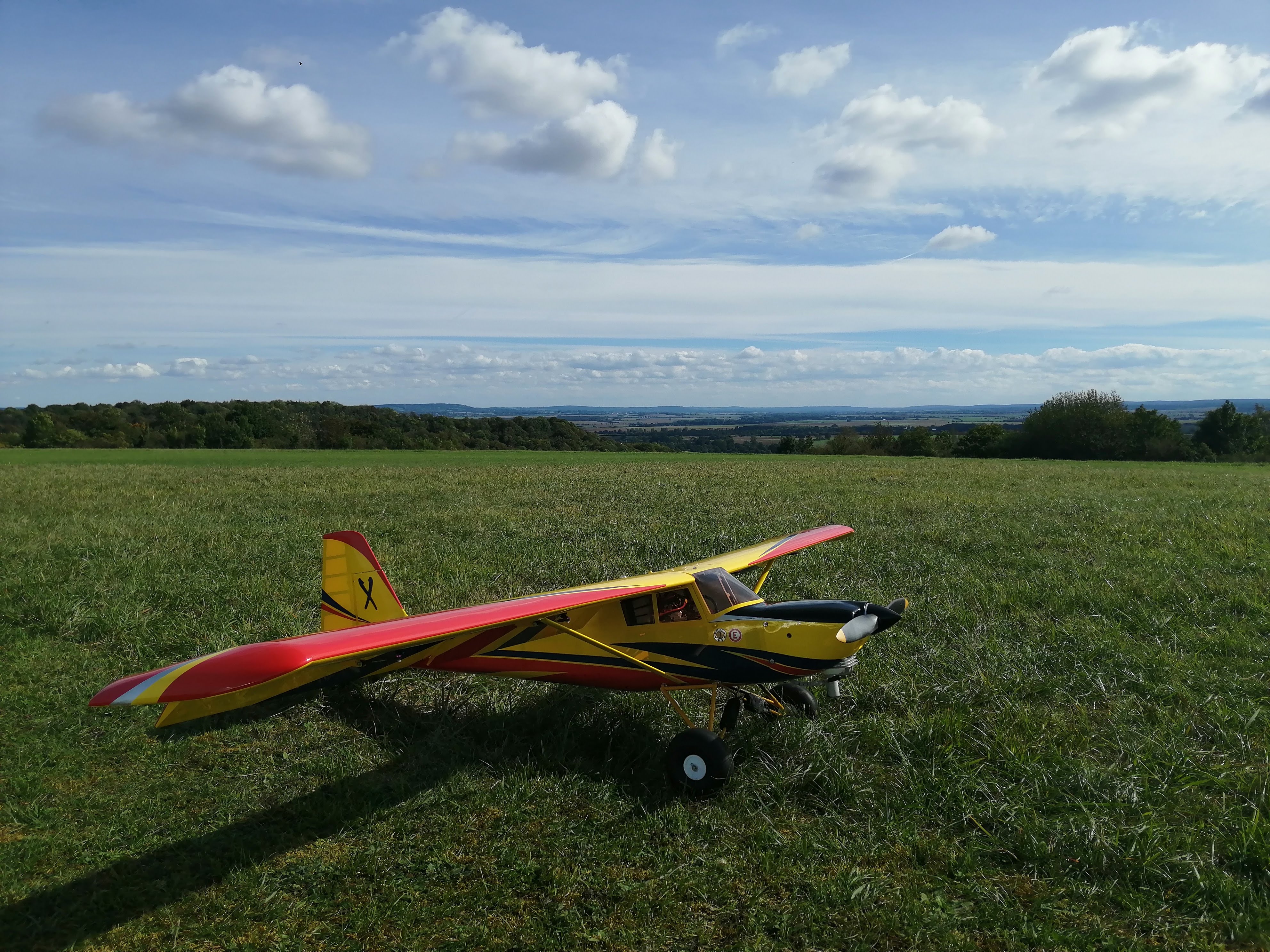

My Timber at my local field for it's first appearance.
Laurent
Welcome to GSN Laurent!!
Think it's about 6-8mm. Basically, just enough for another hole with the same edge clearance.
Having a quite motor will be nice, my DLE55RA is pretty noisy.
There are no cowls available anymore. I contacted Horizon about a month ago asking for any molds or CAD files to re-create some cowls and the answer was basically the sourced factory vacated and everything was lost. To me that doesn't make a lot of sense, but it is what it is. I've contemplated making some cowlings for fun, but it's a lot of time and expenses to make a batch with the possibility of ruining my cowl in the process...

I will have to find another solution to modifiy the landing gear for the canister.
The entry tube of the canister is just in front of the fixed part holding the tubes with the springs.

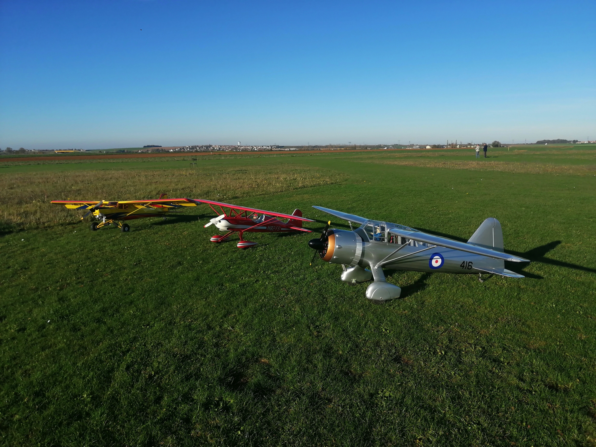

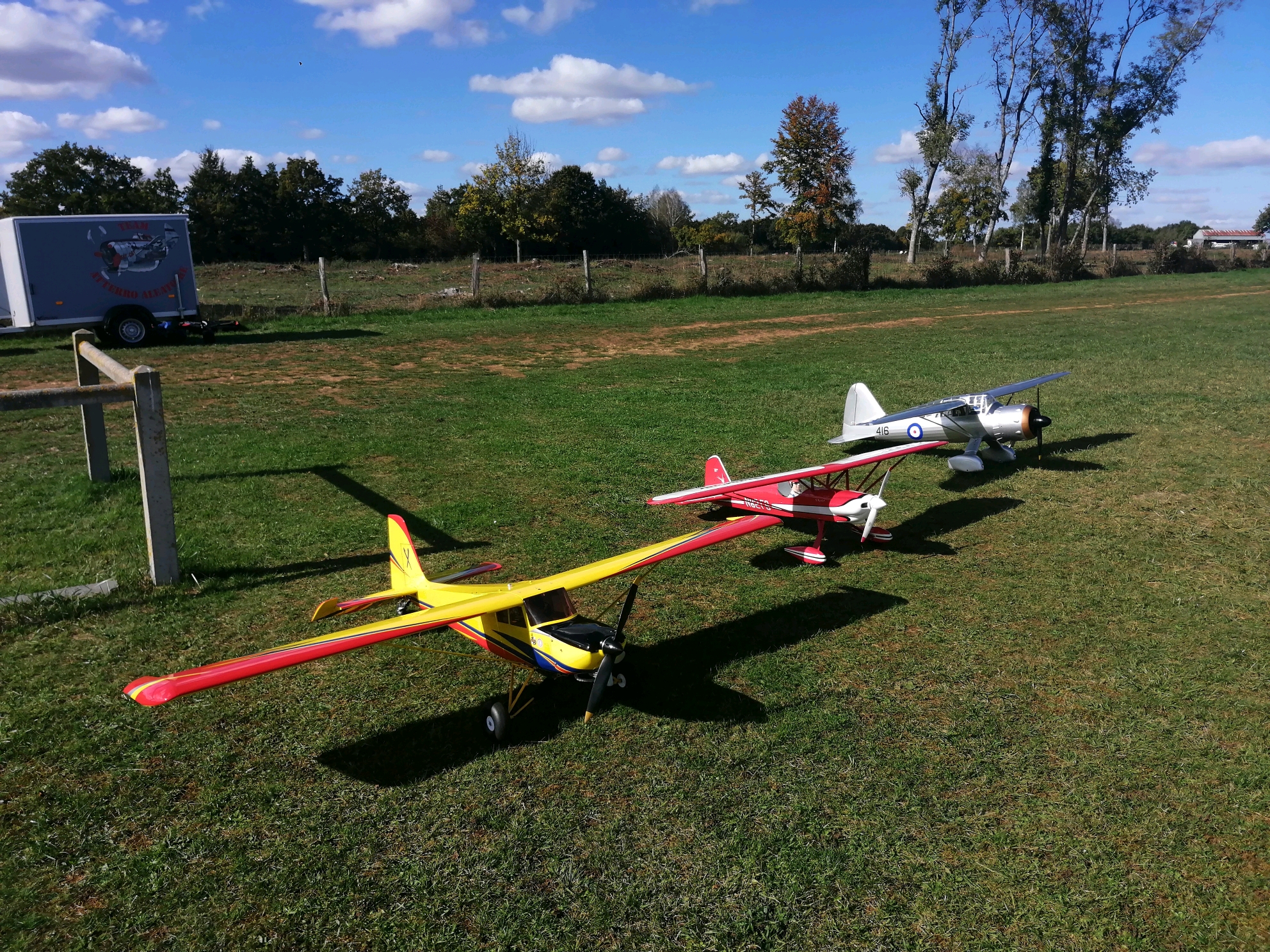

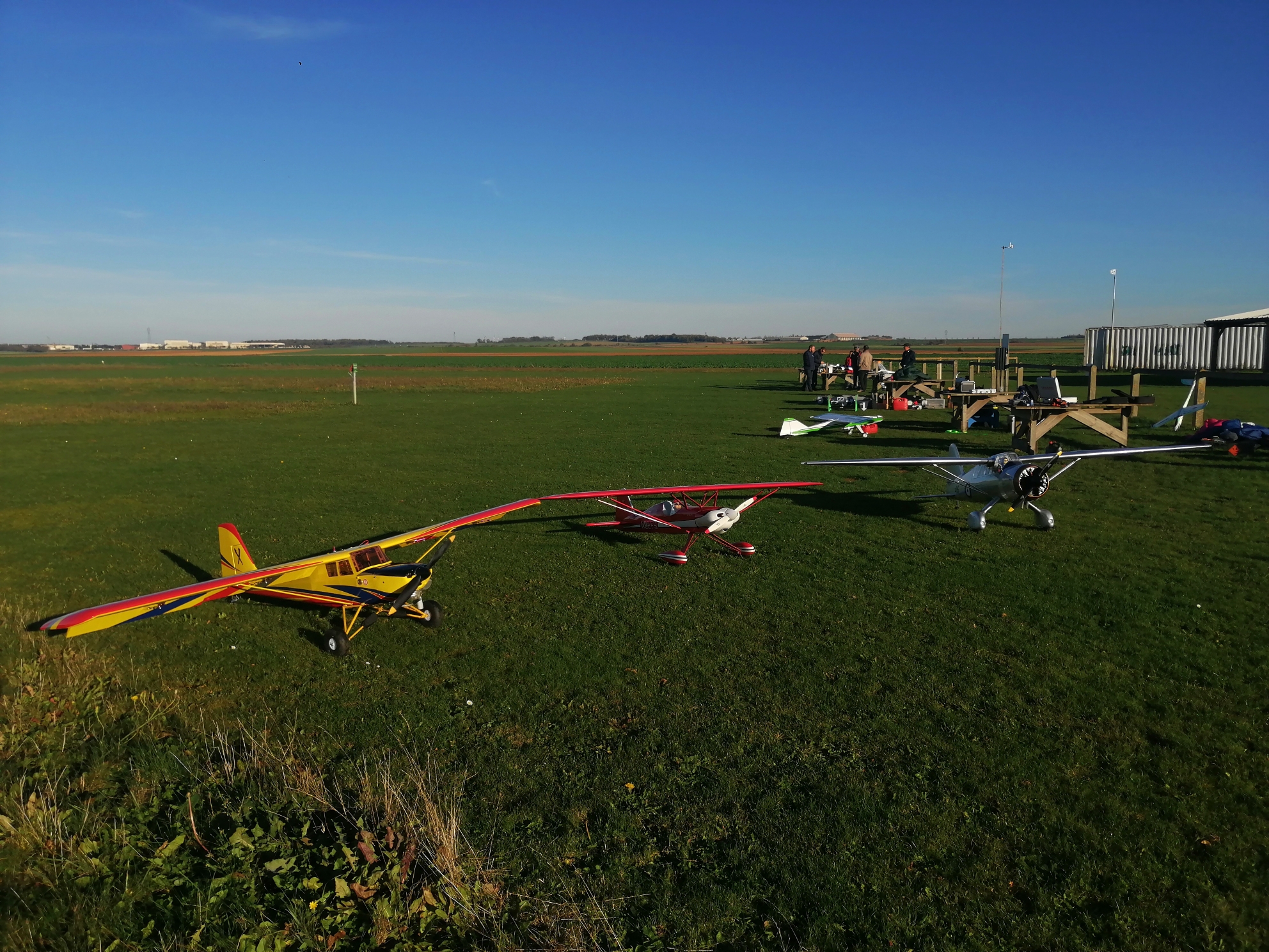

Here are some pics of The timber and my fleet (missing the foamies and my Topflite P47 GS)

The gear is probably the 60cc H9 X-CUB gear, which is also on my timber. The gear comes in red and covered, I stripped them down and painted them "carbon mist" enamel. Yours appear to have been repainted in yellow?
Can you get a flexible header to the cannister? There is someone here that did that... I cant find the picture readily
