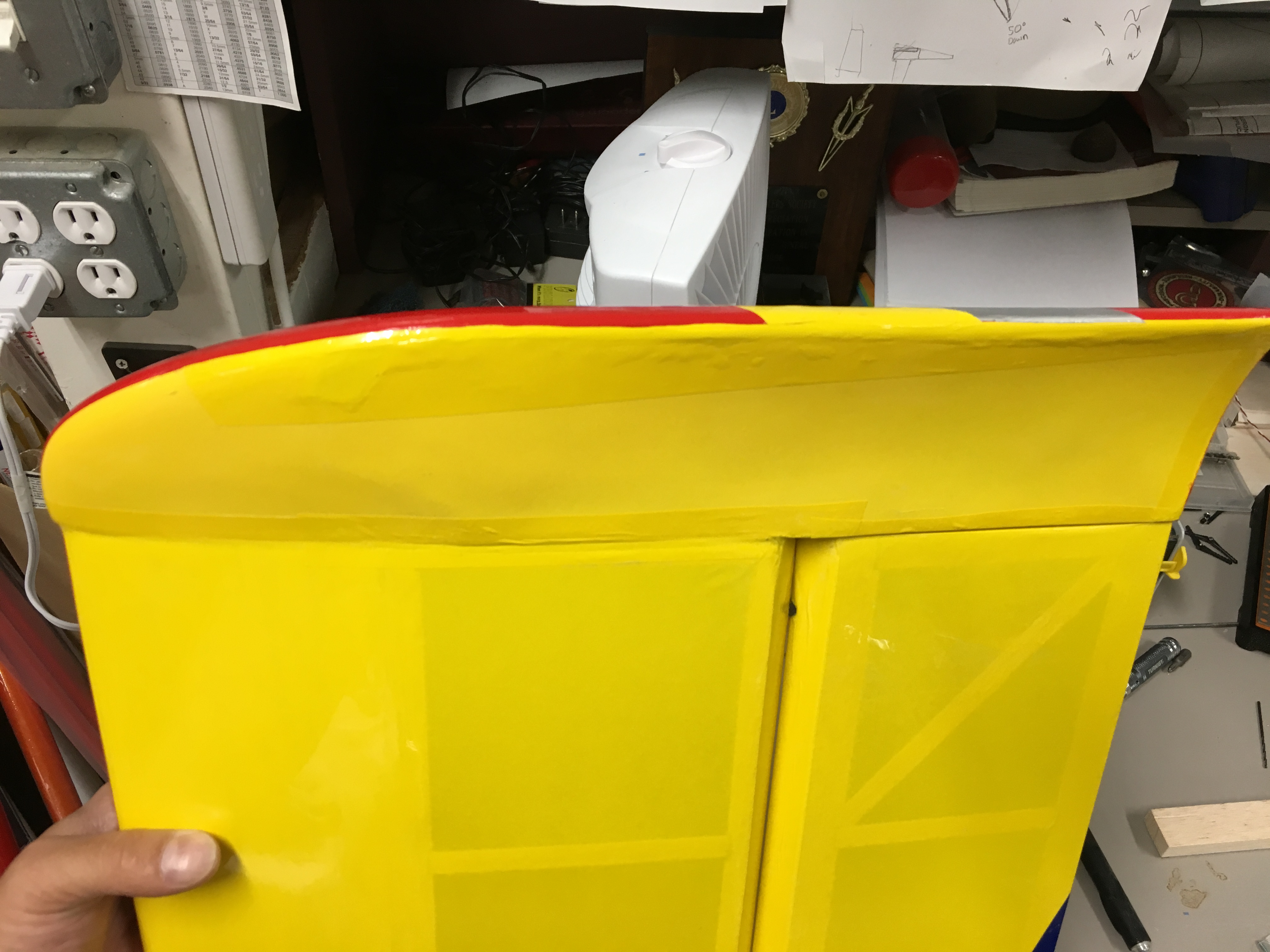

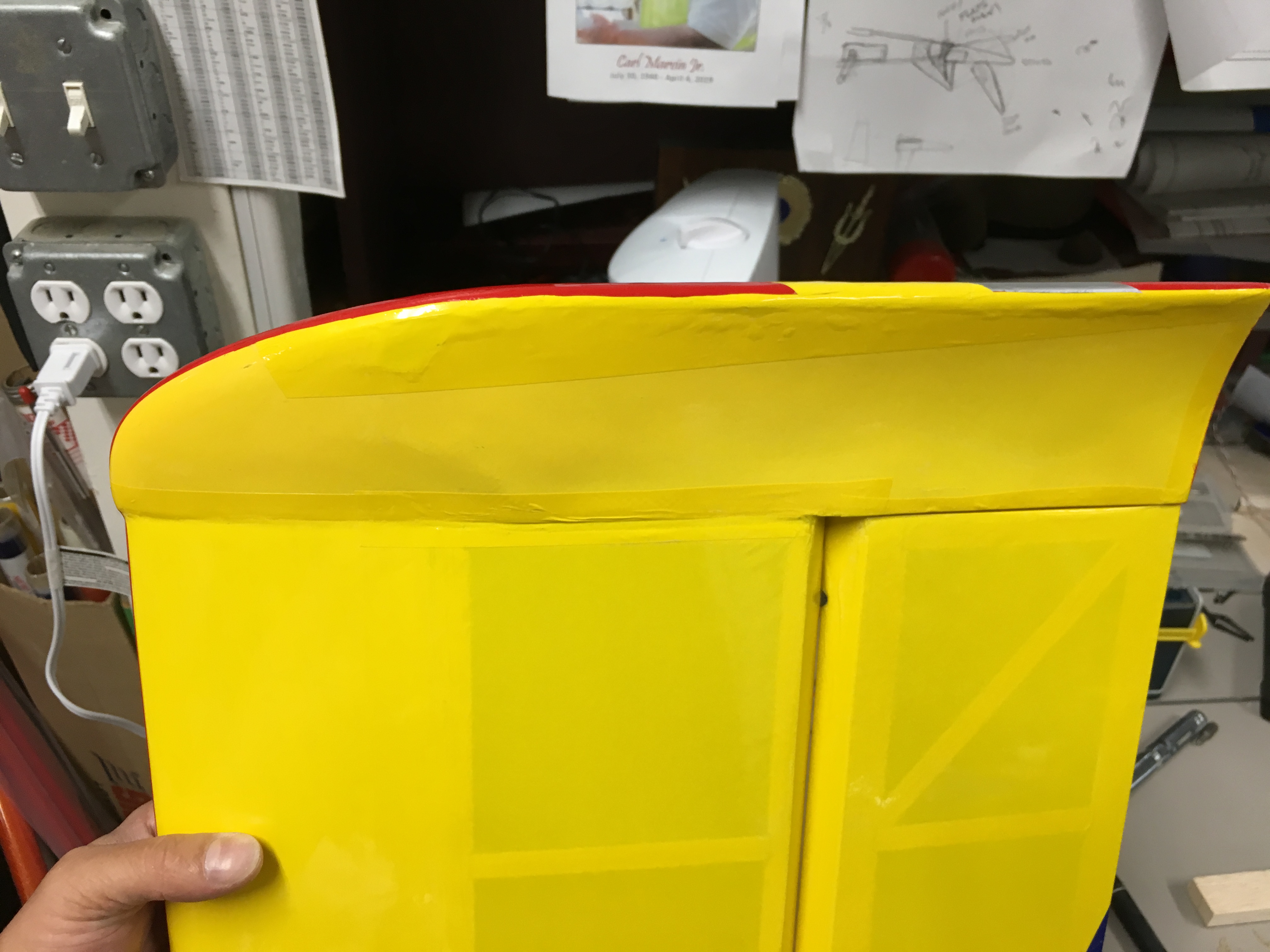

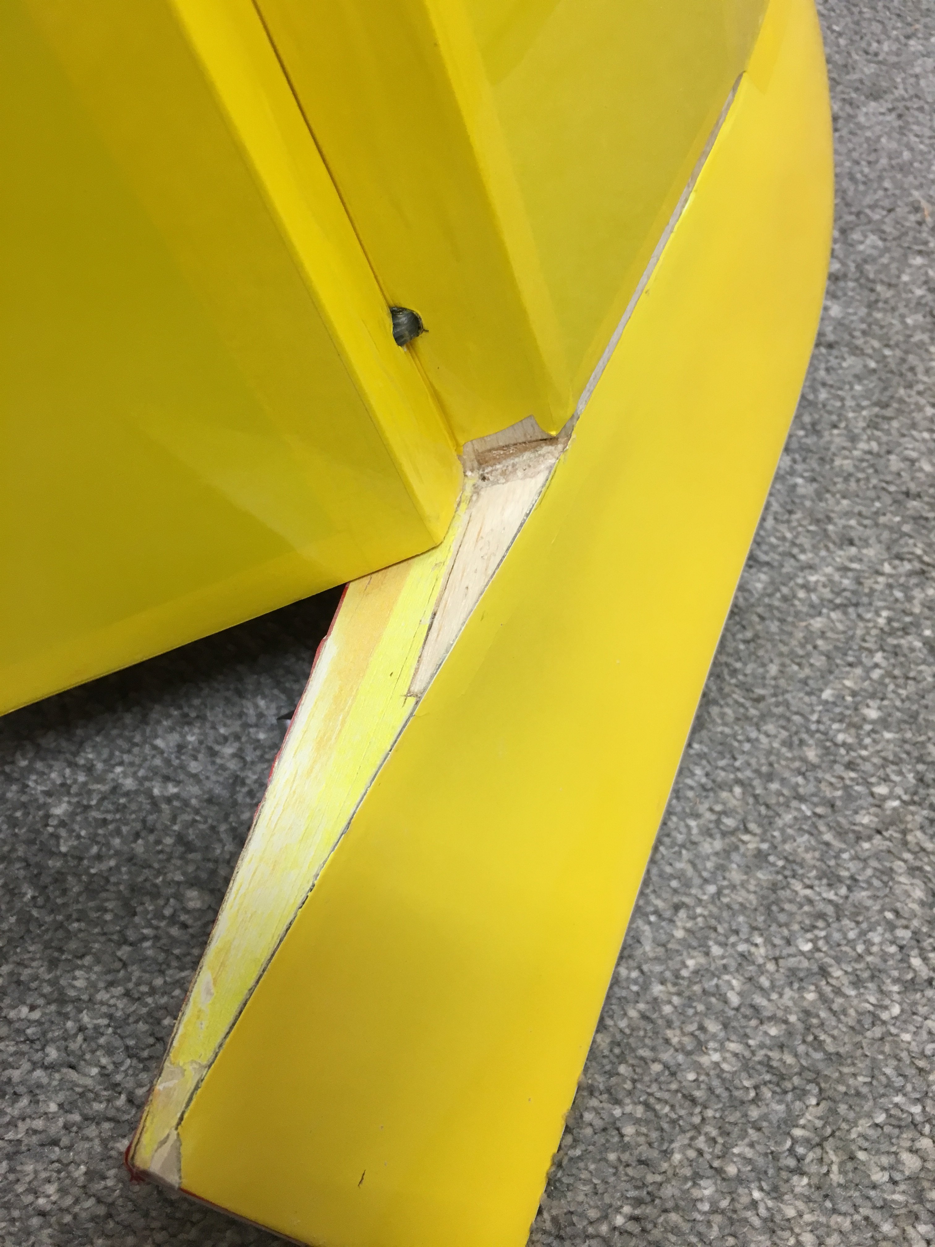

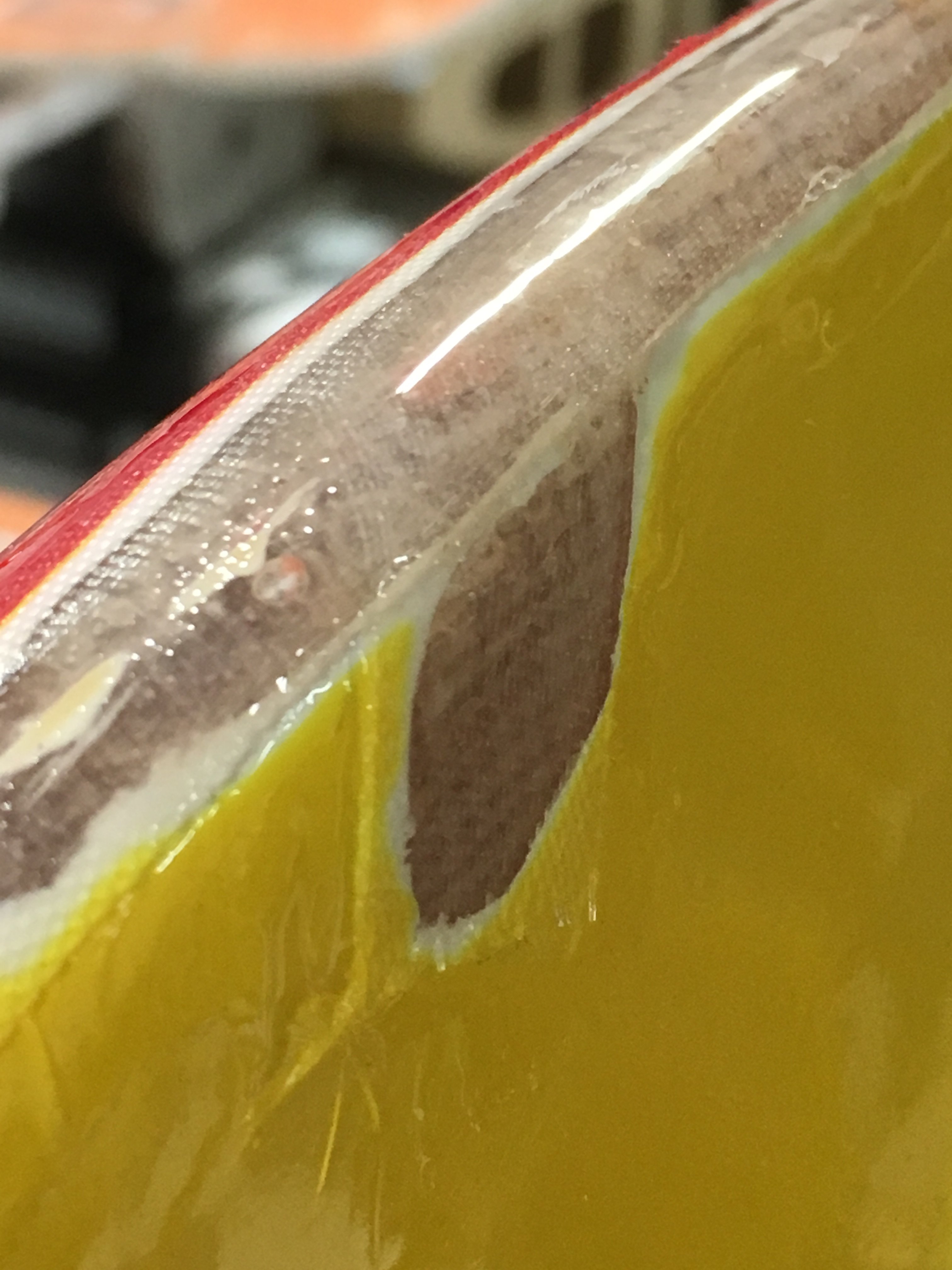

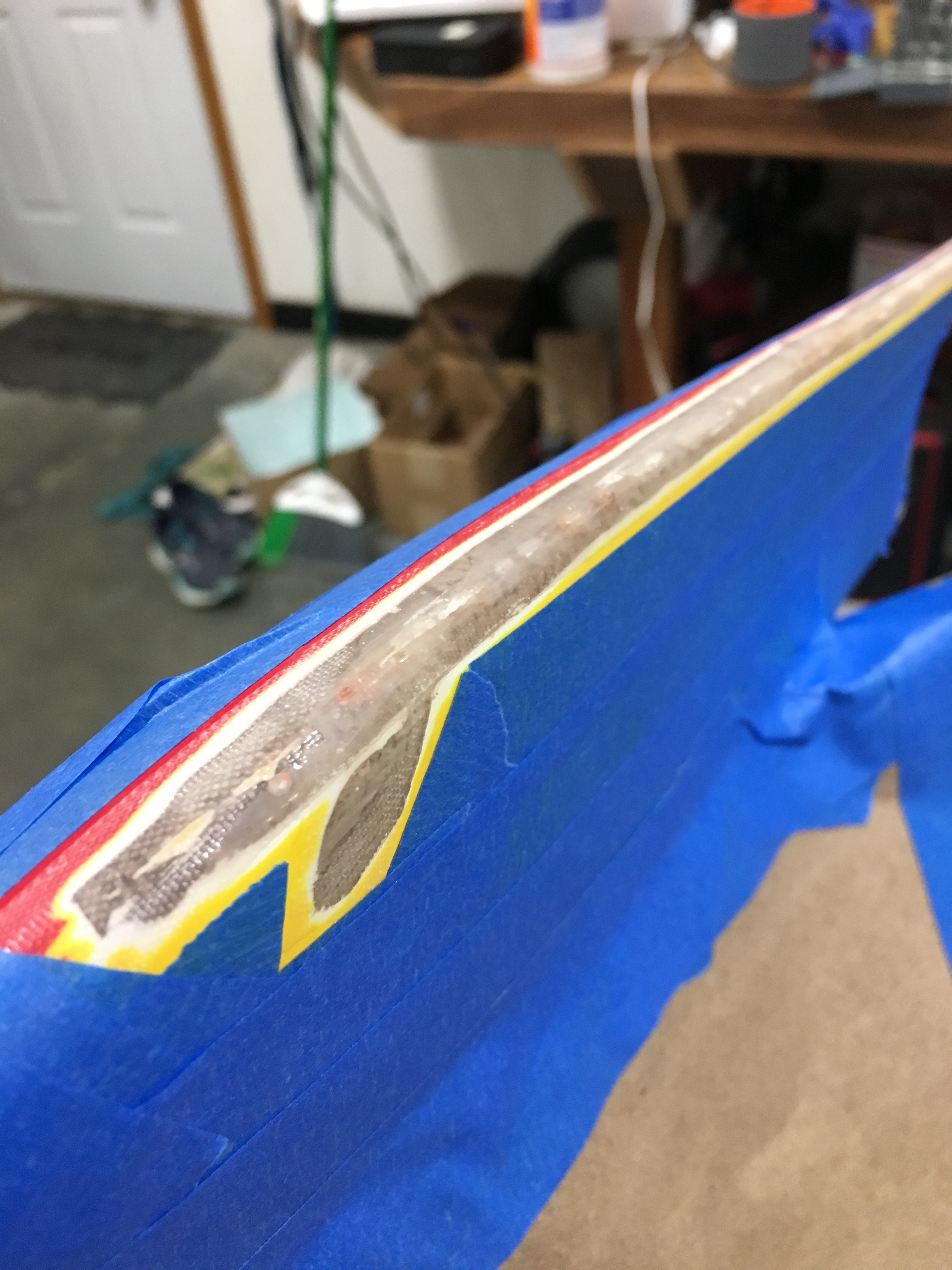

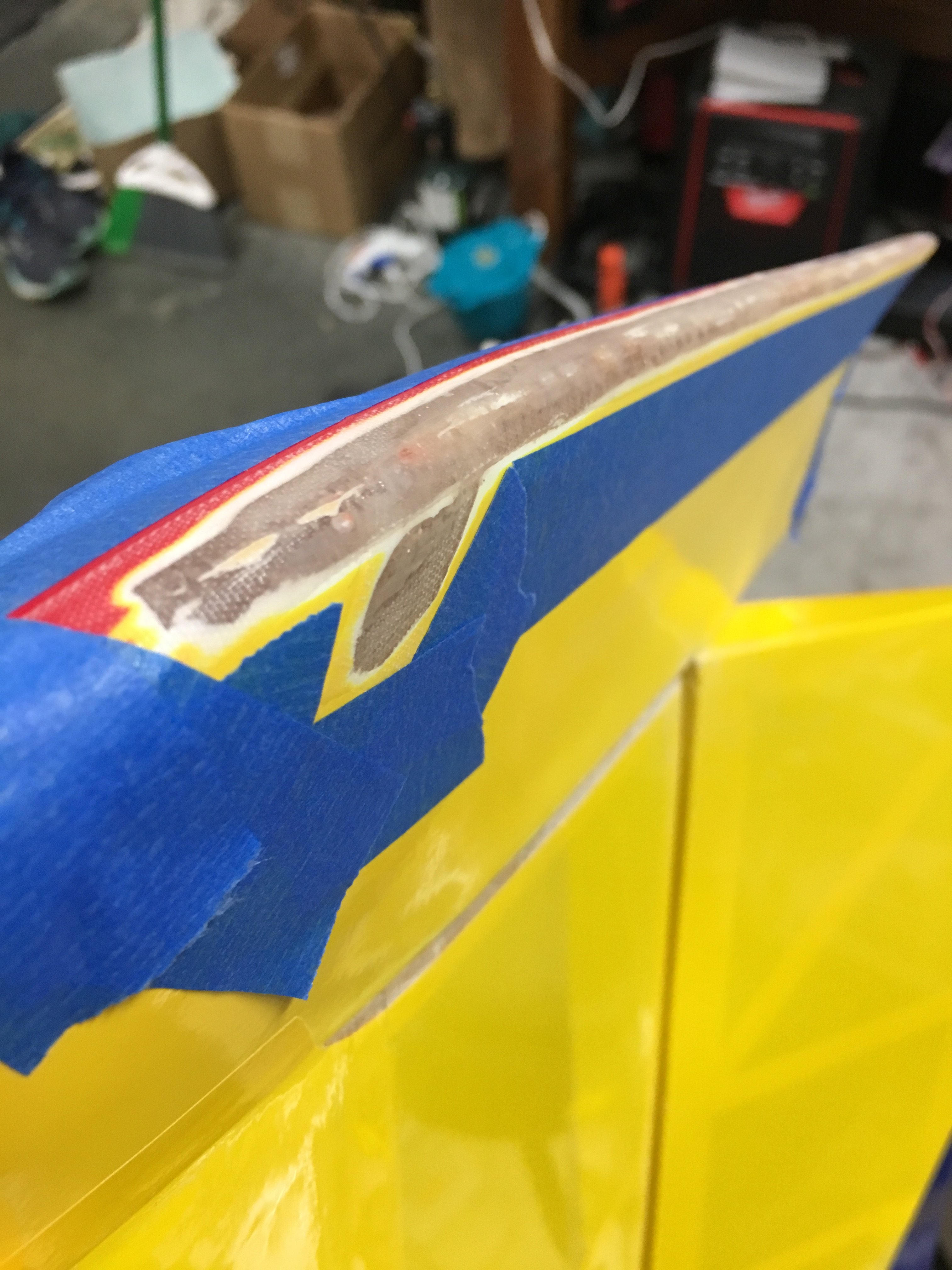

I’ve been a little slow repairing my wingtip. But it’s done. No it’s not pretty... but it’ll work pretty good. I’m too cheap to source matching paint.
Sanded down the wingtip to expose the fiberglass. It was a pretty clean break which tells me that the wingtip was made in halves. It cracked else where too. Using some glass tape, and west system epoxy, sanded, white primer so the bright yellow ultracote turns out looking decent, true red ultracote, followed by some silver trim, and of course the wing tip/root balsa rib was repaired by removing the busted stuff and adding new material.

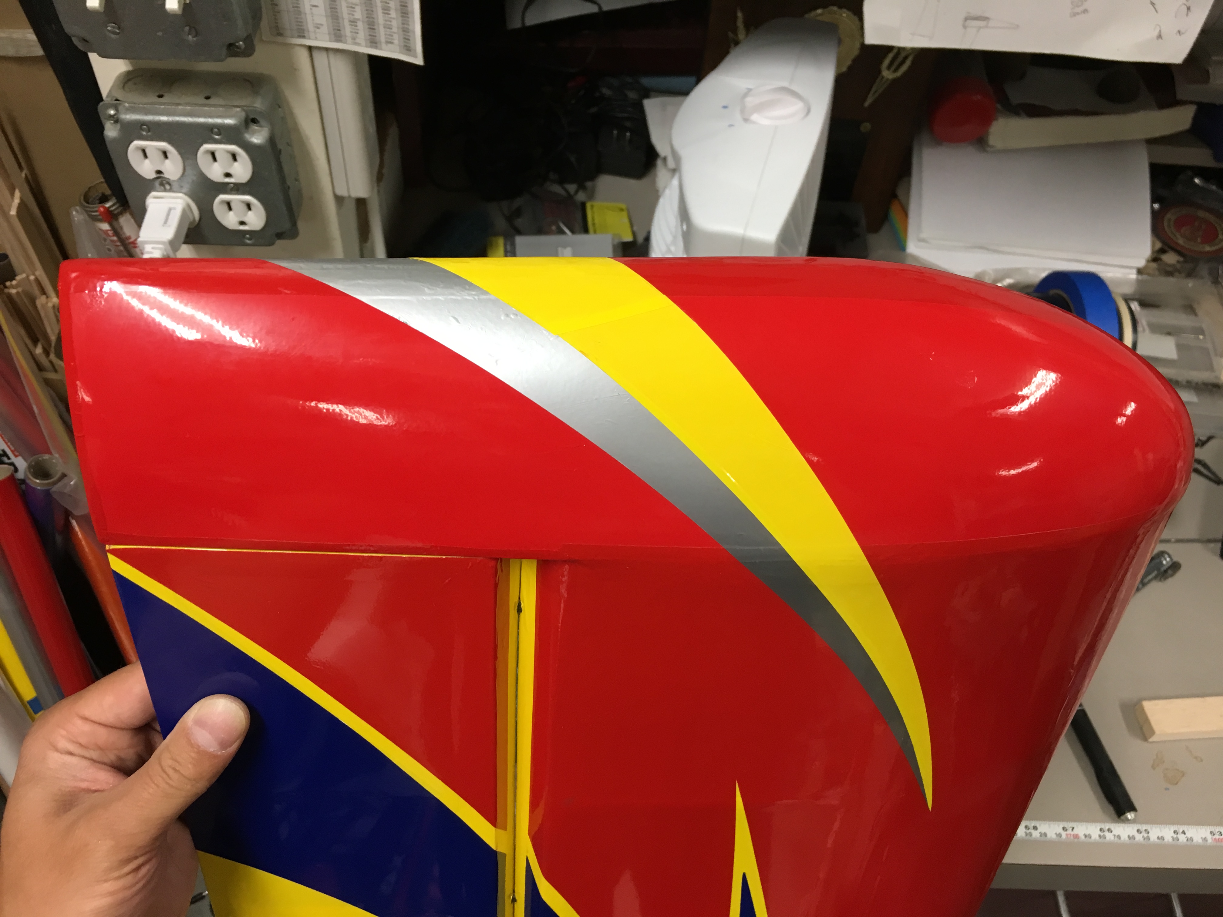

My shop is a mess, don’t judge me!

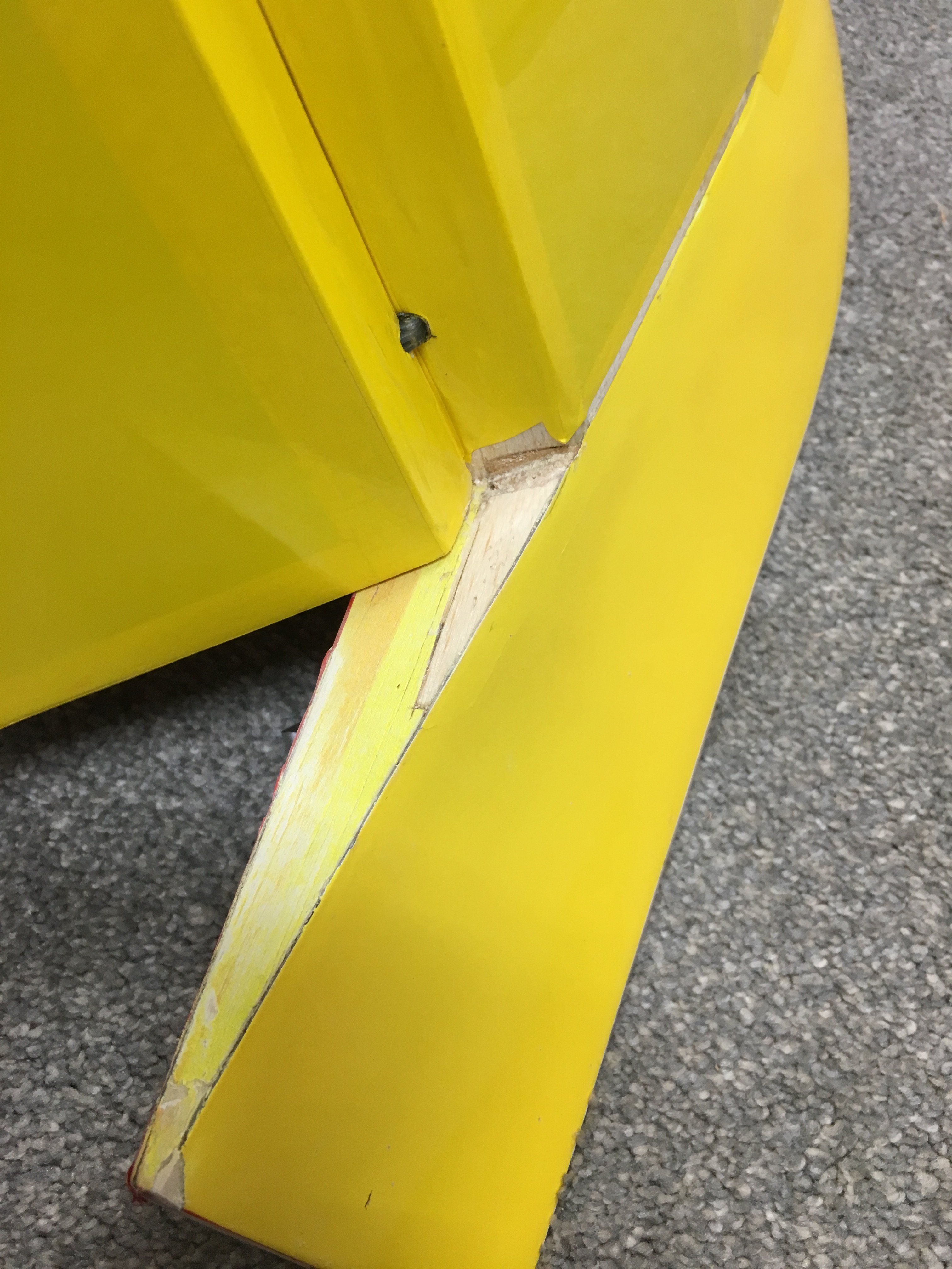

Repair completed

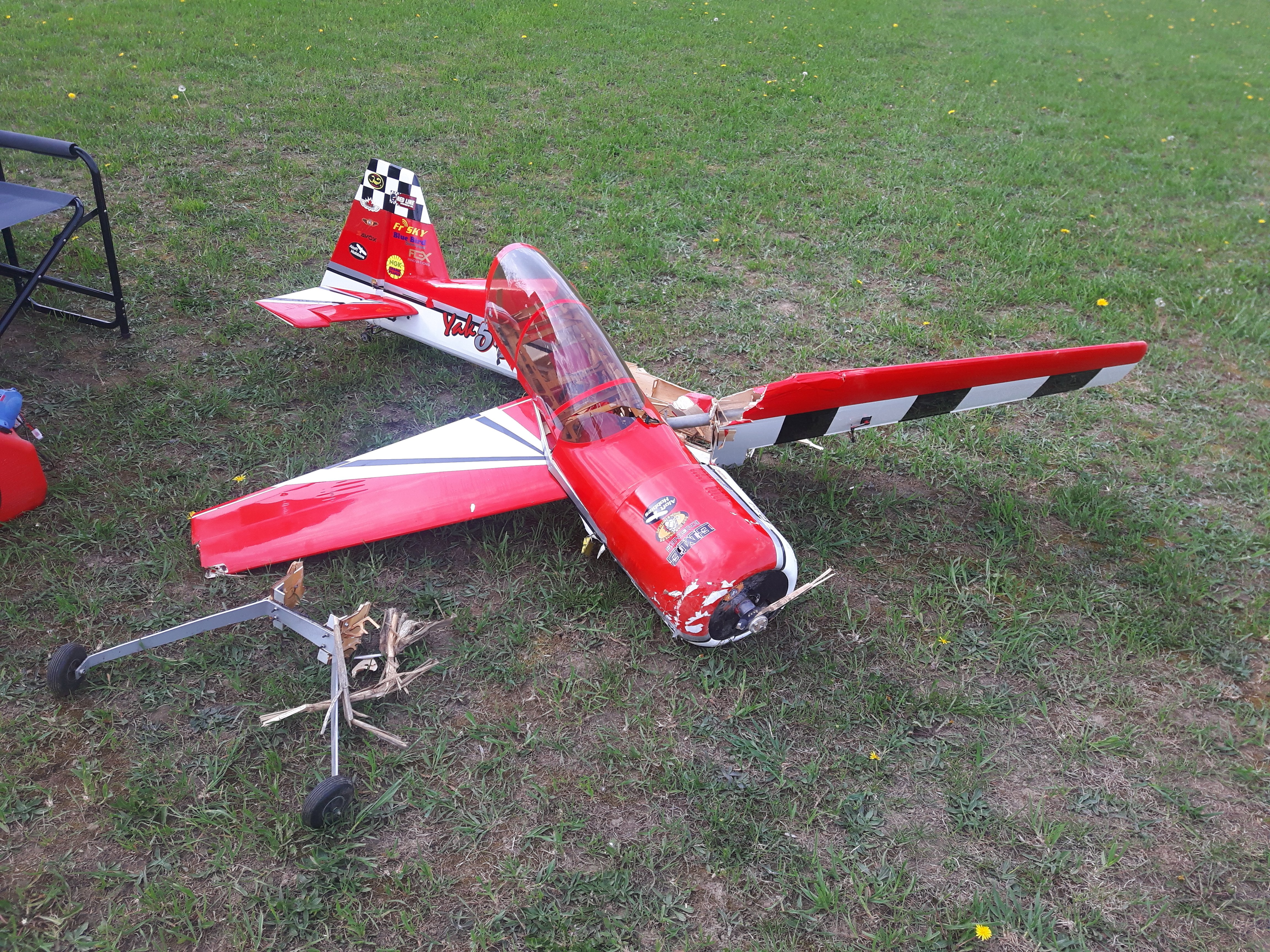

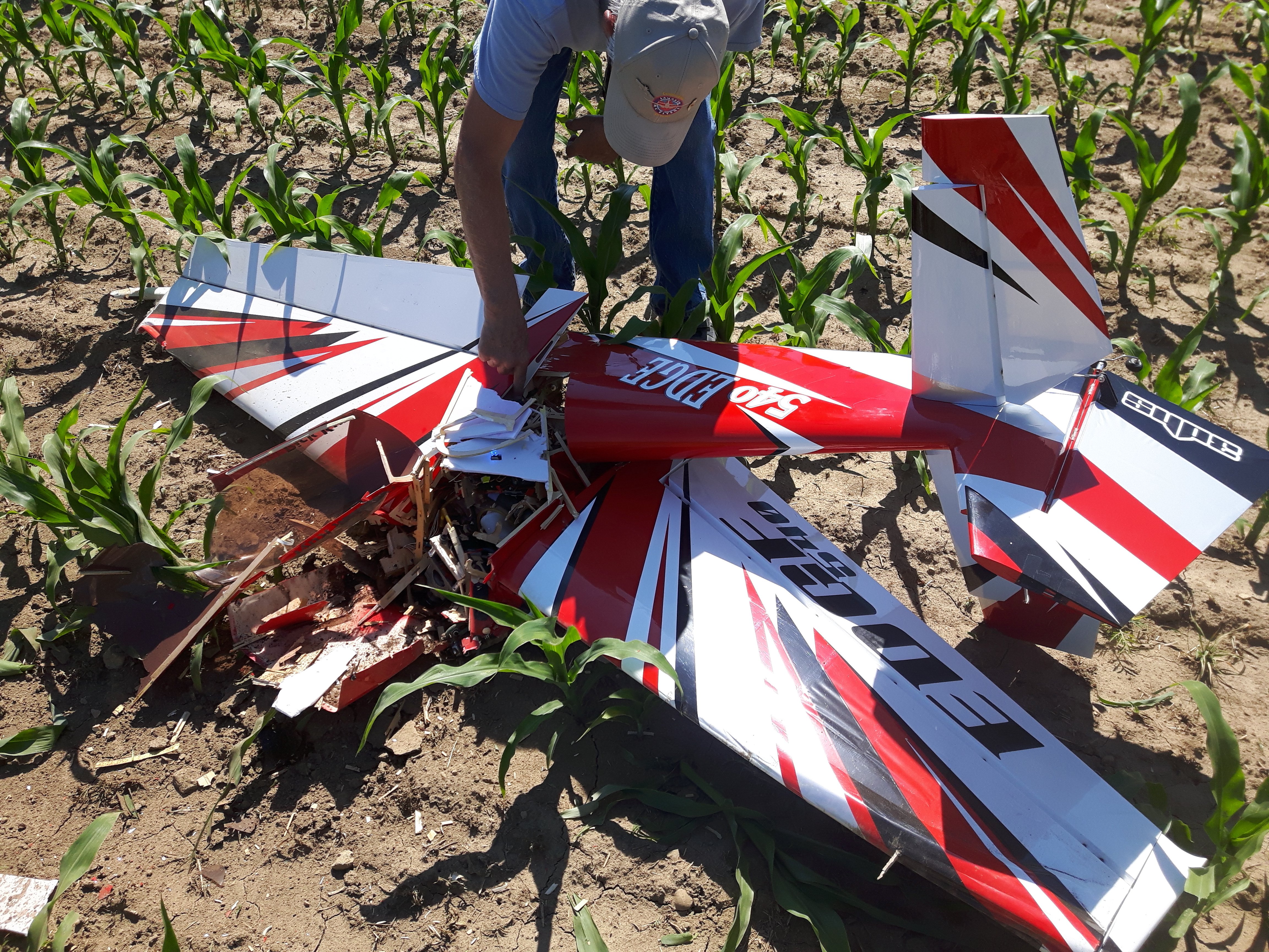

Well not for me, no fixing these. Not much luck this year... EF 60cc Yak and a 3dHS 91 inch Edge on the third flight.
Haven't crashed in years, I guess the gods wanted me to make up!!
View attachment 115291 View attachment 115292 View attachment 115293 View attachment 115294

Repair completed
View attachment 115296 View attachment 115297 View attachment 115298
