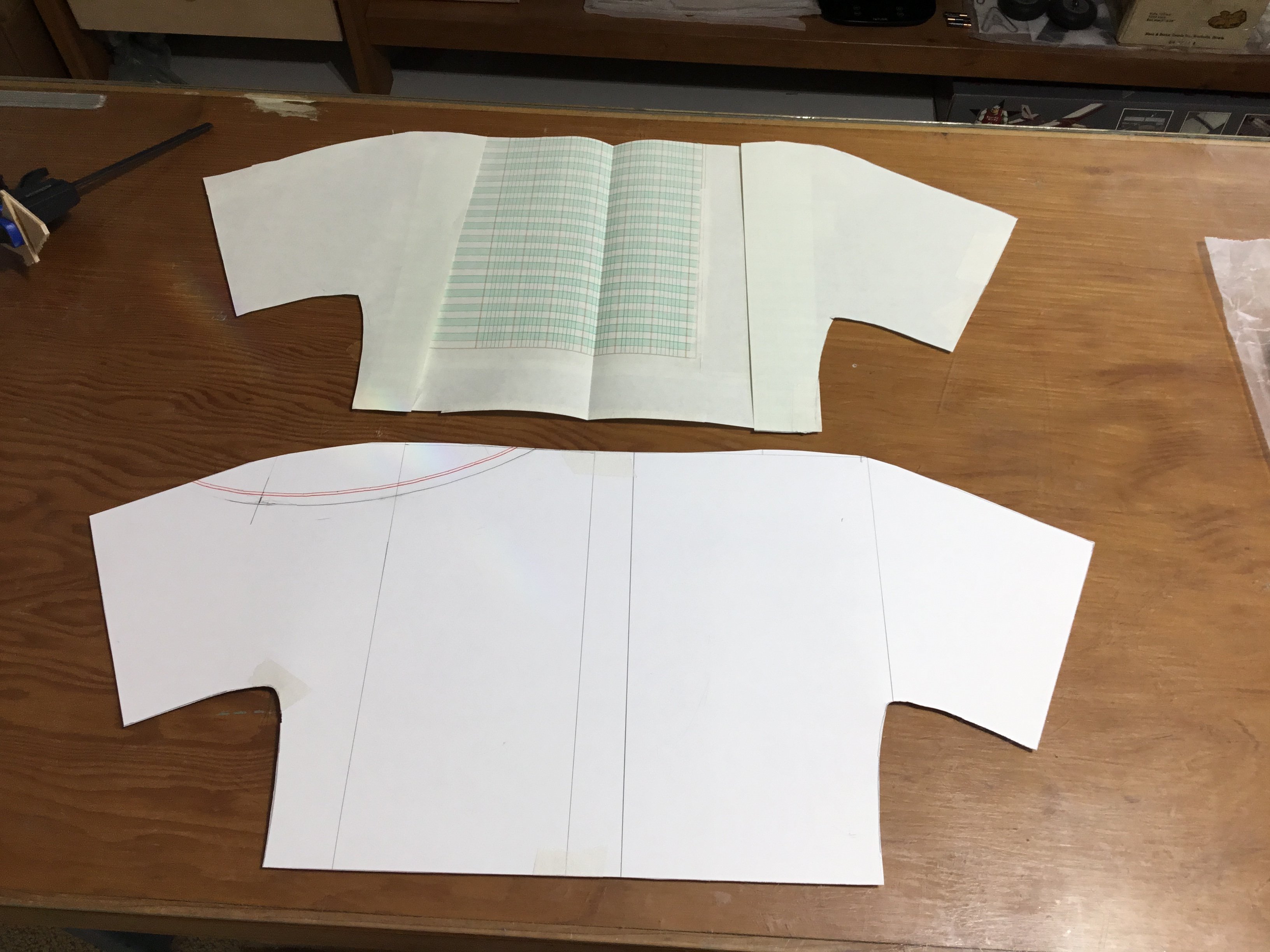

Well made a start on The windshield. Started with paper first then made a second pattern from cardboard. Getting close. Still not sure if I am going to make a ledge on the inside and lay the windshield on the ledge or on top of the fuselage. What do you gentlemen think.

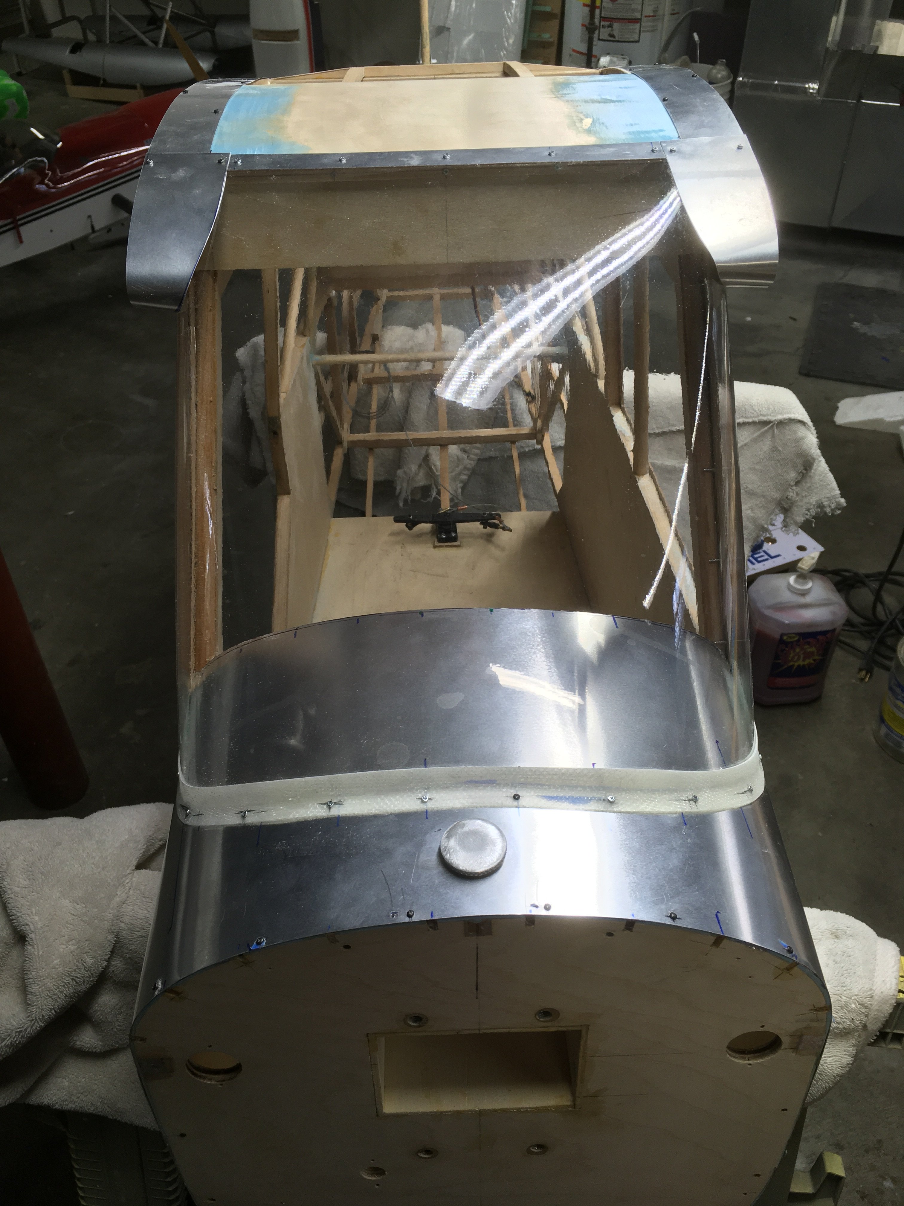

Piper simply calls it windshield attachment strip. I made it by laying fiberglass in the area and final sanded to shape.
On the Balsa USA Super Cub, the attachment strip is formed into the windshield plastic, nice touch.

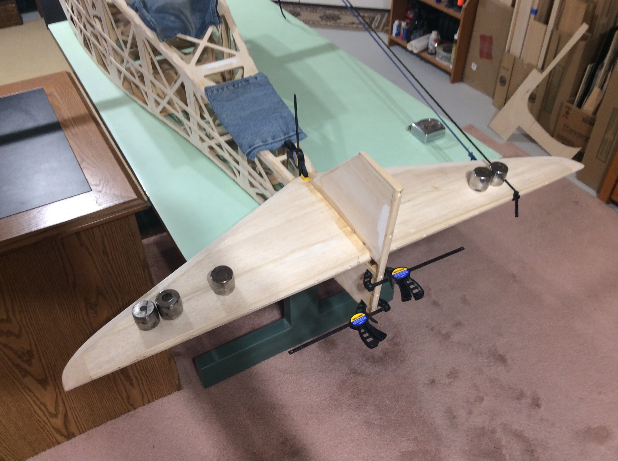

Fin and stabilizer are in and are square and straight to the fuselage. Just have to cleanup and finish of the fin connection to the fuselage to make look good. Will add the wiring tube from the cockpit to the tail.
