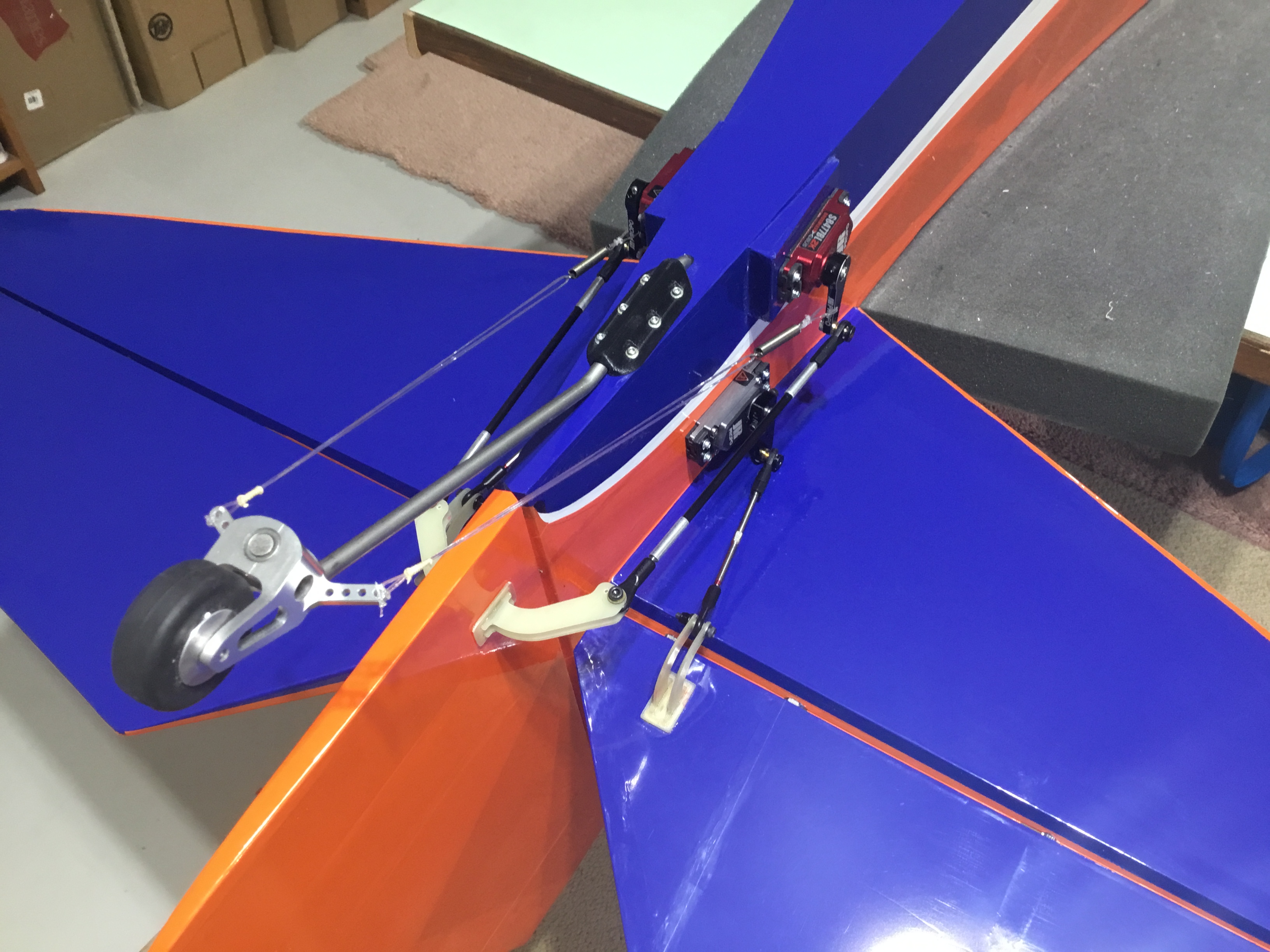

Busy setting up the JR-Bus system. Have the servo ID done . Now just have glue in the rudder in so that I can synchronize the 2 rudder servos.
if you are interested this is link explaining the JR matching

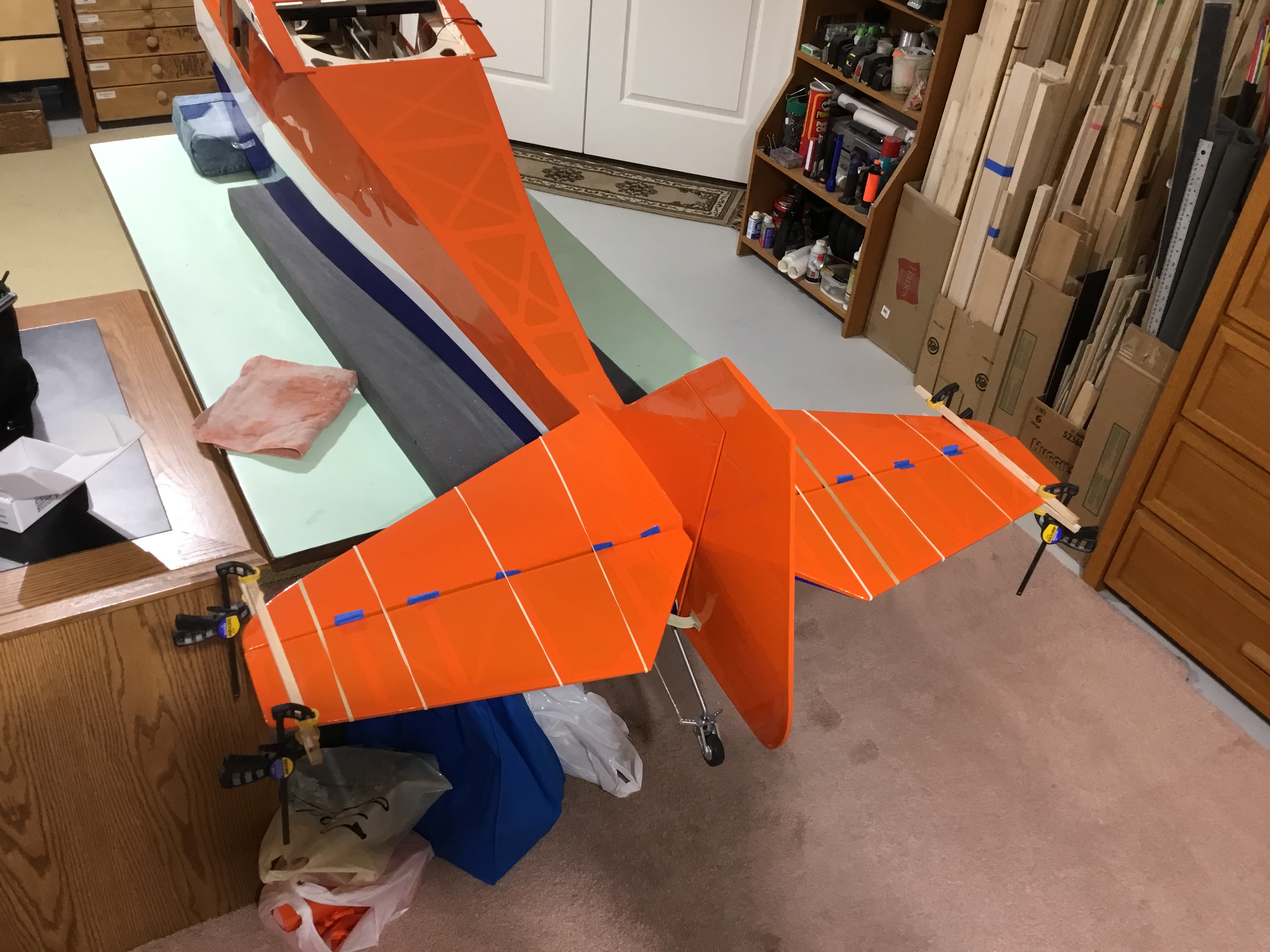

Got to the elevators installed at last they are glued in just have wait for the epoxy to cure and then some connections to the servos and the tail section will be completed. Getting there slowly.
Ok every thing in the tail is done. Made up all the connecting rods and the tail wheel setup. The rudder synchronization is done and working.
Also installed the bracket that @AKNick designed for the tail wheel.
When look at it takes a lot of equipment to make the rear end of an aeroplane operate properly and also be robust, serviceable and light.

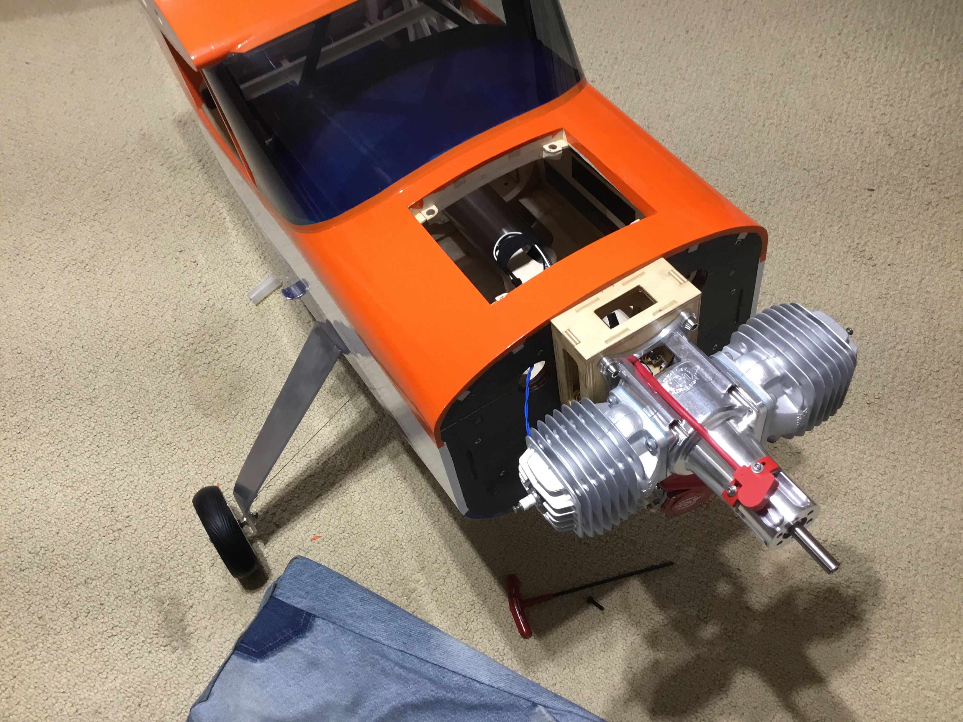

Ok making some progress the motor box and engine are installed And and all the nuts bolts have blue Locktite on them.

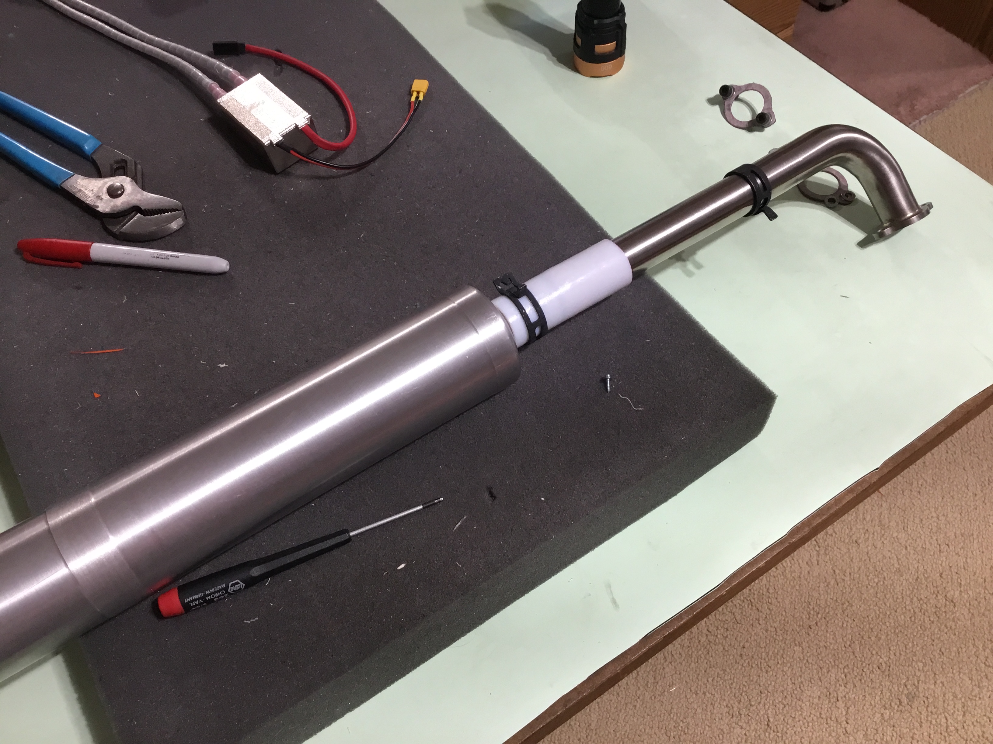

one canister in stalled and busy pinning the second one and ready for installation.
DA120? I just got mine back from service and have to reinstall the mufflers. I HATE mufflers. Your canisters and headers make me think about changing over. All of my planes for the last 15 plus years are canister other than my Yak.
