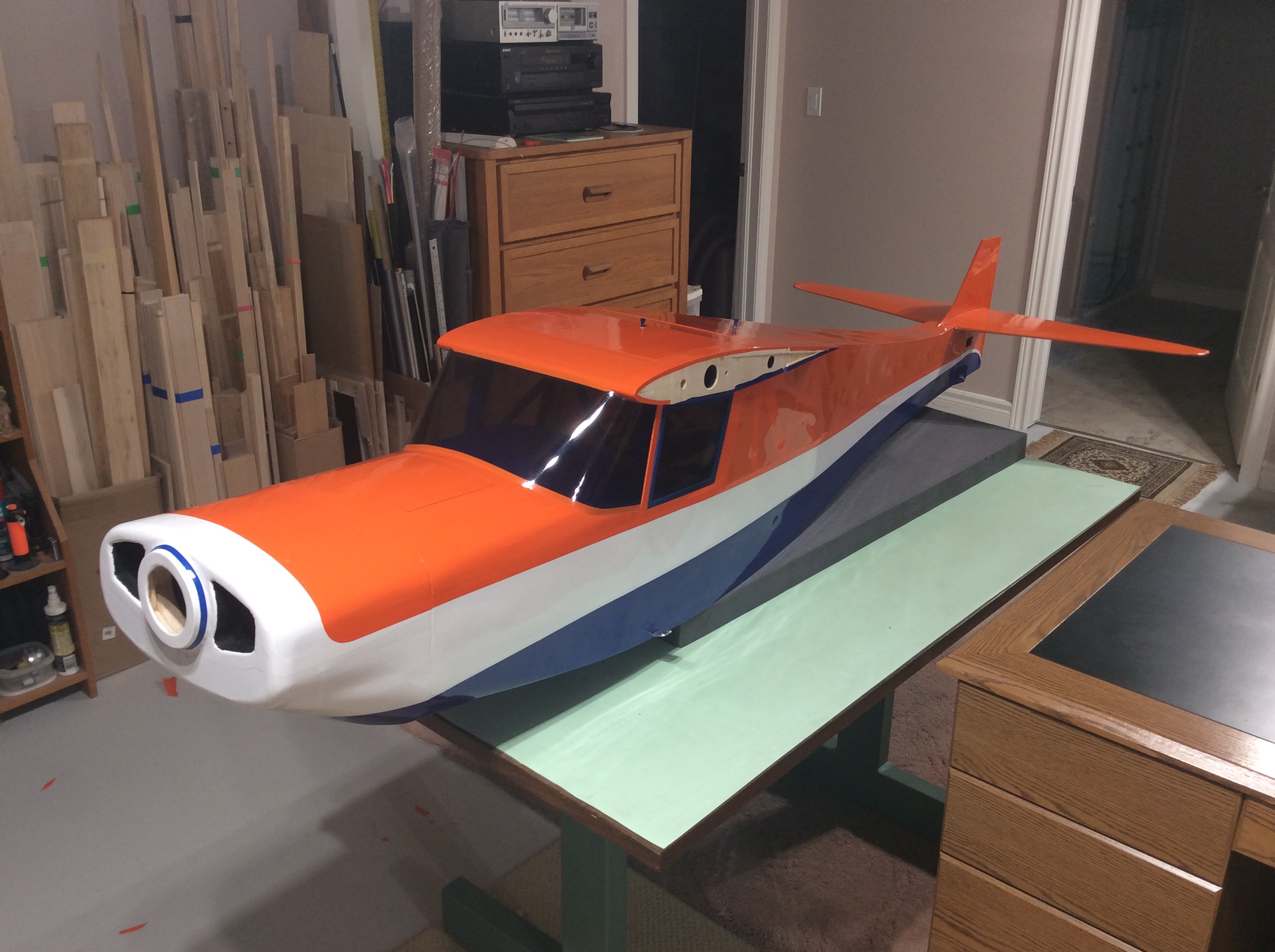

Scale 112” - Taylorcraft by HeyLuc & Snoopy.

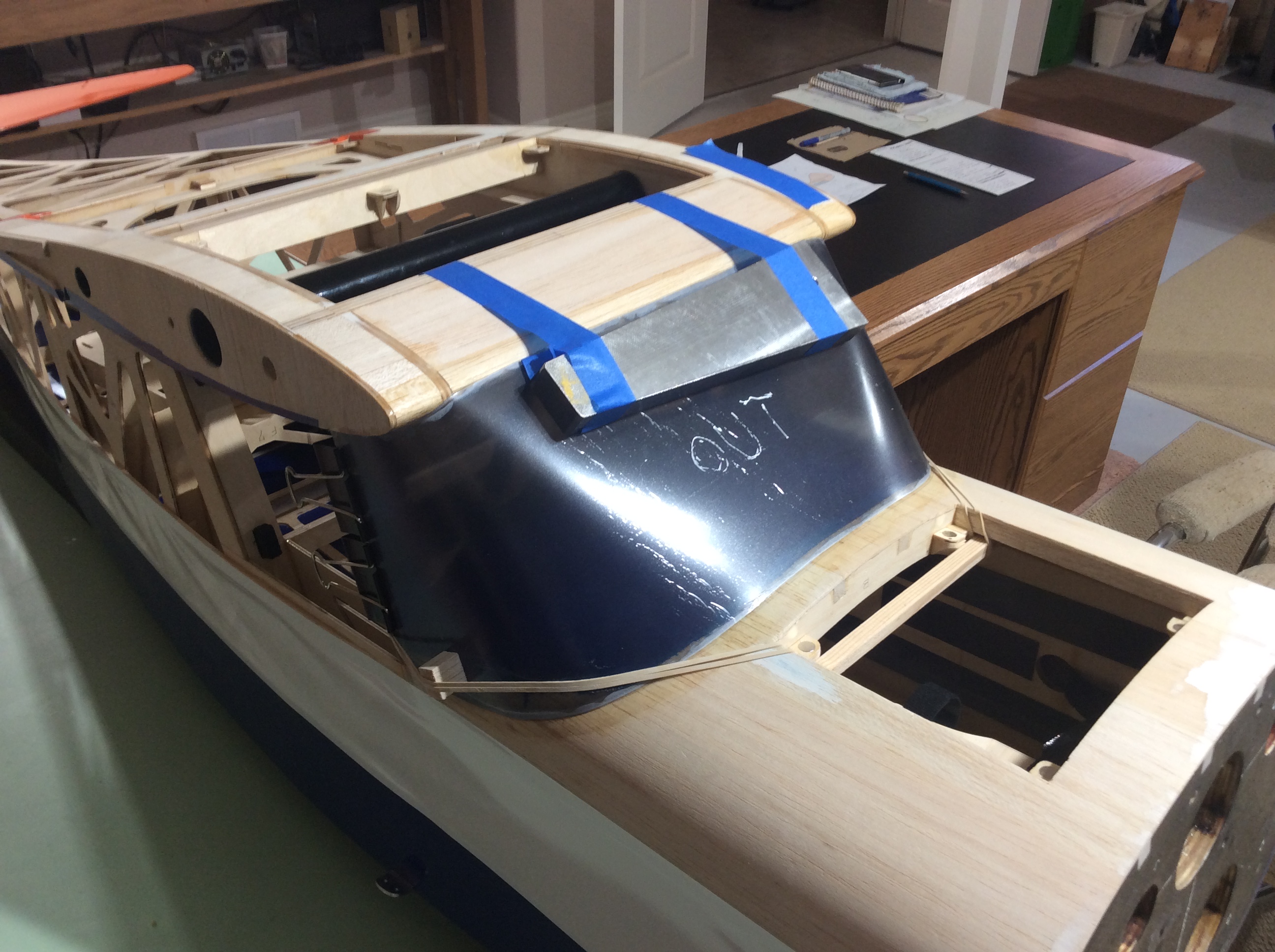

Well it’s glued in now I just have be patient for 3 hours and see what I have. Gluing windshields and canopies is never easy and you only get one chance.

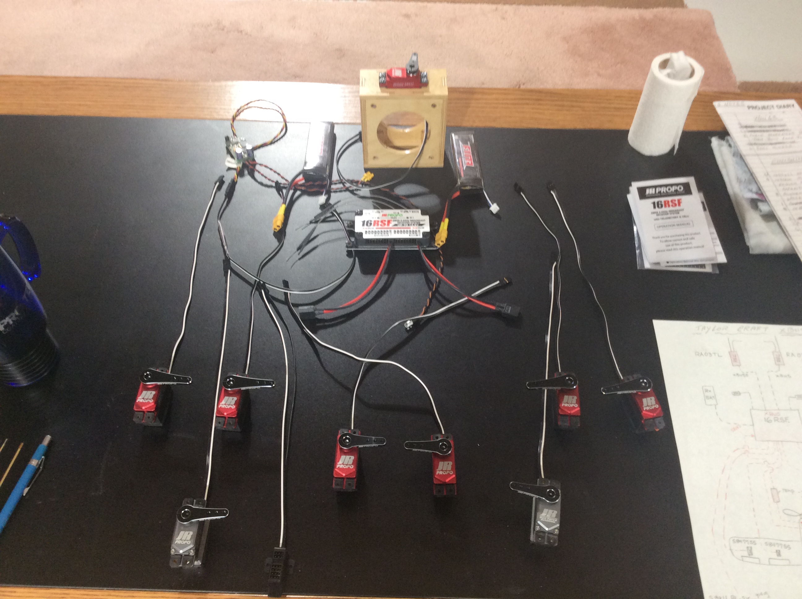

Just about to install the elevator and rudder servos that I realized that I should program all the servos first. That should keep me busy for a day or two. What is so nice about the JR - XBus system is you can actually program the servos for location in the plane and the characteristics you need. I.e. gain, soft start, degrees of rotation, center, damping, acceleration and a few more just cannot remember them all. Will read up on it again and then will be ready to program them all. Will also servo matching ailerons, elevators and the two rudder servos. The matching works over 2000 positions.
