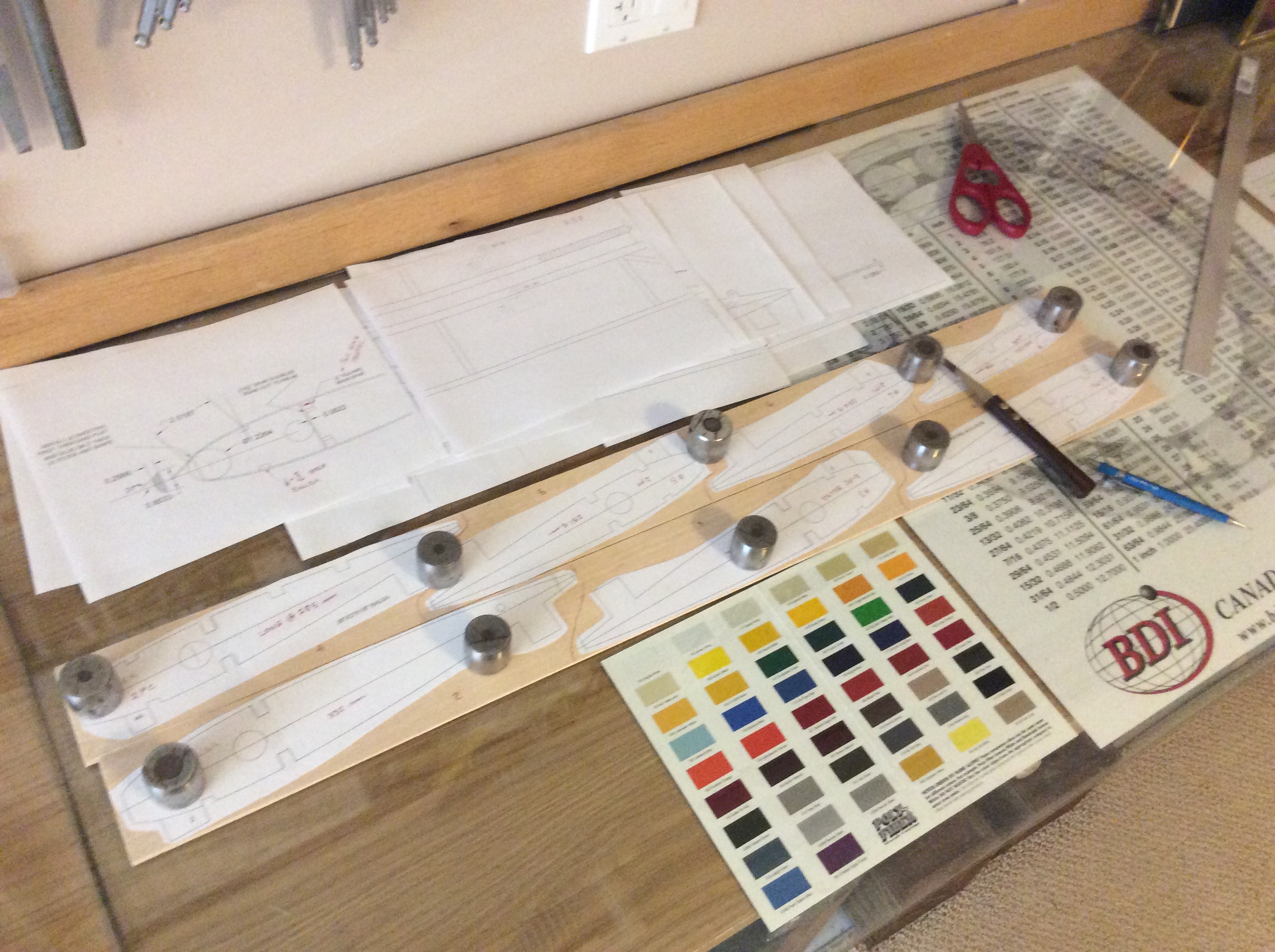

Well made a start printed out all the ribs and the end plates. Had to make some minor corrections to the print outs but they are all correct now and ready to be glued to some balsa wood. 8 ribs and two end plates.

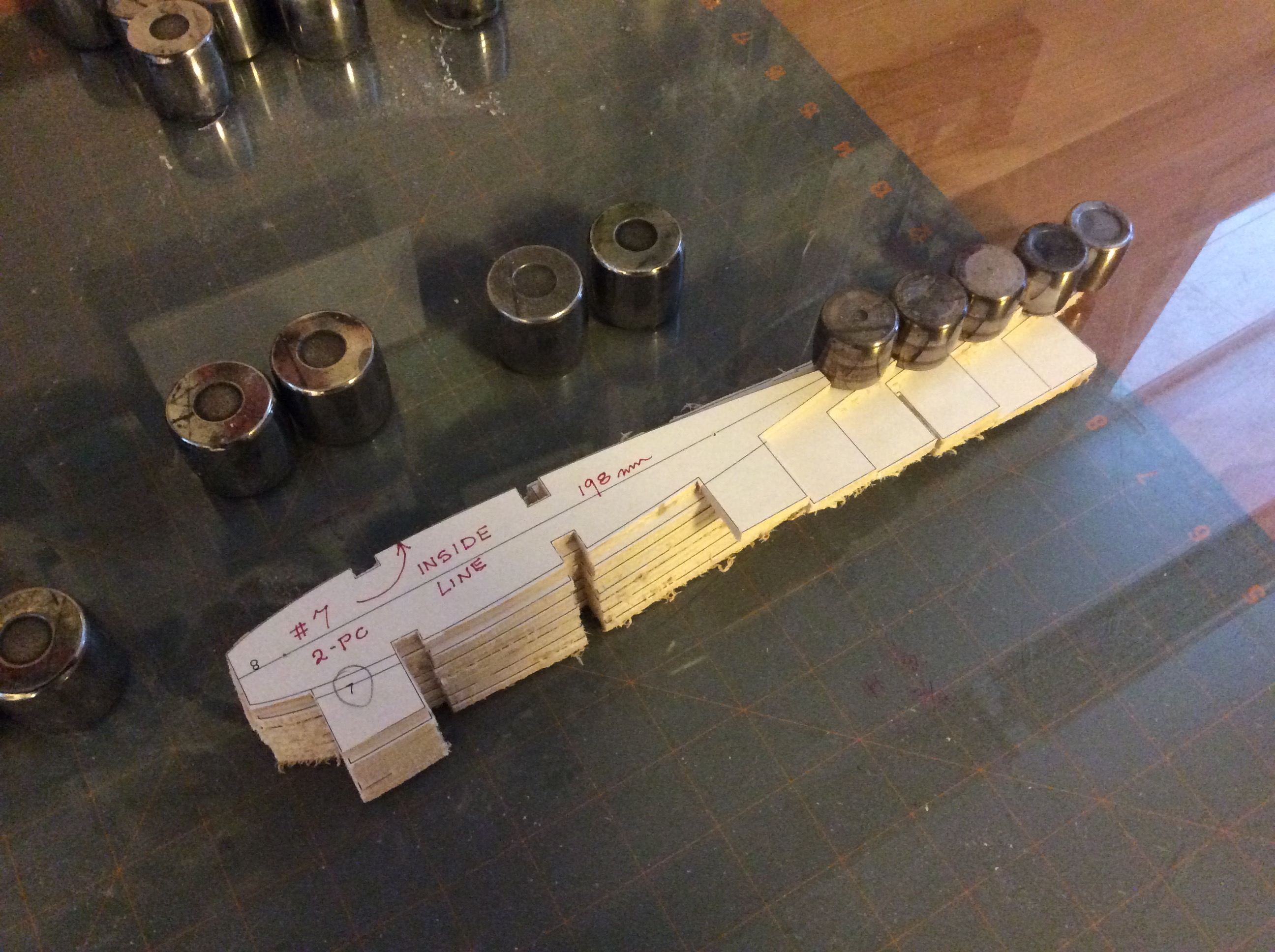

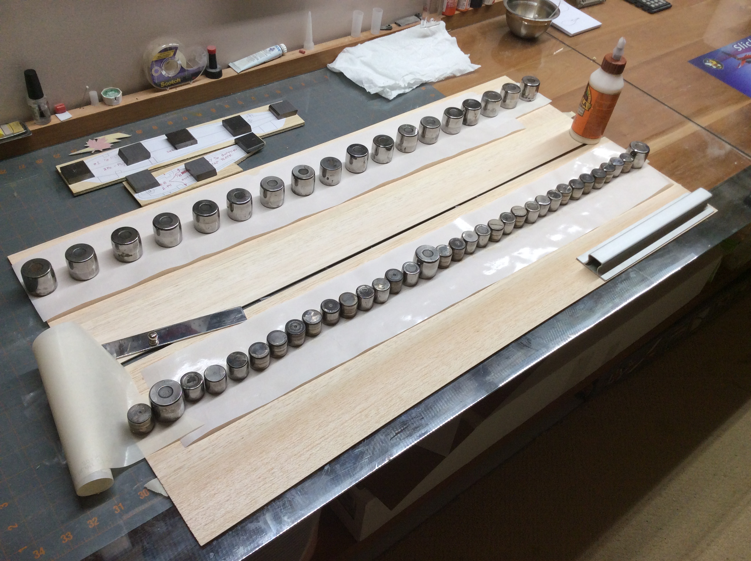

Made a start at last. Got some of the edge gluing done on the 1/16 sheeting. Ribs laid out on some balsa sheets, just need to be glued down and then the sanding and cutting starts.
