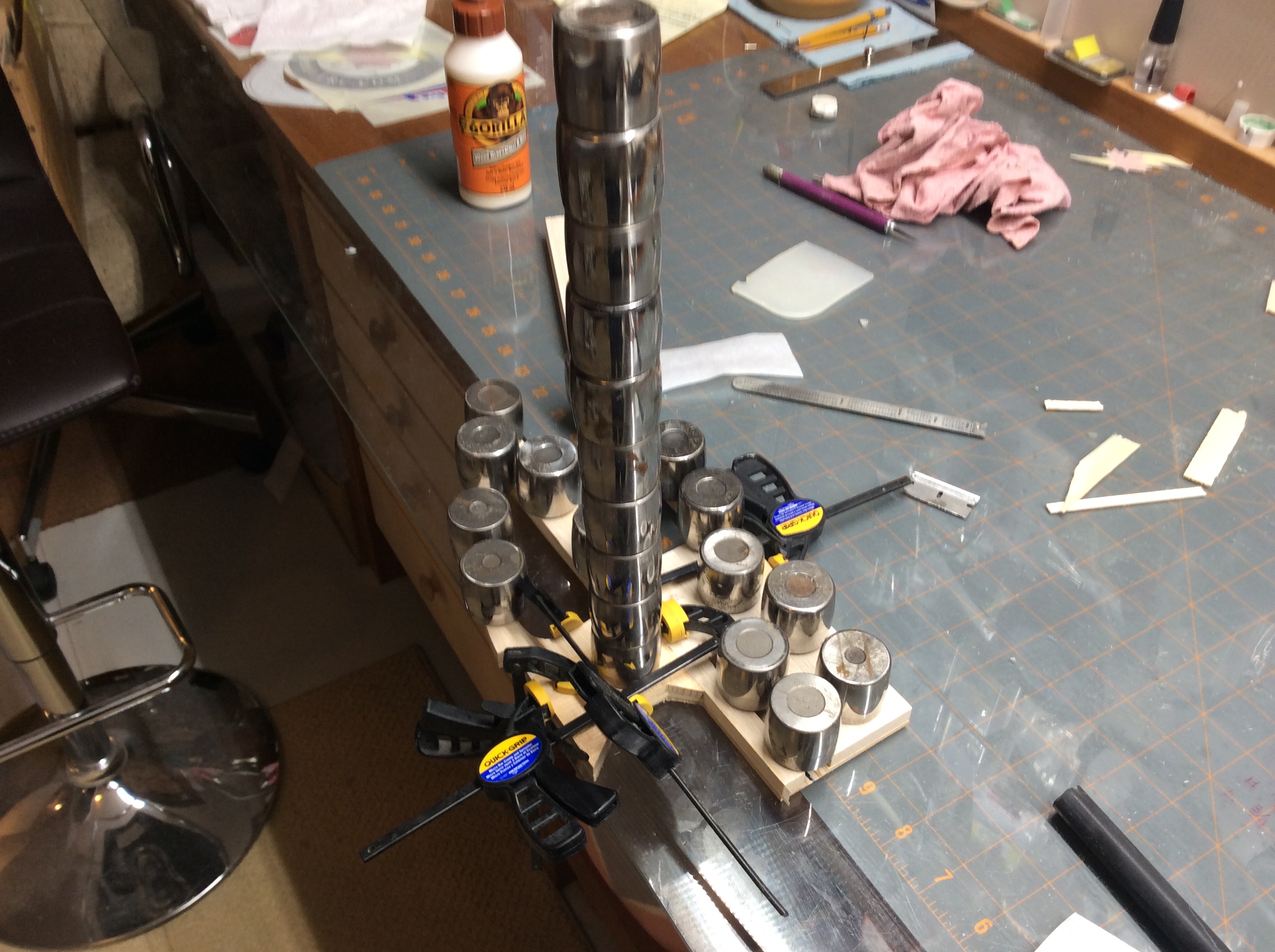

Got another piece of the front end glued in it, it is a slow process when using wood glue. Every 45 minutes a piece gets added. Making sure every piece is in place and clamped in tight.
Got the second plywood plate glued to the other side. Leave it overnight and see what I have tomorrow morning. That should be it for the front motor mount. Now I can get into building the stick fuselage.
Are your building weights from a large roller bearing? Is Gorilla glue your go to? Never tried it myself.
Yes you are correct the rollers you see are from a rolling mill main back up roll bearings.
And yes again over years I keep going back to Gorilla glue it seems to work the best for me and one thing I like it sands well and does not clog up the sanding blocks. But it does not get as brittle as others.

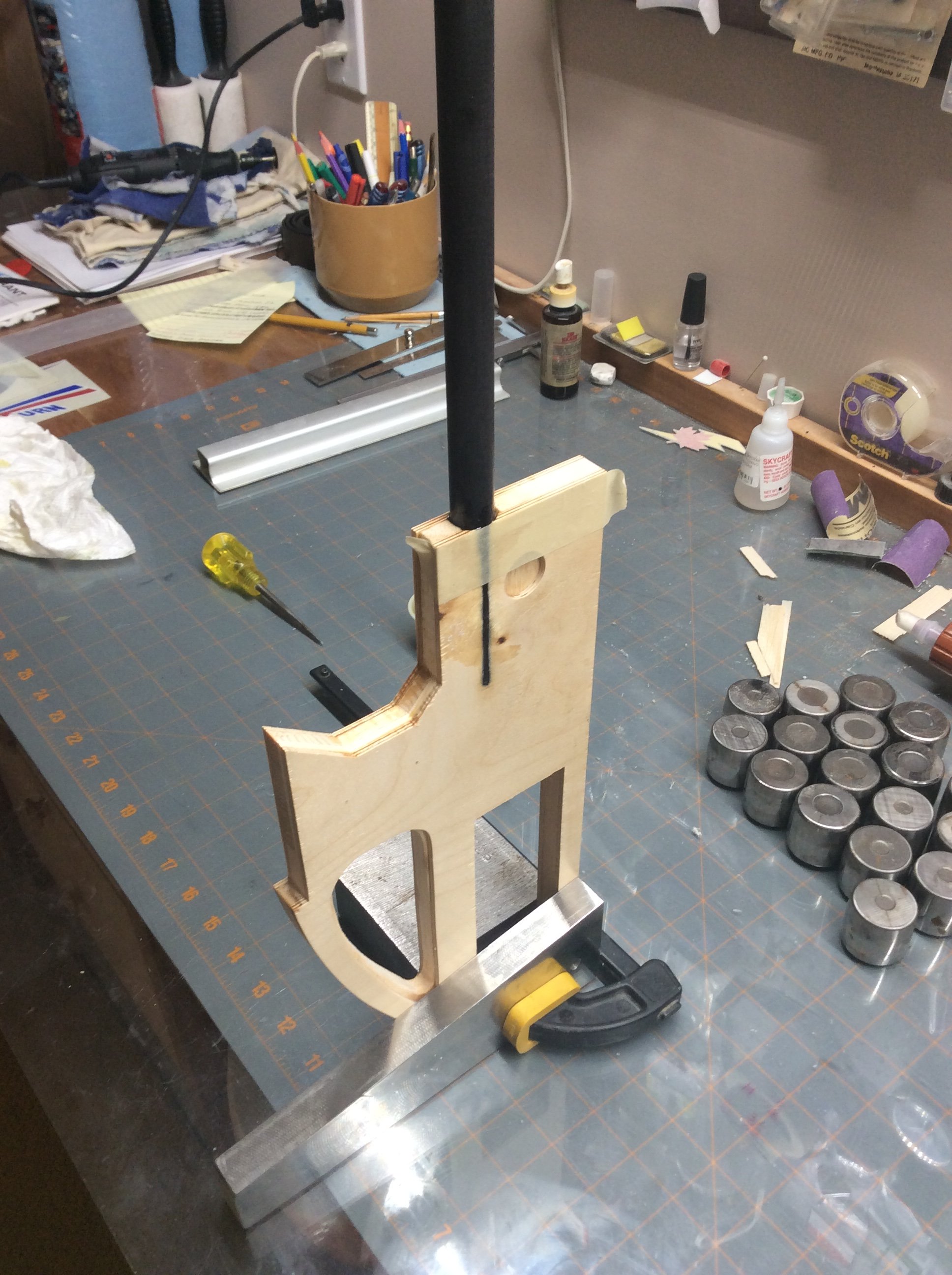

The carbon tube is glued into the motor mounting plate. That took quite some time and had to keep plugging tiny little holes the epoxy seeped out. Stood the part up and then keep filling epoxy into the top until it stooped disappearing. That took awhile but had to make sure that the tube and motor plate were connected properly.

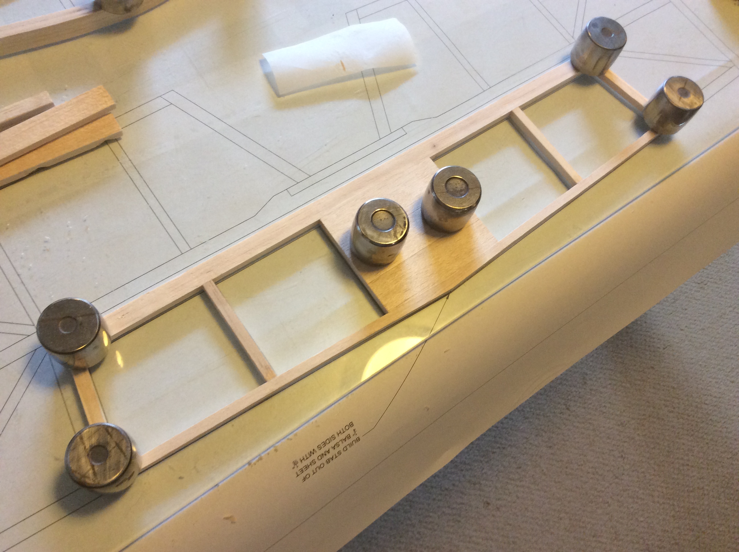

Did you just bend the LE stick to match the angle on the center support? If so I like it and will try that on my next build. I have always just cut and glued two separate sticks.
Helpful hint for when you build the elevator. Have the tristock on hand you plan to use in the hinge line area. Use a couple scraps of it to properly space the elevator and stab apart. Also use a straight edge along the LE of it jutting out just a bit so you can lay your LE sticks on the counterbalance right up against it and then it will all perfectly line up. Along the same line whatever you want your gap to be between the side of the stab and the counterbalance just lay some scraps in there to keep an even spacing.
