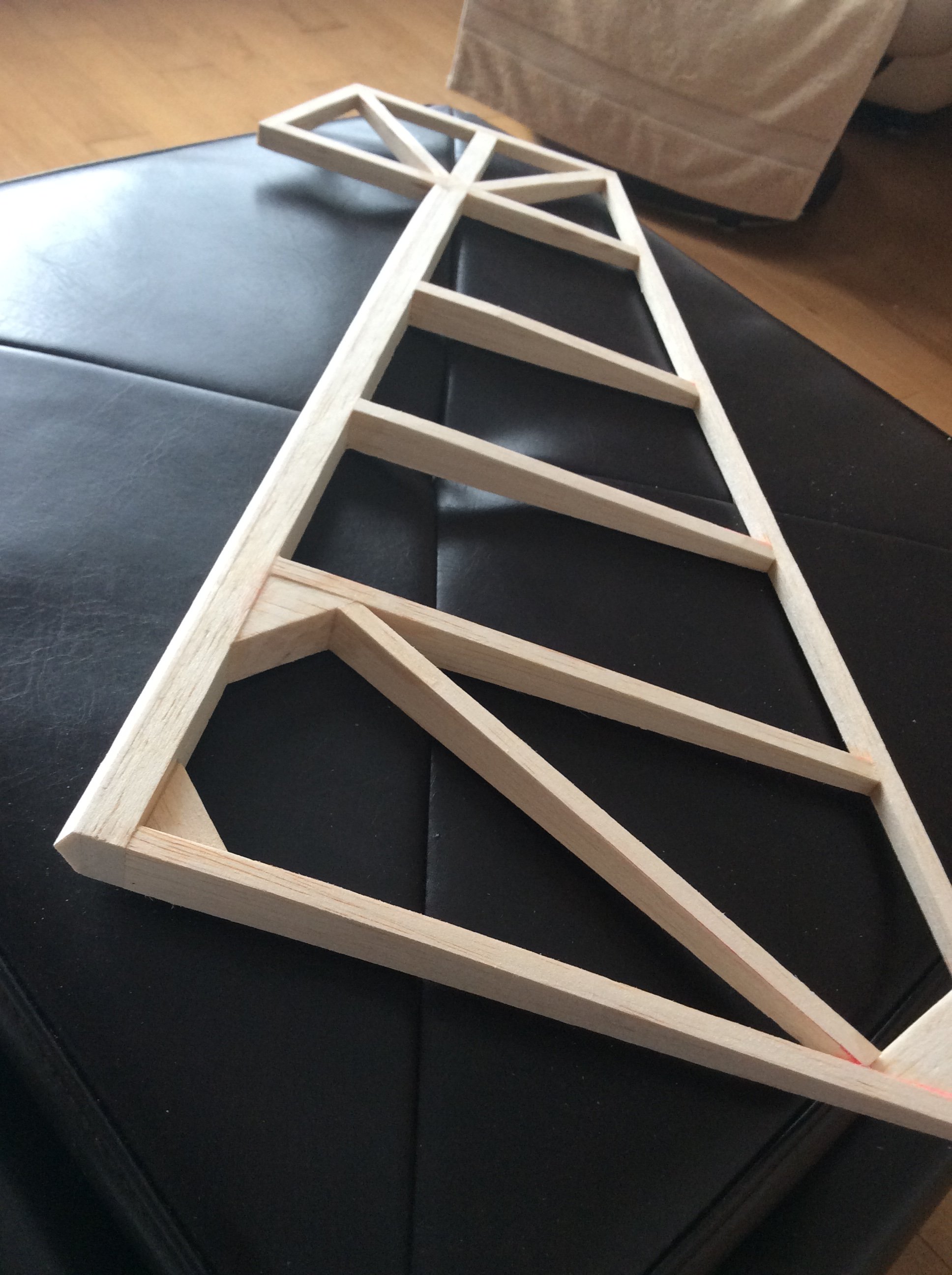

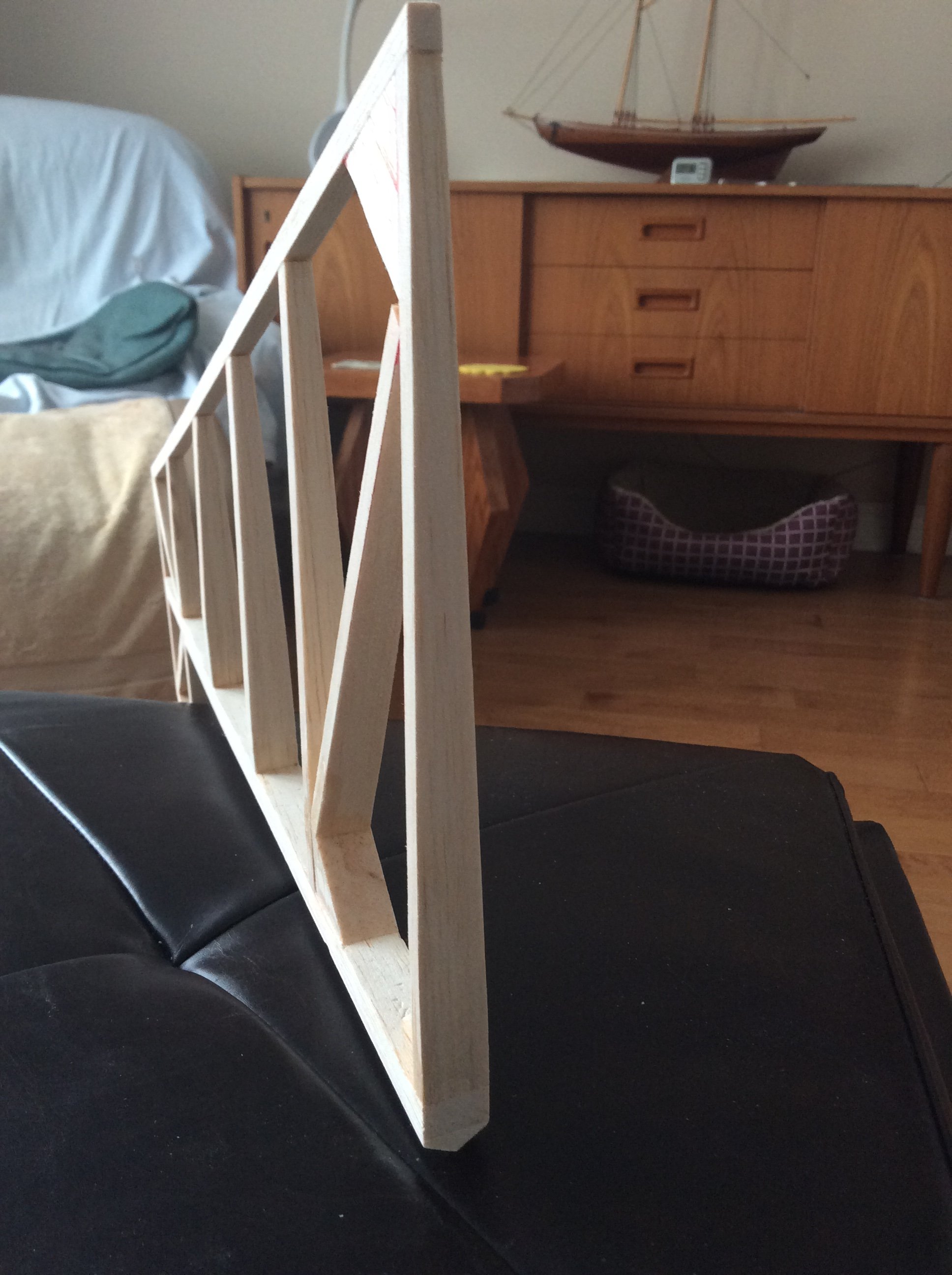

That did not take me to long but the hard part is not done now I have to match the fuselage to the rudder. The rudder tapers from 5/8 down to 1/4 around the perimeter.
View attachment 112675 View attachment 112676
So this was one thing I really wanted to do with mine. Airfoil the tail. I was going to copy an airfoil from one of my 3D birds and scale it down to fit this plane.

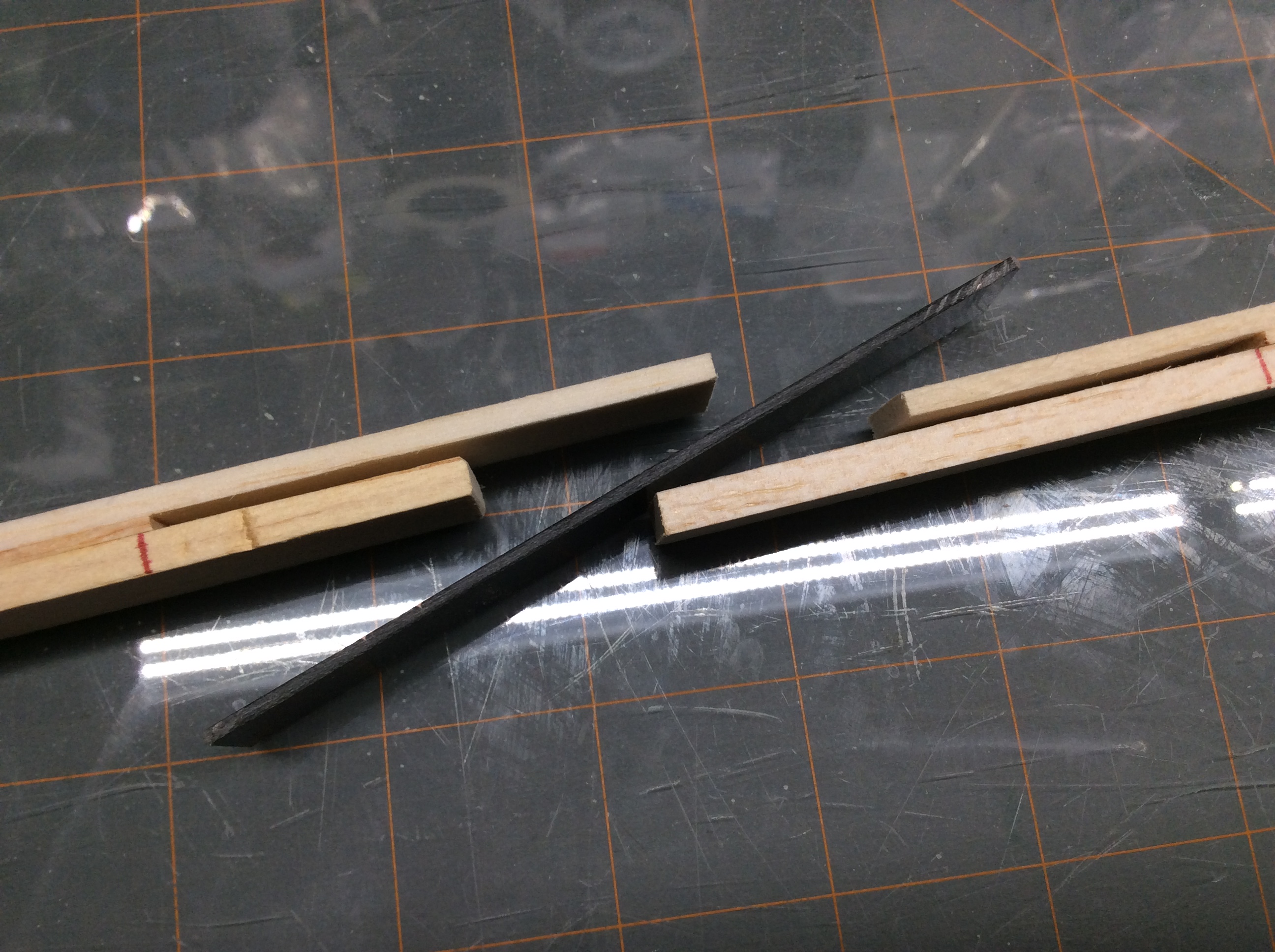

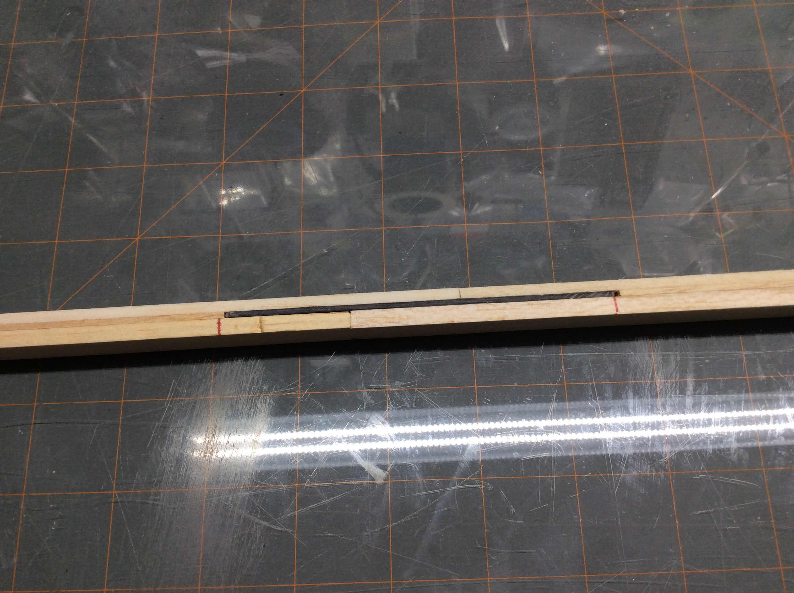

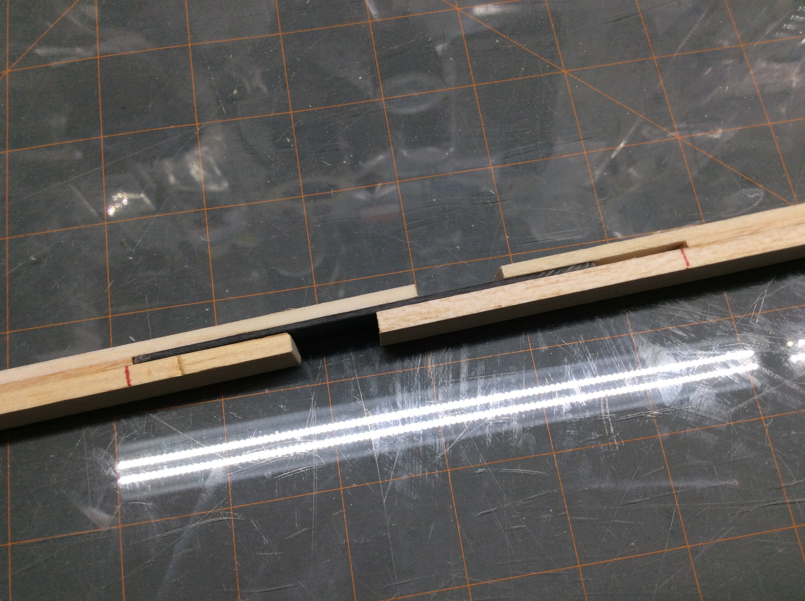

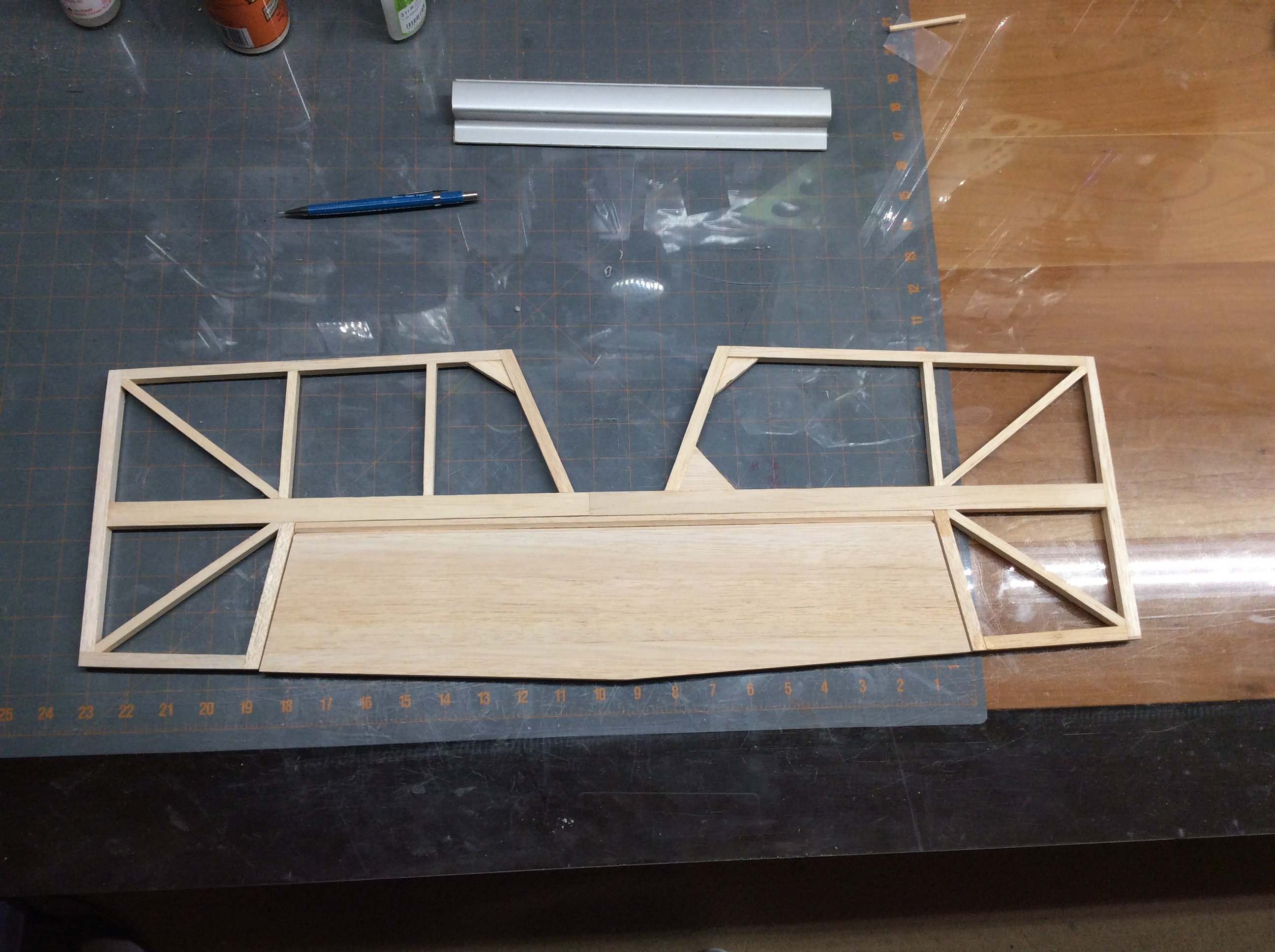

The elevator will be split. Will be finished in two halves and slid together, glued and the centre section covered carefully, then the hinges glued in. Pictures to follow once it starts look like something, it is just a pile of sticks at the moment.
Finished the leading edge of the elevator and looks as follows the pictures tell the story.
Once covered some epoxy in the slots then slide together and let it harden.
