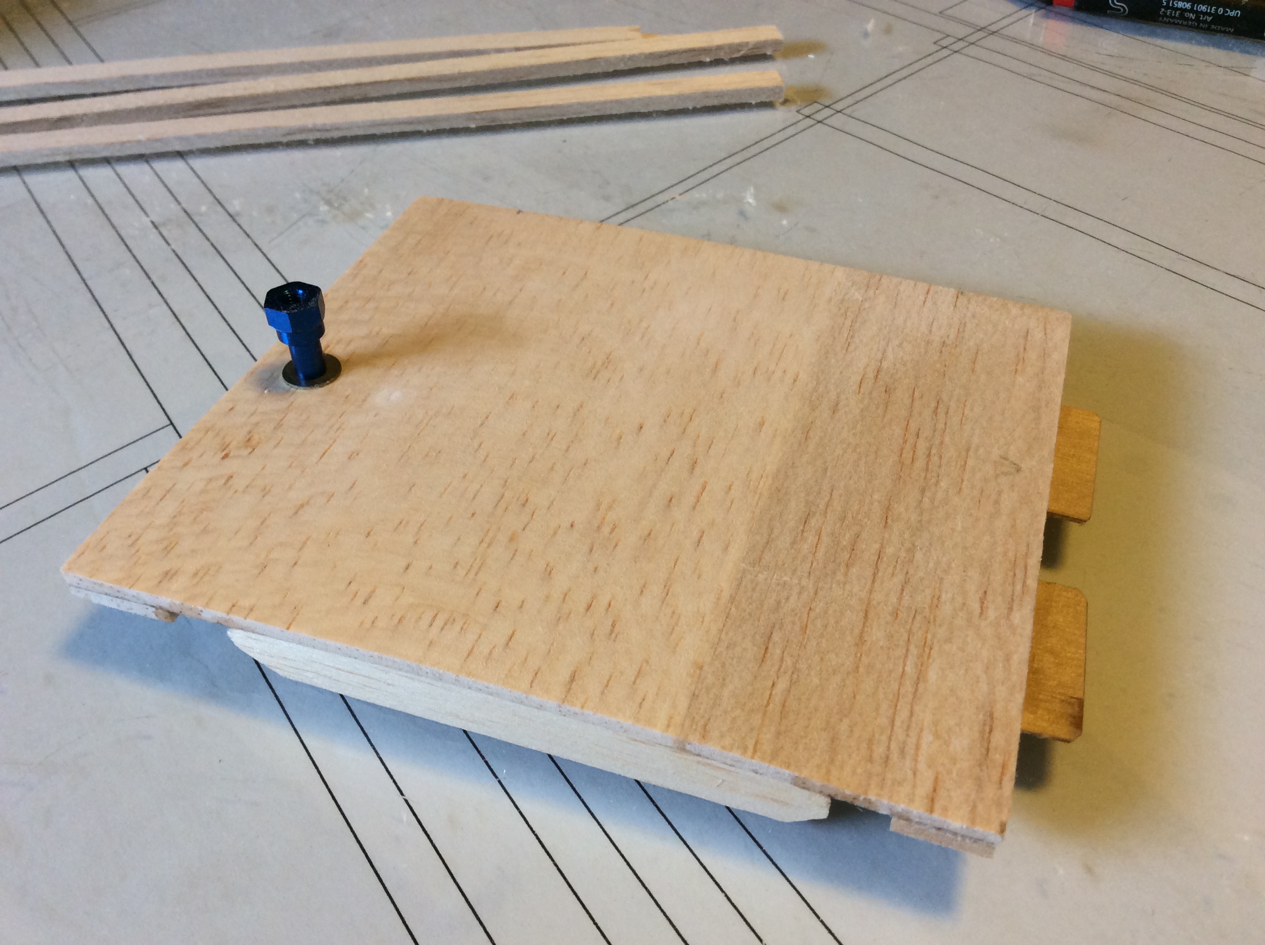

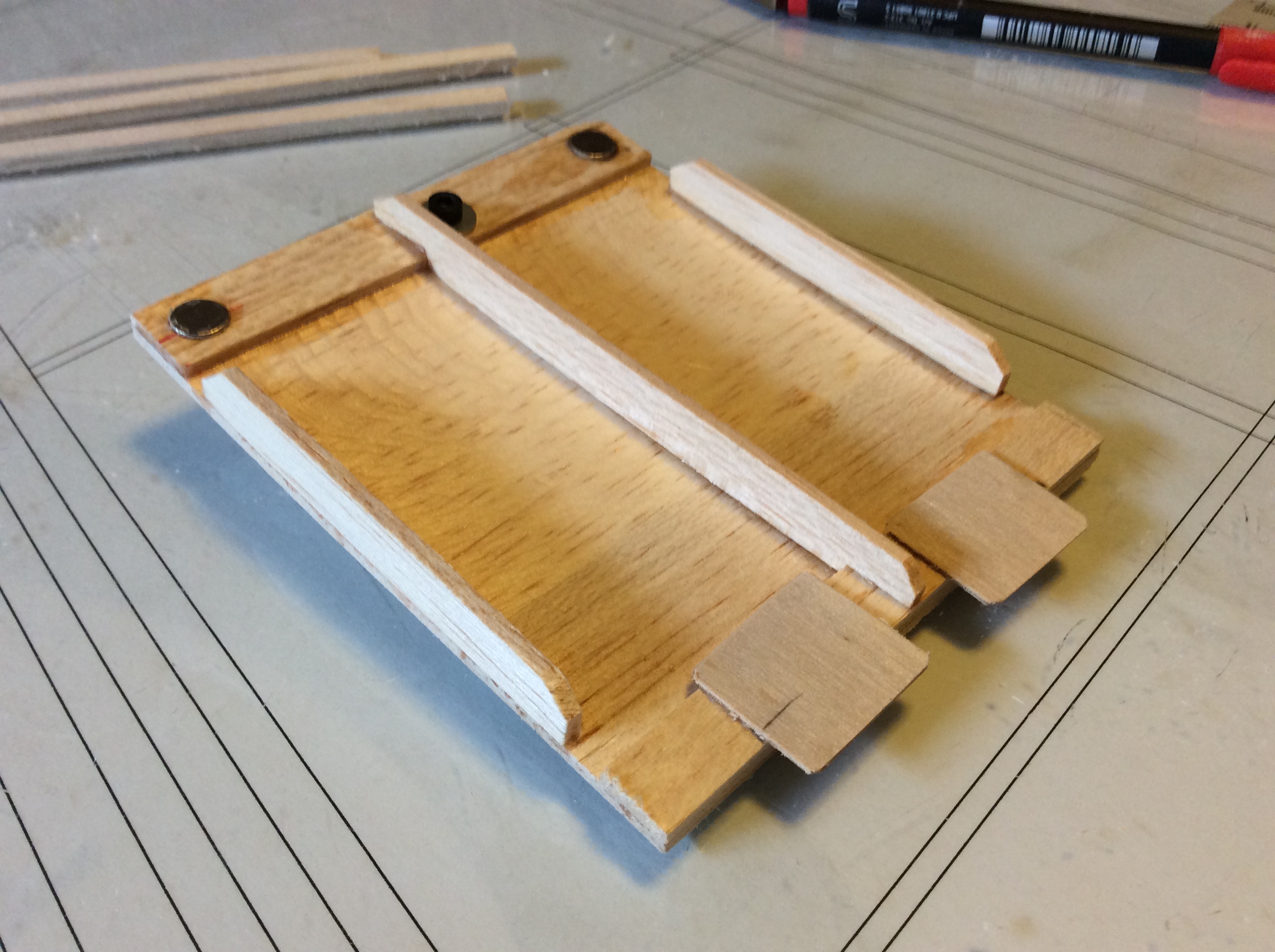

The door is all made up, what a pain to build it trying to get the door to match the curvature of the wing but got it done. It looks Correct when on the wing. Decided that I will use only one access door on the left wing I think I can make everything work using one compartment. The door will use four small cobalt magnets and no screws so that it is easy to open it at the field for charging and turning it on and off , on switches. Saved a tiny bit of weight again keep trying.

Just a picture of the hatch, took a full day to build and fit the wing curvature.

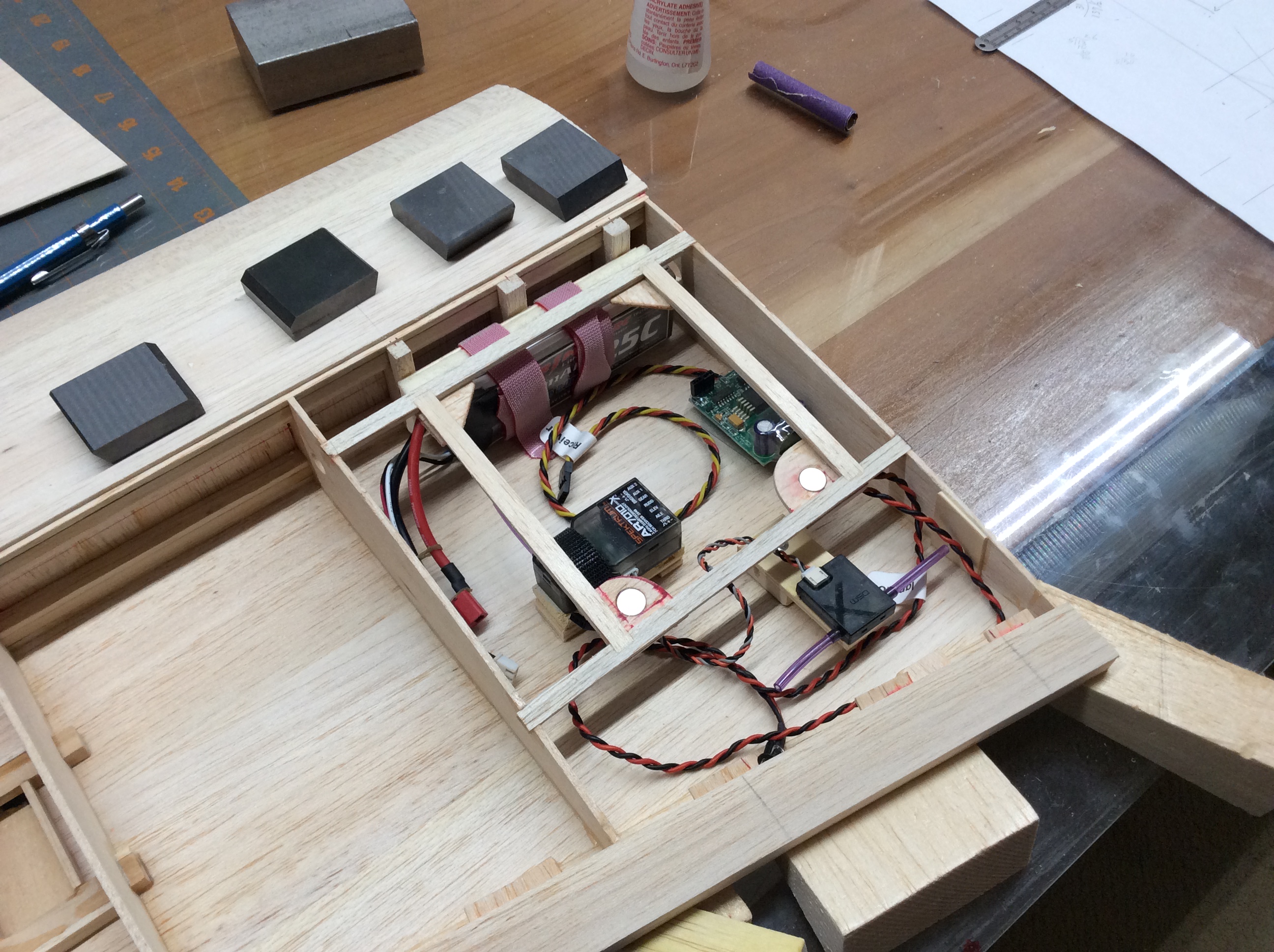

Thought I would install all the mounting blocks while it is a little more accessible. Looks like it all fits ok IBec, receiver, remote and battery pack think I have everything I need to power the plane.
