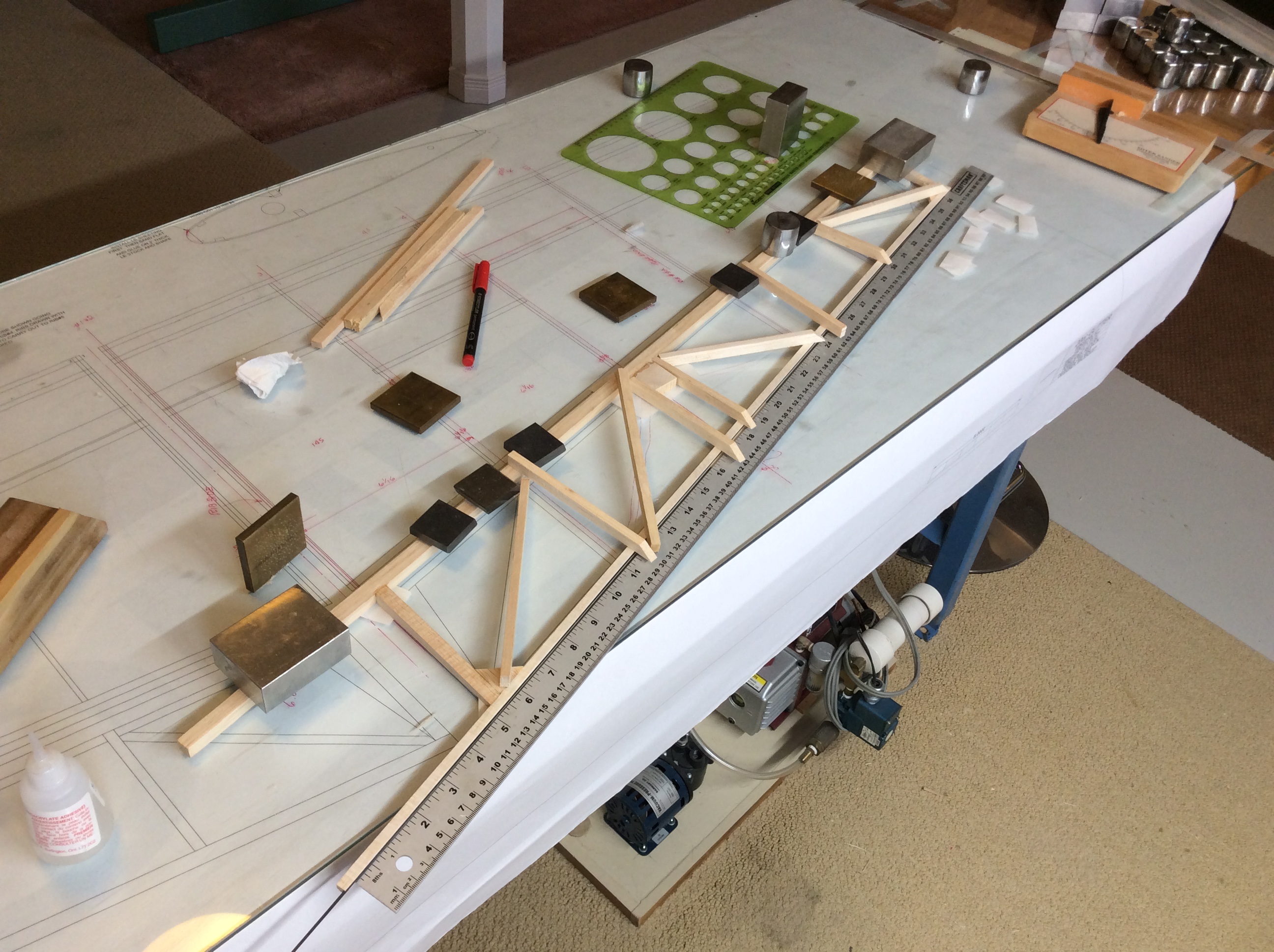

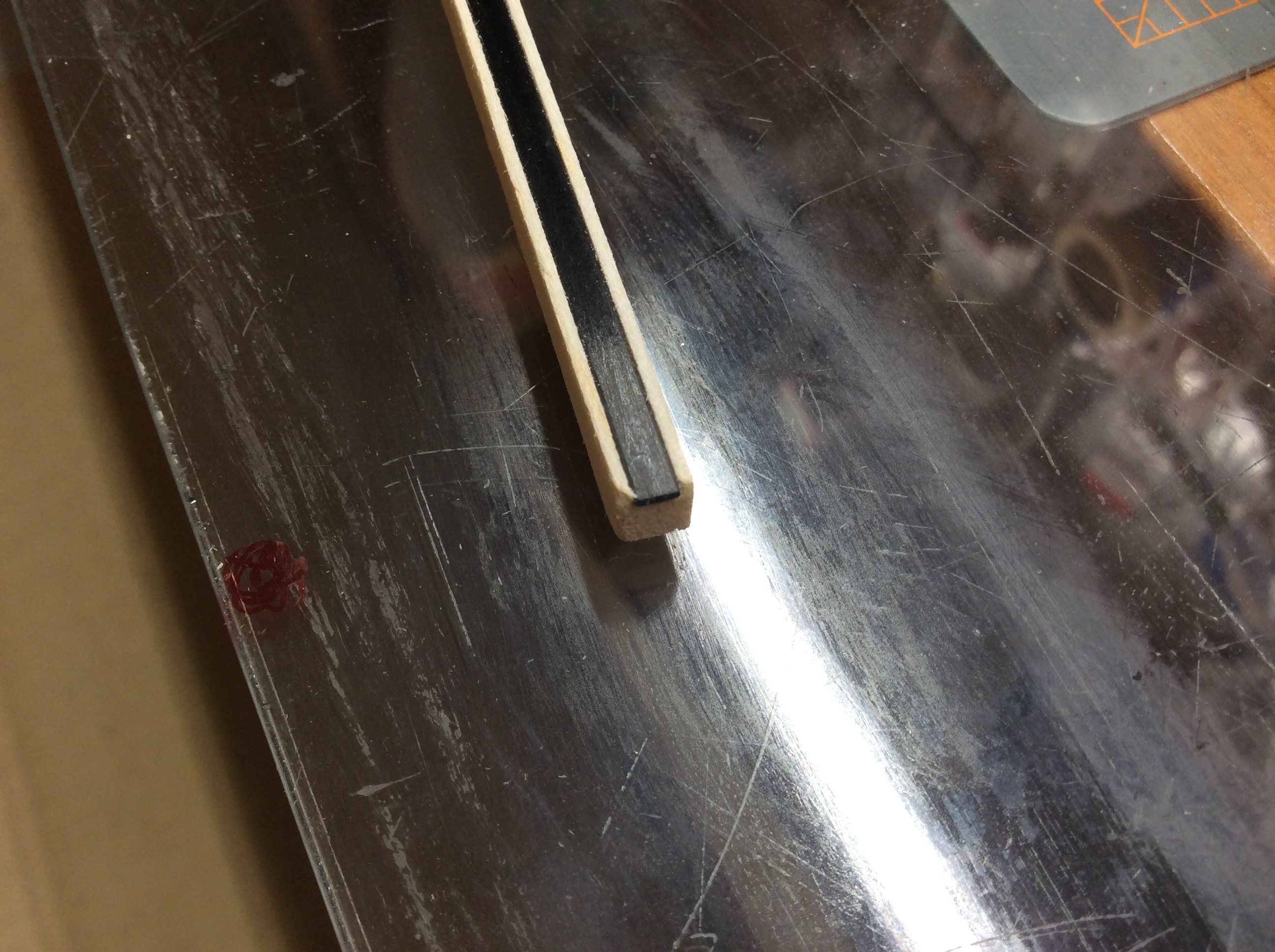

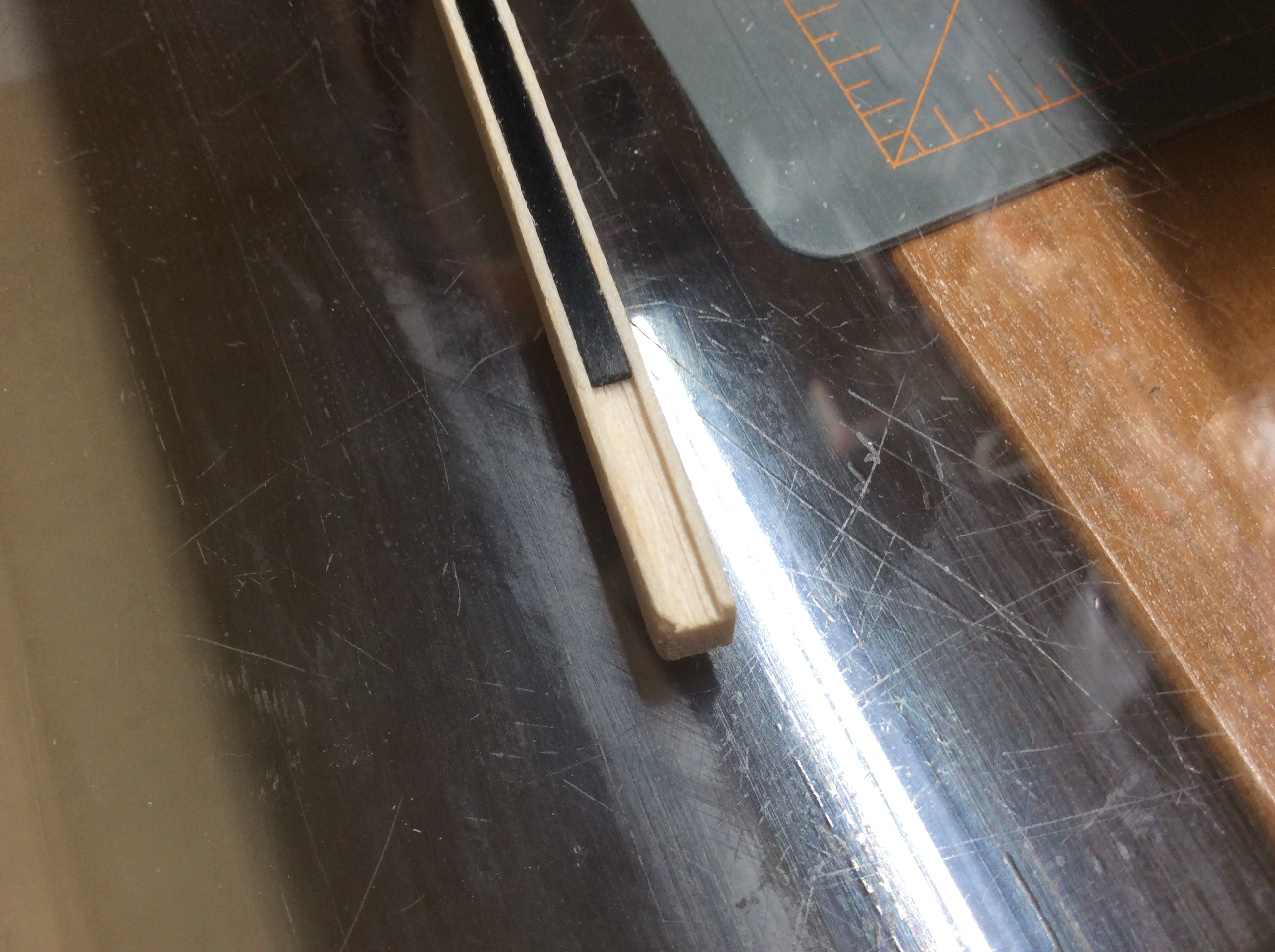

I thought I would try to do this one time and see how it goes. The ailerons are supposed to made from 3/8 square balsa. So at the wing it will be 3/8 to match the wing it is actually a little bigger. But I do not like seeing I nice airfoil wing and flat ailerons. So at the wing it will 3/8 thick and the trailing edge of the aileron it will be 3/16 thick. So I have made up a special trailing edge as you can see. It is 3/6 thick and a groove cut into it to insert a carbon strip to give a lot more strength. And hopefully a lot more rigid, and a lighter aileron.

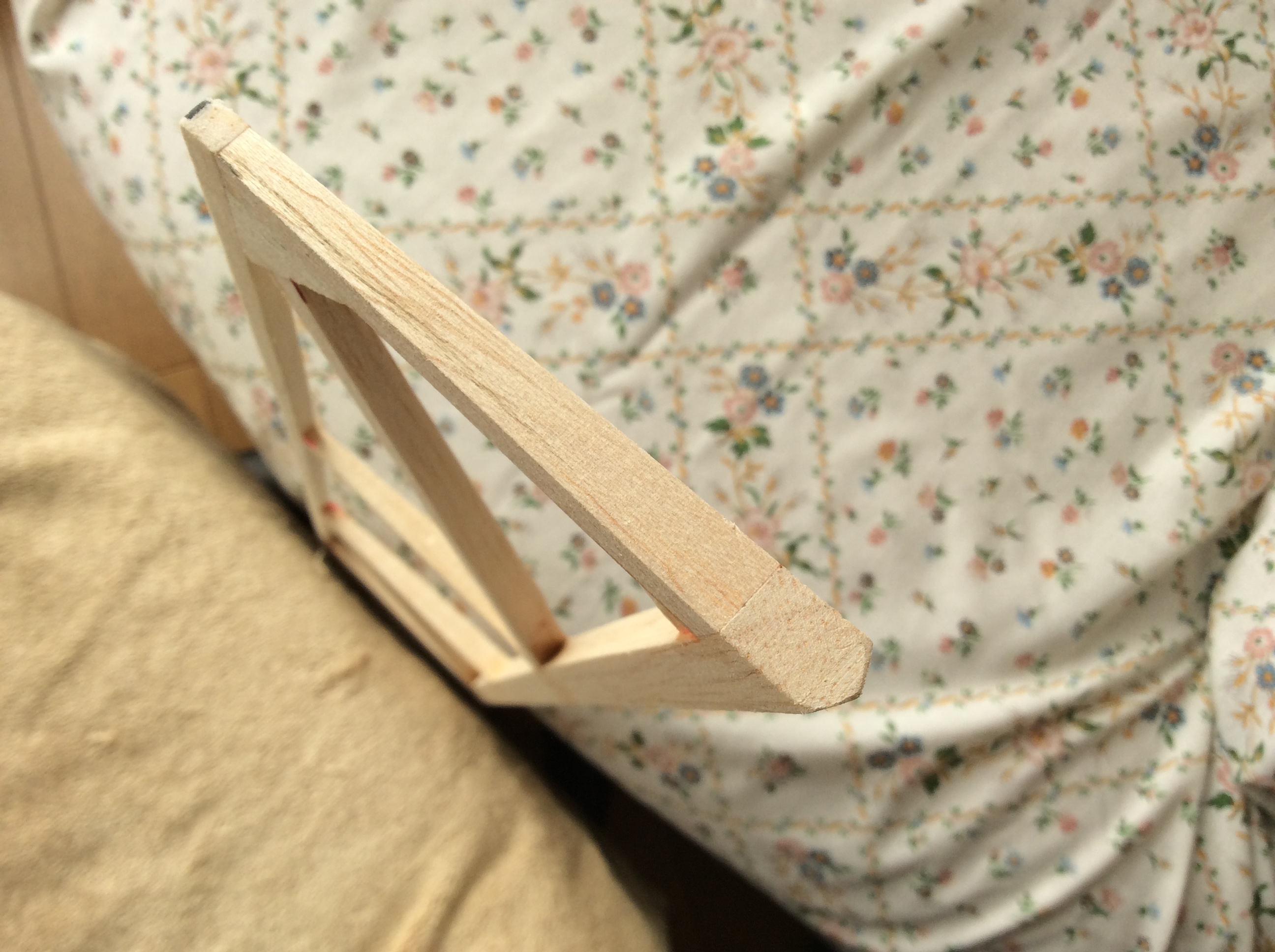

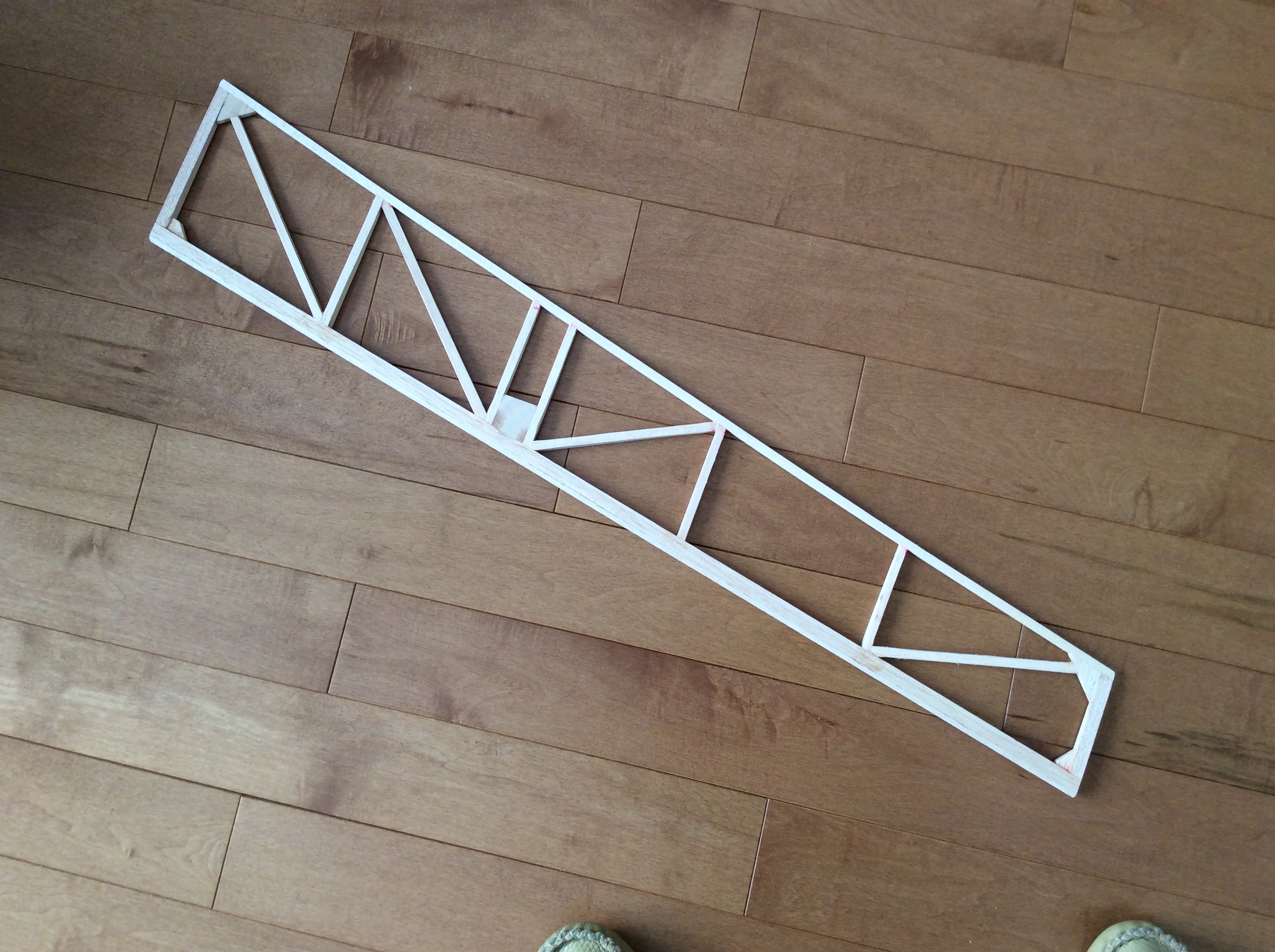

The aileron is built and sanded, it is a lot lighter but it took a little work. It is 3/8 thick at the leading edge and just under 3/16 at the trailing edge. Do not know if I will add the missing diagonal brace it just looks like I needs to be there.

Looking good Snoop, I would add the extra bracing.

Have agree I will add the last brace just for looks.
