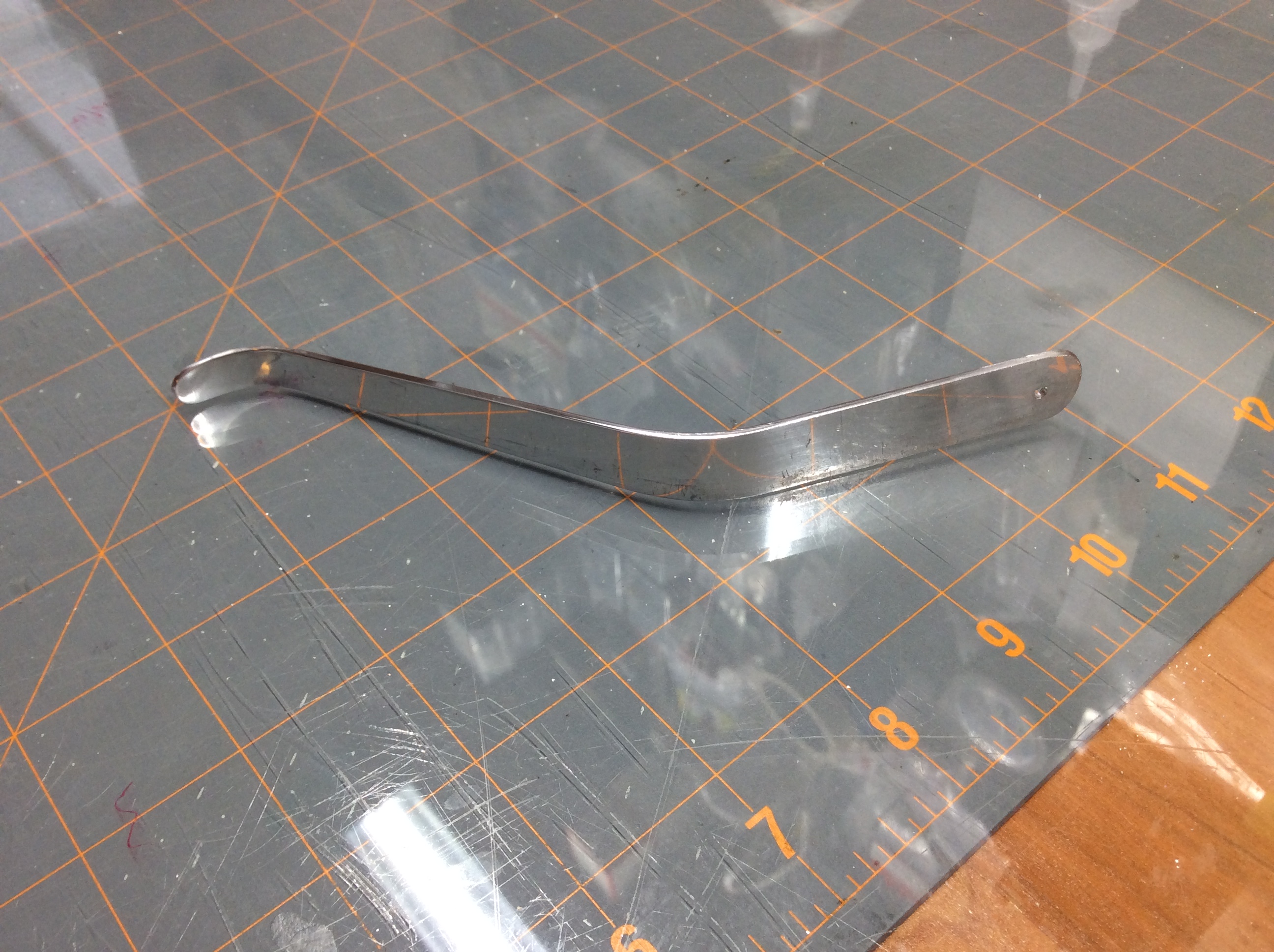

Thanks for that yes it looks simple, effective and light weight. I guess I will be build an aluminum tail skid tomorrow or sometime soon.
The tail skid is made not sure if it is strong enough but time will tel. Can always add a stiffener leaf if needed, time will tel. Just trying to keep the plane as light as possible. It only weighs 10 grams.

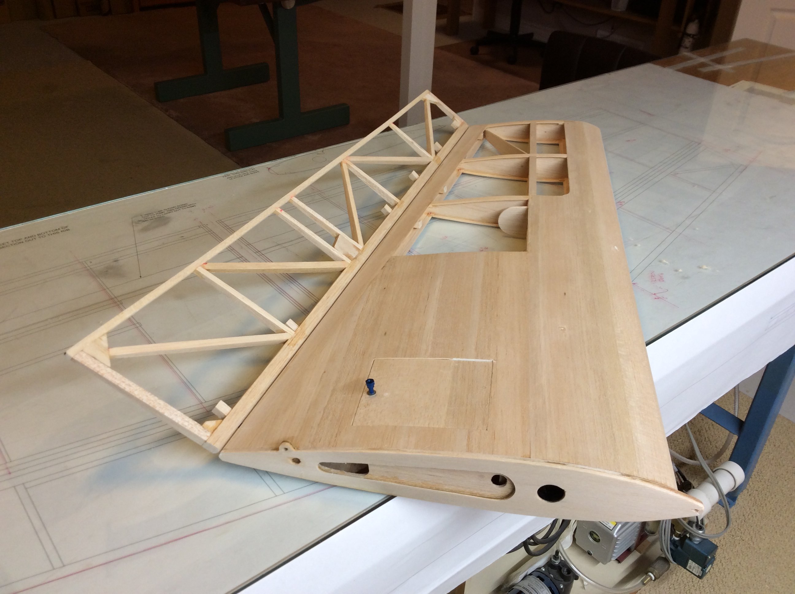

Ok got one wing hinged now just have to do the second one just not looking forward to that hope I get it done tomorrow. It can deflect fifty degrees either way, that should be enough may loose a little after covering. The hinge line looks good and tight.
The second wing is hinged and done. Now all that needs to be done is the Carbon plates add for some reinforcements.

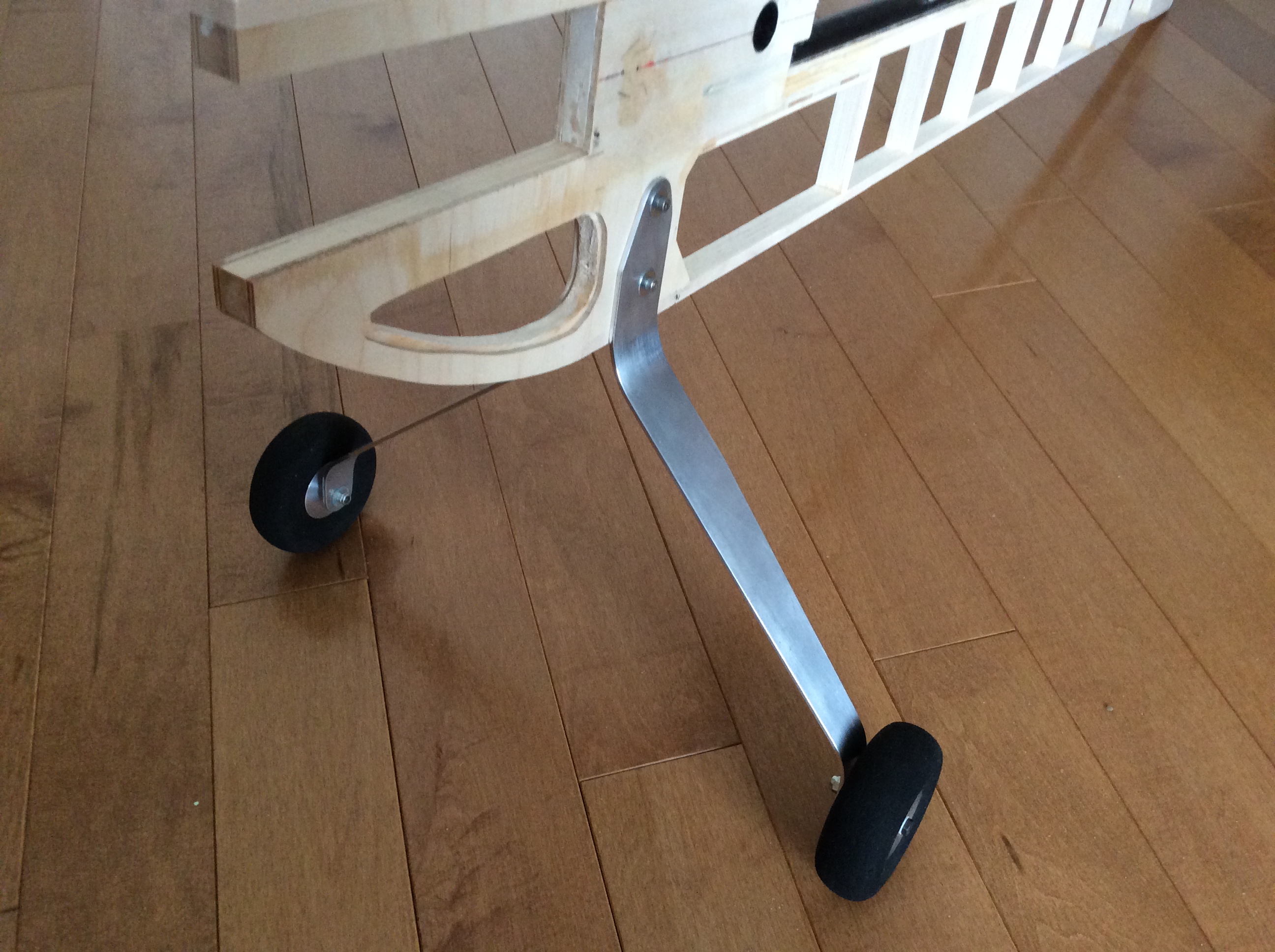

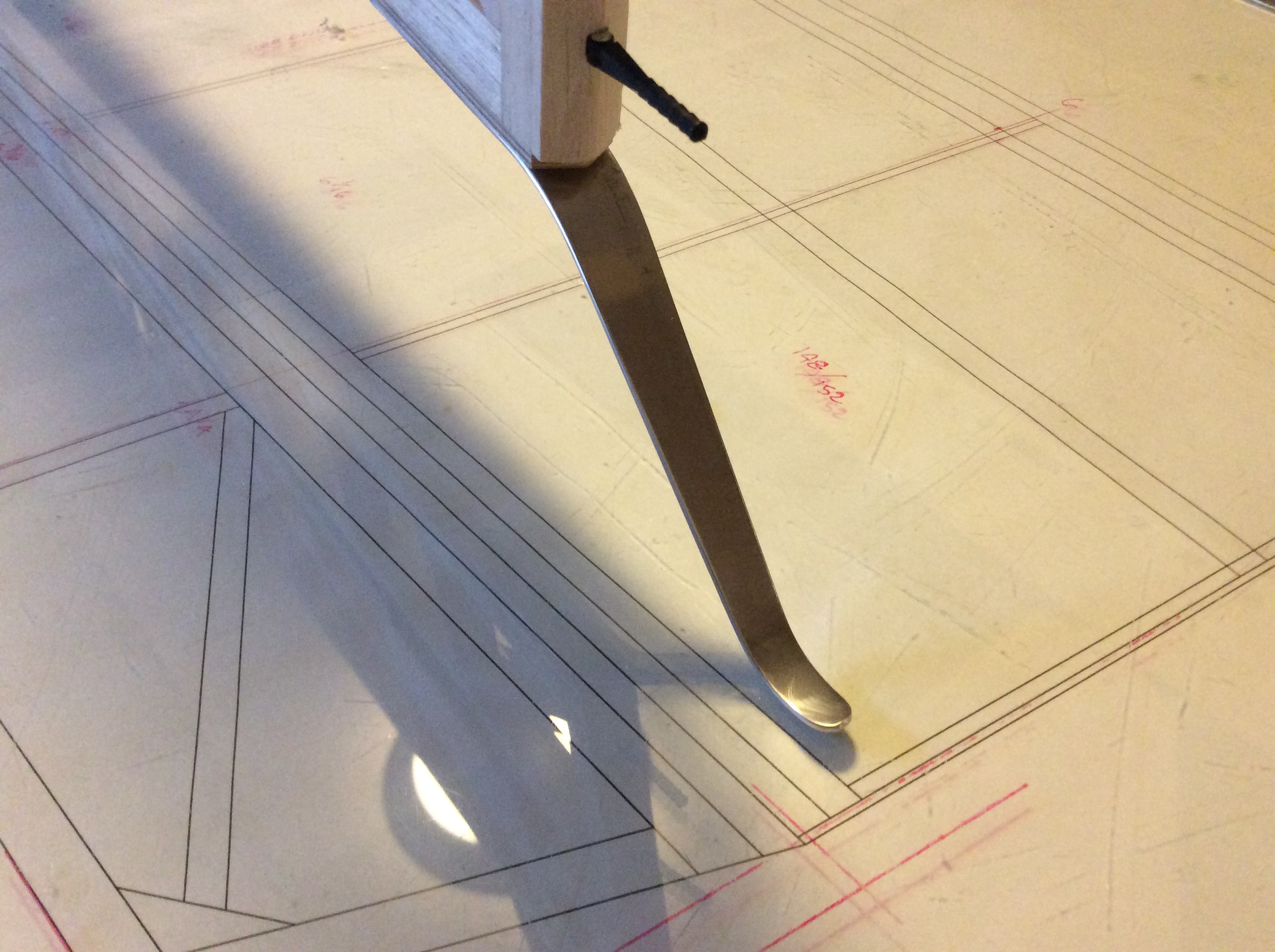

One more thing done front landing gear installed. All the aluminum and hardwood blocks drilled and taped. One job done just have to install the tail skid will install some hardwood dowels to screw into.
