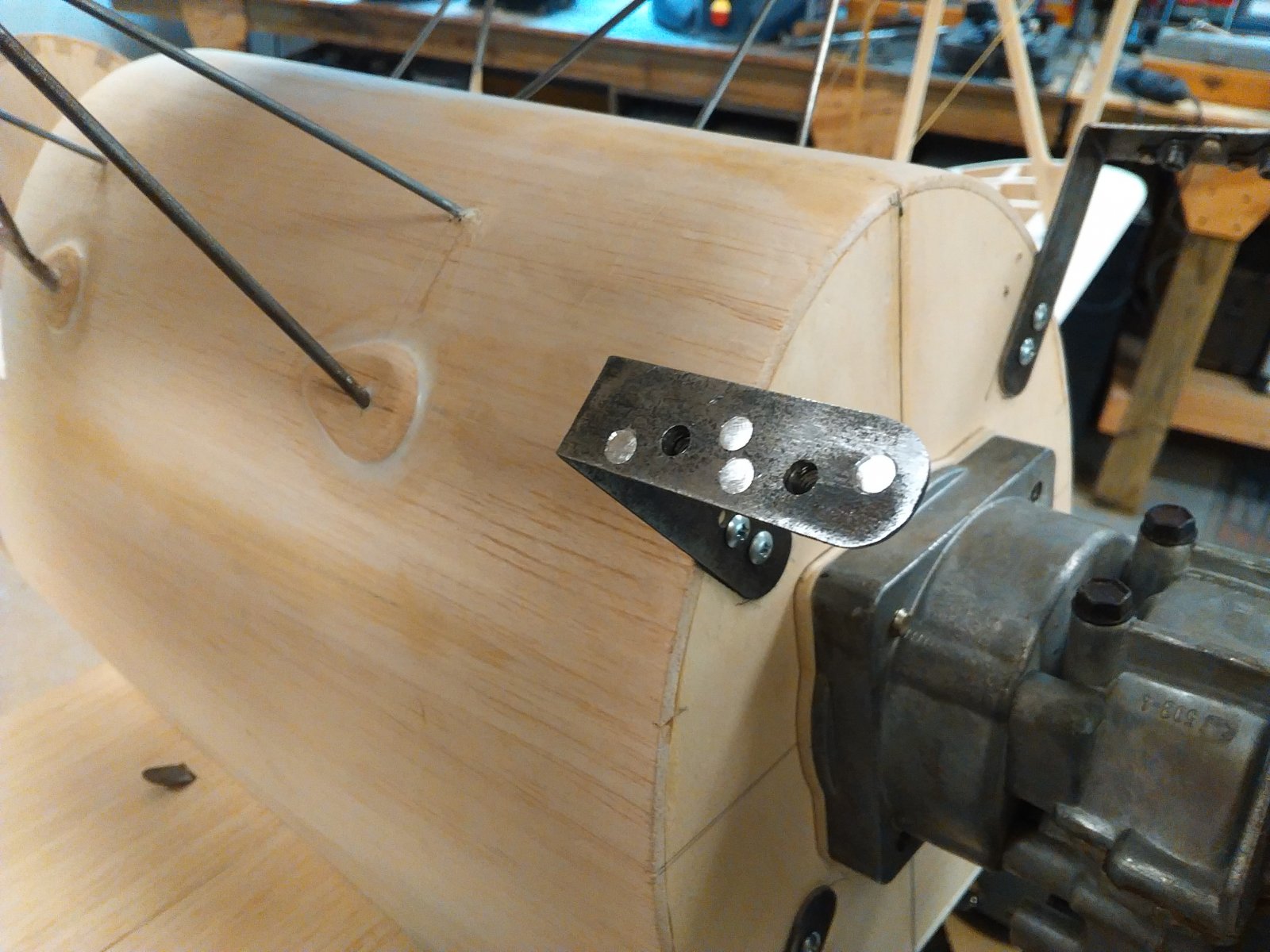

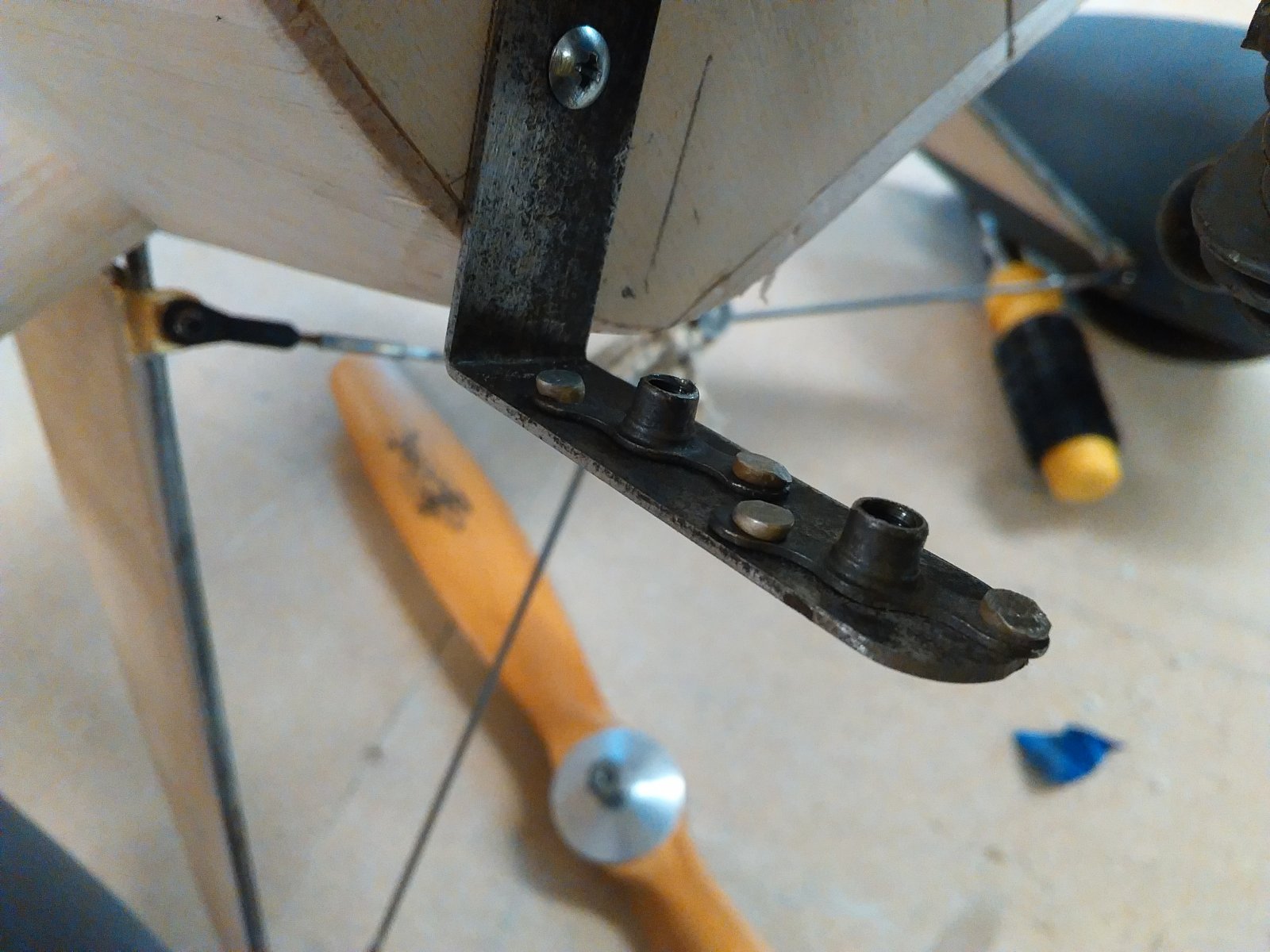

Tonight, I crossed finishing the cowl mounting off of the list. Dad and I got the nut plates riveted to the back side of the mounting arms and I drilled and counter sunk the holes in the cowl for the warshers and screws.
The nut plates in place, these are what are called hot nuts. They lock because the bottom of the hole is actually egg shaped. I think they call them hot nuts because the screws get hot as h*ll when you put them in and take them out lol.
The nut plates are flush riveted to the mounts so they sit against the cowl with no problem.

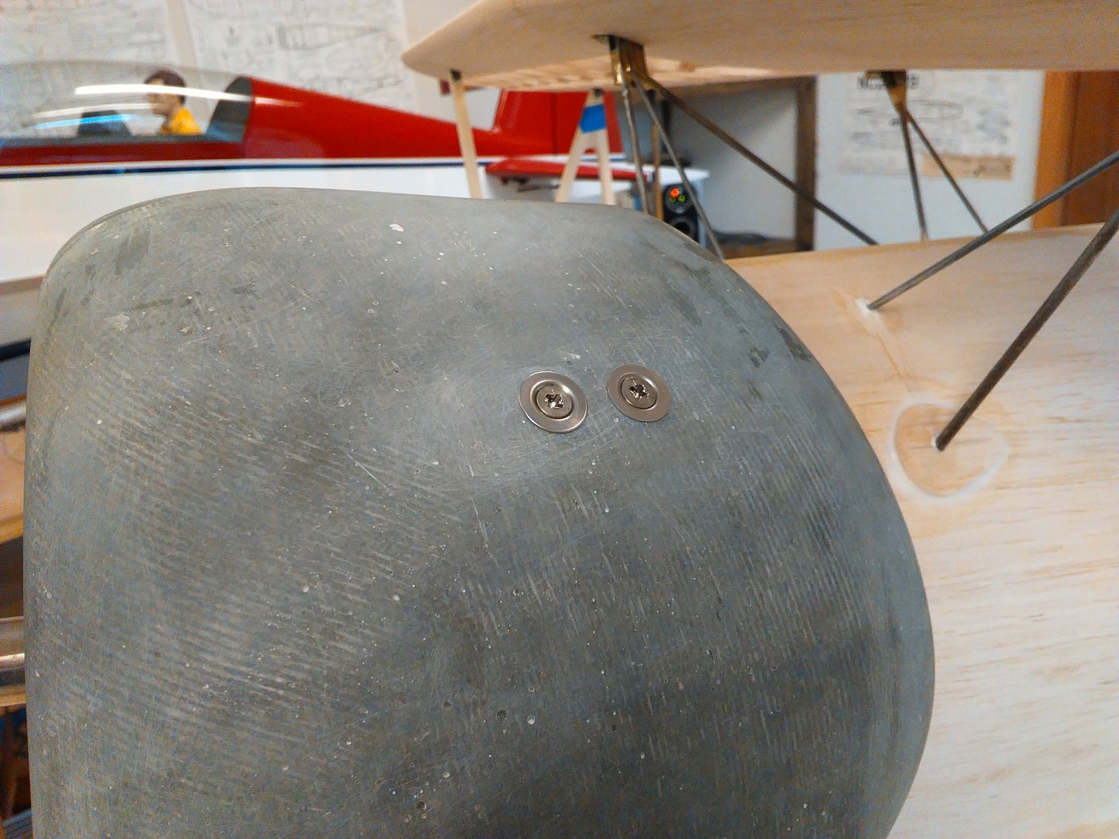

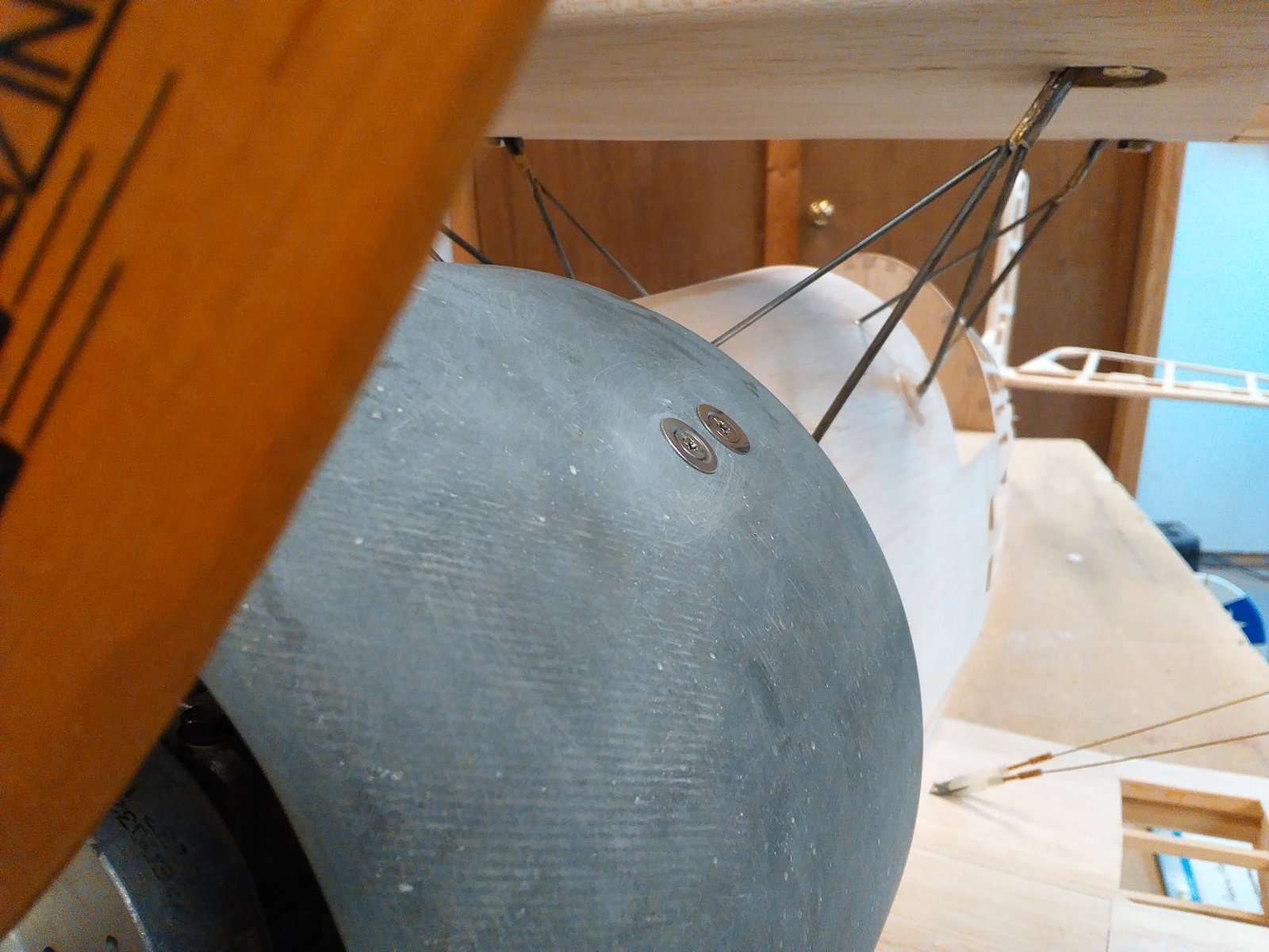

The #8 machine screws and 100 degree flush washers that hold the cowl on.
The screws and washers sit nice and flush with the cowl, I mean there is already enough drag on a biplane, no need for the cowl screws to cause more! :D
