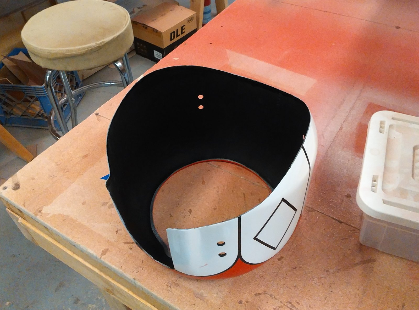

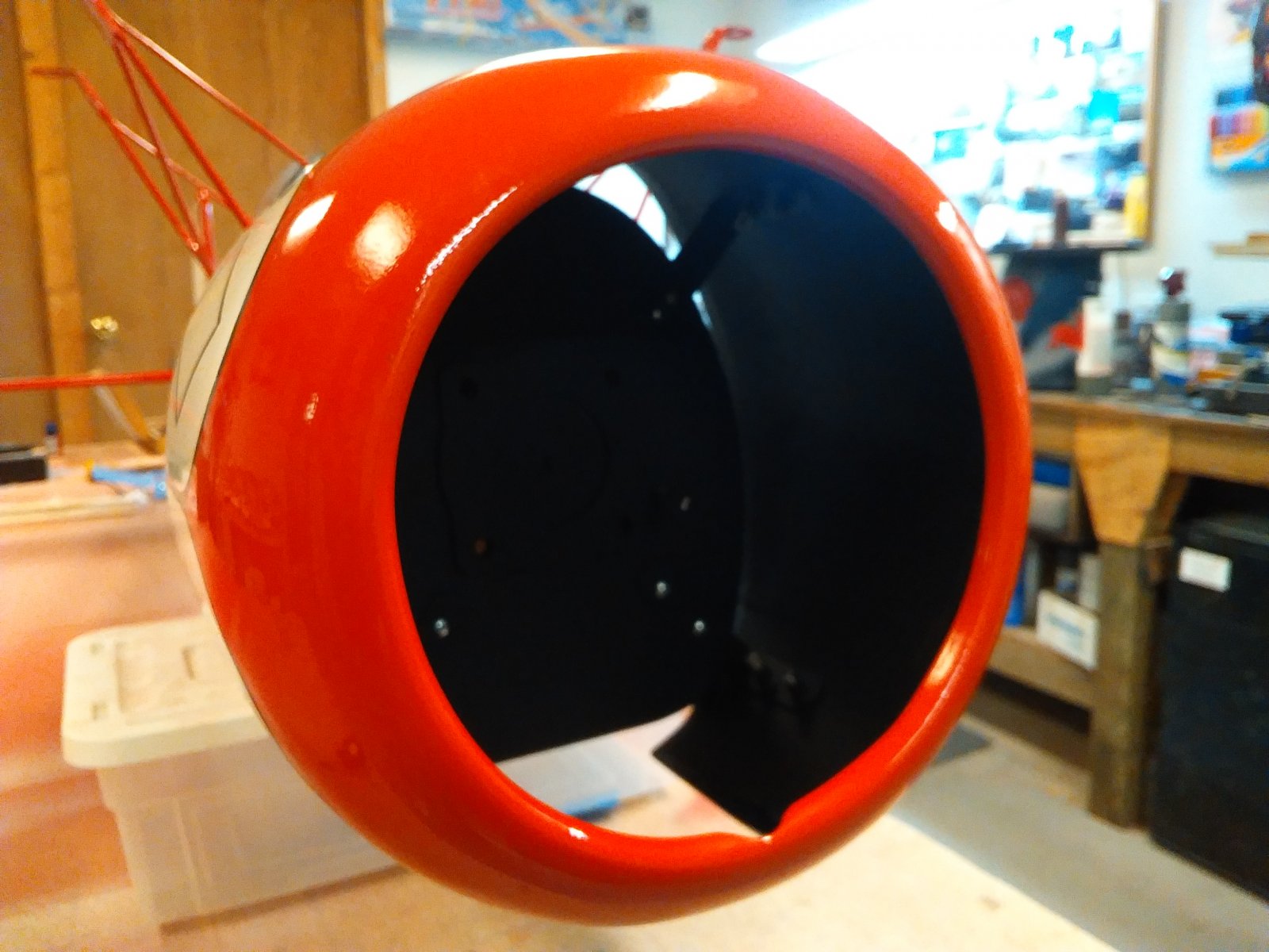

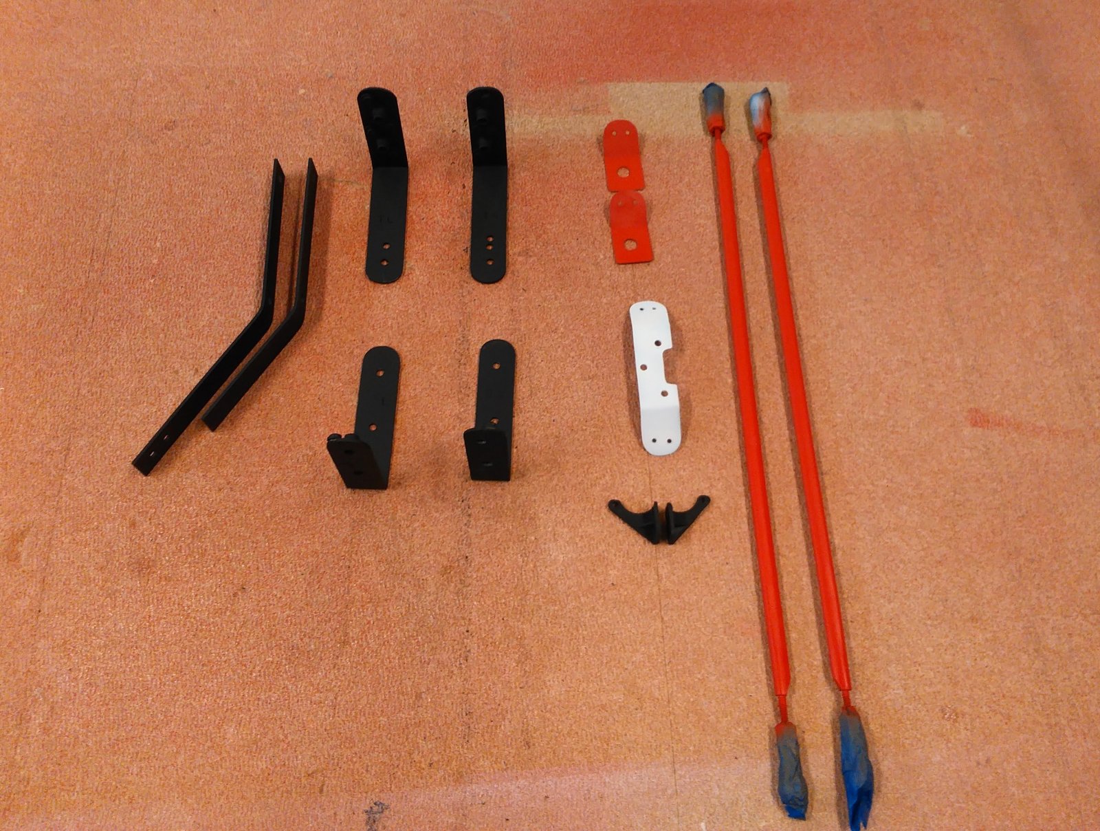

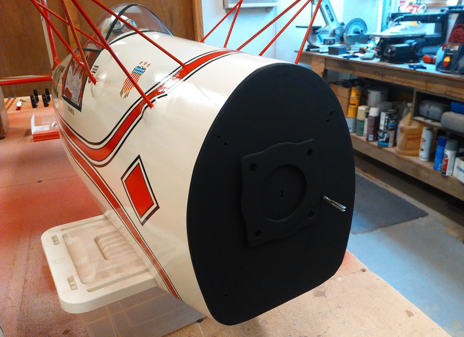

Finishing the last little bit of painting. I painted the firewall, cowl mounts, the inside of the cowling, tail wheel bracket and tiller arm flat black. I then painted the upper landing wire tabs, and slave struts red as well as the bottom tail brace wire tab white. The slave struts and tabs will all be cleared tomorrow.

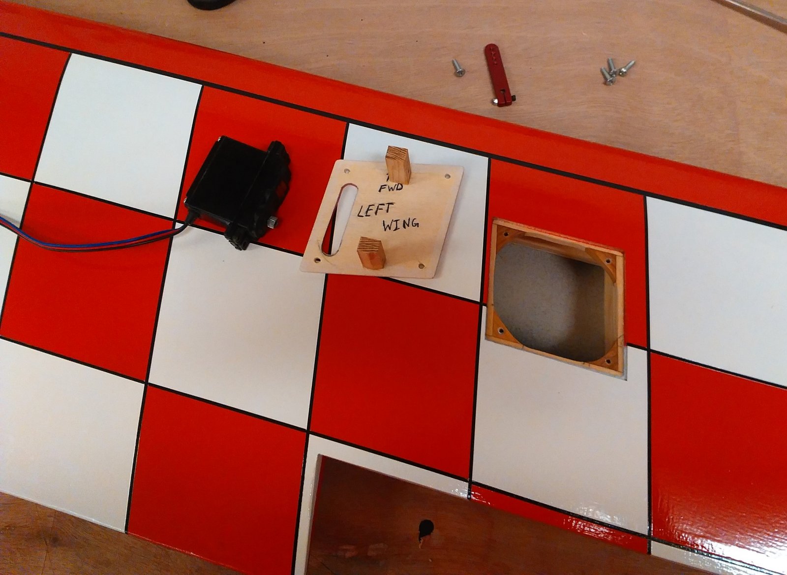

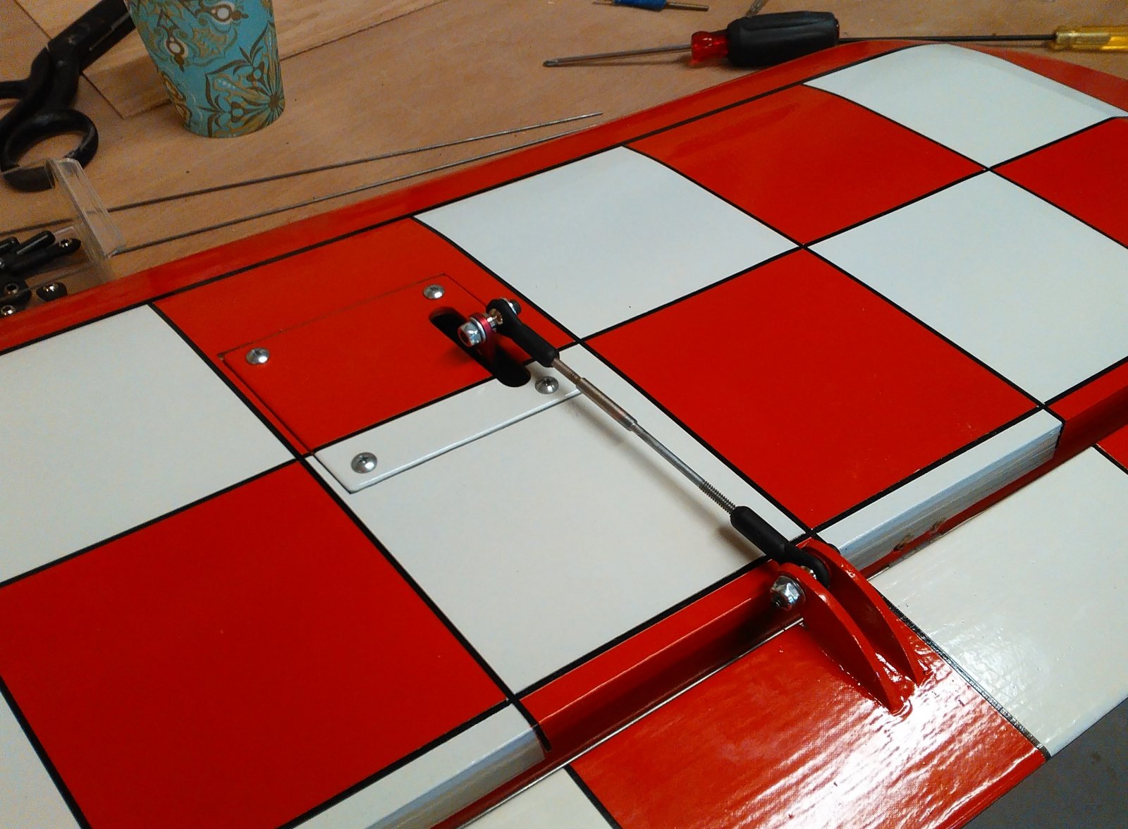

It's really fun to be putting stuff together for the last time lol. This evening I attacked the aileron servos and the bottom ailerons.
Extensions made, and everything gathered up and ready to start.

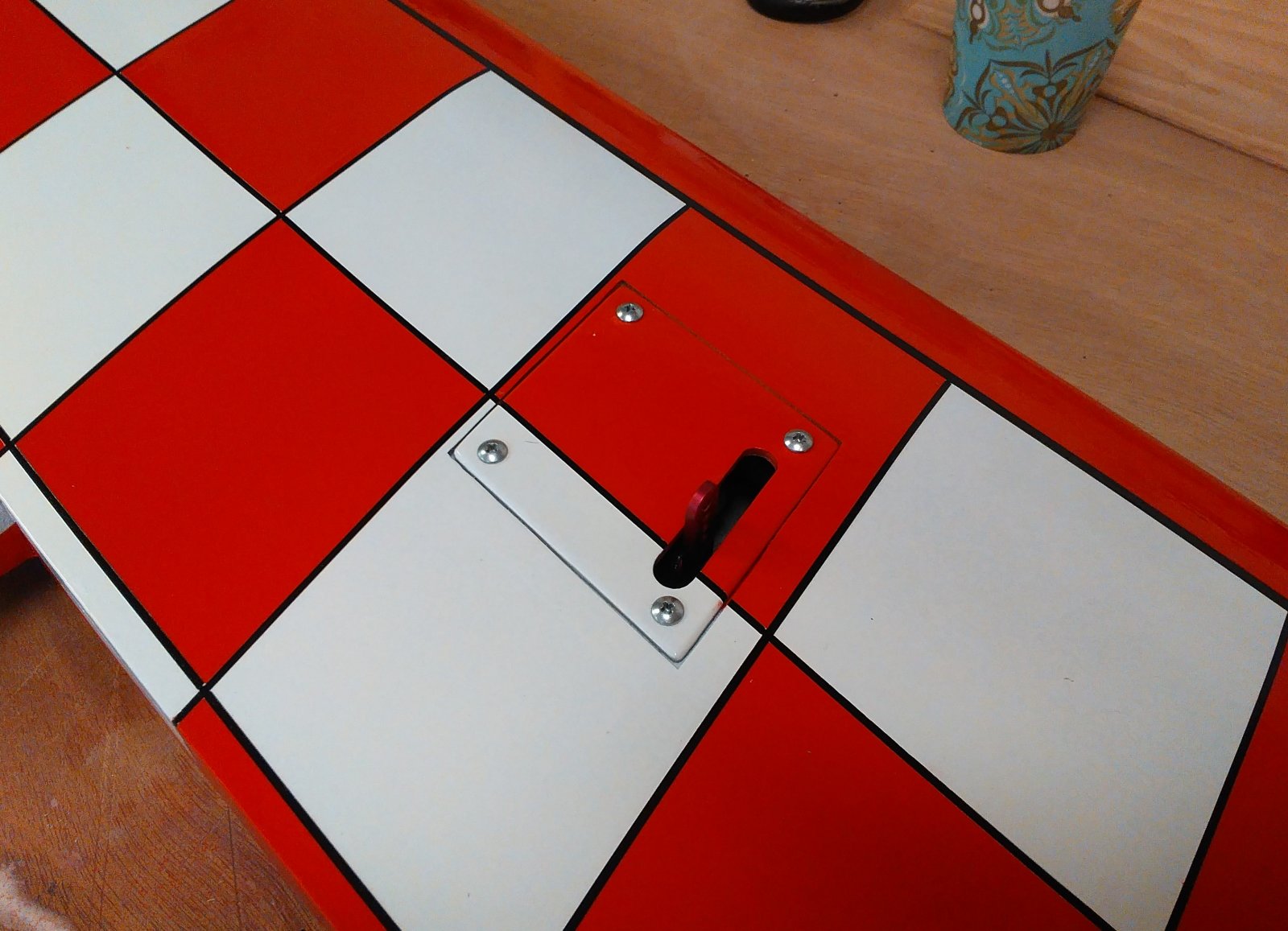

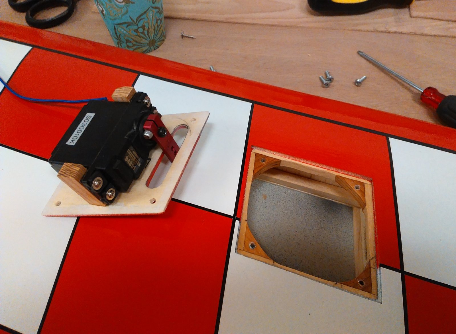

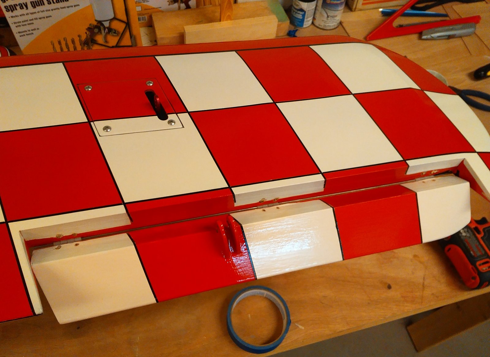

Put the servo back on the hatch and thought I was going to have a big problem. The pocket for the servo was always tight, but the 94851 is less than 1/8" taller than the 94702 I used for mock ups and because of this the hatch wouldn't sit down all the way.. Luckily, a little grinding with the Dremel on the corner gussets of the pocket gave me enough room that it slid back together.
Ready for the aileron and push rod.
Pinning the aileron hinges in. I'm just using tooth picks for the pins glued in with CA. Once they are all done and CAREFULLY sanded down flush, I will dob a little paint on them and they will all but disappear.
Both ailerons are pre-rigged and ready to hook up to the RX and program :) Tomorrow I'm going to work on making the bungee cover out of some black leather, and finishing up the landing gear which still includes making bushings for the wheels, trimming the axels to the proper length and final assembly of the wheel pants.
