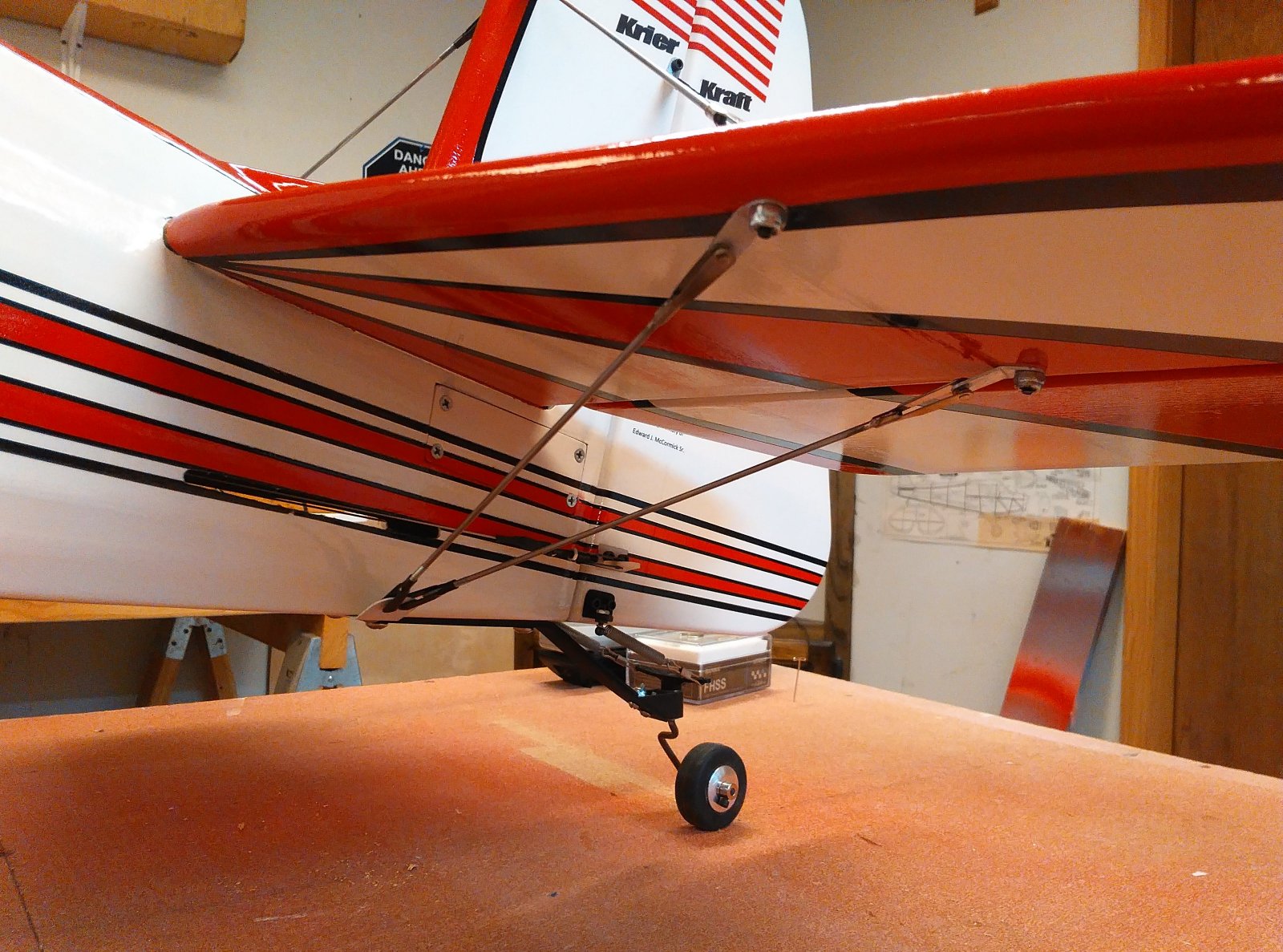

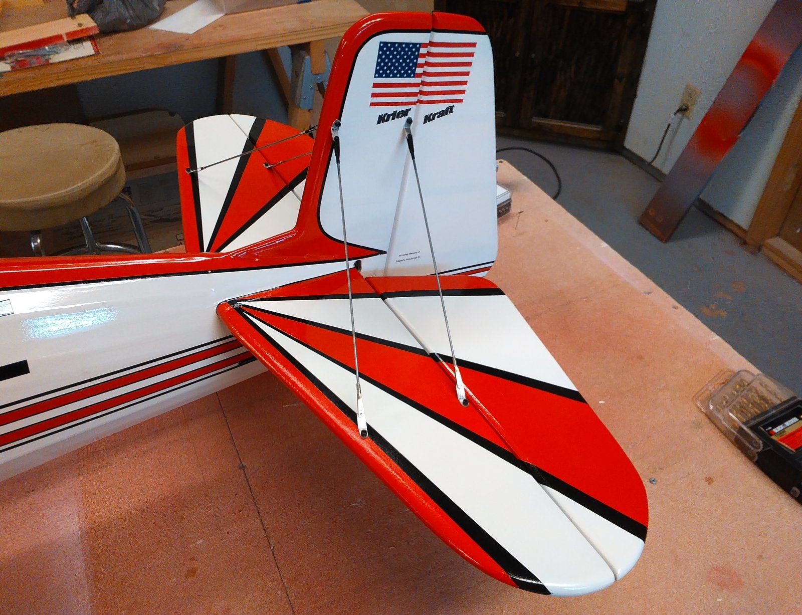

This evening I got the tail brace wires made. They are made out of 2-56 threaded rod, with Dubro steel clevises. I made the tabs from .032" aluminum.
The tail brace wires on this model are functional, It would have taken a lot more structure in the tail to not need them.

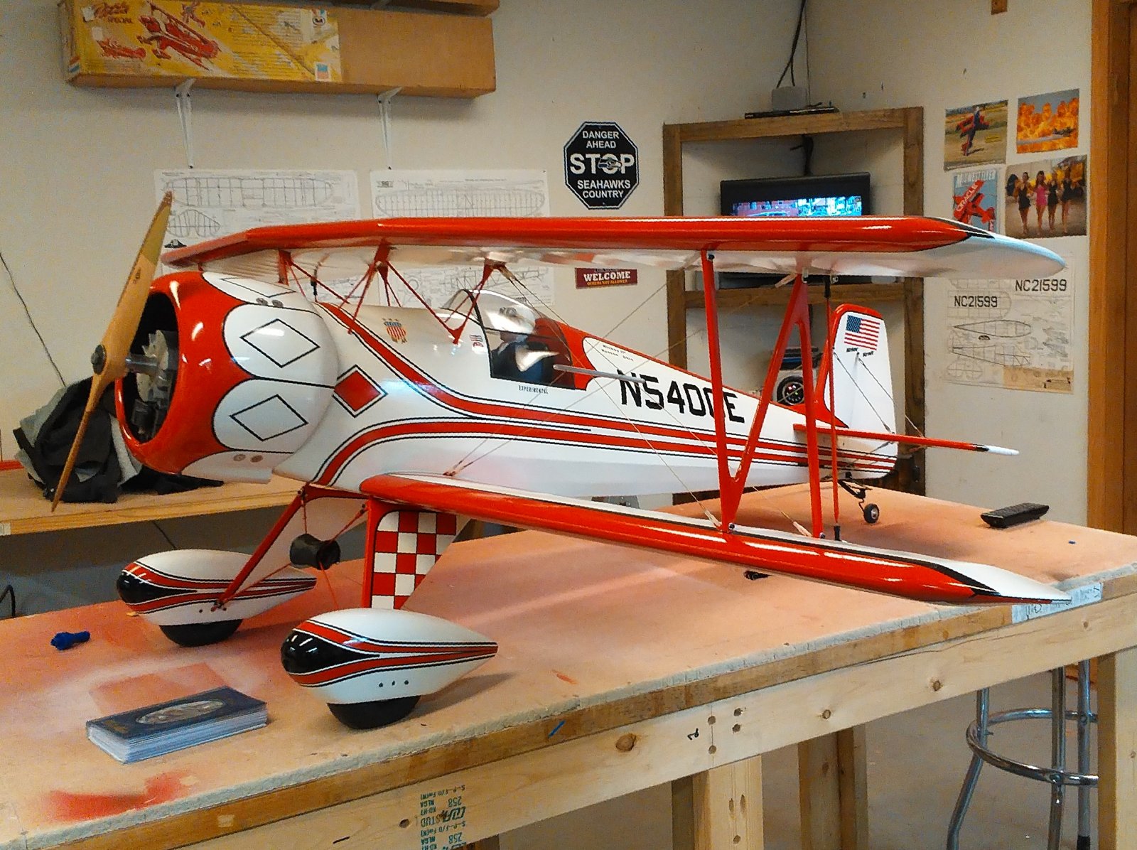

Hasn't been much to take pictures of though as I've just been getting the hinge pins in and all the hardware locked down. The last couple parts are in the mail, and really all that's left is to run the engine on the test stand, then bolted back to the airplane, plumb the fuel system and program the radio.
Oooh, there is a picture for ya! the flying wires are all finished. I painted the broomsticks with some silver Testors model paint and attached them to the wires with some white string and a drop of Zap.
