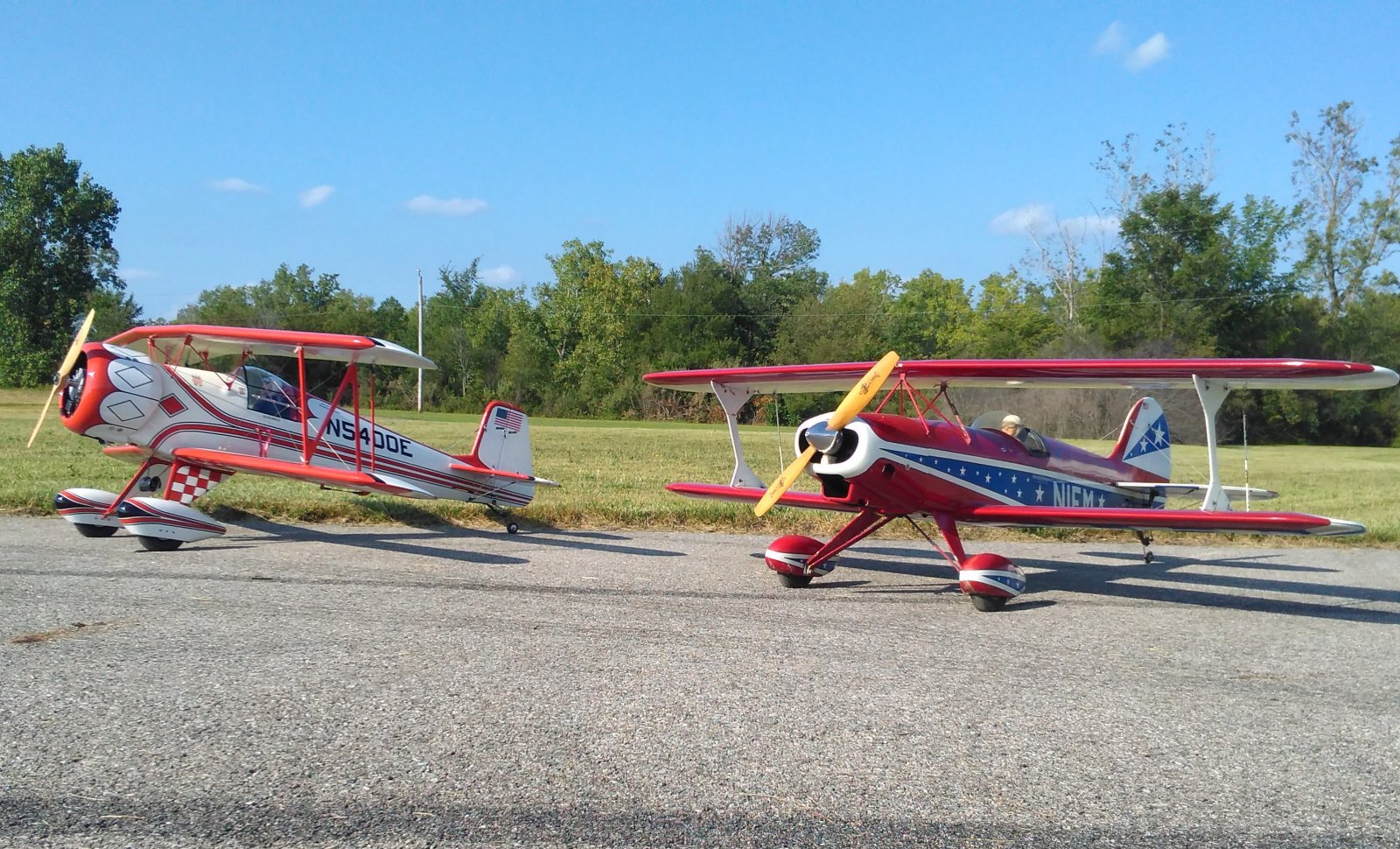

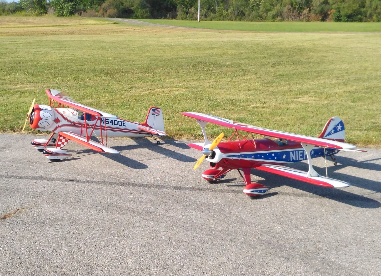

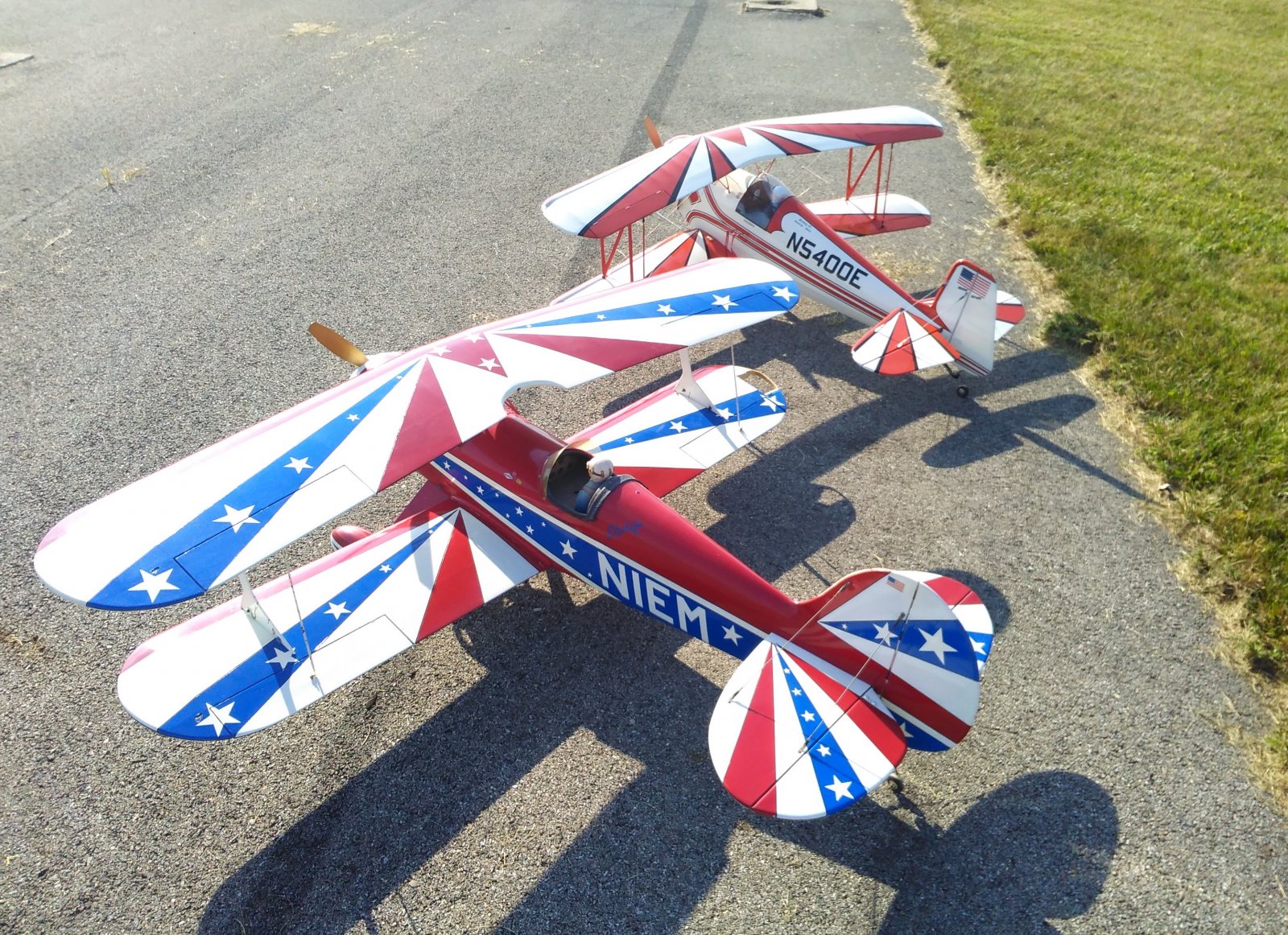

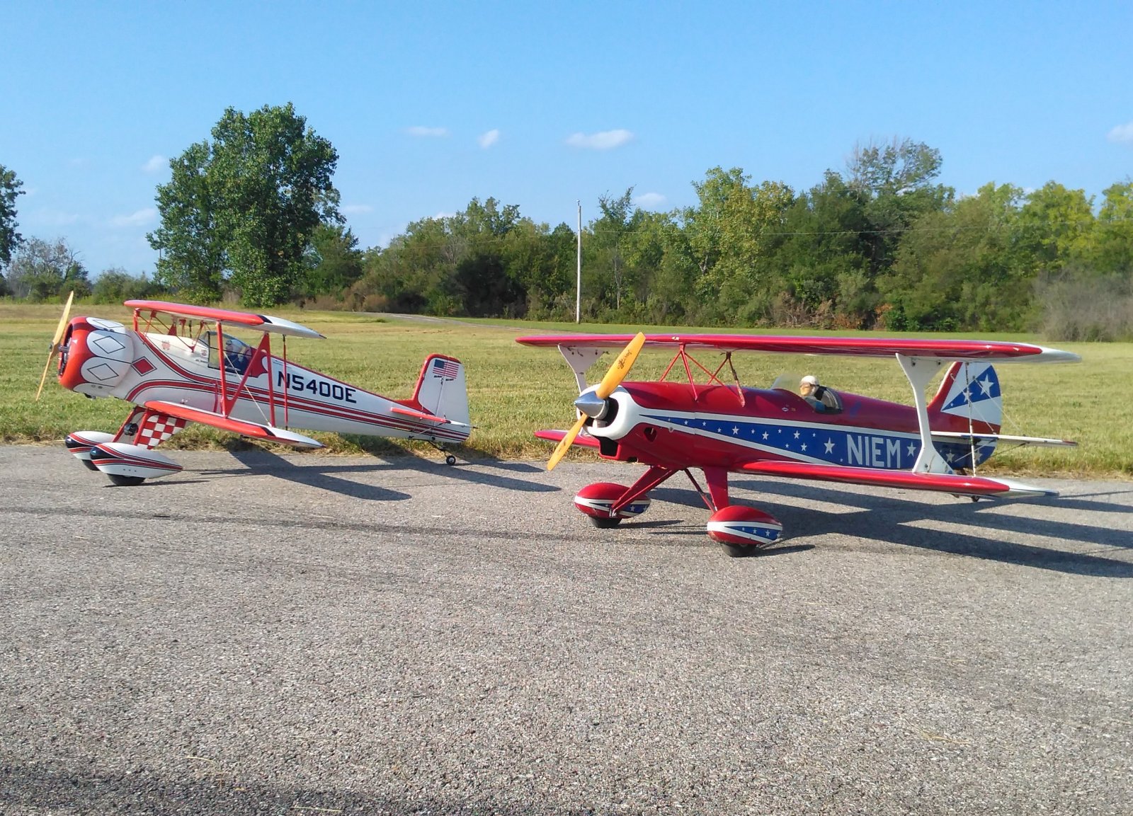

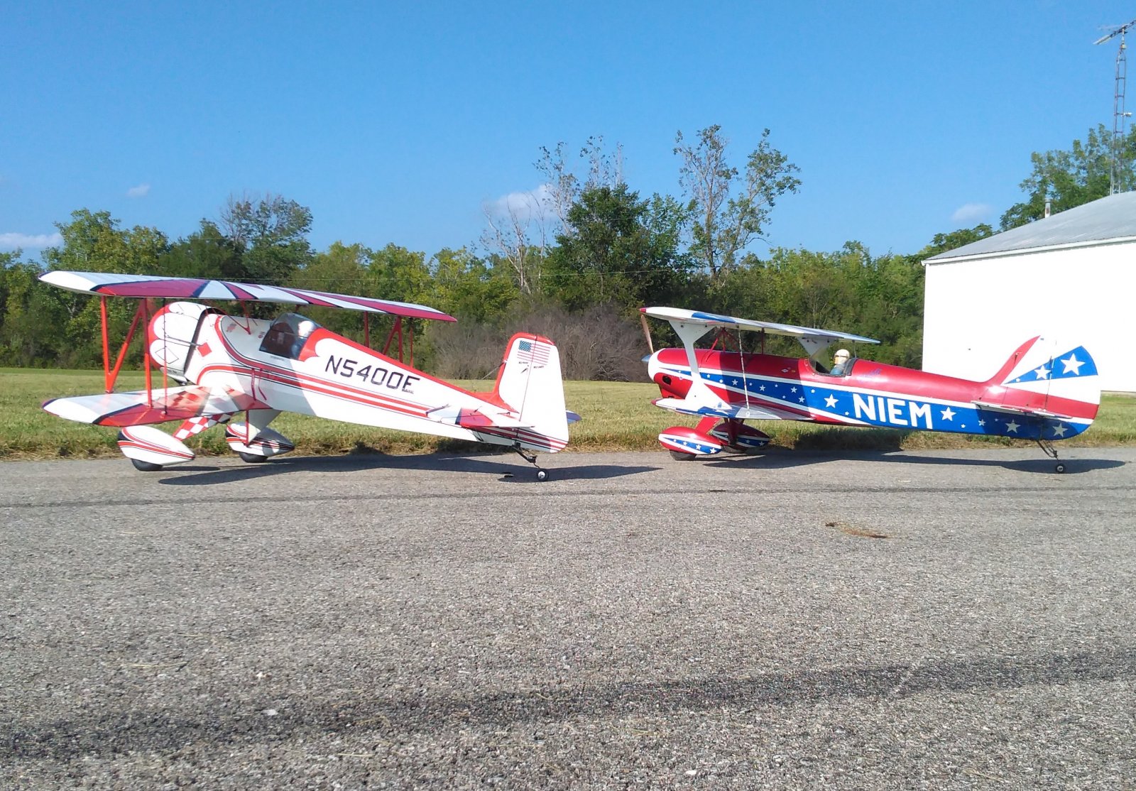

I put some cloth tape in the aileron cove as a gap seal, and increased the aileron travel slightly. She's now waiting on weather so I can get some more flight time on her.
Over the next day or so I'm going to get the plans tweaked on and then get them up to the graphics shop to see how much it costs to get them scanned and/or some copies made for anyone that wants a set.

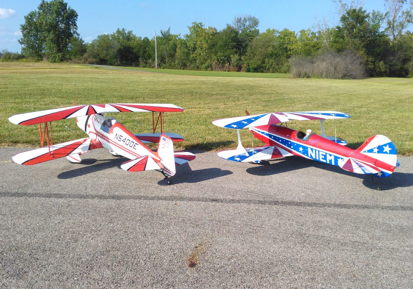

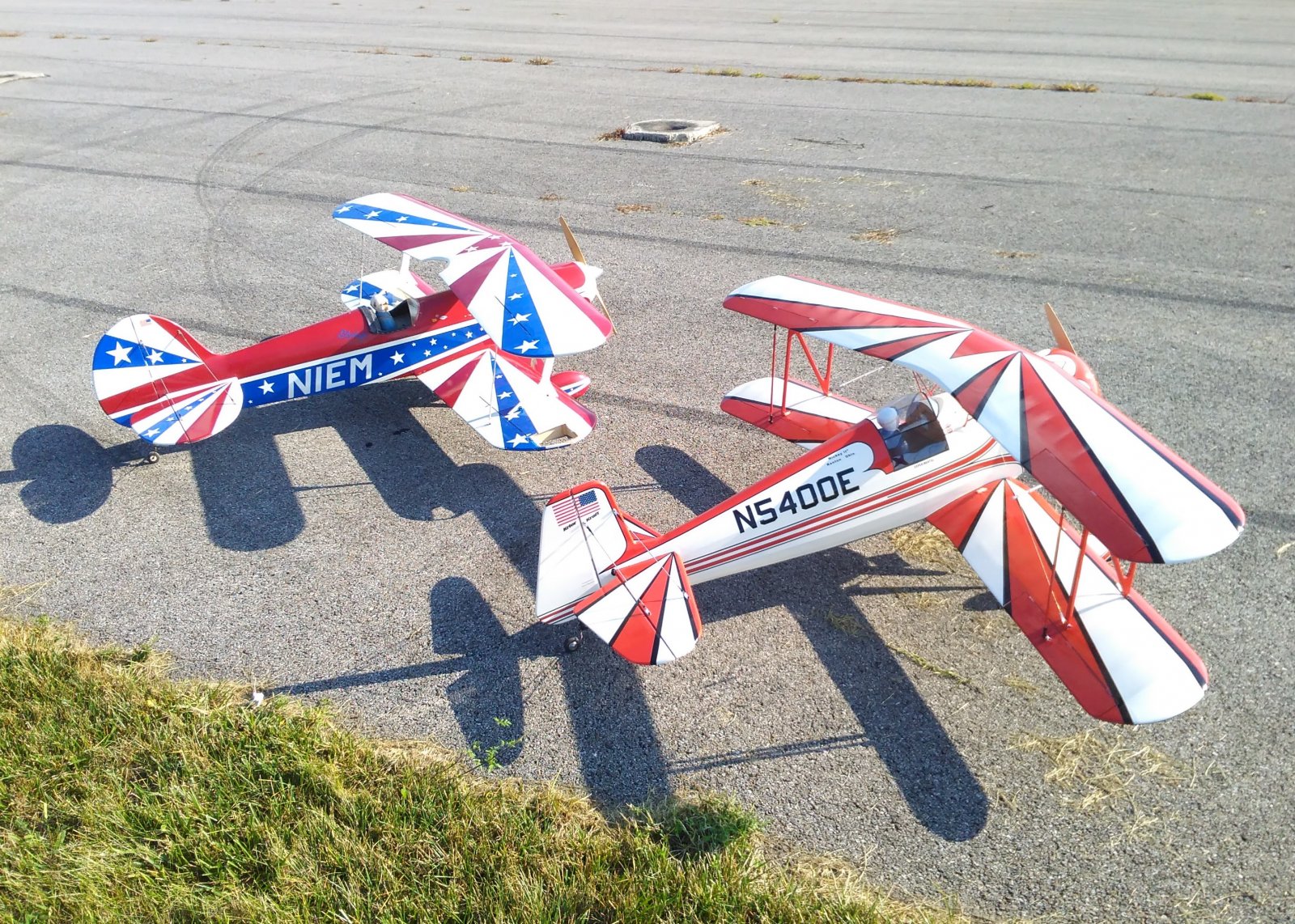

For now here's a couple pictures I took the day I test flew it before the maiden, it was pretty cool to see the Krier and the Skybolt together again, even though it's not Papaw's Skybolt lol.
Nice shots. Thanks for bringing back some great memories. I remember when I could not wait to get to the field early with my 25% Bucker Jungmiester because I knew a Great Lakes and Steen Skybolt were there awaiting for some formation flying. A Fly Baby Bipe would join in time to time as well. They all flew Zenoa G-26's in them but I was a diehard YS guy. Wish I had pics of back then because they were almost identical to yours. Very NICE.

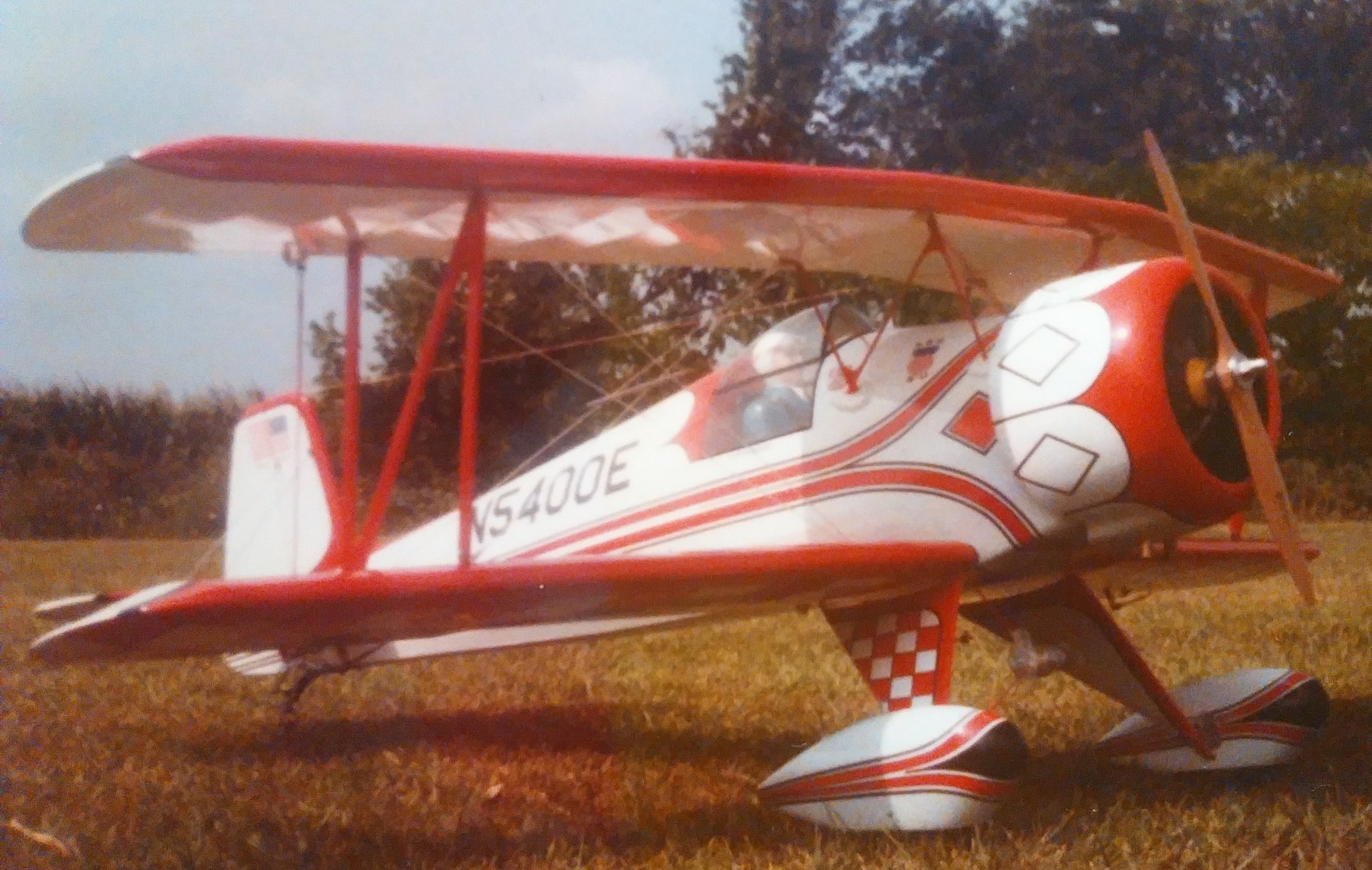

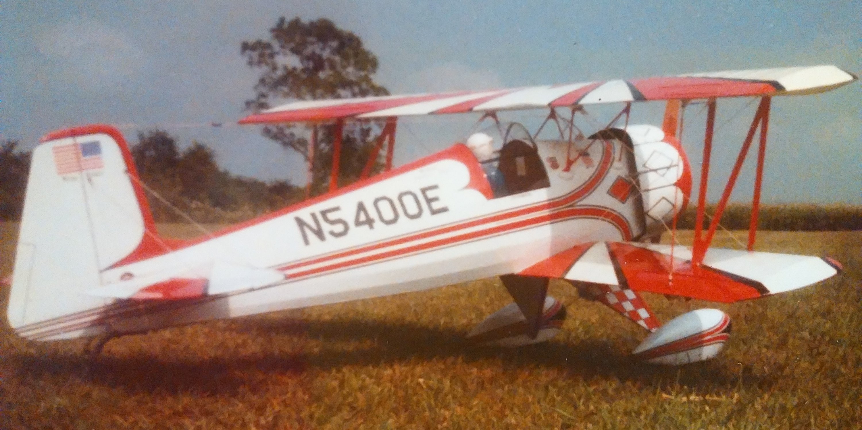

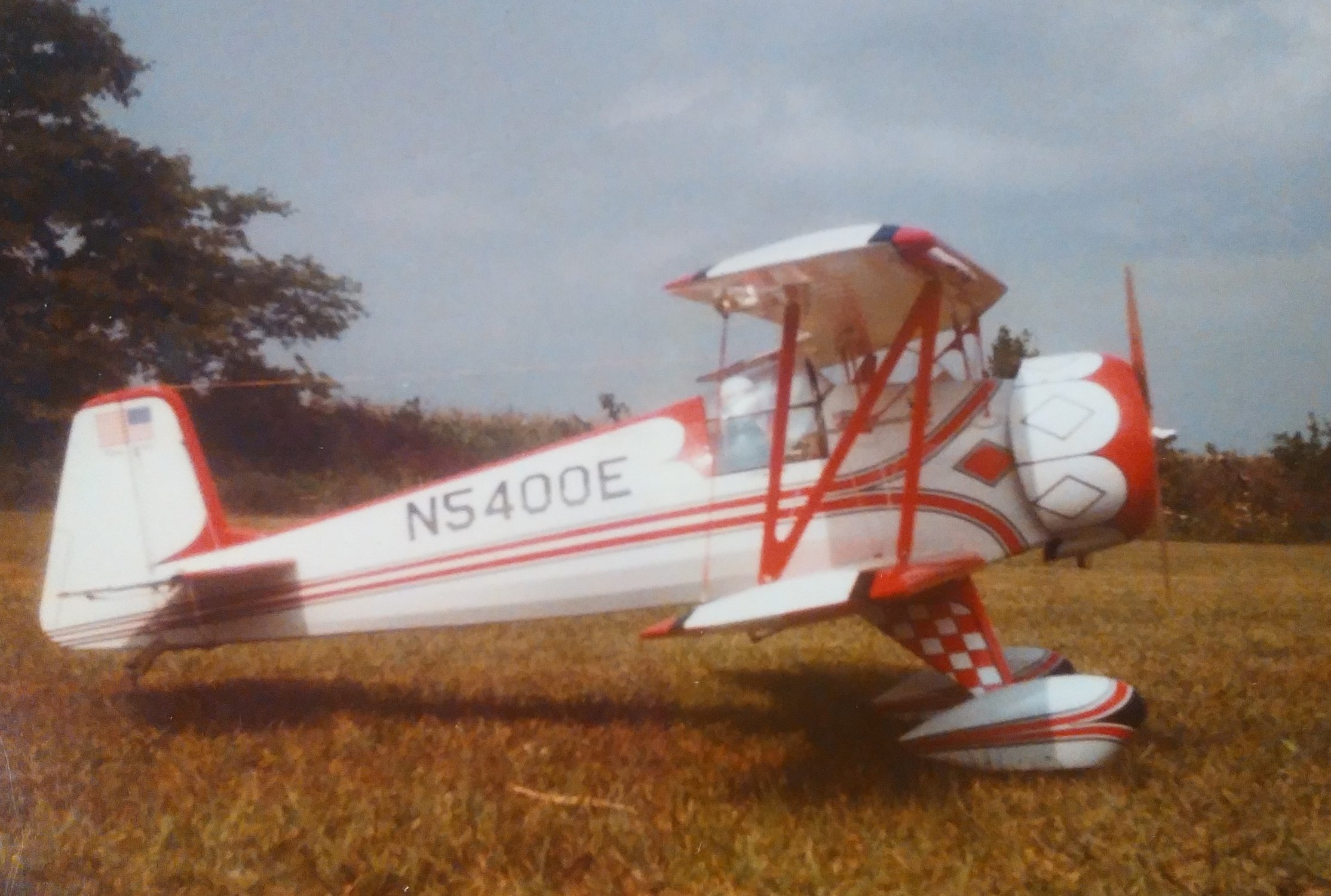

Grampa ordered a set of Flying Models Magazine "King Kong Krier" plans and went to town changing some aspects to make the model have the proper outline. He shortened the nose, removed the Bucker type hump in the turtle deck, made the belly skinnier, reduced the forward rake in the landing gear, changed the shape of the tail to look like the early rendition of the full scale, and reshaped the wingtips as well as stretch them 2 inches to get to the proper scale span of 71".

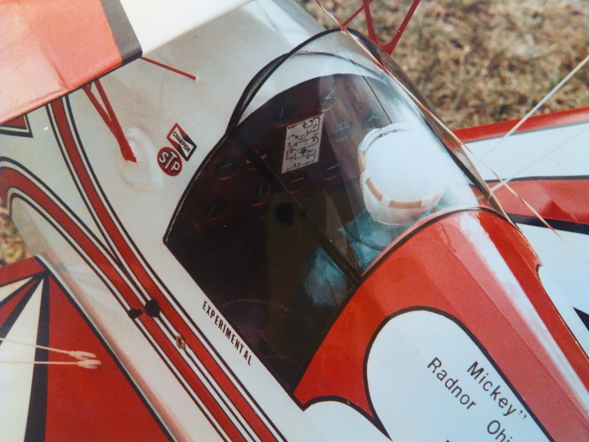

He fabricated everything on his Krier with the exception of the pilot, engine, wheels and radio equipment. He even made his own fiberglass fuel tank. The landing gear was made from piano wire and made to have functioning bungees in the scale locations.
The Krier's finished weight was 18 pounds, covered with Sig Koverall and painted with dope. It had a Quadra-Aero Q35 for power, and probably it's most unique feature was functioning boost tabs on all control surfaces allowing for use of STANDARD size servos. Keep in mind that standard servos of the late 70s and early 80s only had 30-40 oz of torque!
The canopy was made out of pieces of other larger canopies and flat clear plastic stock, and all of the pen striping was painted on by reverse masking.
The headphone jack next to the power switch was the ignition kill, putting the plug in the jack shorted the magneto to ground killing the engine. Gampa Mick did this to all of his gassers. Grampa built a few giant scale airplanes including a Hostetler Skybolt (which we still have) and a large Stinson Reliant.
He had and flew the Krier Kraft until the day he passed away in March of 1988 less than a month before my first birthday. My dad flew it a hand full of time afterward but not anywhere near as much as grampa. One day a guy approached him about buying it, and dad just starting a new business and with 2 young kids (me and my older sister) he decided to let it go.

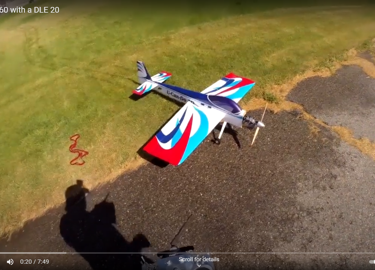

This old thread has inspired me to tackle a project I've been wanting to do for a while now. I've been flying a 20cc UCD for a few years now and love it, but it's been discontinued and the one I'm flying is a bit beat up. With the 20cc engine up front, the nose needs to be shortened a little, and the rudder and elevator can be reduced some, as they are a bit overkill. They also need to be made out of 3/8 stock instead of 1/4, for better hinge retention. So, I'm going to give drafting out my own plans a go, once I dismantle the one I'm flying to make all the templates I need to make. Should be a fun project! Thanks for the inspiration!!
