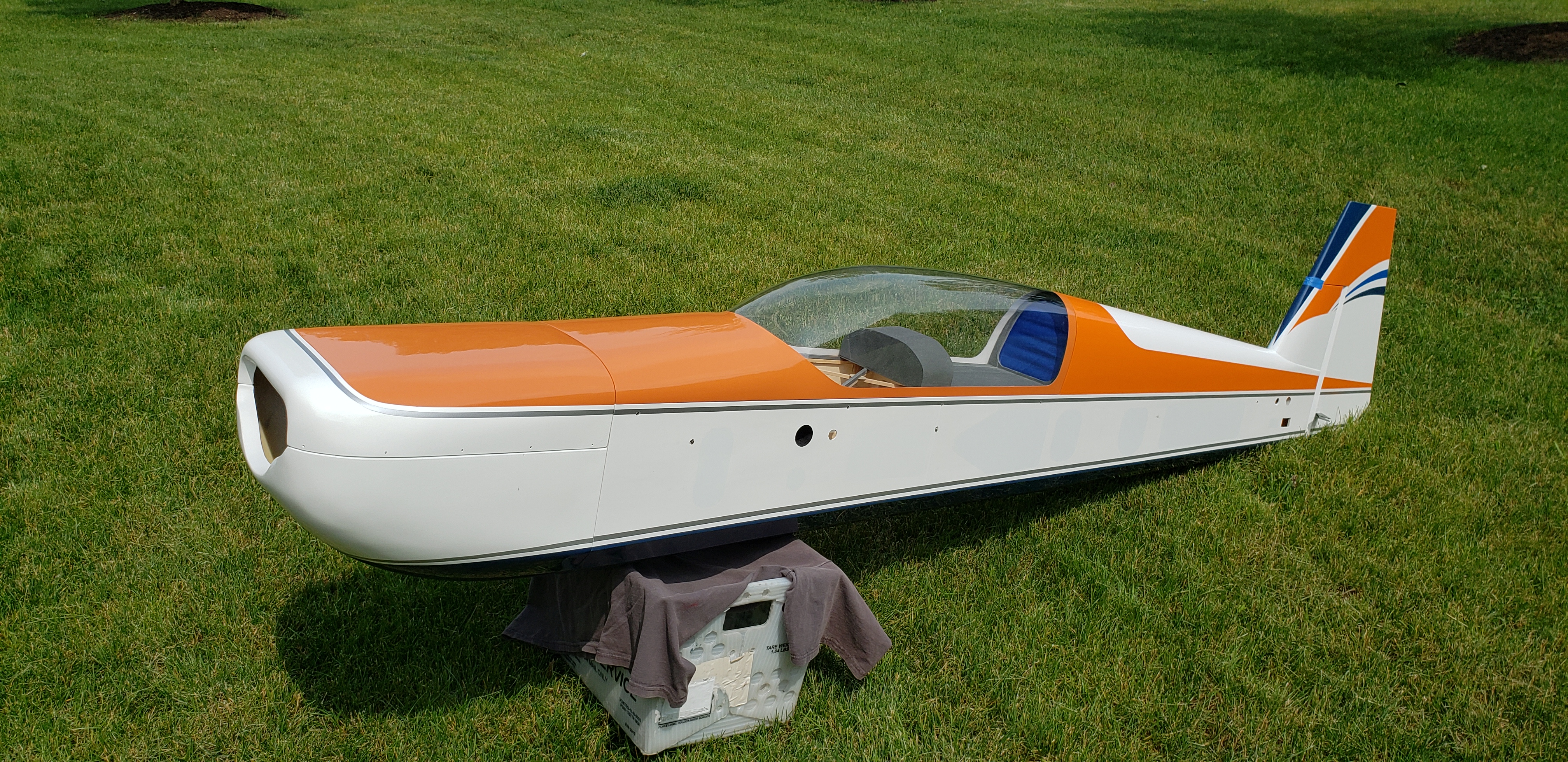

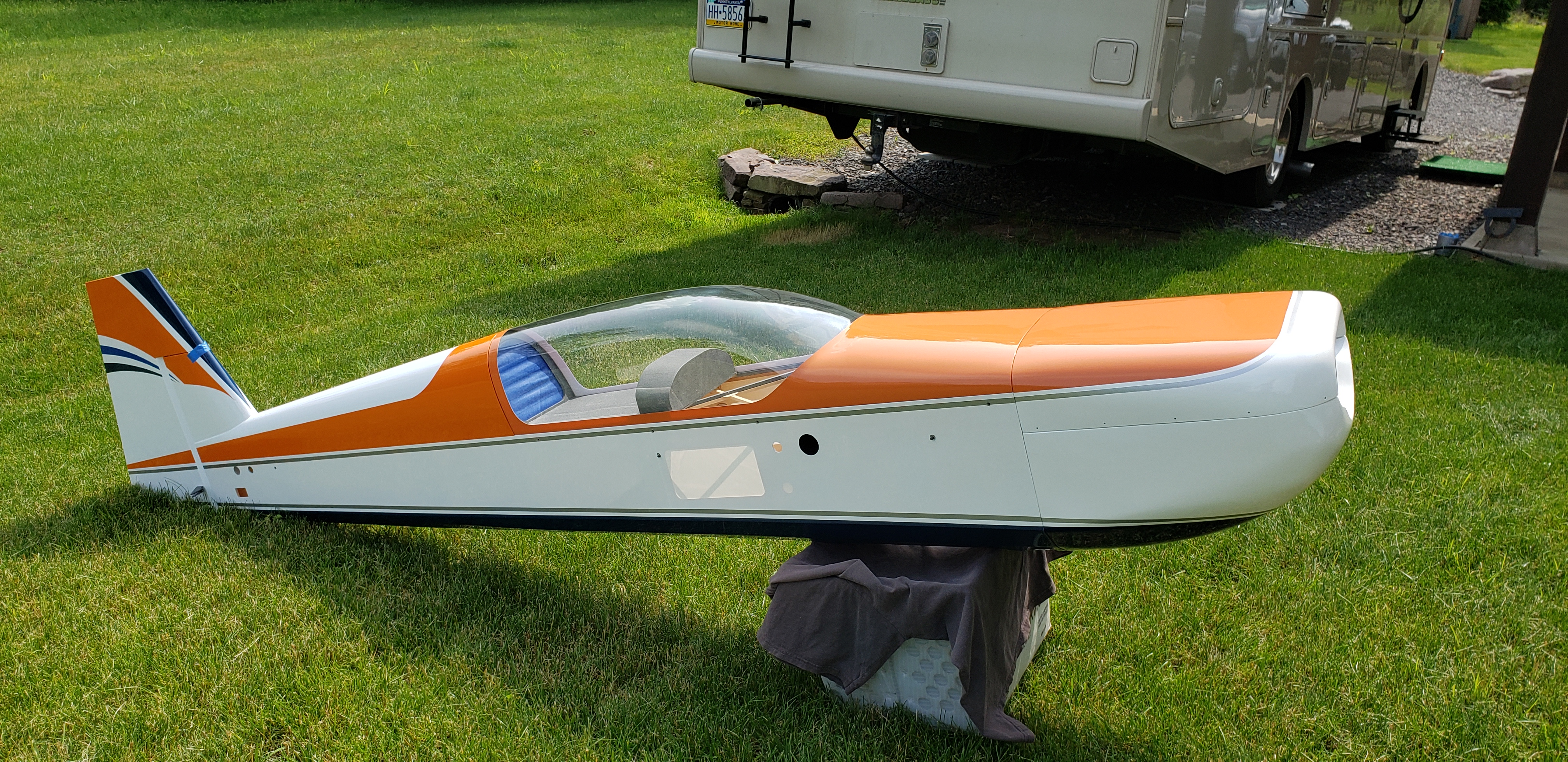

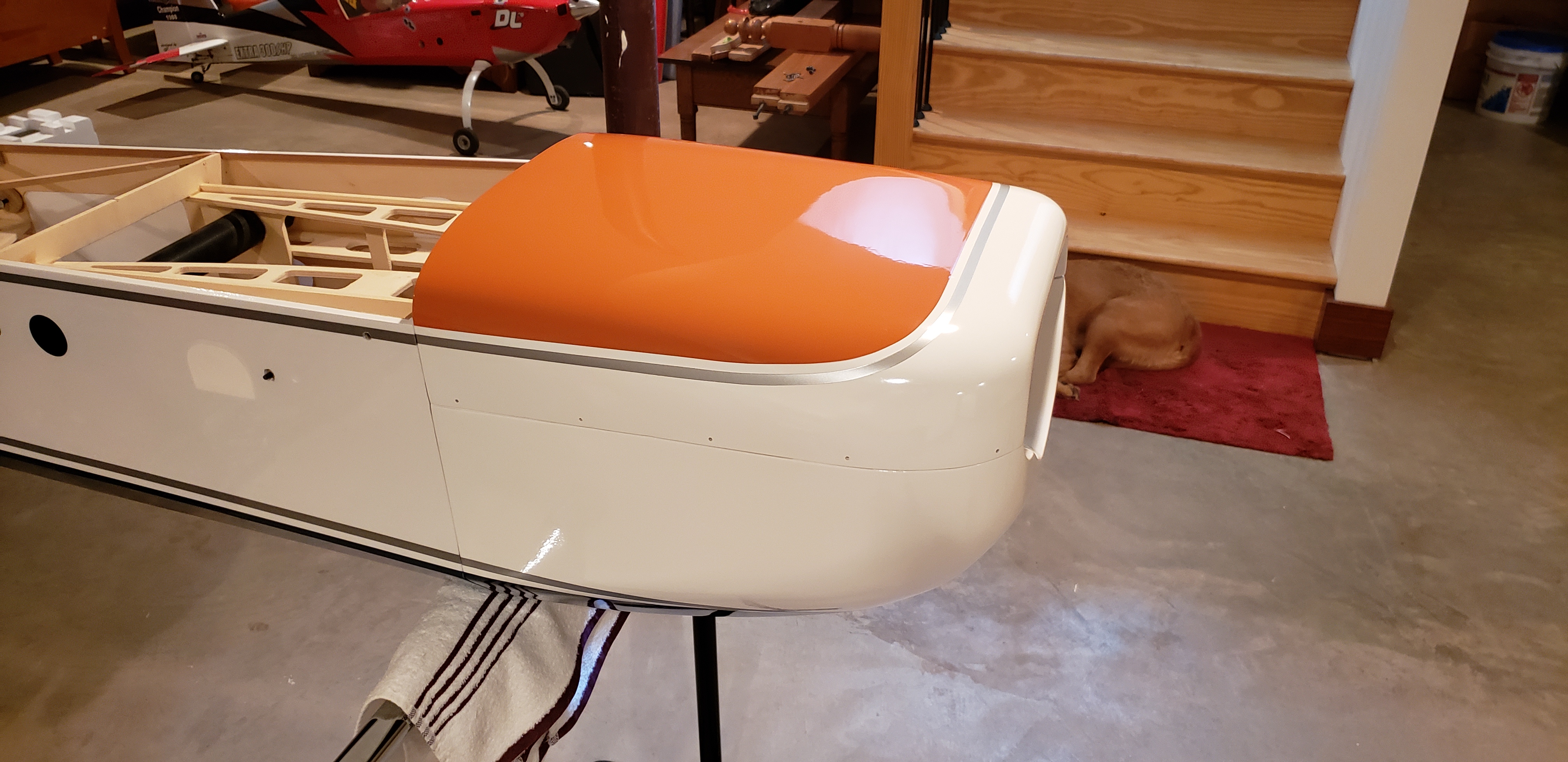

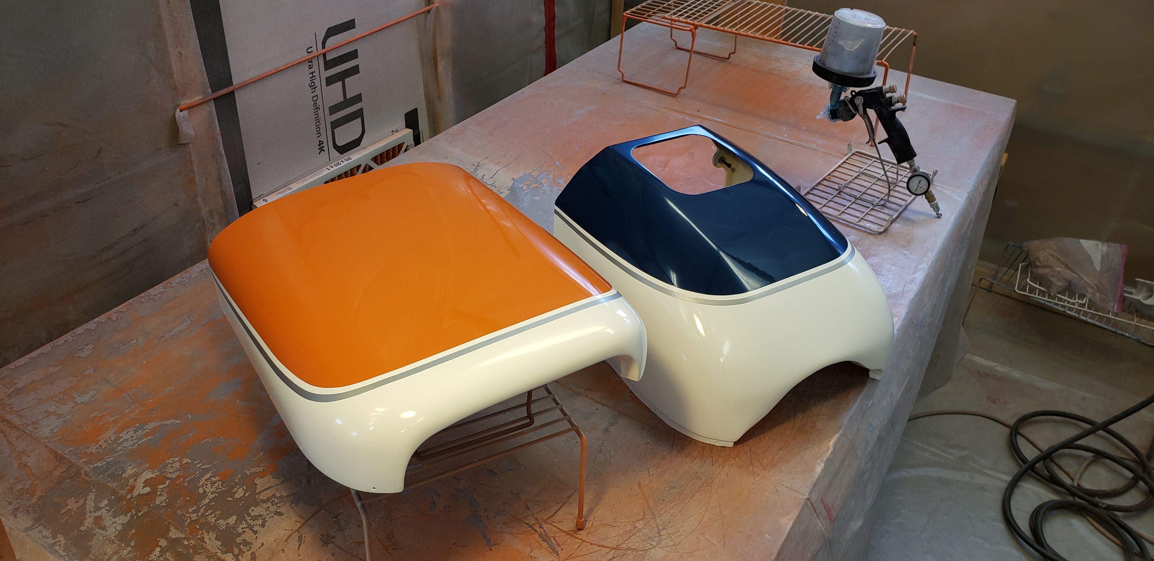

Finally finished the last paint job before getting back to MY plane!
This is a newly built Godfrey. Paint is KlassKote, which was a learning experience for me. came out fine but really don't care to shoot it again.

so Earle, let me ask you a question because you obviously know what you're doing, is that straight out of the can or has it been sanded and buffed?
holy moly it's some good looking paint work!

Hey Bart...it's epoxy paint , mixed 1 to 1...color to catalyst, then reduced to thin for spraying. Using their gloss catalyst it's doesn't need clear coated. This has not been buffed.
I much prefer auto base/color systems though. Far easier to work with....and faster.

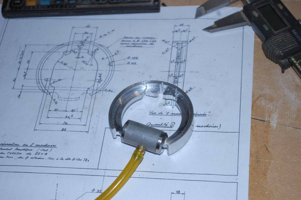

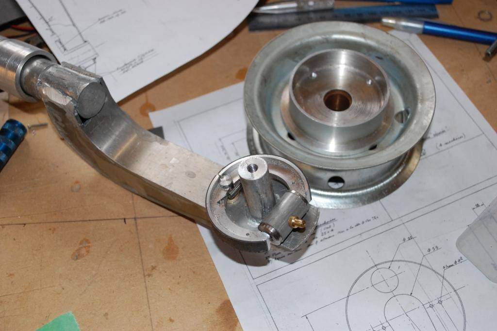

Somehow a little odd the subject of brakes should be the topic of conversation. I have actually been toying with the idea of trying them out on say, maybe the Behemoth Yak. With any good fully proportional radio, a slider switch on the back of the radio programmed with expo should/could prove interesting. I think that is spring project. If it works well, I may consider it for the Tank Stang!

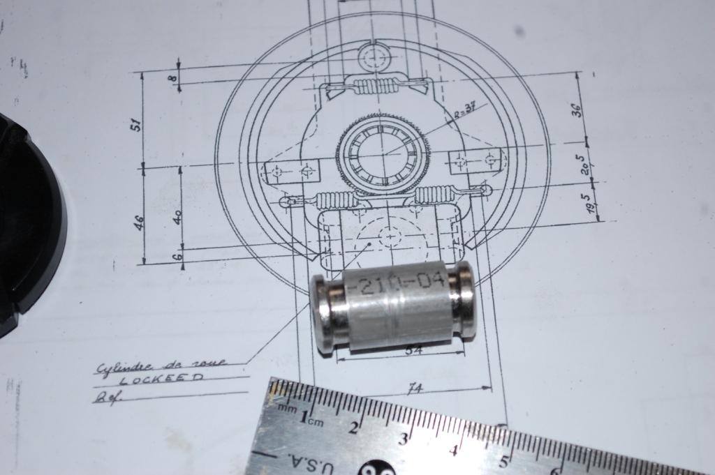

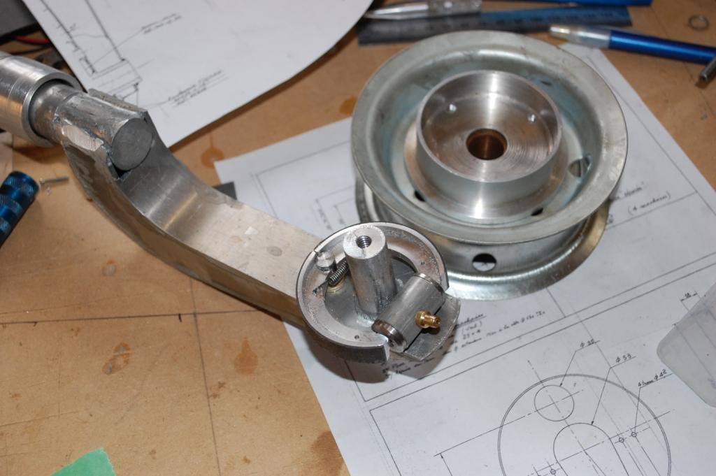

Here are drum brakes for my Dalotel
