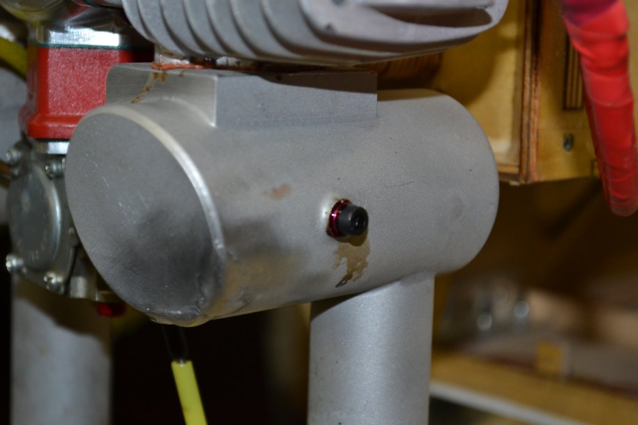

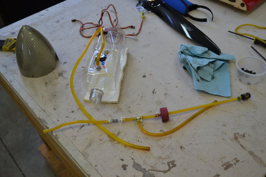

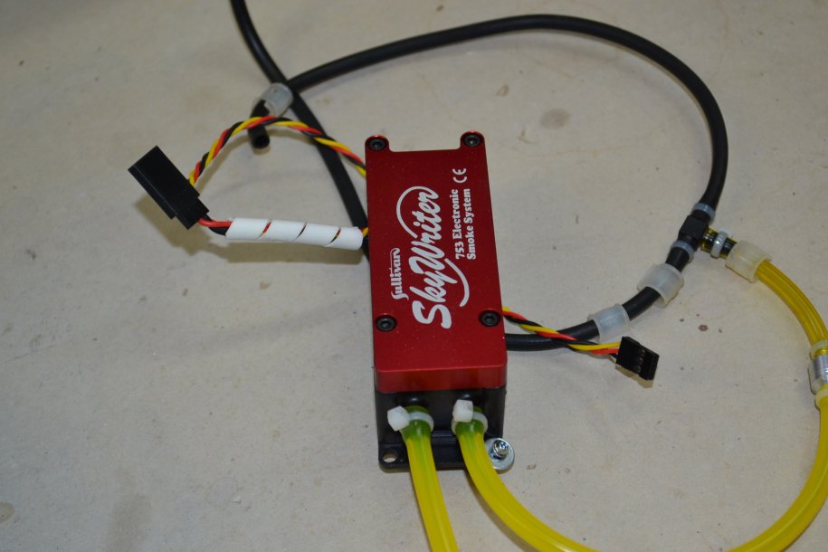

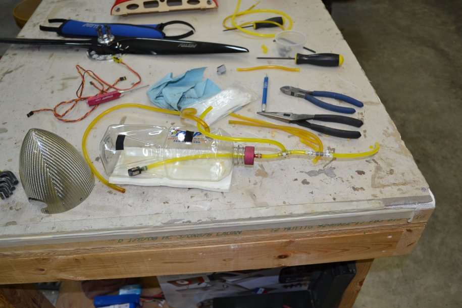

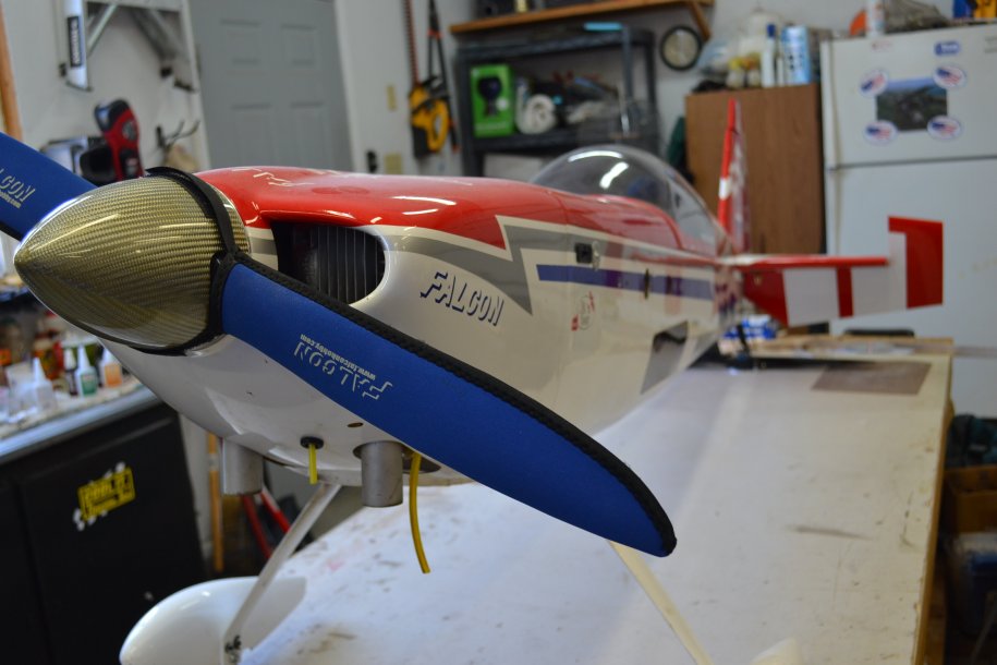

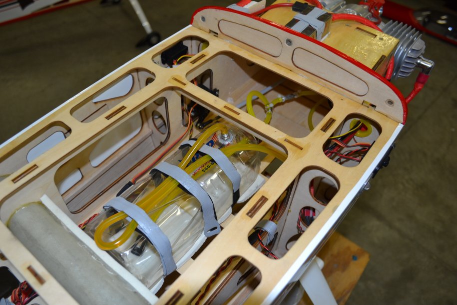

It is now Spring and it's time for the Spring Tune Up. The Edge is the first on the list. I changed out every fuel line except the vent from the tank. The Vent line was in good enough shape for another season. I also decided I don't like cleaning up Smoke oil from my plane so I removed the smoke system all the way so I don't get tempted on using it.
Also tightened up the motor mount bolts. These always seem to need tightening every spring so don't forget to check yours when the time comes.

How come you dont run viton in the tank?
I get used to something and it works for me. Until something goes wrong I probably wont change. Using the Tygon. I'm forced into rebuilding the tank every year. This makes me inspect everything thoroughly. This gives me a peace of mind that I checked it and everything is in Top shape. I also had a clunk get stuck in the front of a tank and had a dead stick because of it using Viton.
