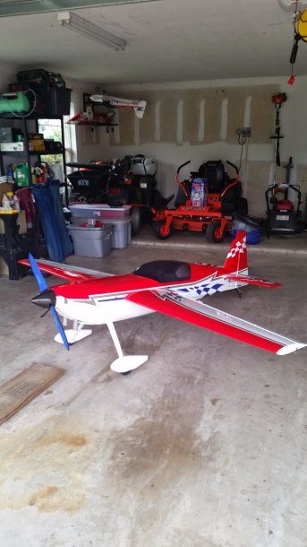

Here's my newest addition to the fleet. After a little shipping Snafu or two I was finally able to get it put together and its almost ready to go. I attempted to run the engine before I left for offshore and that was a no go. Engine wants to die about half throttle and the IBEC light was flaking out and my elevator servos were jumping all over the place. I tried a Life battery I had laying around straight to the ignition which cured the elevator servos from jumping and the ibec light would stay lit(even though not being used) but engine still won't above half throttle. Didn't really get to mess with it any more after that but I'm leaning towards some ignition problems as I've had something very similar happen before. Anyhow, I have a spare ignition to try out when I get home. But I am excited to get this thing up in the air once I get the 120 up and singing again. Big thanks to Herve for getting the shipping issues straightened out while he was busy prepping for Nall so I could get my plane :)
