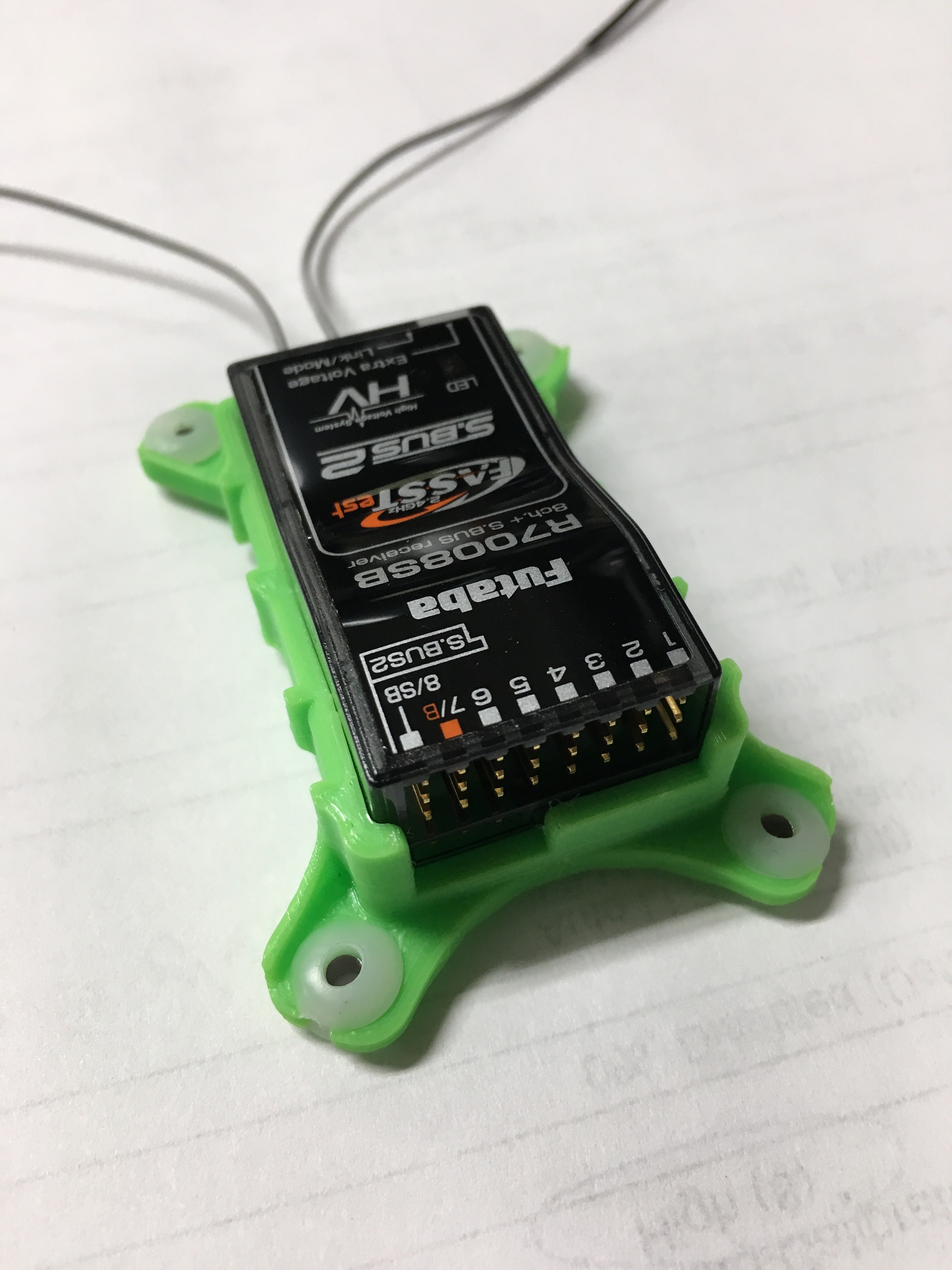

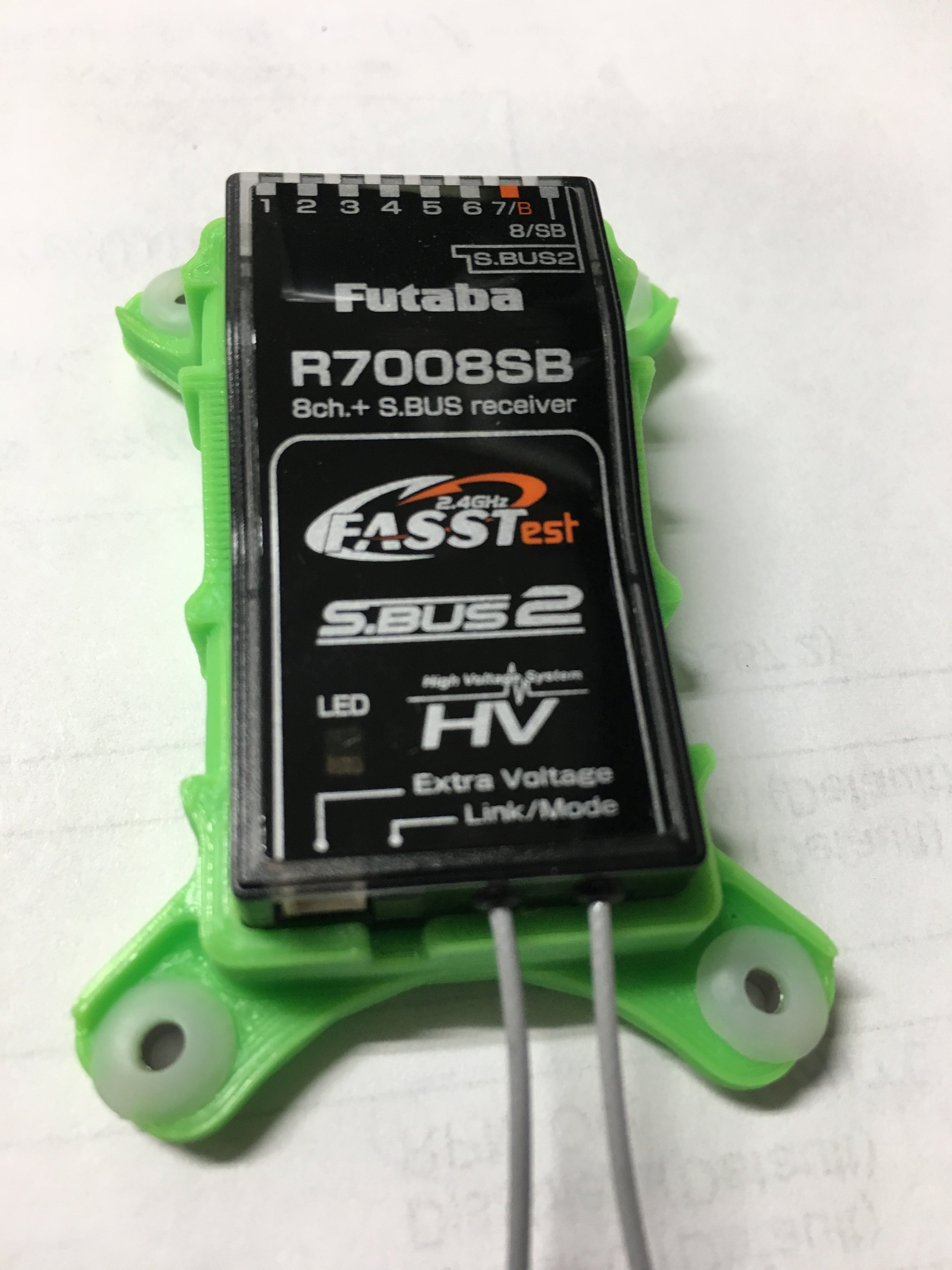

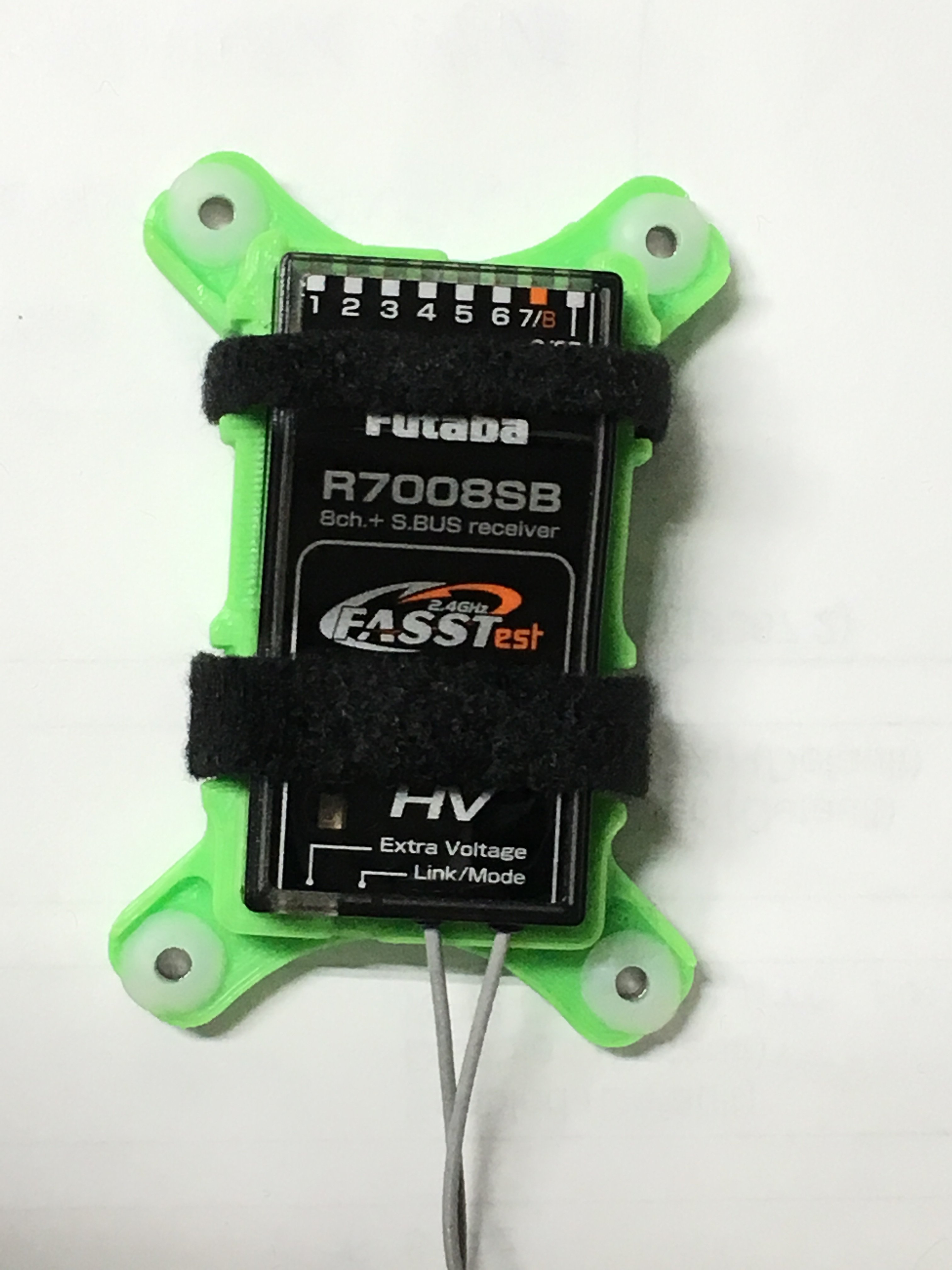

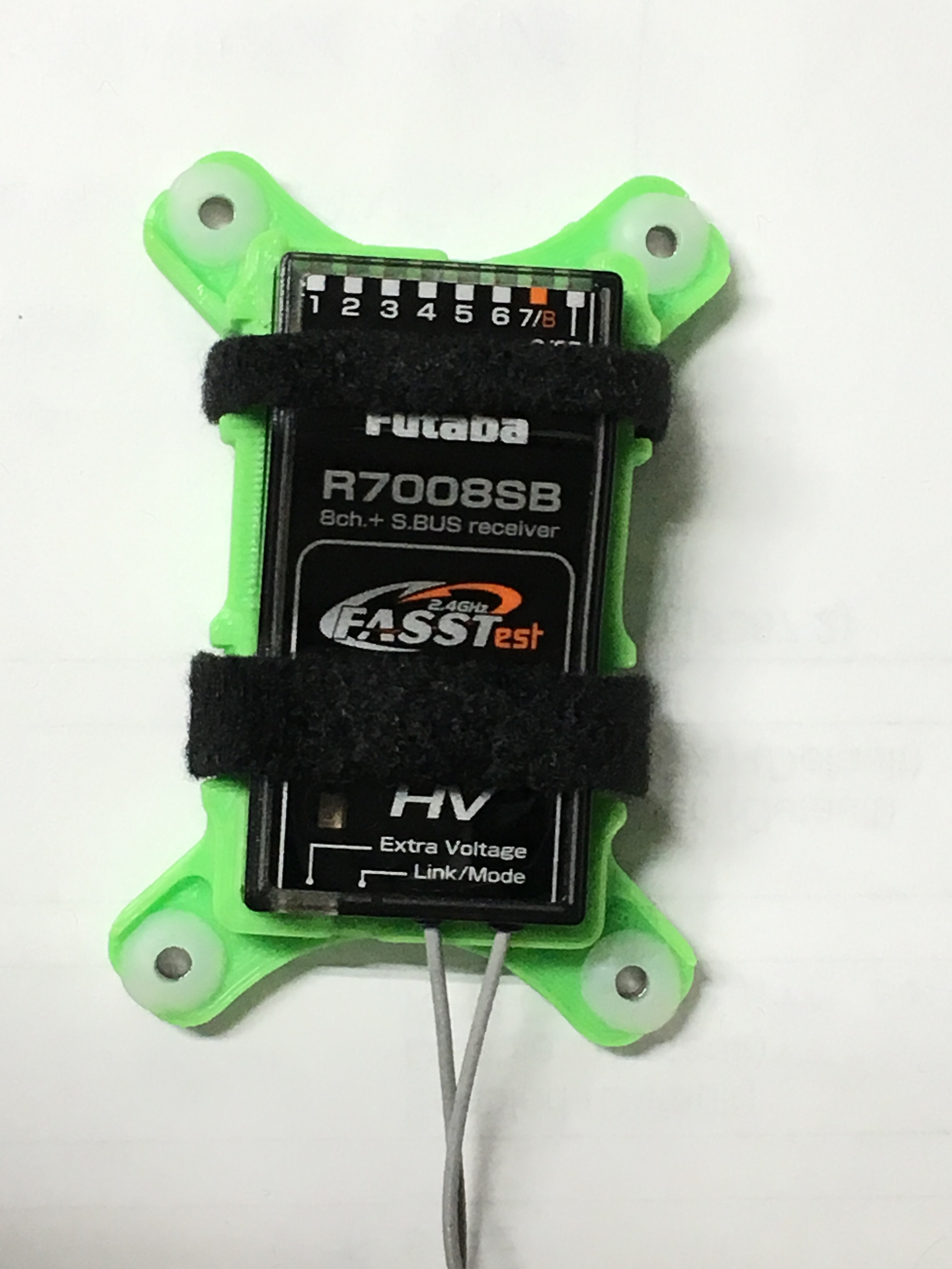

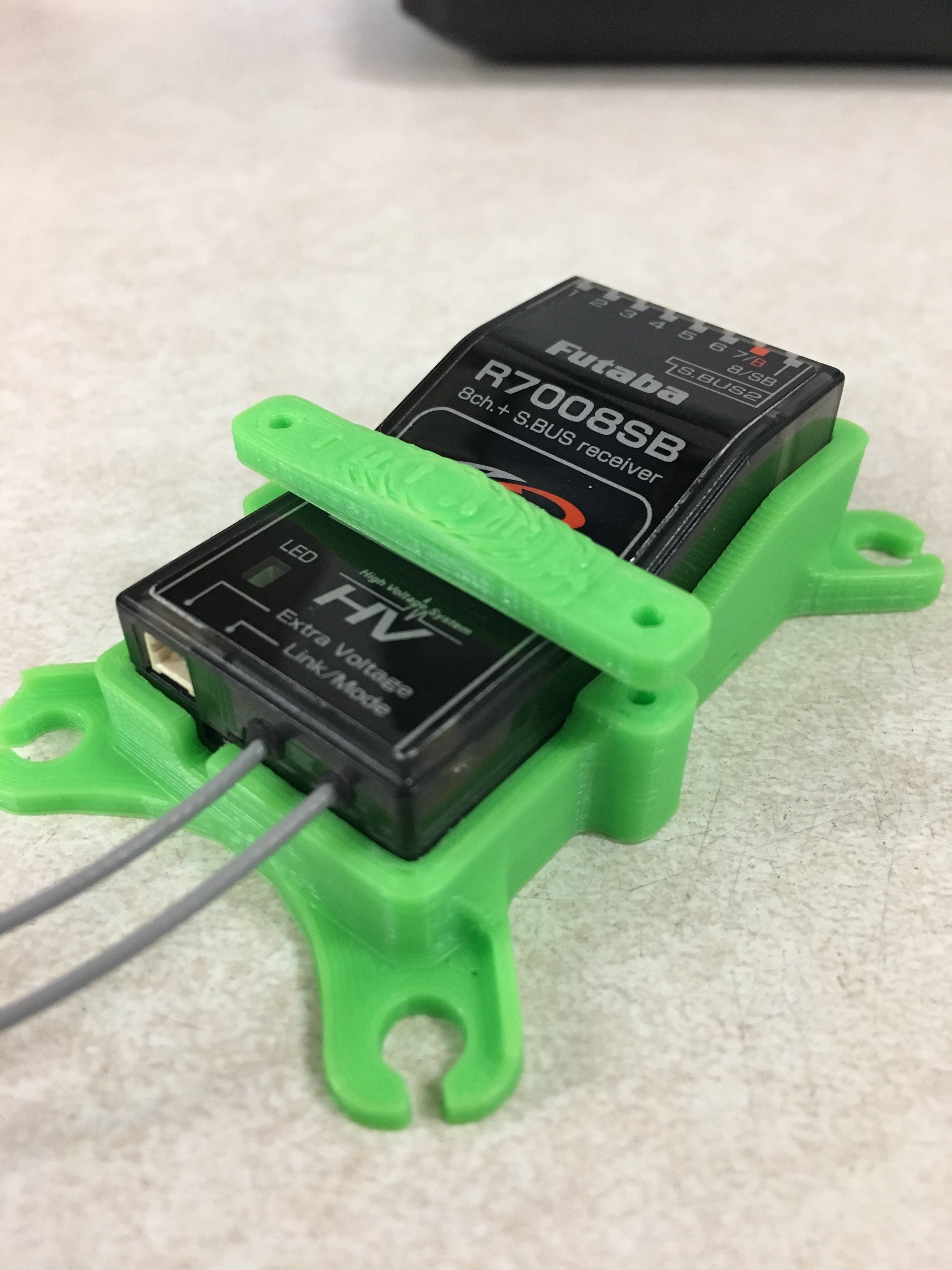

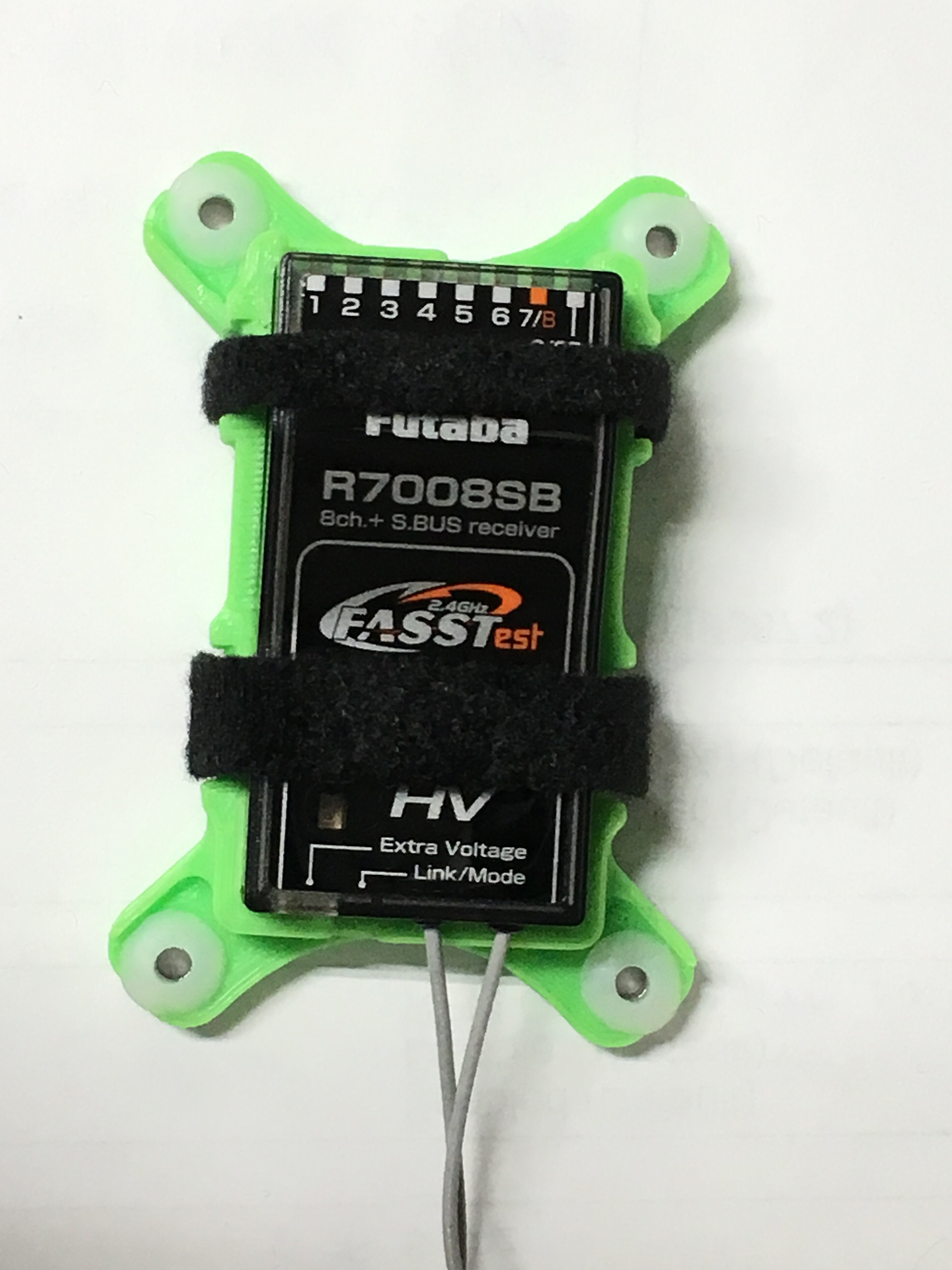

    E03D11C0-ED22-4FBF-8C21-A6E3D4211068.jpeg 96C7C8B2-E6E2-4B87-B098-72F849C7FFF1.jpeg C446EEED-89DD-445D-900F-2039C53BE979.jpeg
    Been working on a receiver holder for a Futaba R7008SB.
    I’m starting to think the Velcro isn’t the way to go. I may do a screw on band with some padding on it. Just don’t like all the effort it takes to try and secure it down.

  4. Snoopy1
    Snoopy1 640cc Uber Pimp
    4,512
    6,473
    Canada
    Can you not extend the holder with hooks on either side that you have to spread a little to push the receiver in and then the two hooks snap onto the receiver.
  5. AKNick
    AKNick 150cc
    1,275
    1,808
    Alaska
    If there is one thing I've learned with PLA is that it doesn't like to bend. Meaning it's fairly brittle. I understand what you are saying about slipping the receiver into a slot and a clip to keep it there. I'm not very good with my Slicer settings for overhangs (bridging). So it's a little bit beyond my knowledge point to try something like that.
    My designs are pretty snug already to the mm, and I dont think they will come out regardless... that extra piece of mind is nice. Creating a bar to screw into the mount would be easy though.
    Love how we can imagine something and make it reality. Fun stuff!

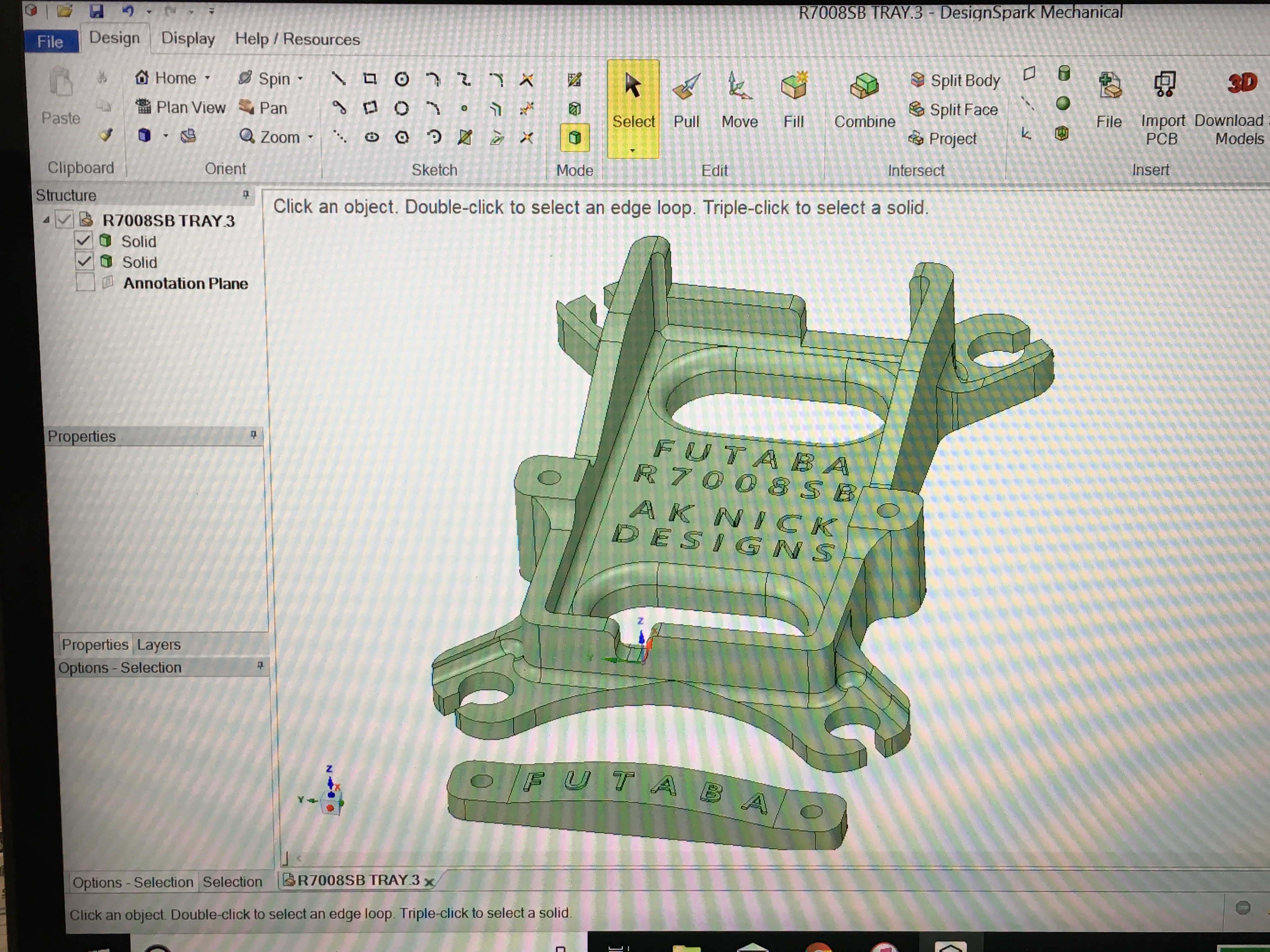

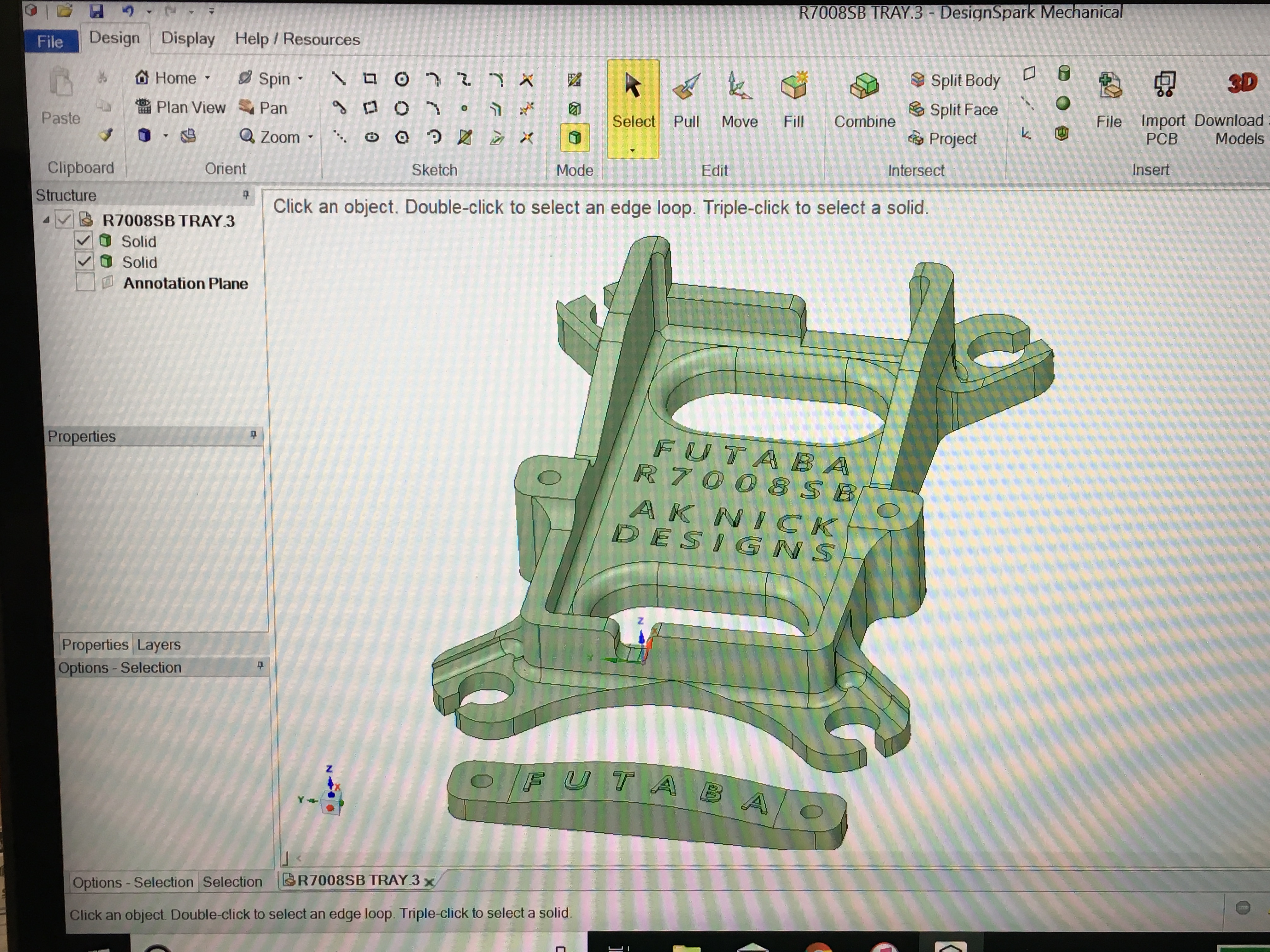

  6. AKNick
    AKNick 150cc
    1,275
    1,808
    Alaska

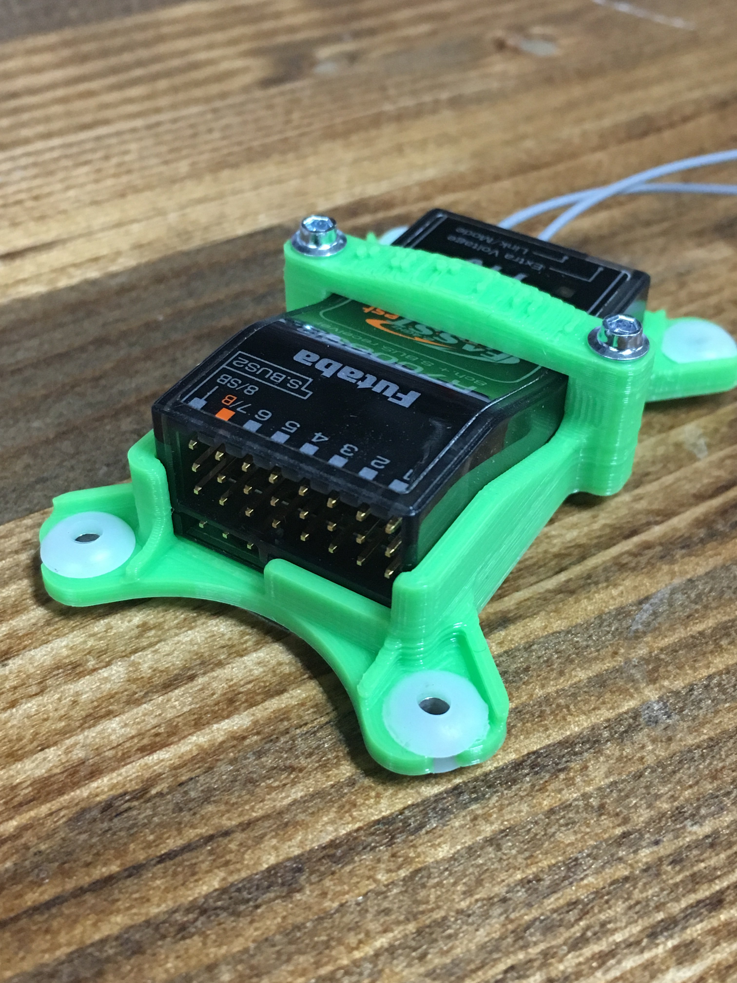

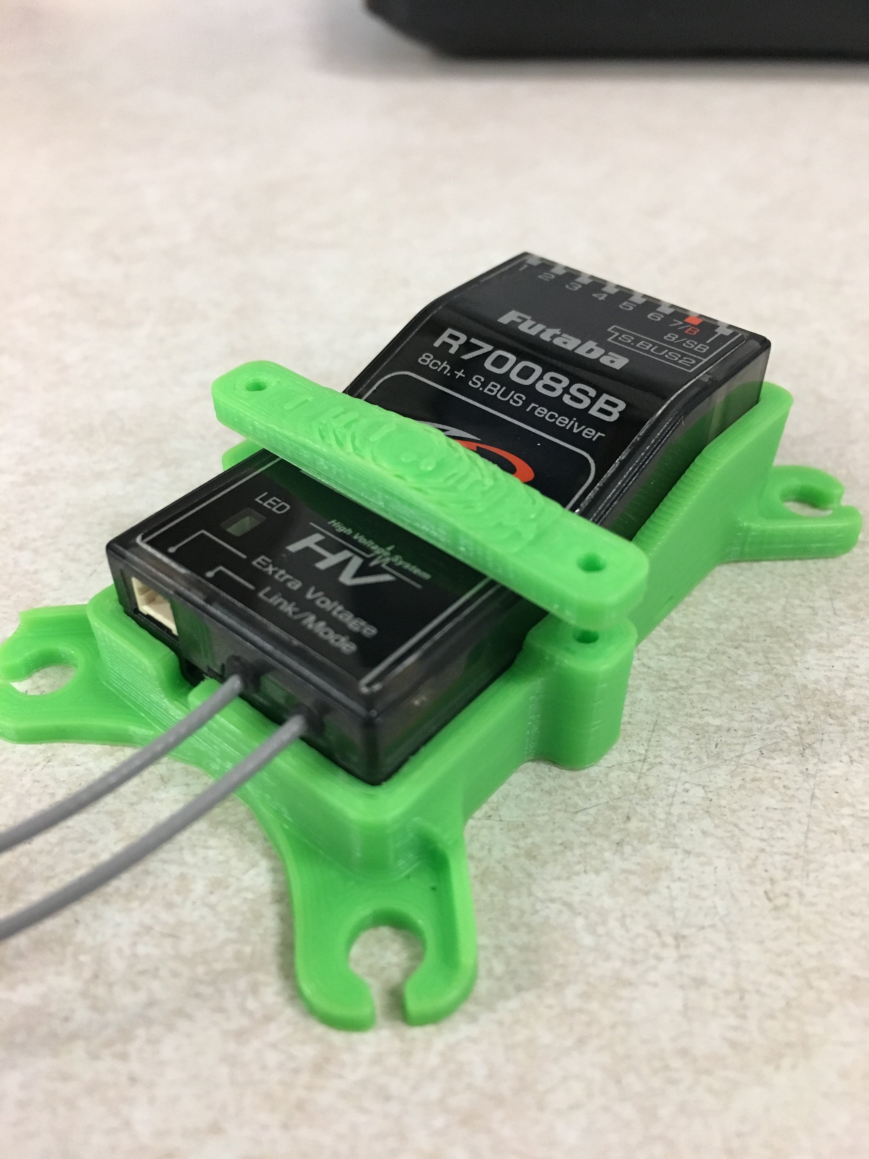

    So this is what I’m thinking:
    Jetpainter and pawnshopmike like this.
  7. Snoopy1
    4,512
    6,473
    Canada
    That should do the trick. Simple and effective.

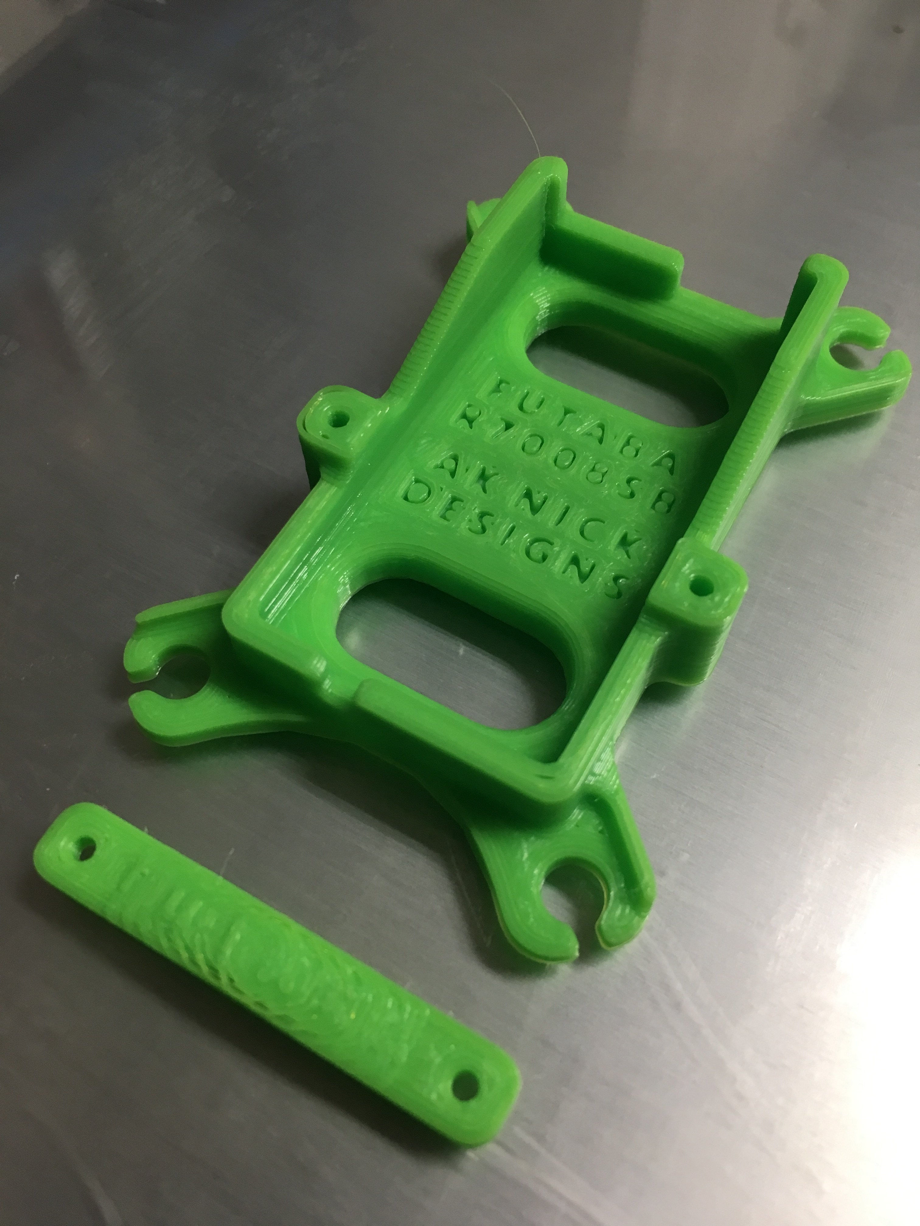

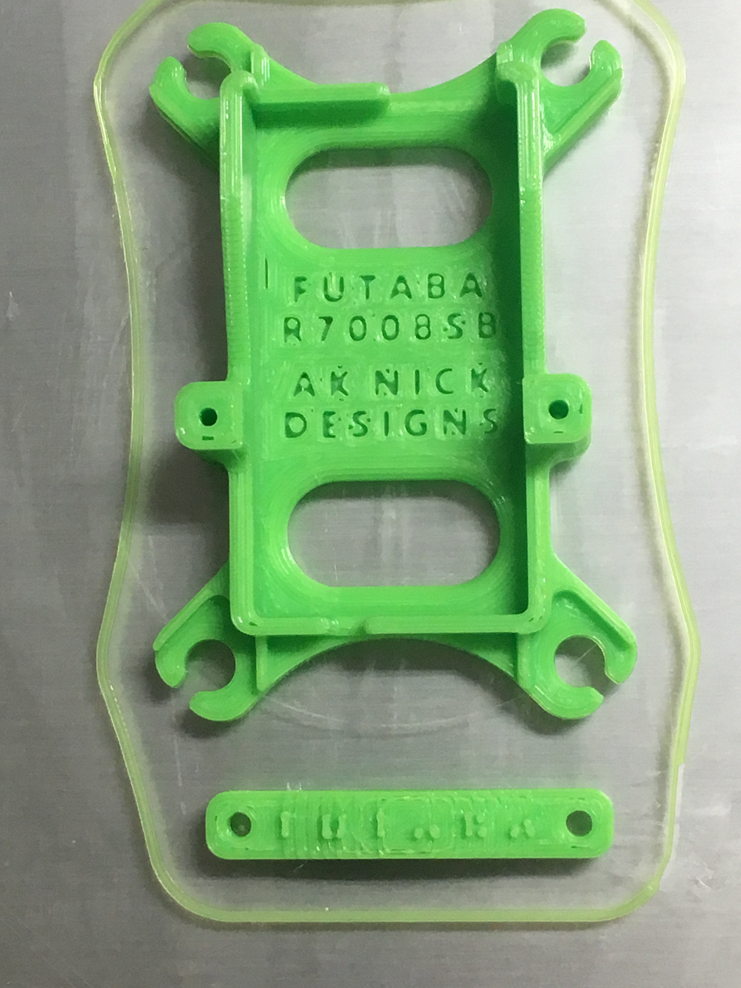

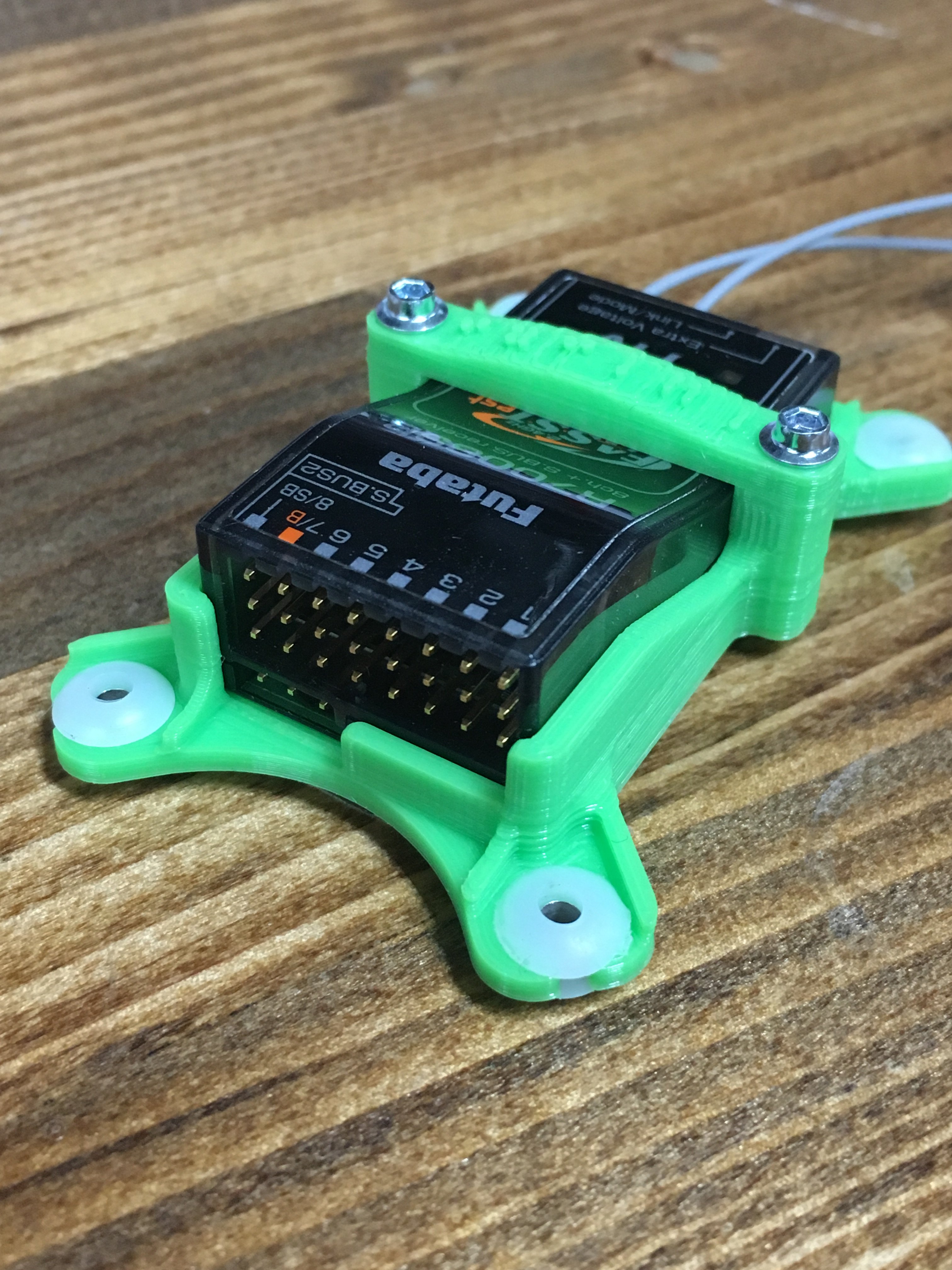

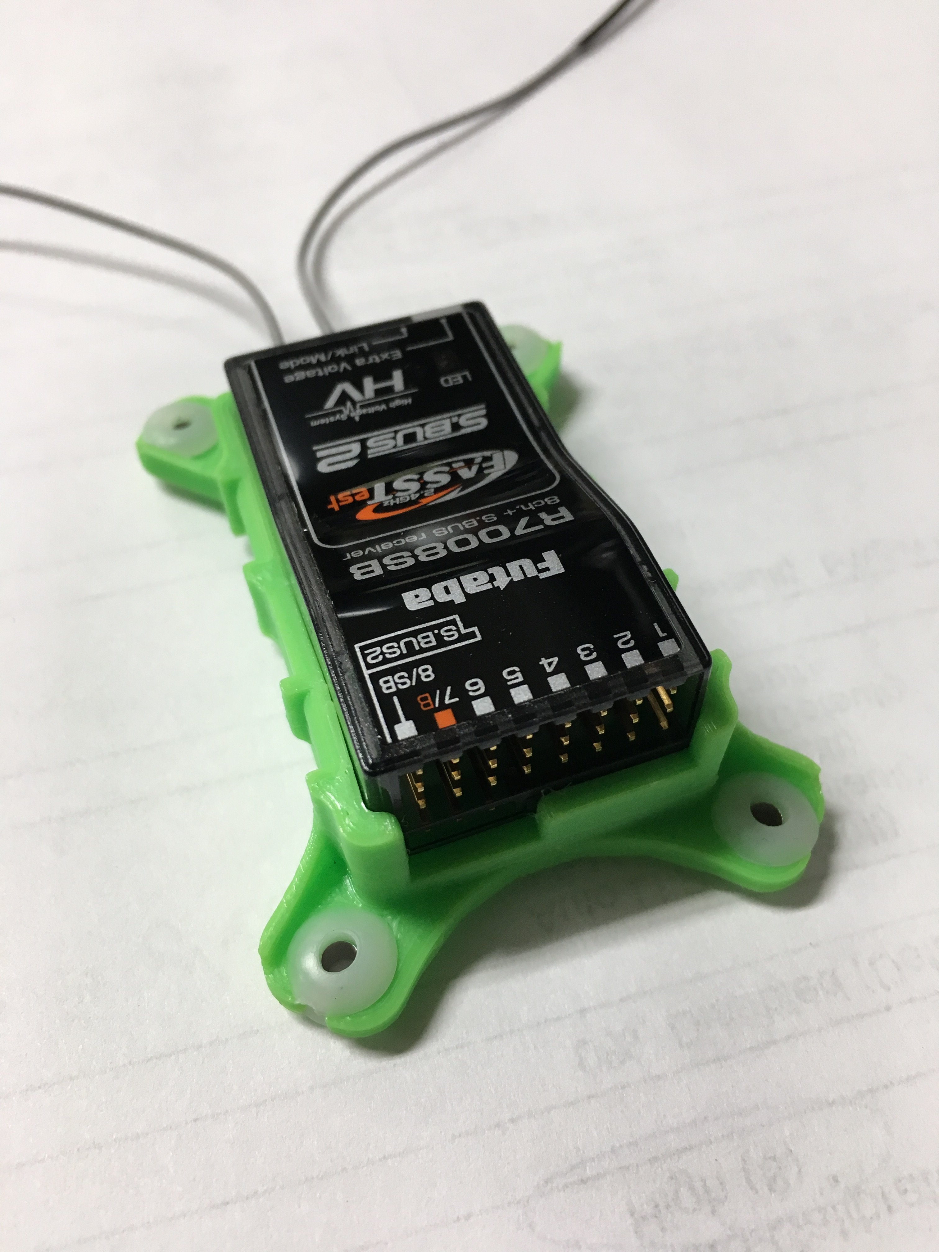

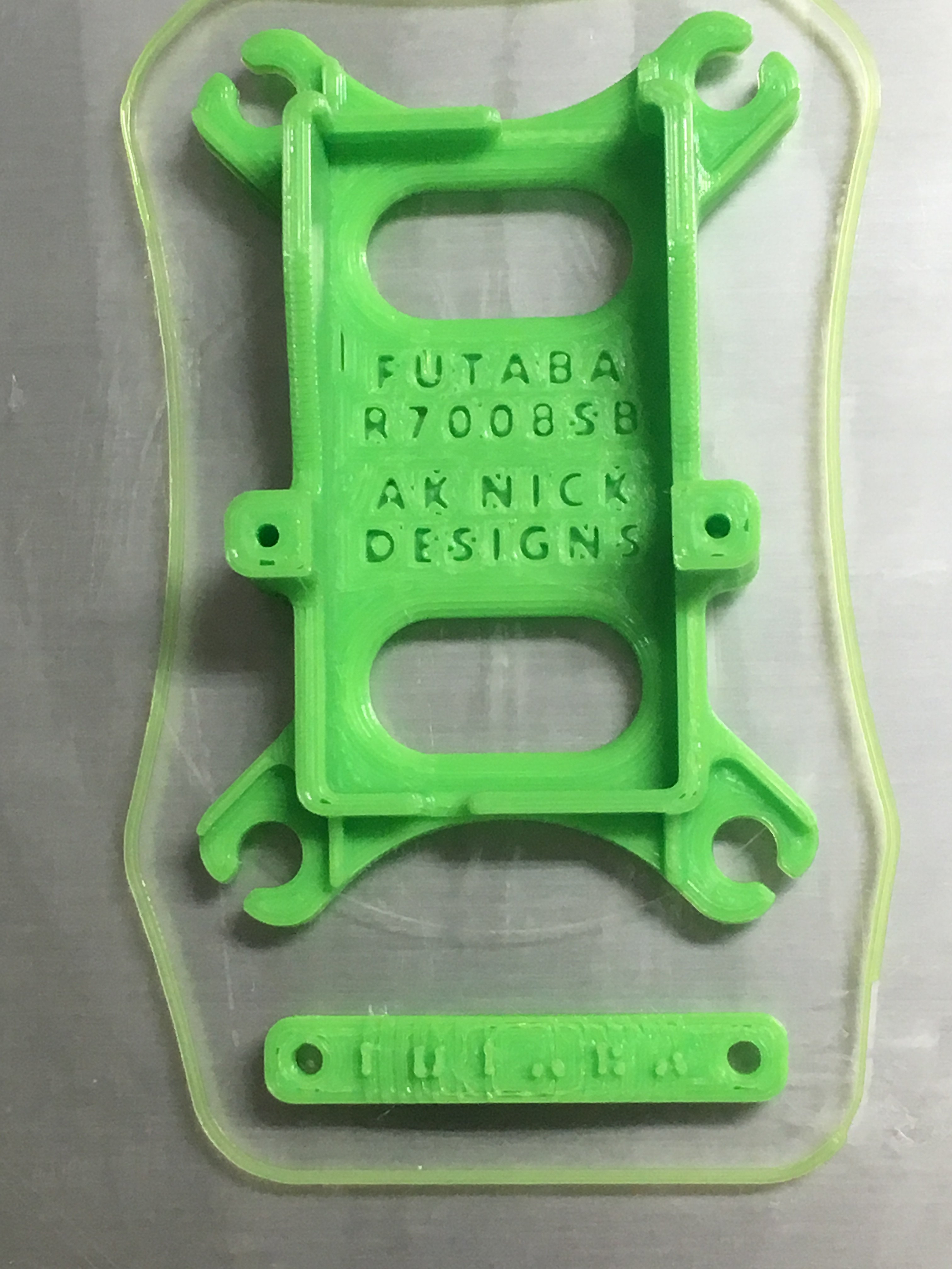

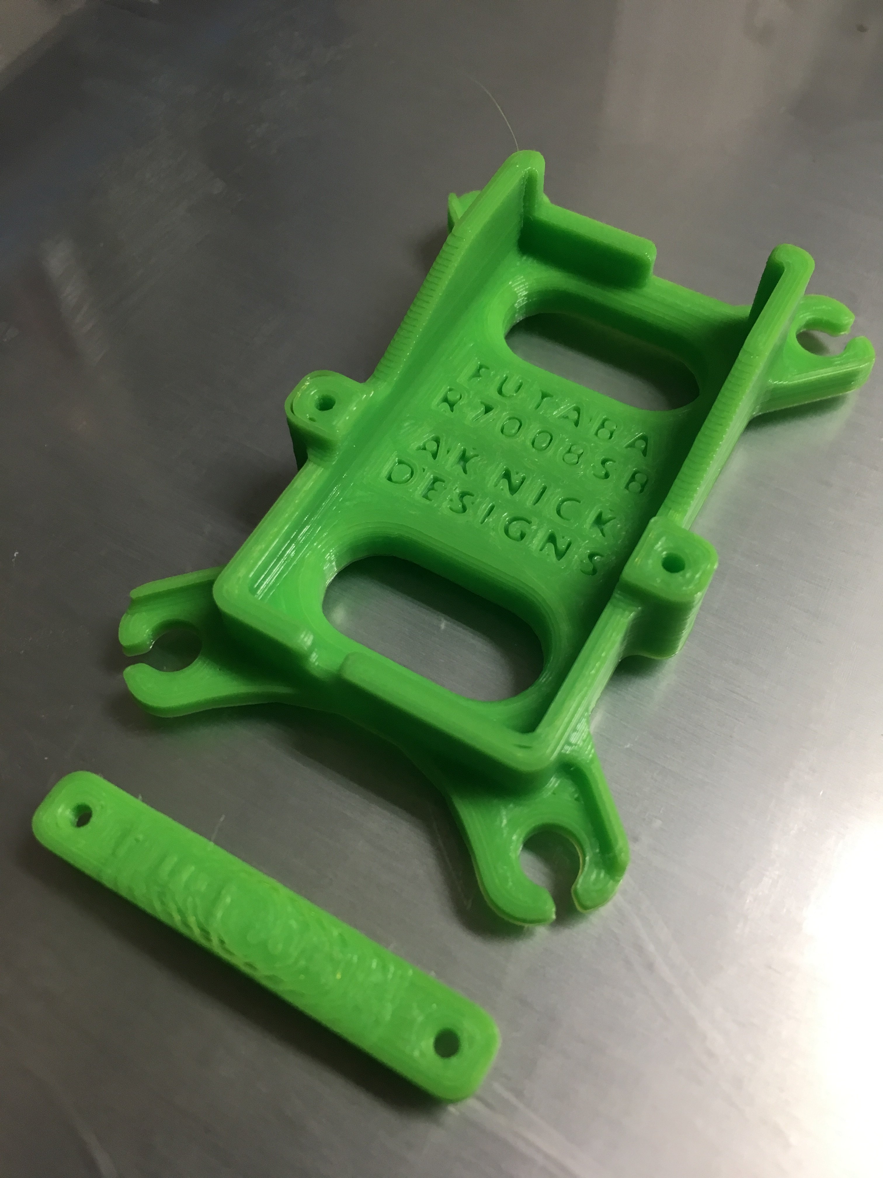

    4F9C0D0E-36E8-4E3D-959C-96FC4C227AA7.jpeg BA3042E7-E8D8-4CA4-B1E3-2686ABDA89C2.jpeg Need to manipulate the file a bit more, couple defects, but a step in a new direction.
  9. Snoopy1
    4,512
    6,473
    Canada
    You need to add a little plastic to bottom side of the cross bar at the screw location. Add just enough so when there is just enough tension across the receiver the two plastic parts touch, this prevent over squeezing the receiver. Just a suggestion.
  10. AKNick
    AKNick 150cc
    1,275
    1,808
    Alaska

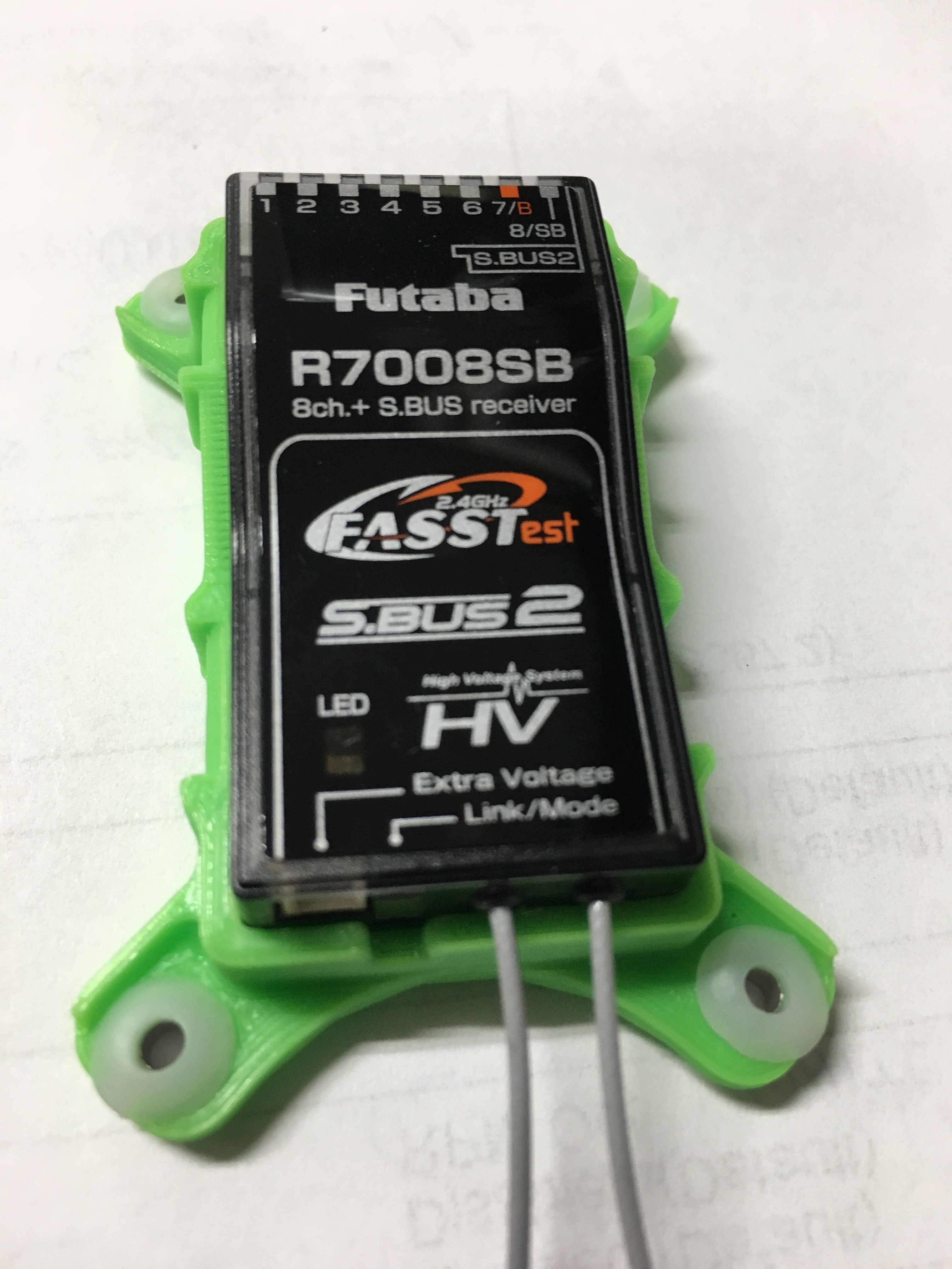

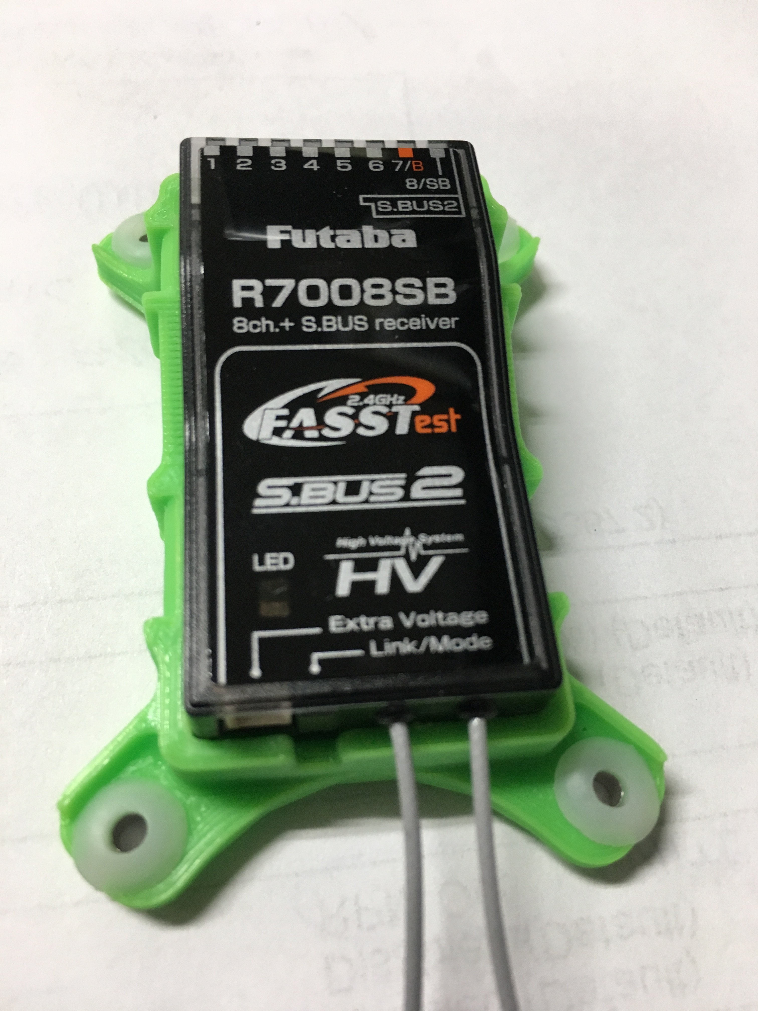

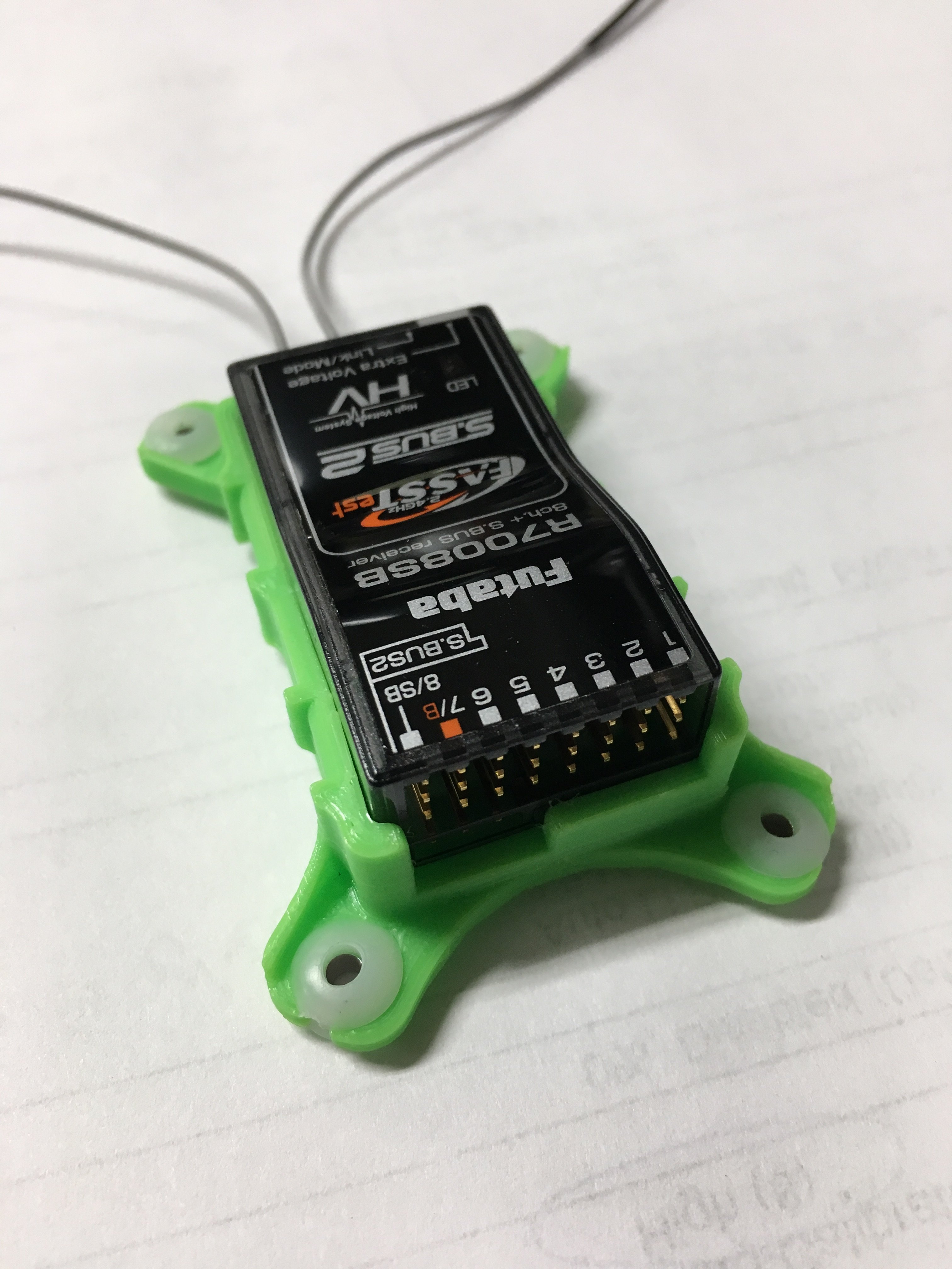

    Oh I know! And done. Still more to improve on. Not sure why the letters are not printing right on the top...
