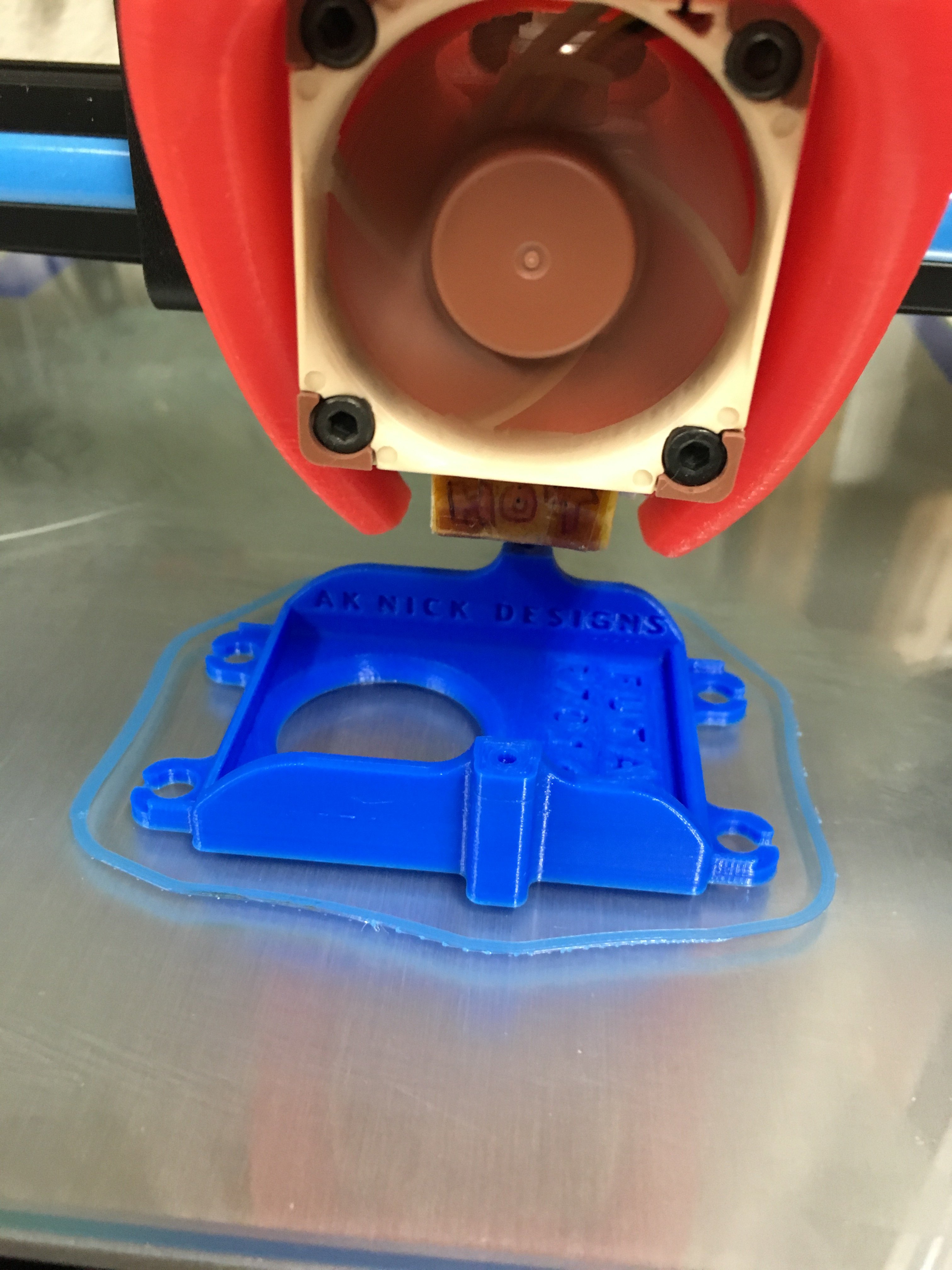

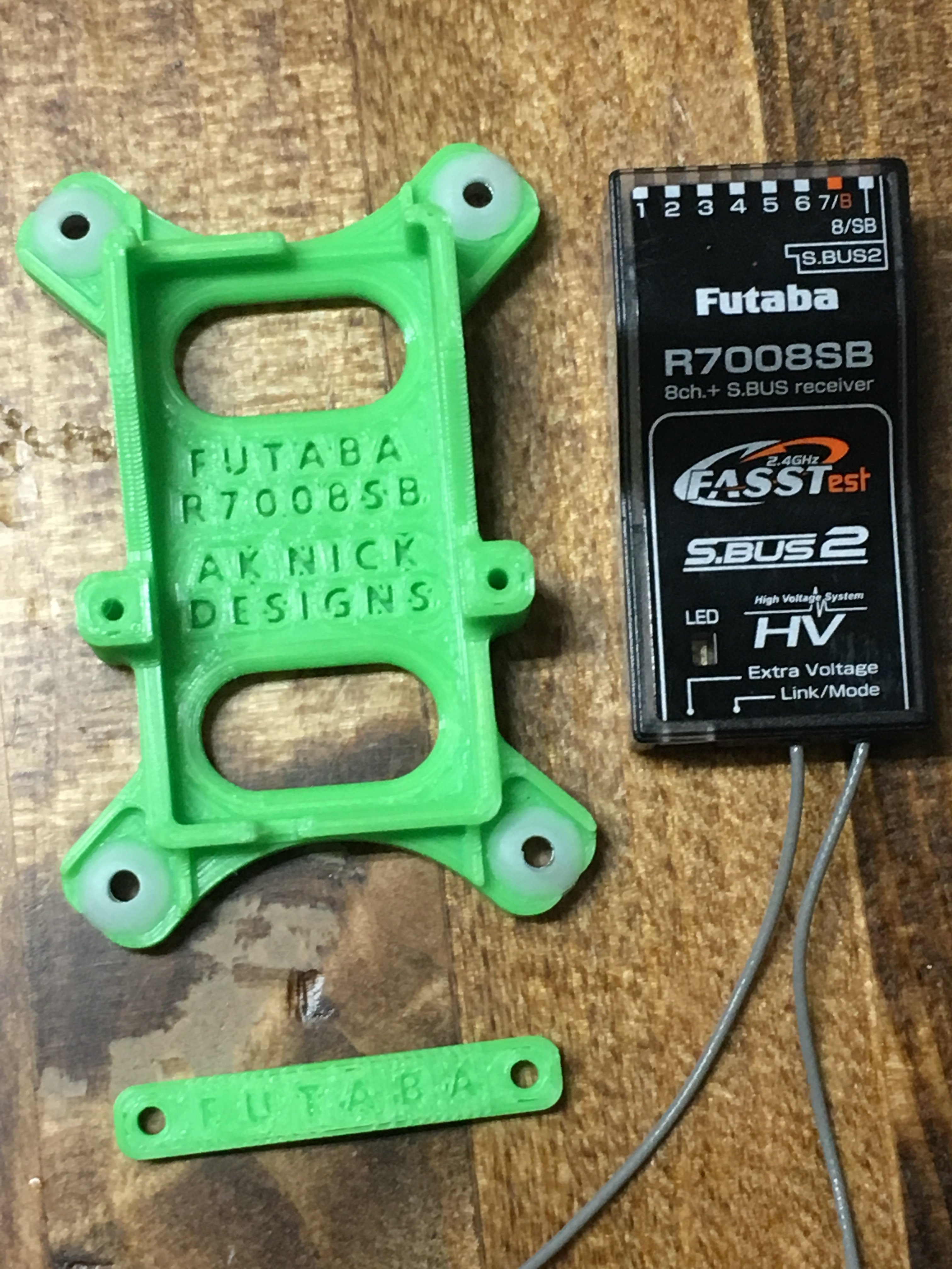

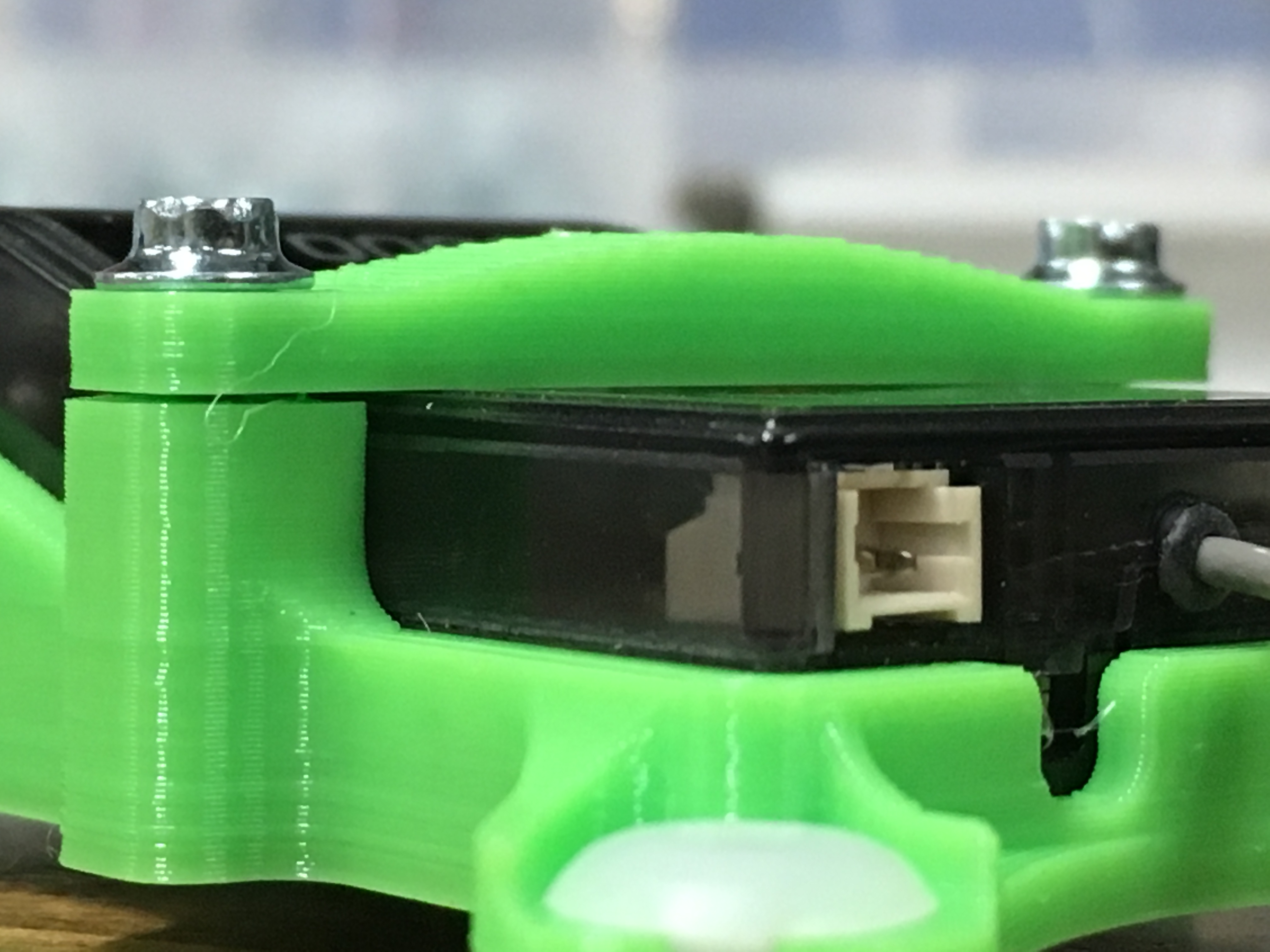

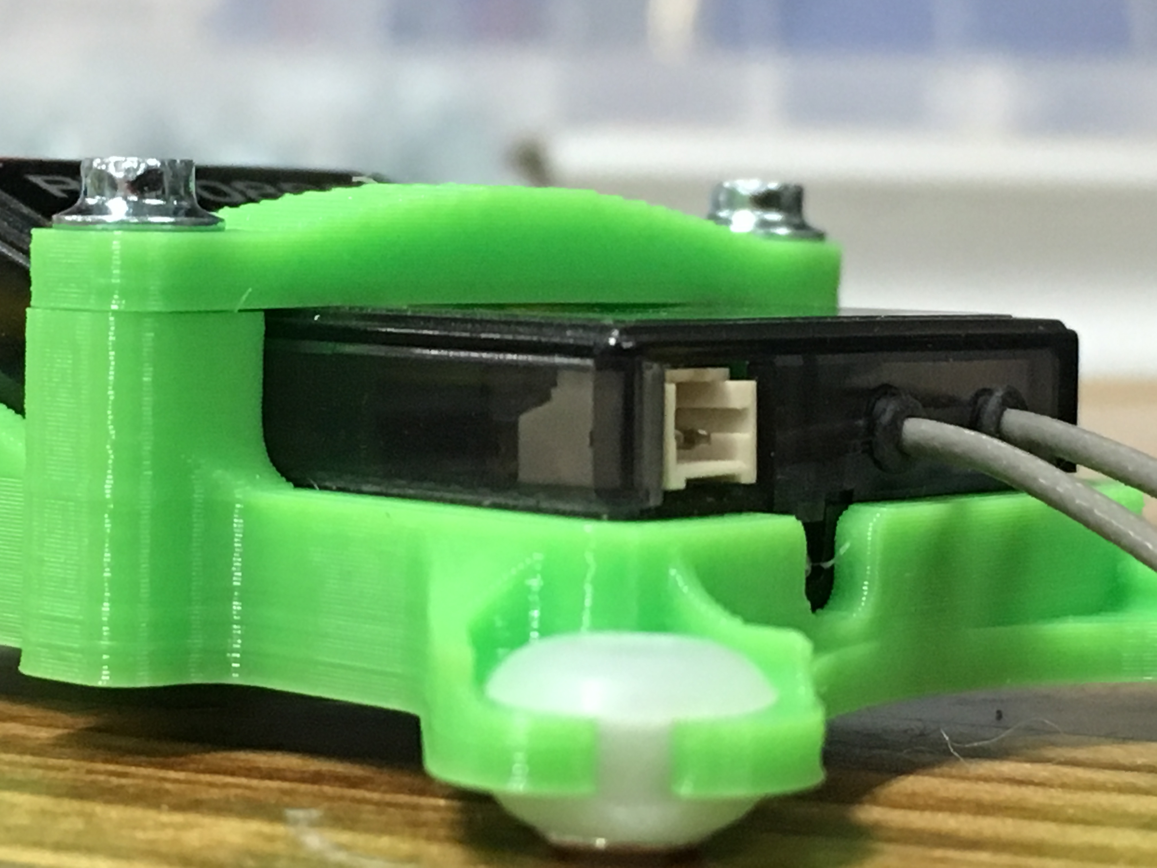

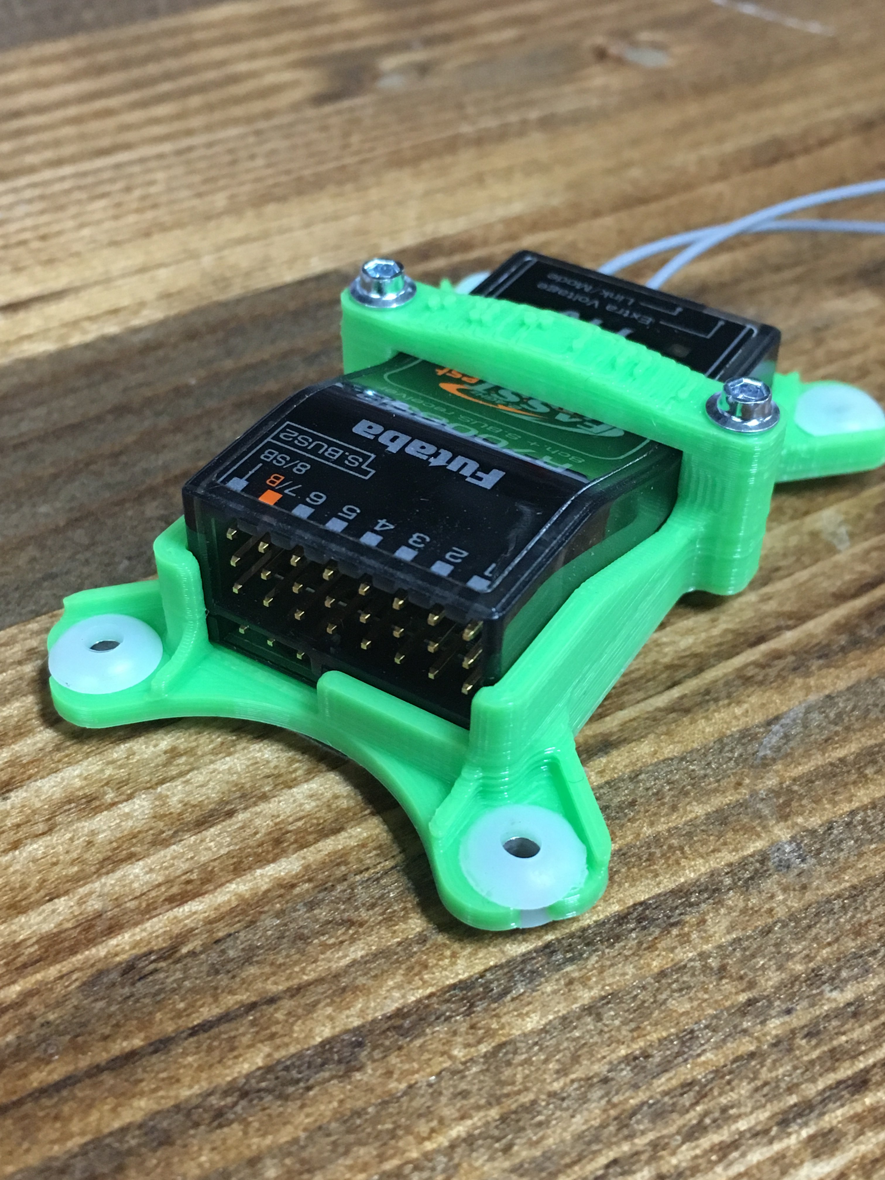

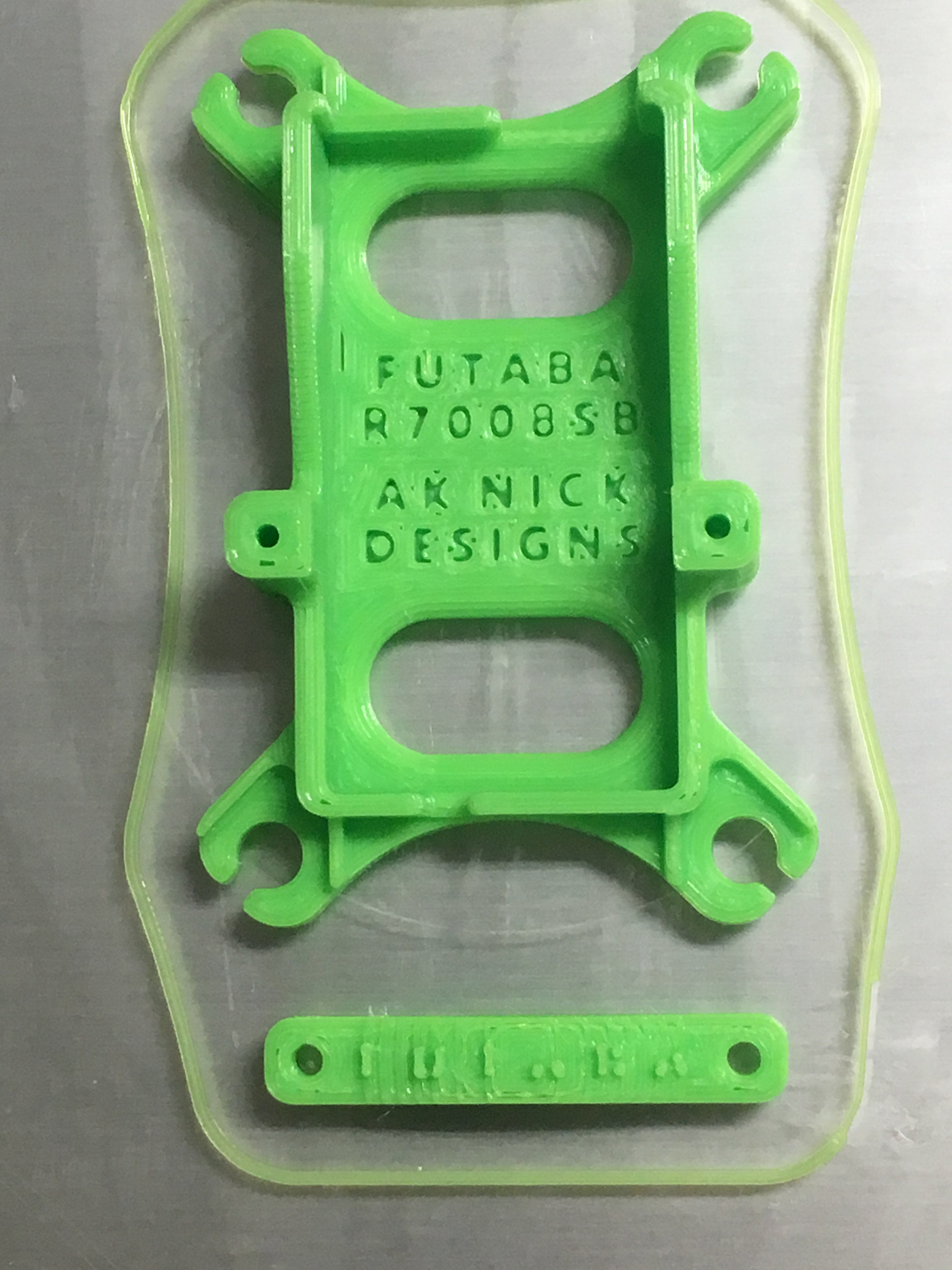

    Believe I made a final version of this. I love the cross bar design, simple, effective, clean, and easy.
    I recessed the Futaba letters on the cross bar and it printed well. Slight flex in the case showes that it’s getting depressed enough. At 50% speed, 1.5mm resolution, 30% triangle infill, it’s taking about 1.5hours to print. I can speed it up, and see if the quality suffers or not.
