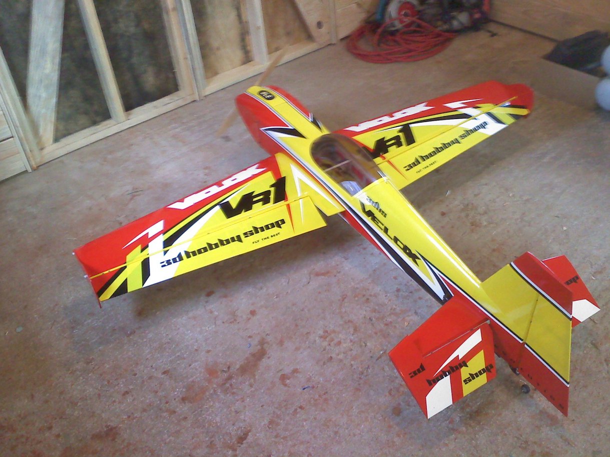

Well hey hold on.... move that battery ahead one length!!! thats where i was with the 20!!! My Bad!!!! had to thro some weight on the back tho with my 30!!! BUMMER!!!=(
Snow Dog in your reply to the request of some details on that 30 setup in the velox... I dont have much to say other than what i already said earlier in this thread that i come in at about 9.5 now that i pulled smoke system out and added a lil weight in the tail!!! thats gona be the MAX dry weight!!! prolly not quite 9.5!!! was only at like a hair over 9 with a 20!!! Im regulating one 2200 3 cell bat for ign. and servos so dont have the weight of 2 bats!!! The regular standoffs for a 30 are a quarter inch to long so that takes some modifying!!! Not sure what it does if you leave em long but... mayb some one has something to tell me about that!!!??? Runnin an 8 oz fortitude fuel tank and its plenty for me!!! I dont ever fly much over 5 minutes and that only burns like a third to half of the fuel!!! i dont do much full power stuff tho... only time i use full power is in a straight up out of a hover r somthin!!! Not as stable as it was with a 20 in it but i dont mind that much cuz LOVE LOVE LOVE the power!!!=)
SnowDog
Jordan,
Thanks for the info...that thing must be a beast on power with a 30 in there!
If you left those standoffs long, that would require even more tail weight, I think...so good that you cut them down.
yea snowdog that 30 is fast in that velox!!!=) i have become convinced along with my flying buds that 30 is the way to go in that velox!!! that weight i added with that 30 made that sucker lock into a harrier!!! and STABLE!!! WOW!!! like it is quite a bit better than with the 20!!! even the guys watching said the thing just just looked like it was more fun flying!!! if you go to 'ask joe smith' forum and look at where someone asked him 'Is lighter always better?' and you will see what i mean!!! thats the only explainable reason i can come up with!!! but i am SOLD on that setup... not going back!!!=)
