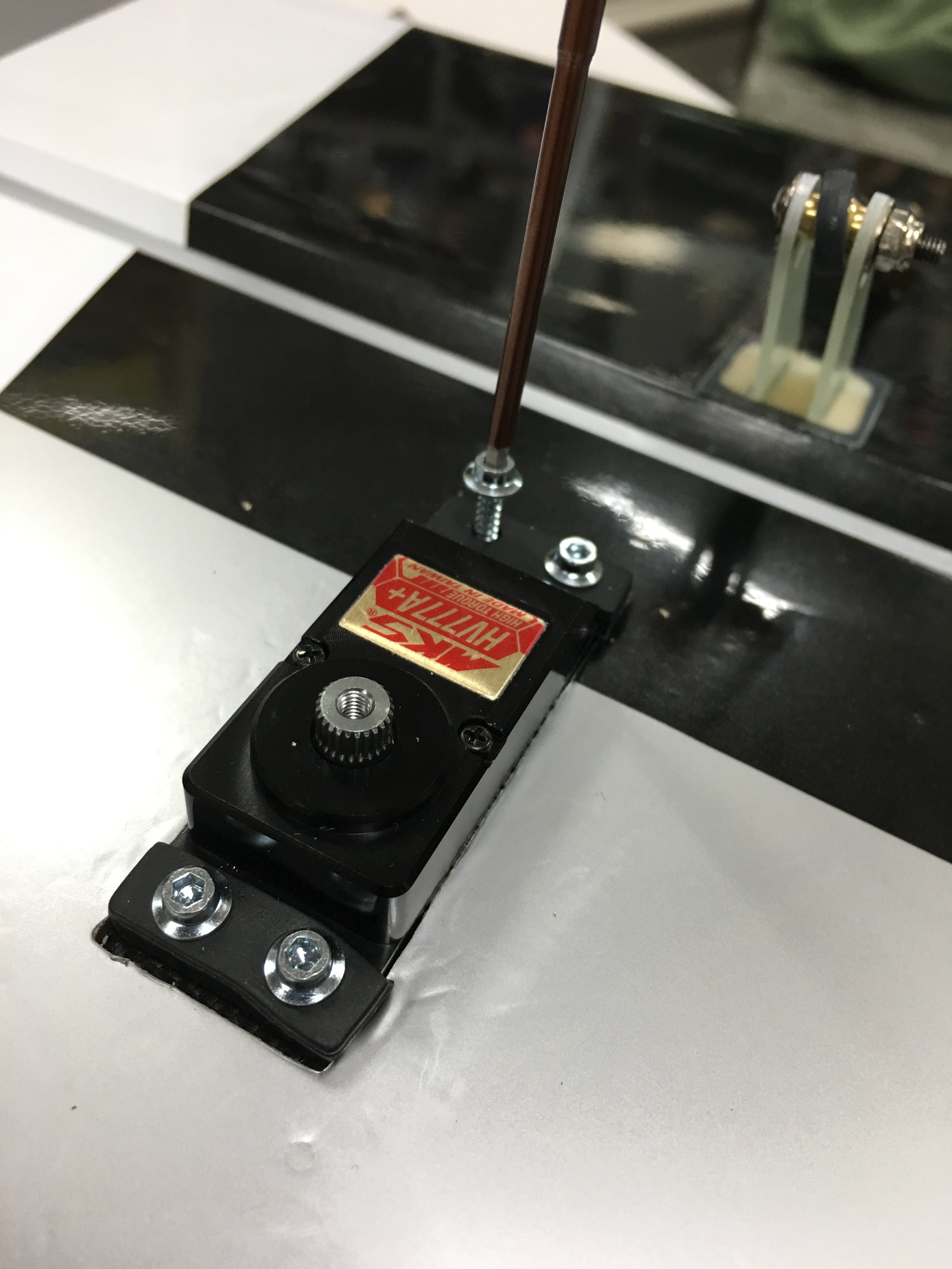

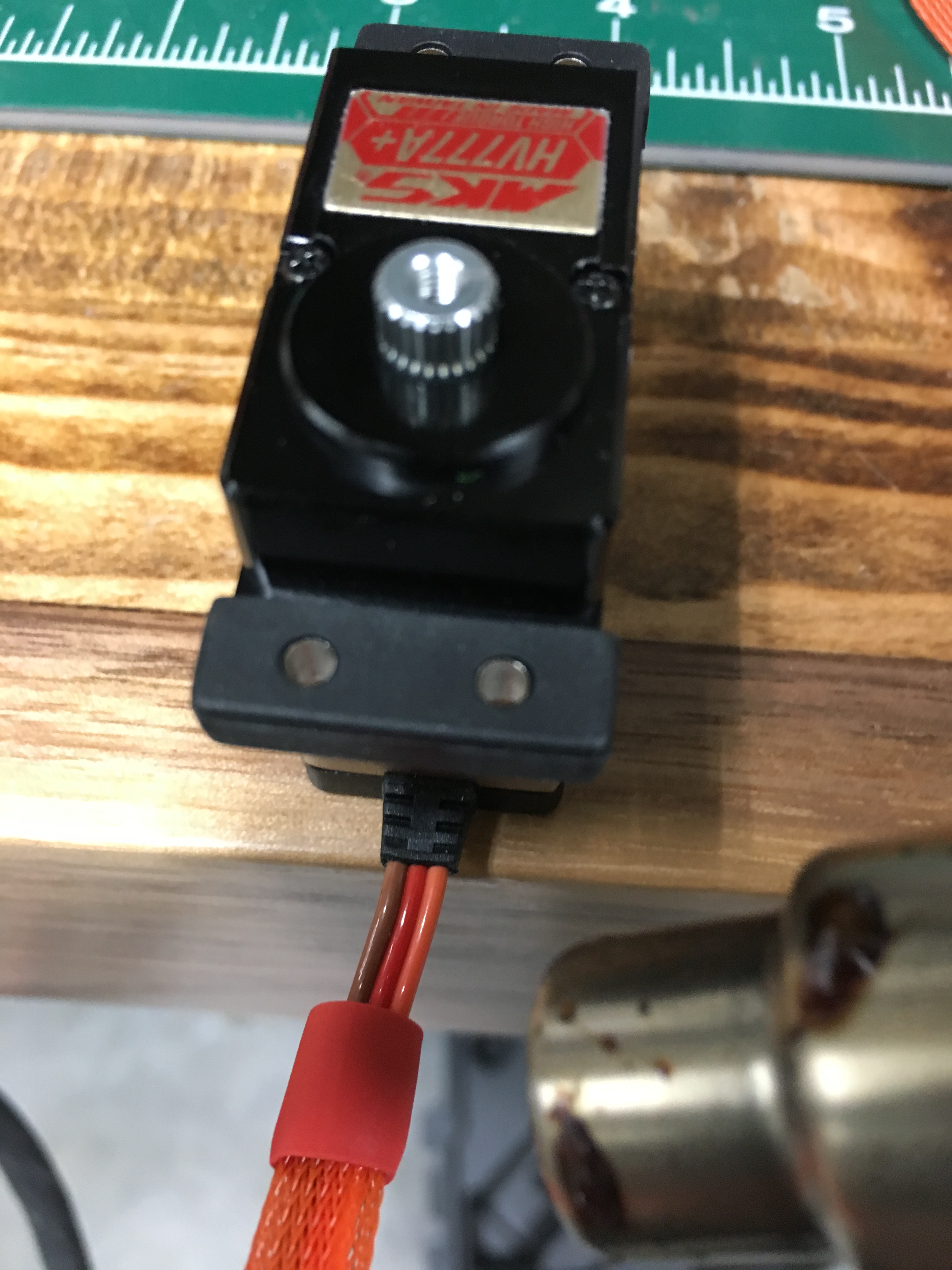

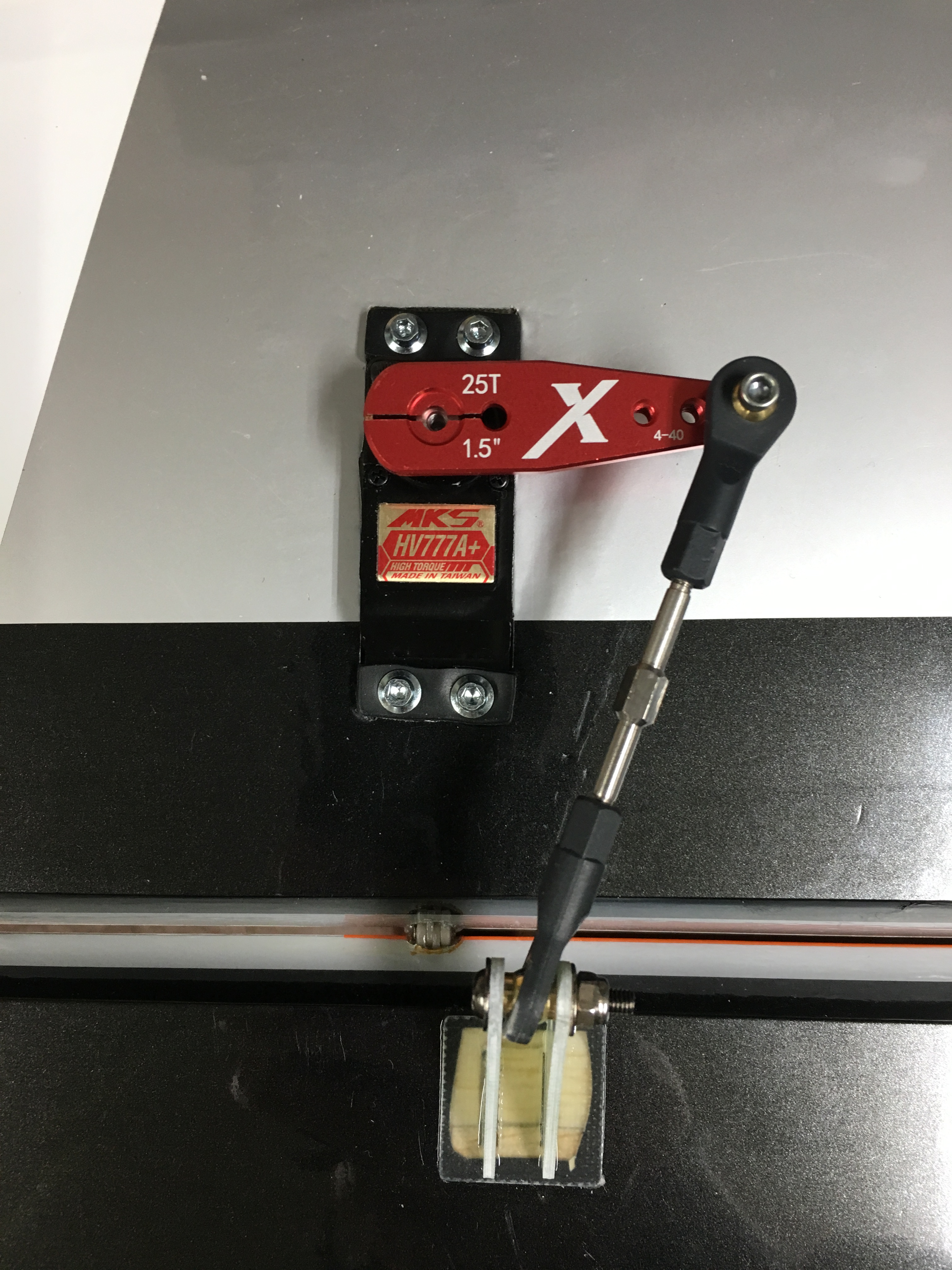

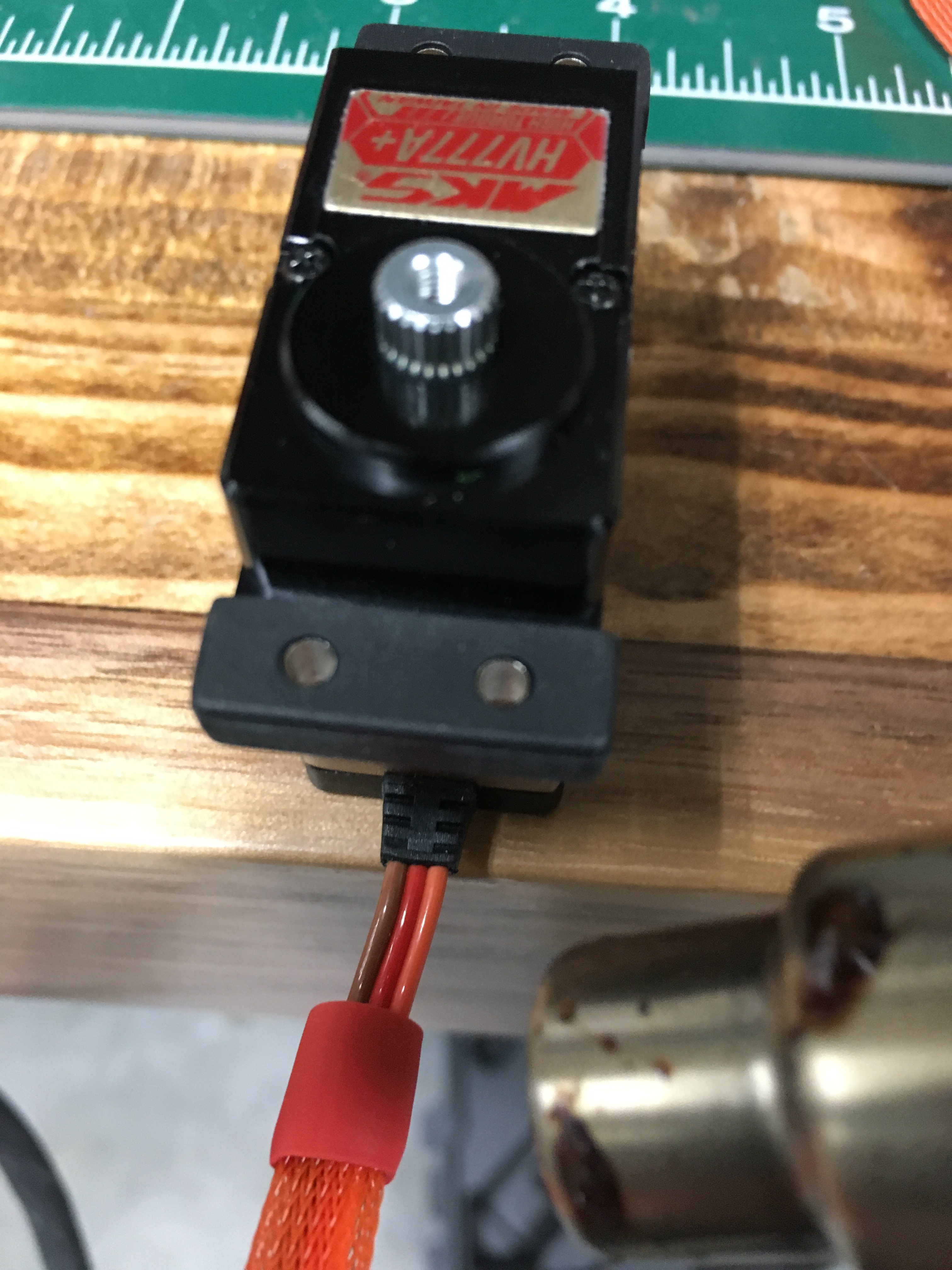

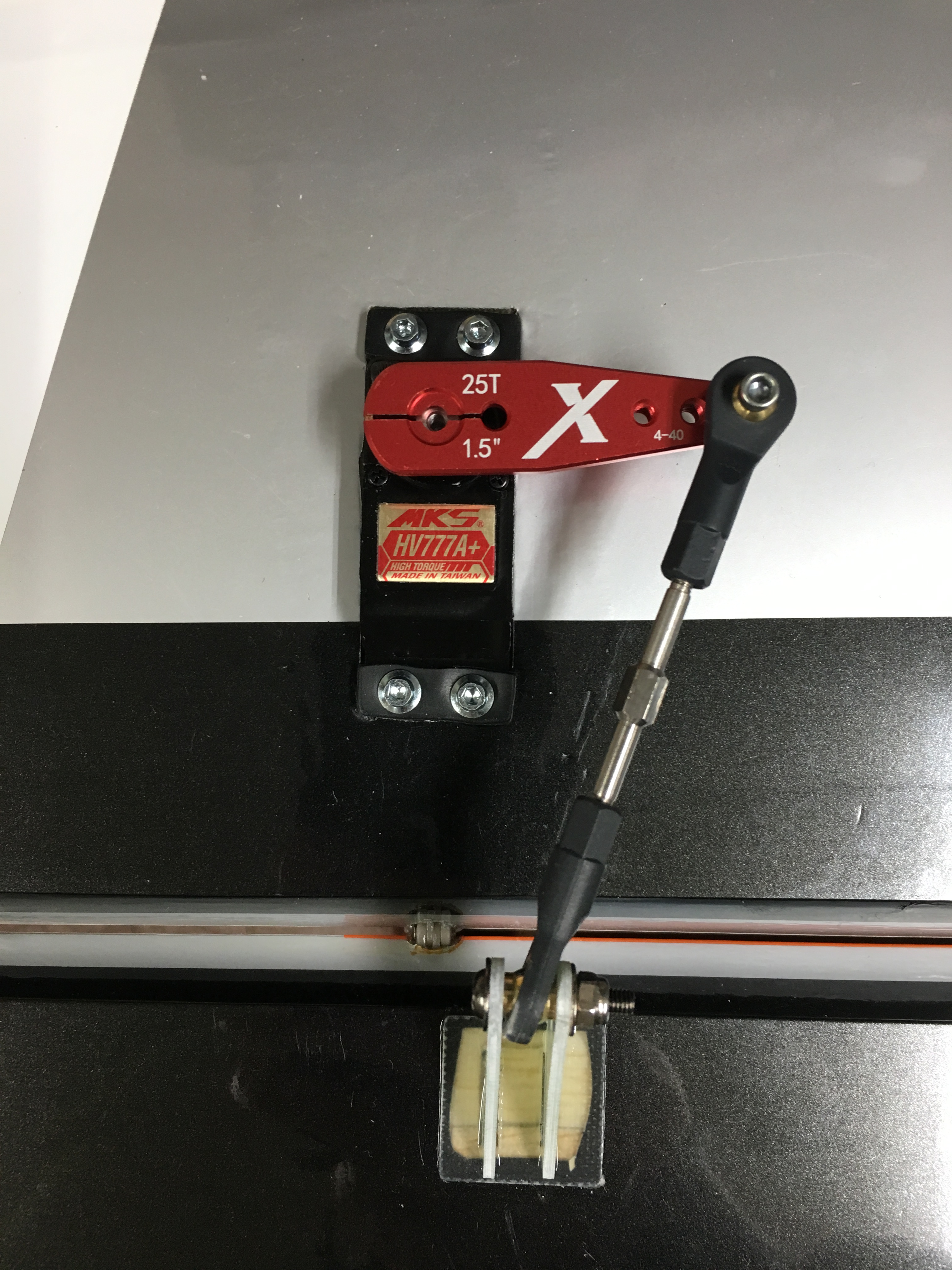

First - the MKS777 gen1 do not fit. They are too deep. I tried shims but it messed up the geometry for down deflection (the control surface horn hits the servo). However the MKS777A+ fit just great (overkill alert!!!).
Second - Aileron deflection for optimum roll and control should never exceed 38 degrees. Learning that you should start at about 40 and adjust it down or up from there. Anything more will actually slow the plane down in a maneuver and fast rolling. I have found this to be true when trying to rifle roll at high speeds with another plane (I said trying... no I cannot rifle roll).

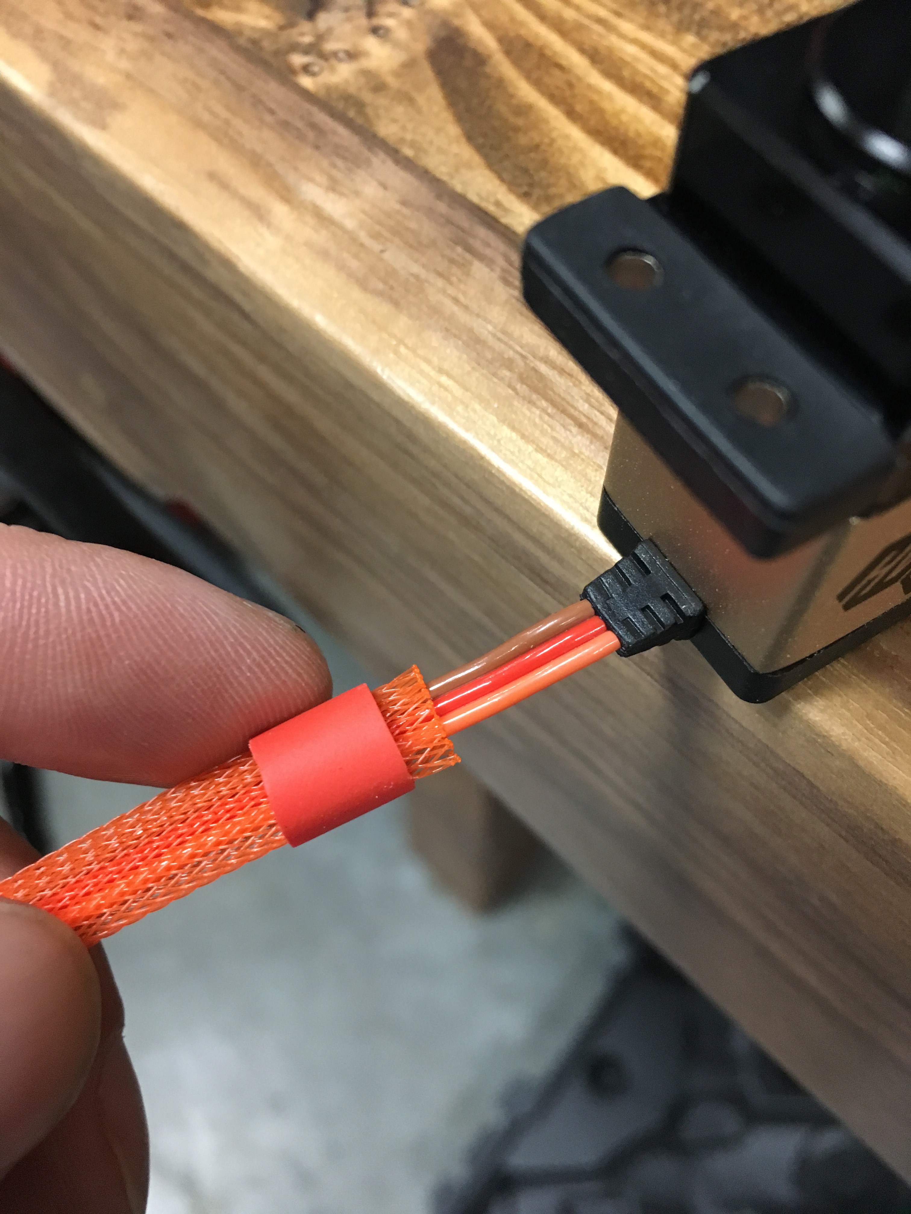

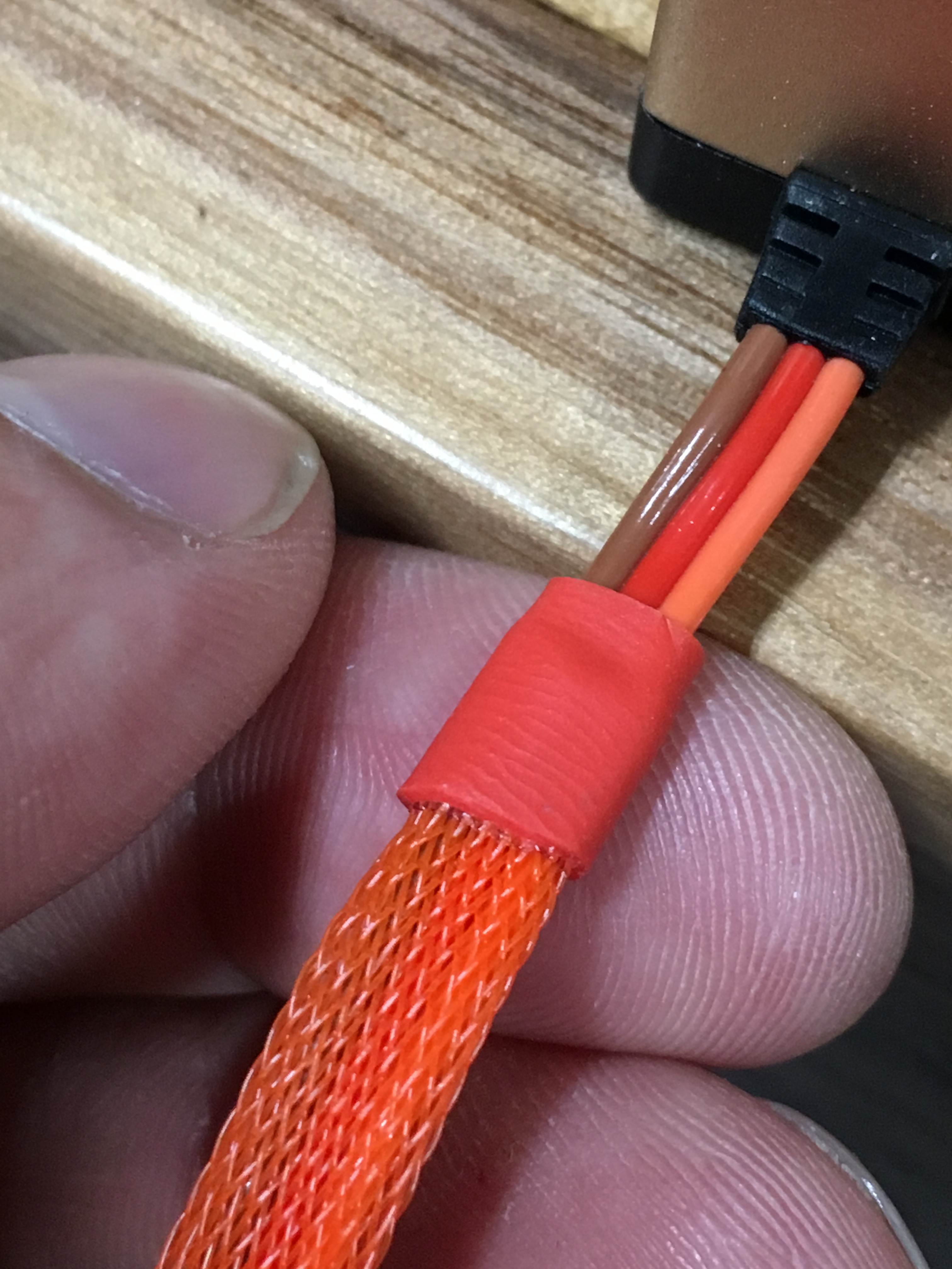

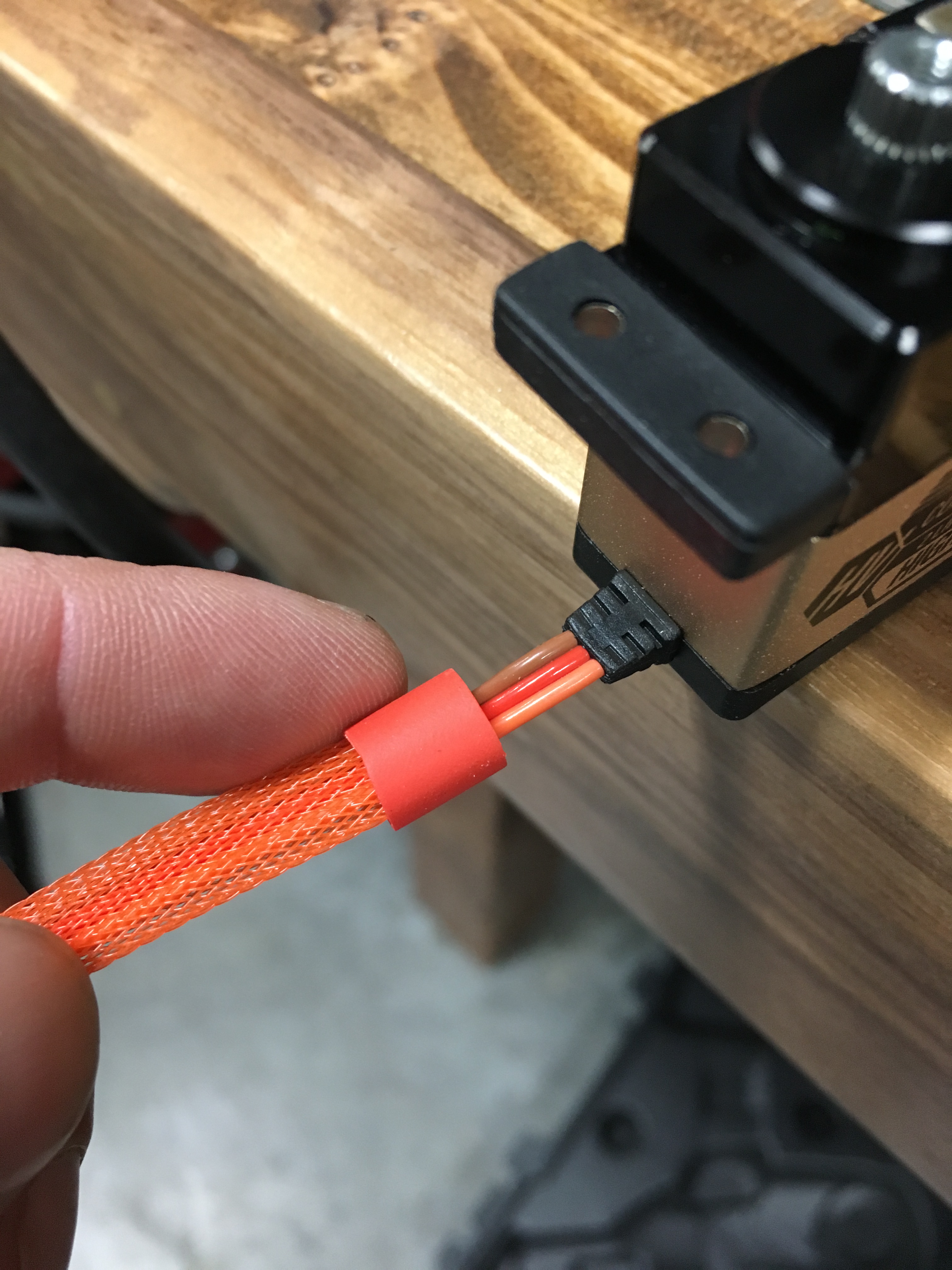

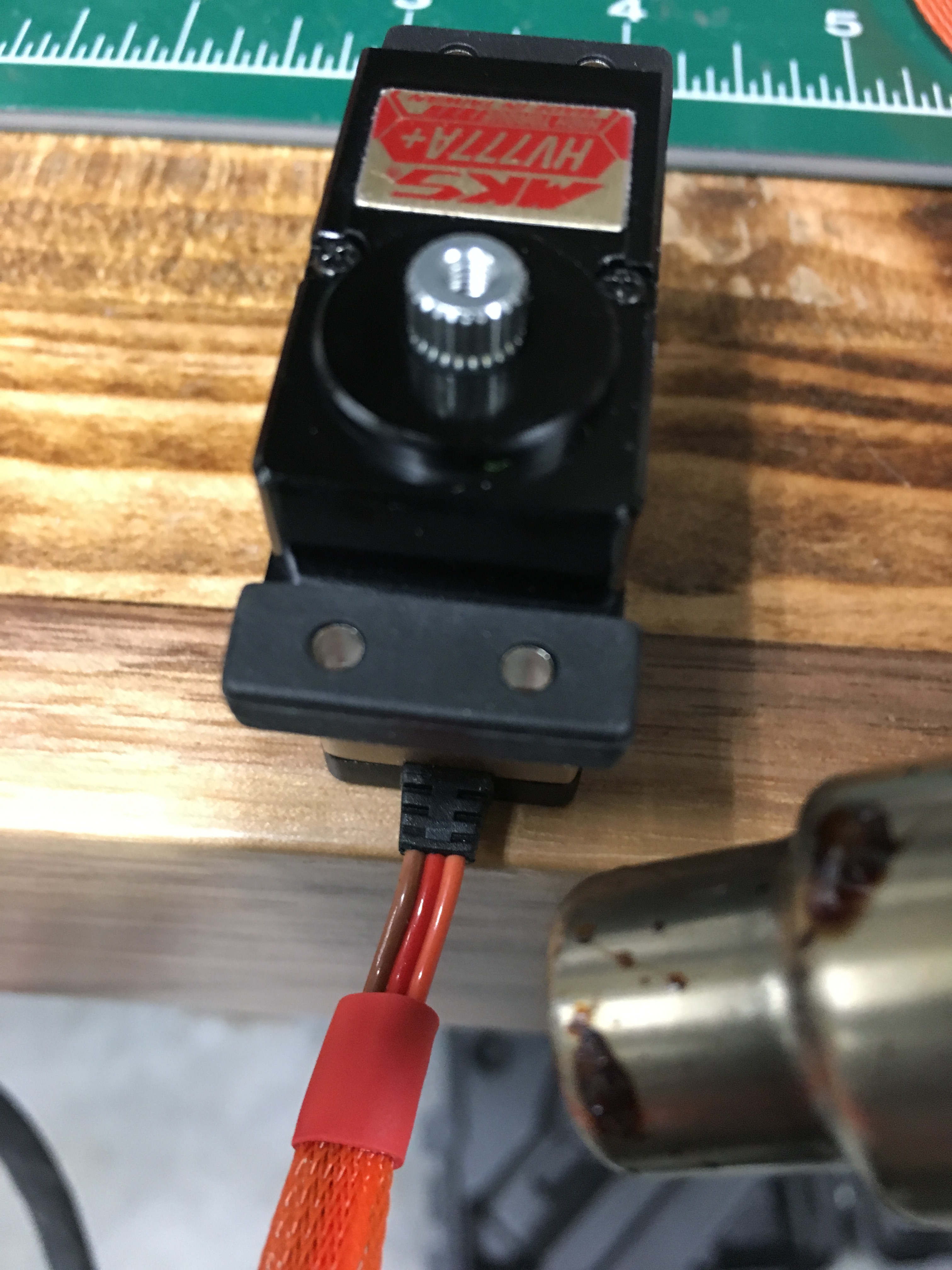

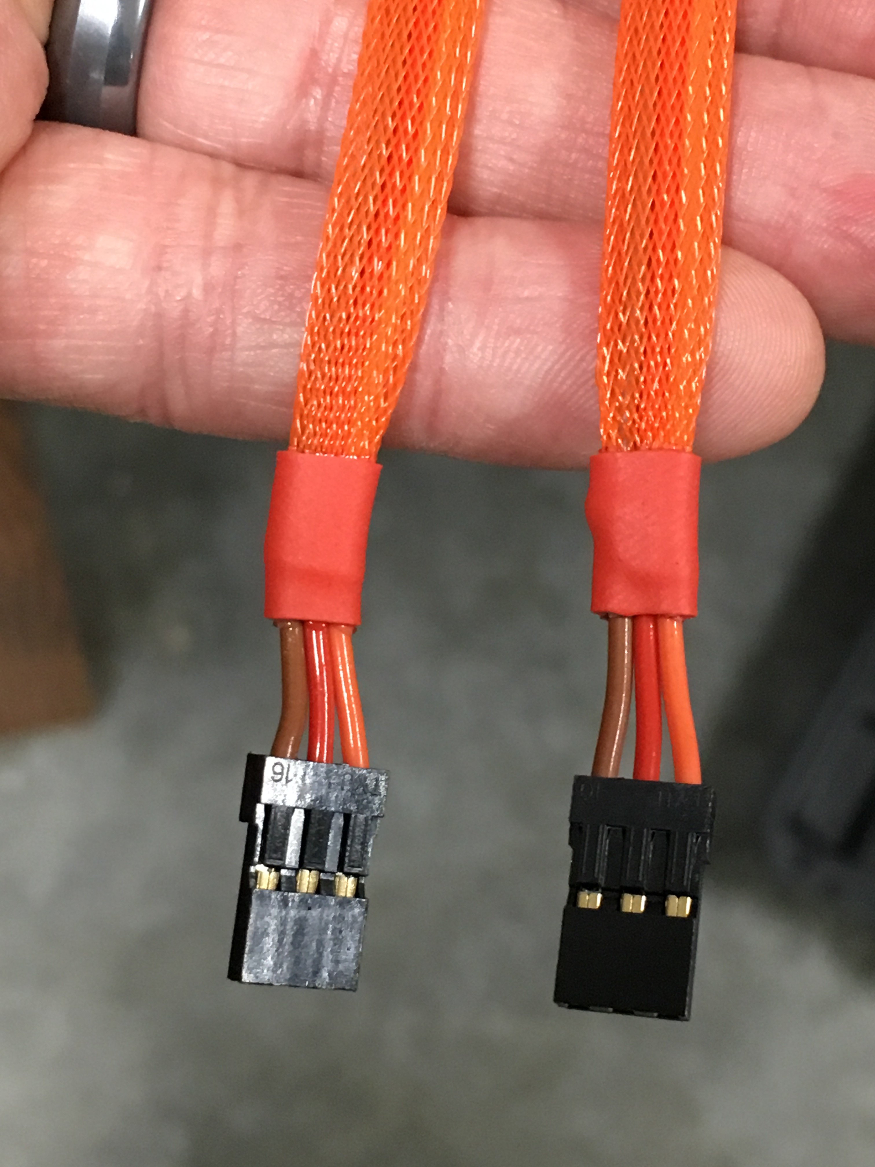

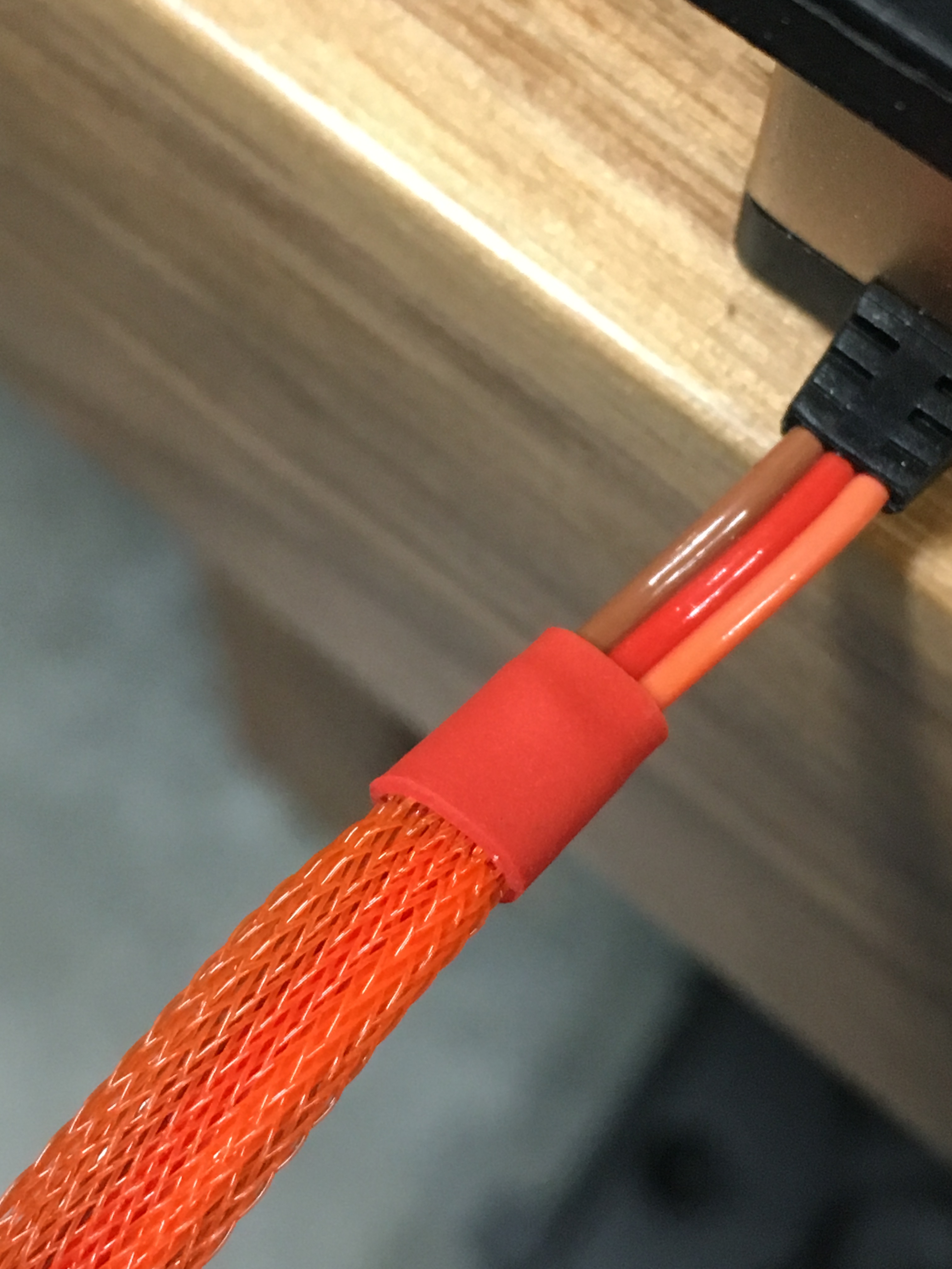

Used some snake skin looming from TDRC (the orange) and some red marine grade heat shrink. The marine grade heat shrink has adhesive inside which sticks to the looming and servo wires - keeping it from sliding all over the place (staying put).

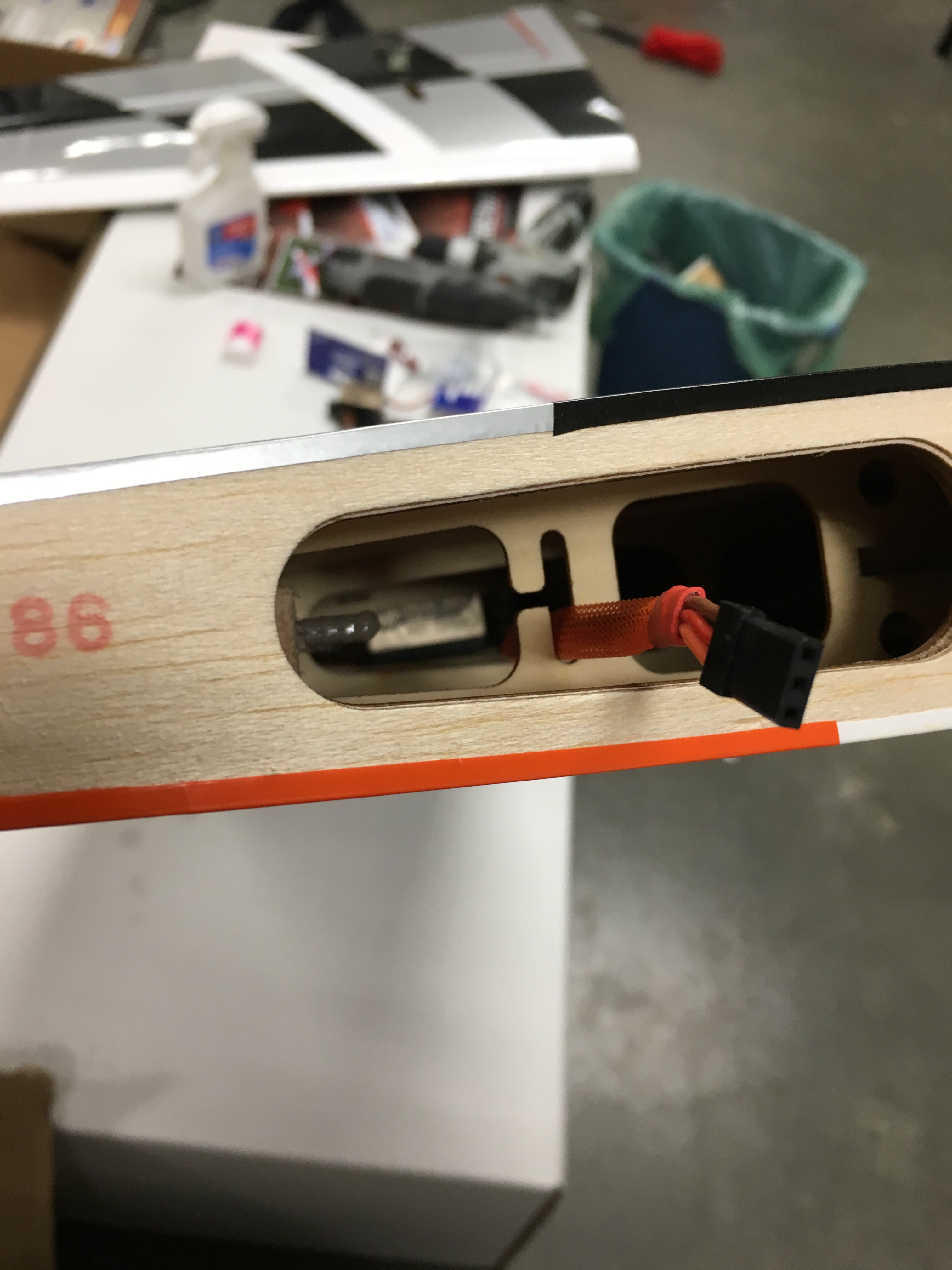

I love that they made a slot to keep the wire towards the end of the wing so you don't have to fish it out all the time.

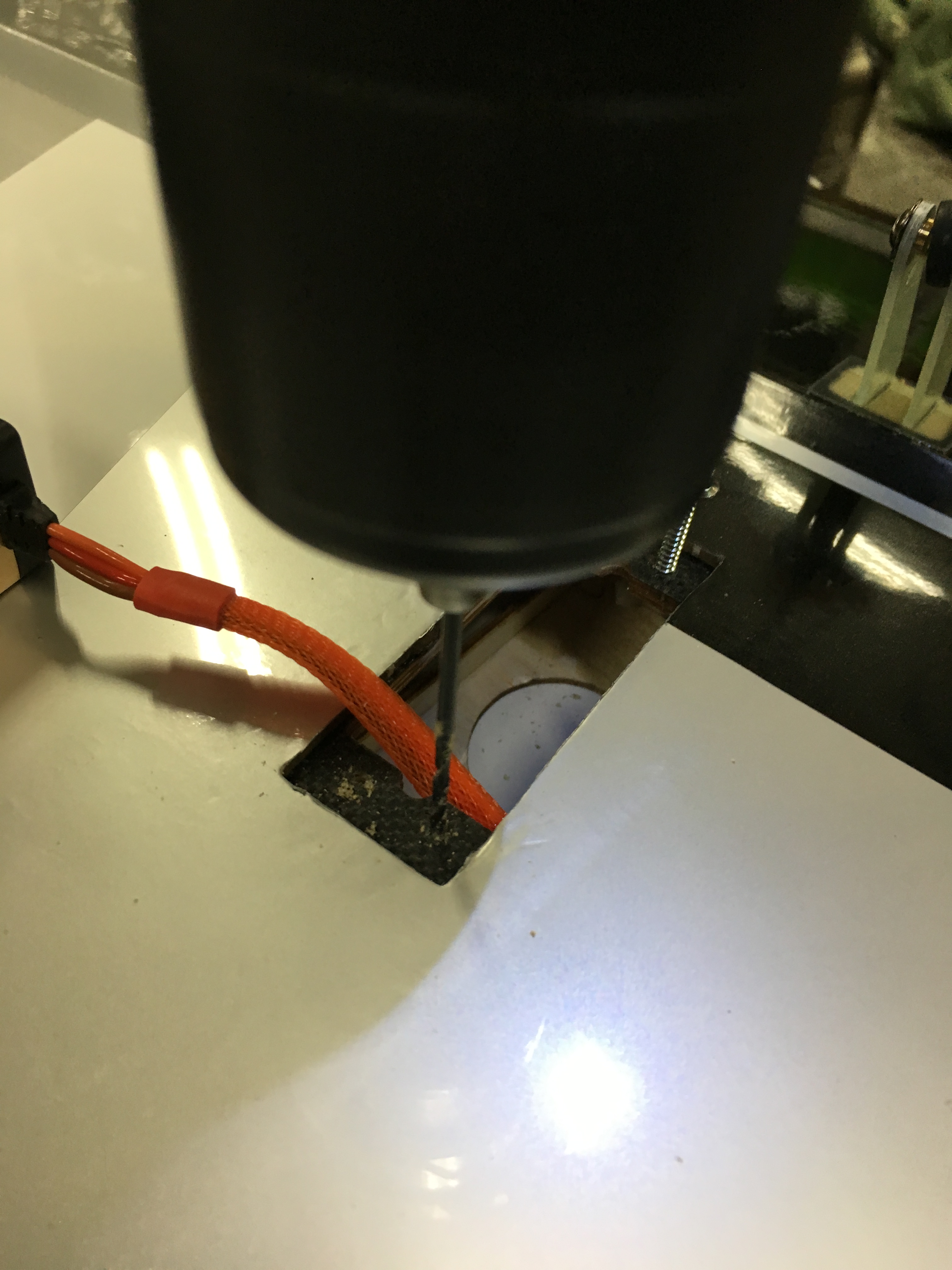

Drill, Tap, cure, and bingo.
