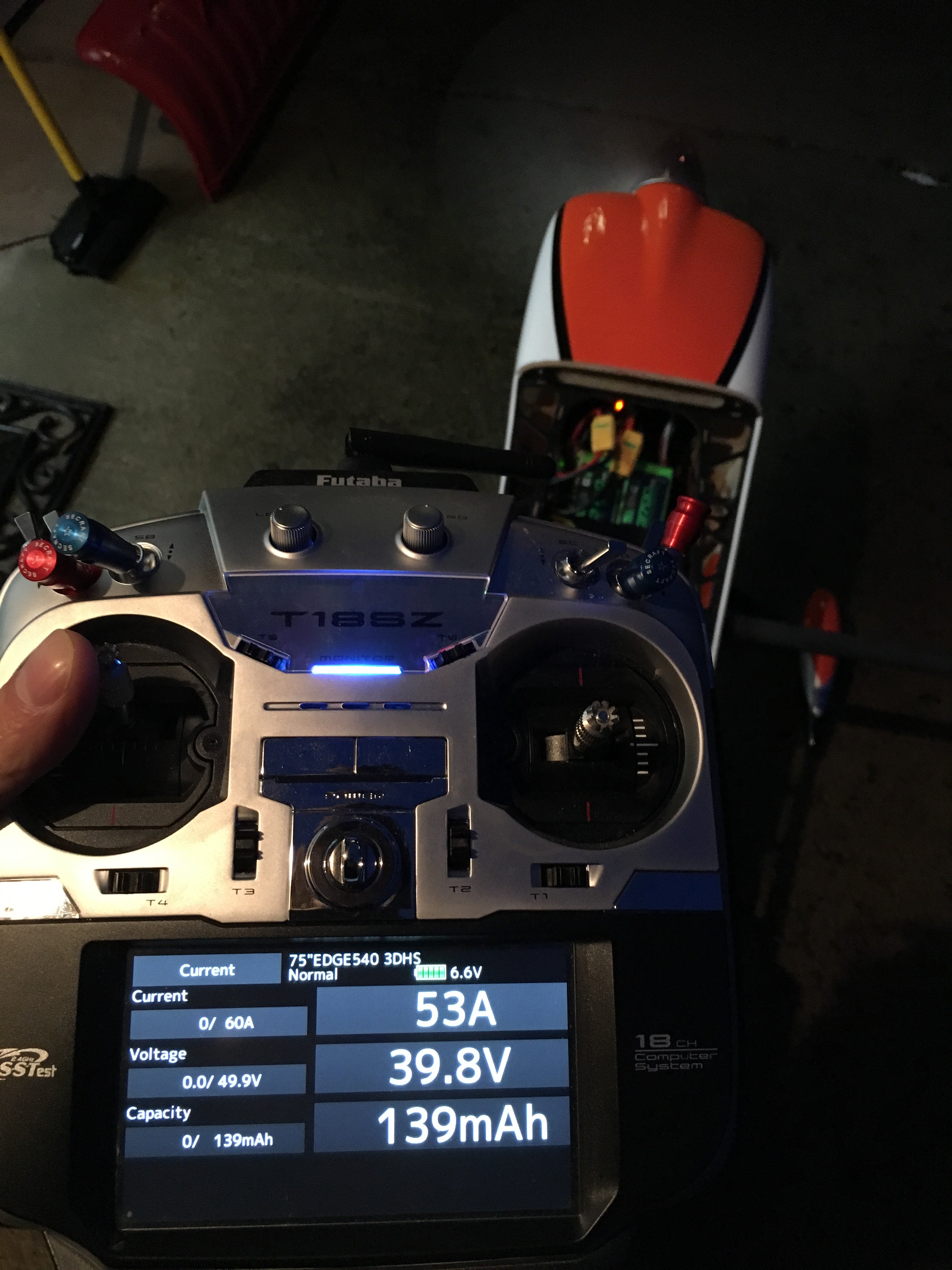

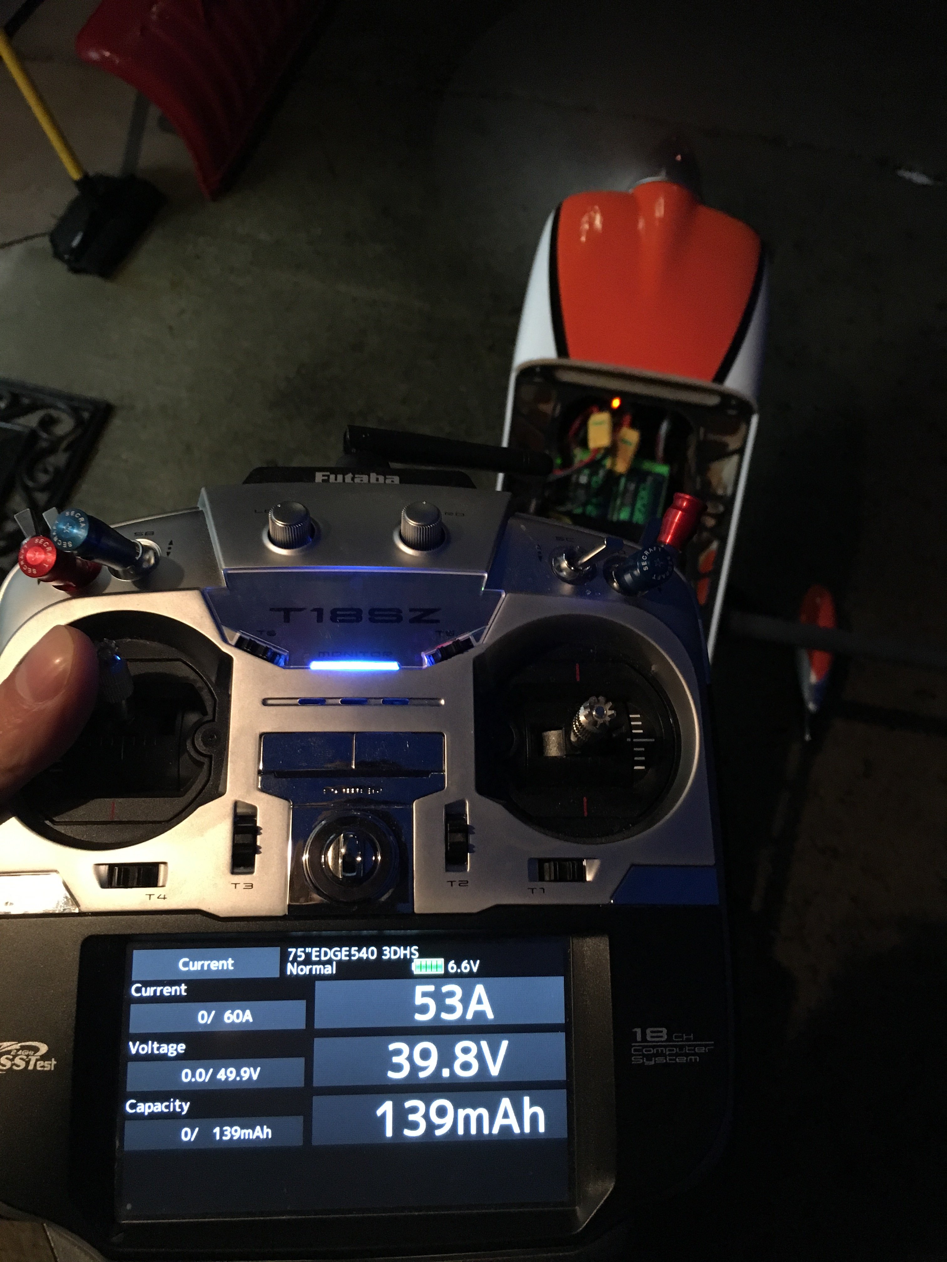

Kindof interesting. I did some more run ups and noticed my Tx will show live current, but also shows the min/max. Logged a 75A burst on that screen after a run up. This was on my two tired Pulse 3700's 6S 65C batteries. Since the ESC is rated for 80A continuous and the current meter is rated for 0-70A continuous, 70-150A within 10 seconds... which I think is a very long time unless your name is Jase and you do circles while rifle rolling at WOT... At any rate, I think this is an ideal setup. Assuming that draw was from 0 rpm to WOT. I'm curious to see what it logs in flight and with my newer revo Lipos.
