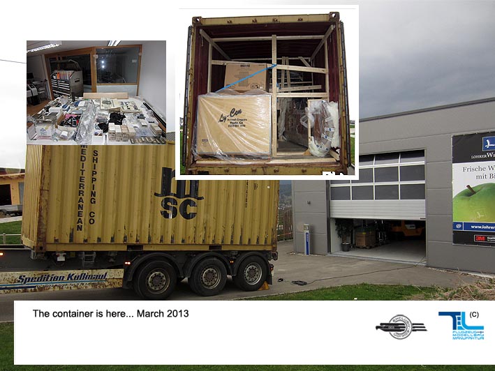

I MADE THE DEAL and two weeks later we were on the trip to the States. ( Its better to do the crating
by yourself for the long trip to Germany )
OK to make it a littel shorter: In March 2013 I had my 100% EAGLE at home and started instantly
to work on it.

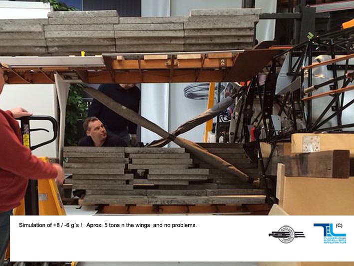

I'm curious to know the reason for the wing loading test. Was this for certification in Germany?

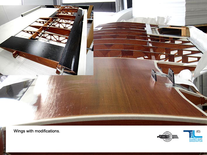

info to the work which is to do: fuselage and tail is already done for nearly only "scewdriver" work.
To do the wings: with the parts and the Quality they are made, the ready formed wing-nose, redy
formed wingtips..... you will Need max. 30 hours for a wing ready to cover.

Yes, we have to do that for experimental aircrafts - but I think this is a good Thing, you know before
you are pulling the max g´s if you are safe. In the next 2 weeks we are doing another final test with
the fuselage / Tial and Engine load. Therefore we have to load a Special amount of kg´s at the engine,
on the Elevators left and right, and non symetrical on the tail, and on the Pilot´s seat.
If this is done and documented, there is only a few cables,hoses and we can start the engine..:)))
