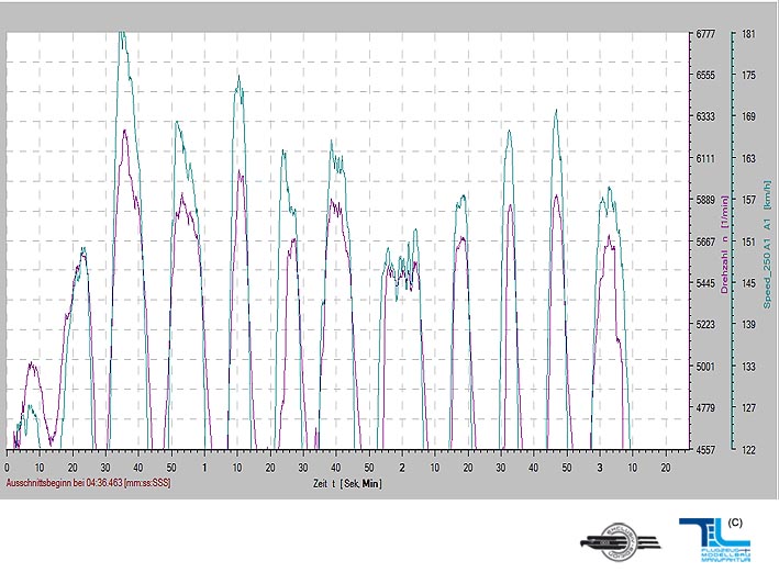

At 187 km/hr that would be 116 mph. Can that be correct?
Running the numbers assuming a 2-Blade prop, 36 x 14, your tip speed would be supersonic (320 m/s) at 6700 rpm, and only 89 mph, requiring 48 HP
At a more realistic 230 m/s would be 4800 RPM, 64 MPH, and only 18 hp.
Please Confirm.
Hello Matty,
we get the data from the telemetry sensors on board. The following Settings were on the aircraft:
We did some flight tests with a higher weight, to test the reactions in flight so we tested
a weight of: 62 lb´s
The Propeller we used is a 3-blade ( FIALA) 32x14
The v-max was measured after a dive at a low-pass over the runway.
The Speed is measured with a real pitot-pipe ( not gps ground Speed ) -> 183 km/h
the rpm was at this Point: 6260 rpm

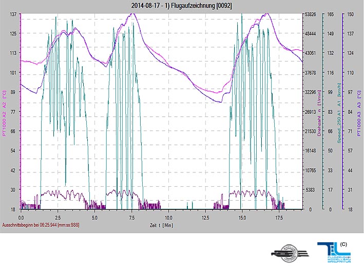

The max horizontal Speed without a dive before is about 165 kmh with aprox 5400 rpm
-> see the part of the diagram 2.
Thomas

I'm surprised the Valach 210 would turn the Fiala 34X14 3 blade. Very cool.
