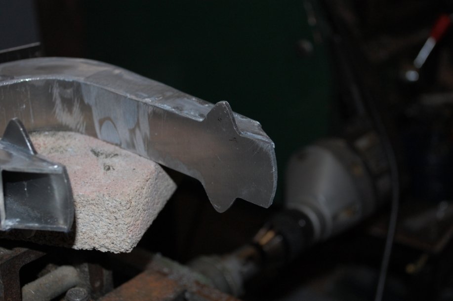

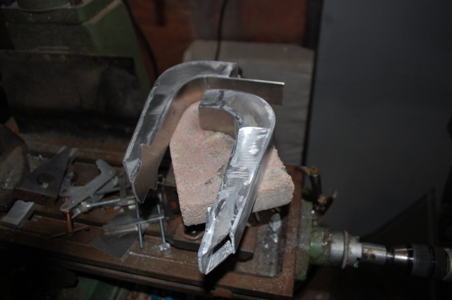

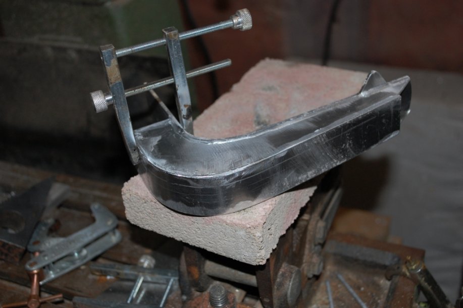

completed the two wheel attach I guess you can call this, but still some filing and sanding , then on to the oleo struts

The welding goods great, is there a flux used with the process?
Thanks Tony, no there is no flux, you simply clean the two parts to be welded, to remove any oxidation , Heat the two parts checking with the rod .
The temperature has to be hot enough to melt the welding rod, but not the two parts being welded, also the hot parts melts the rod and not the flame
I'm not an expert and still learning.
