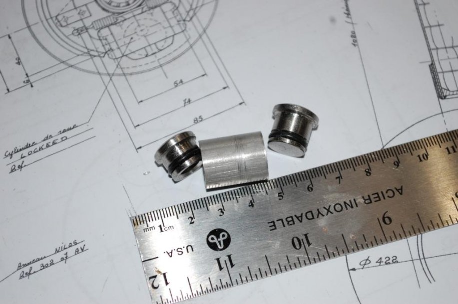

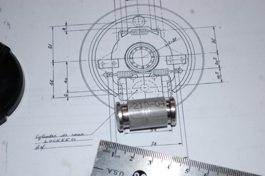

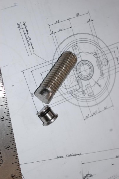

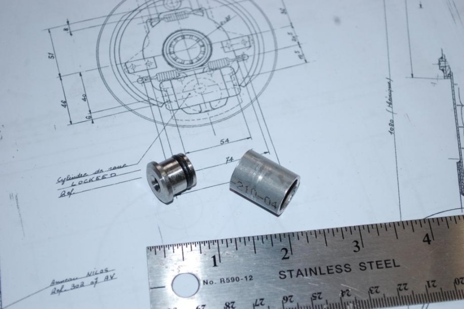

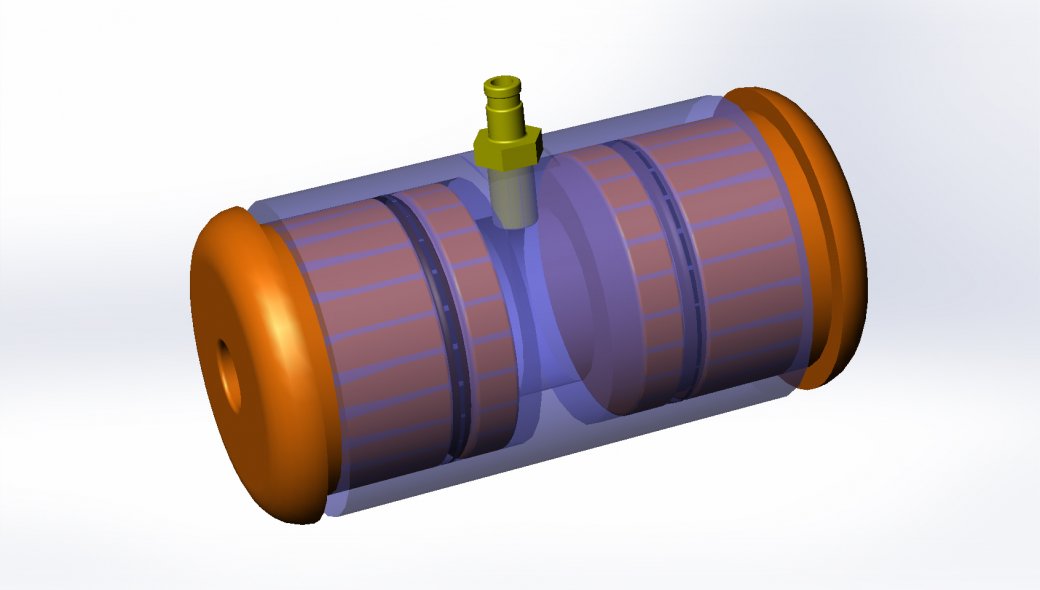

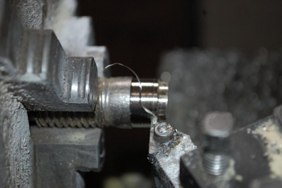

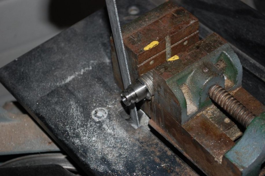

wheel brake double piston made out of stainless steel one is slightly longer then the other, because of the hydraulic intake on the cylinder, which is not done yet, but the cylinder is

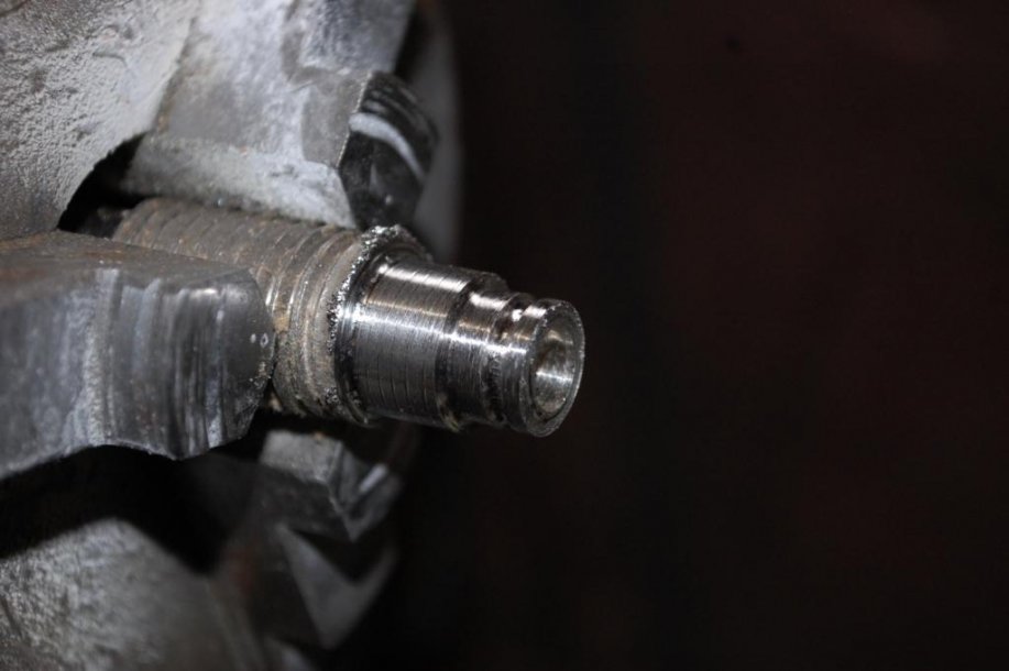

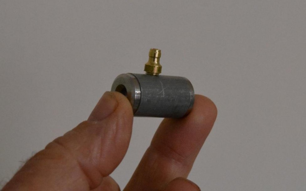

alors les photos precedente sont ceux de mini cylindre de freins, que je dois construire

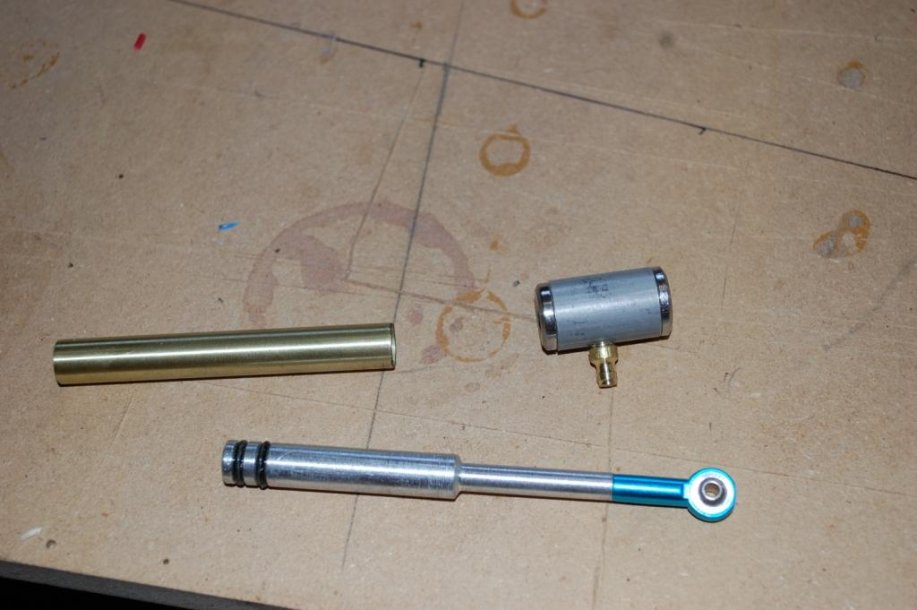

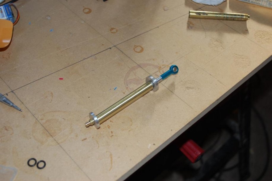

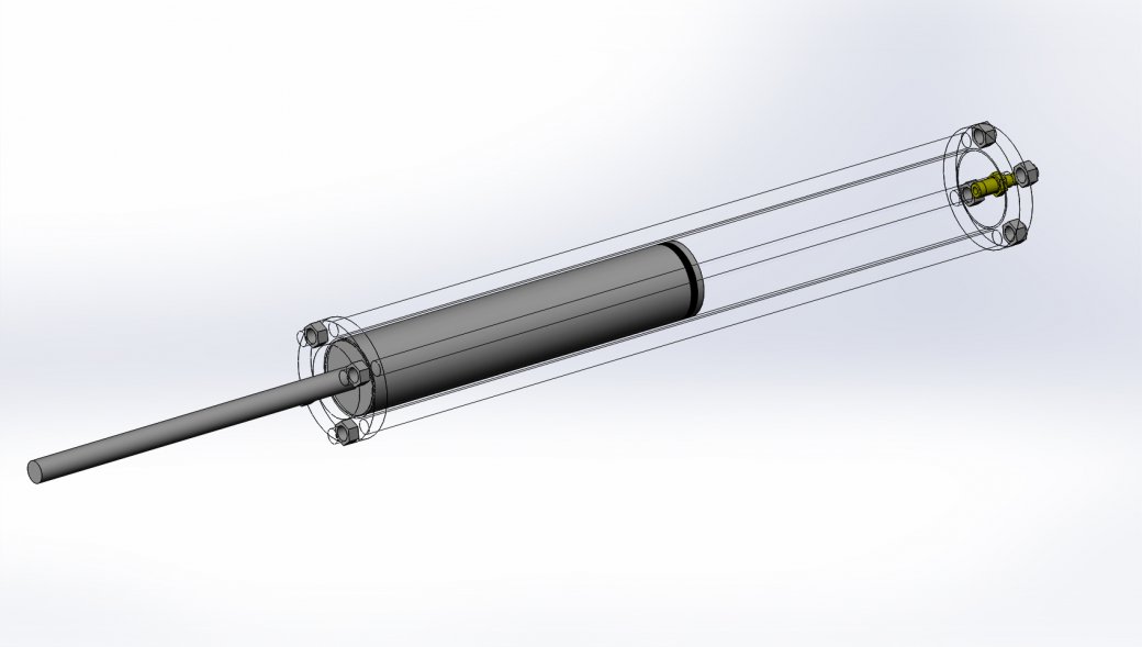

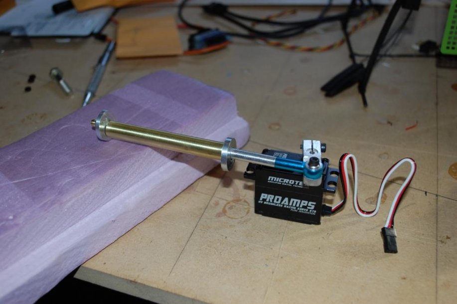

working on the master cylinder, missing long 2-56 threaded rods, will get them later
