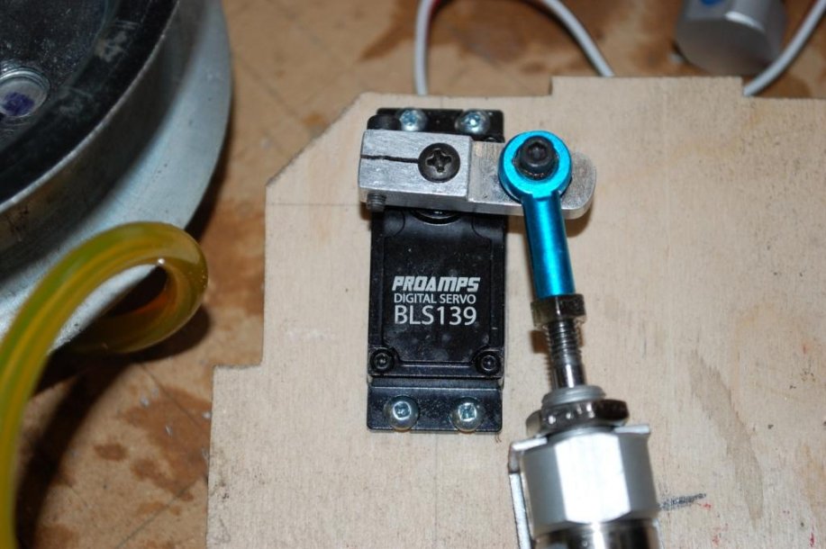

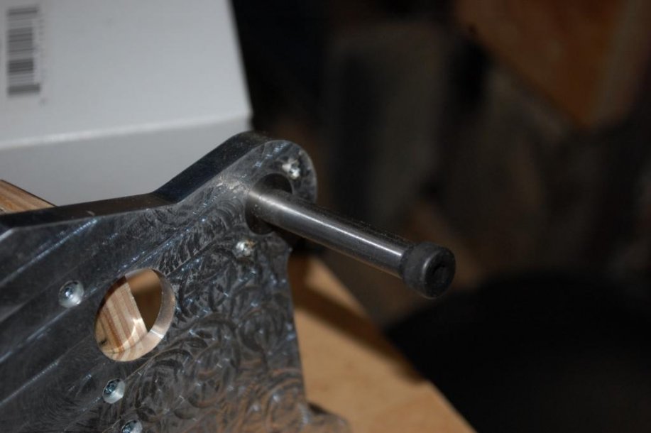

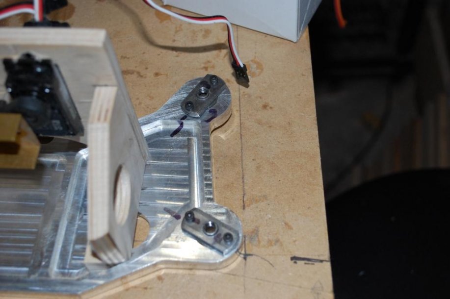

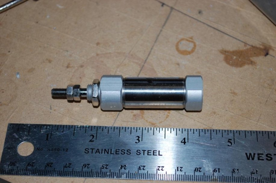

lately on the work I am doing, a lot of hours with very little to show for it, Here I have installed sort of blind nuts , they are actually weld nuts but I simply drilled small holes to install in the aluminum with 4-40 screws, and received what I hope will be the brake master cylinders, one each wheel

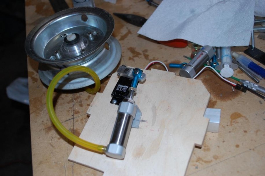

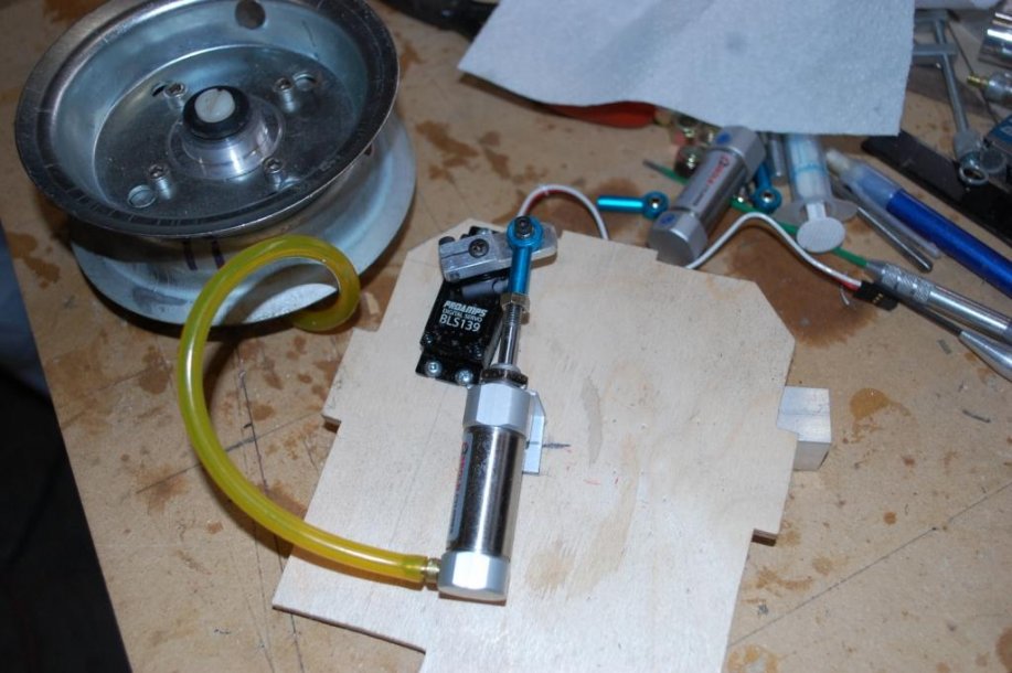

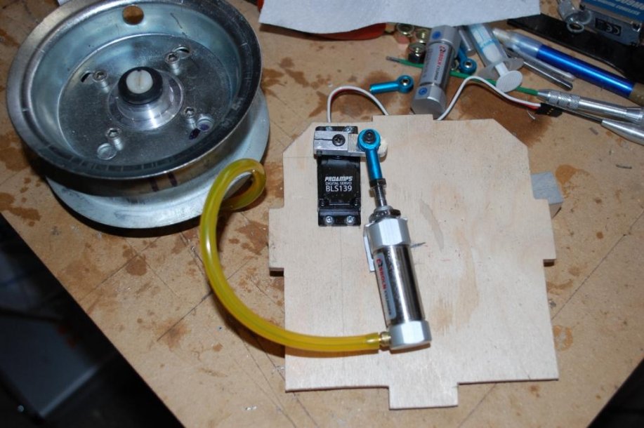

a rest on the wing and a bit on the brake master, this is only a test setup, and so far it works great , I will install the radio for more test, so far very happy

Thanks, I will be looking at all options, right now I need to eleminate all air bubbles,

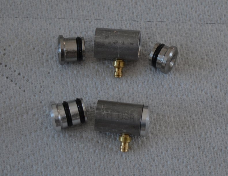

I made a second video with the camera on a tripod this time, but upon watching it, although I said I had taken care of the air bubbles, I actually see some more air bubbles, hmmm back to the drawing board.
The brakes twin piston, aren't working the way I like, too short and binds trying to go back in, so I made another one with a longer single piston, and two O rings, lets see if this is better...
