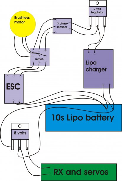

Sooooo while the glue sets , and I have pretty well concluded the onboard alternator, (sort of), here is my plan of course with lots of testing, I want to use only one battery for everything ( like the theory of everything LOL) the alternator can put out a lot of amps, and the Lipo charger I will be using if all goes well, puts out 5 amps, waiting for a high powered rectifier, and high powered voltage regulator since I have to keep the voltage below 18 volts at the input of the lipo charger.
Now in the design stage, I want to make an onboard starter which will double up as the alternator, I don't think this will be too hard but I have been wrong at least once or twice LOLOL how about many times..

while glue sets, I have done some calculations for the alternator/starter and it should work, waiting for a bigger/stronger brushless motor, but did this diagram, looks good
I made a change on the drawing, forgot to connect the esc to the battery
