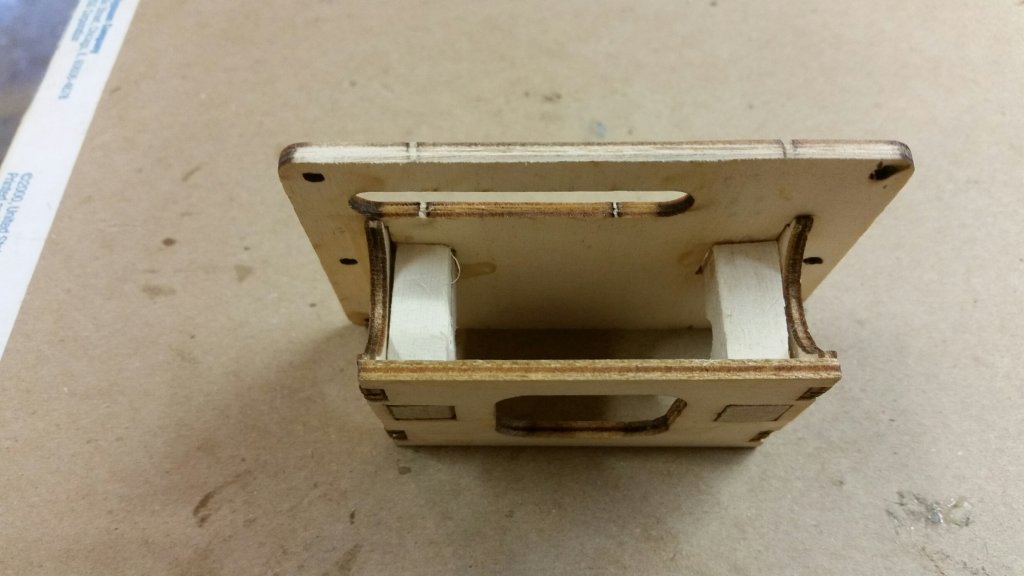

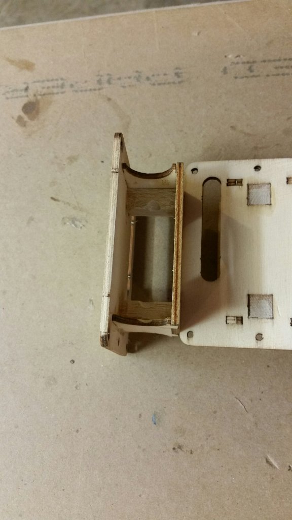

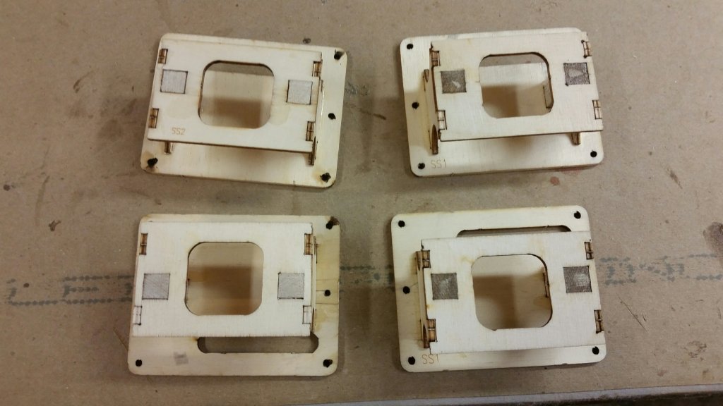

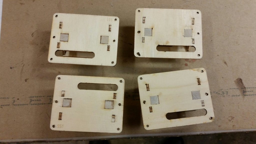

. Since I didn't get to the LHS and get the replacement strip stock that I needed for the wing, I went ahead and made the aileron and flap servo supports for both wing half's. It was parts like this that made me wish I had an extra pair of hands to hold all the parts together and glue them. . . . . .
. After I made the first one, I tried one of my aileron servo's to see if it would fit before I made the other three. The Futaba 9155 was a little tough to get in, but when I finally did, I realized a slight error. . . . .
I mistakenly grabbed a stick of 3/8" square hard balsa for the servo rails instead of hardwood. As it turned out, this will not be a problem because when I ordered the servos, I ordered aluminum arms that had the offset on the top of the arm instead of the bottom of the arm. This means in order for me to center the servo arm in the opening in the servo hatch, I'd have to add a 3/16" piece of wood to the rails to center the arm. I had plenty of excess 3/16" plywood from all of the parts, so I cut, sanded and fit eight spacers and glued them on top of the servo rails so the servo screws will go through the plywood before they dig into the hard balsa rails. If anyone whose following sees any issue with this, please speak up now. Of course, this caused another issue, which you guys have probably figures out by now. Raising the servo another 3/16" made it impossible to get the servo into the holder. As it turns out the servo lead would not allow me to rotate the servo so It could rest flat on the rails. This was an easy fix, however. All I did was put some 150 grit sticky back sandpaper around a 1/4" dowel and sanded an dentation into the bottom of the hard balsa just big enough to let the servo lead clear. If I can remember next Monday night, I will take some pictures and post them next week.
For reasons given above, making the four servo supports took me just over three hours of steady work, instead of the hour it should have taken
, but that's OK. It's one more step I've completed in build my Stick.
