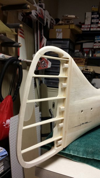

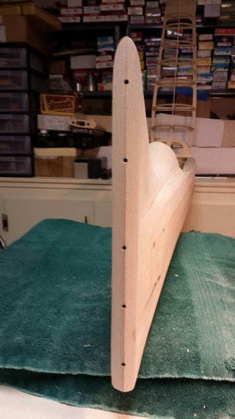

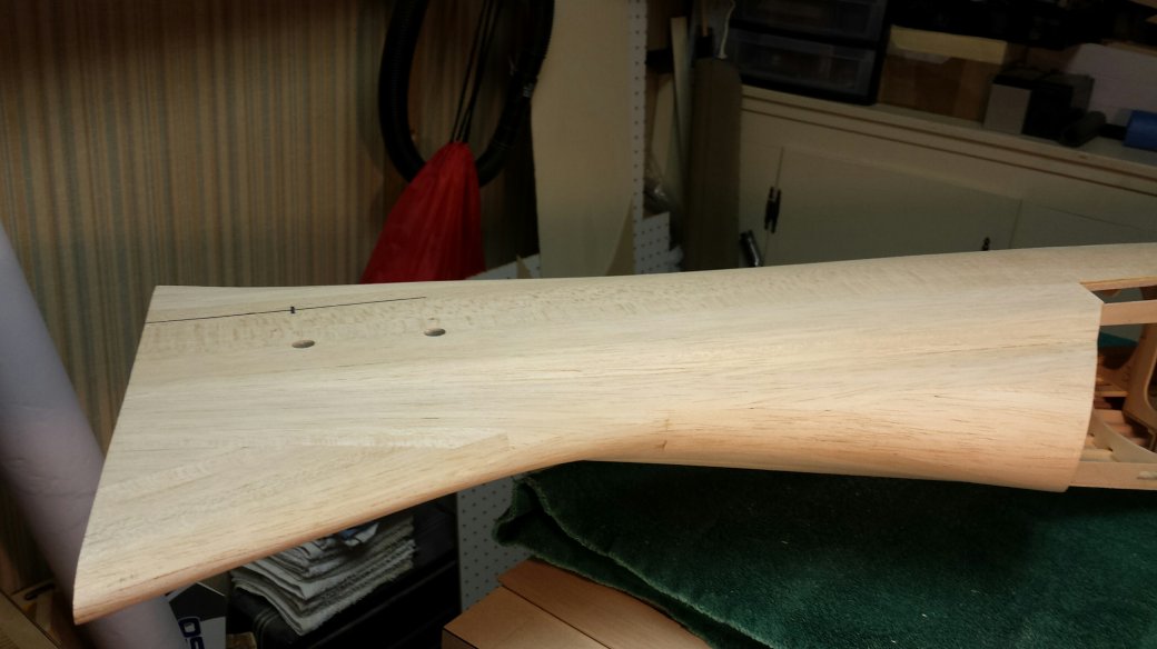

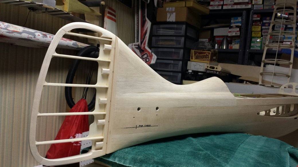

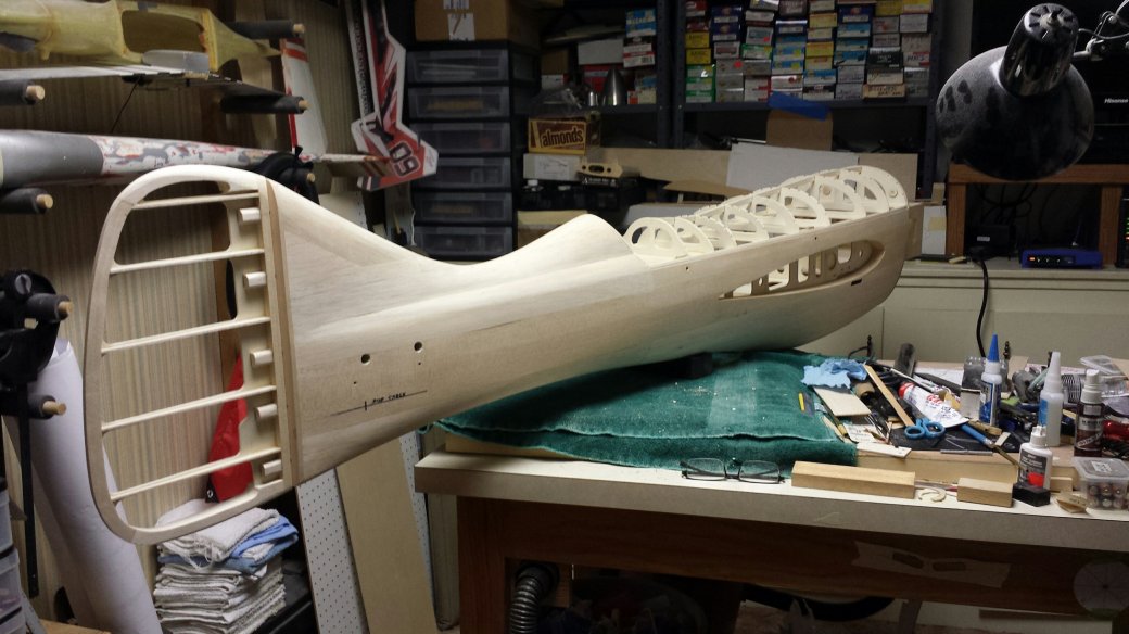

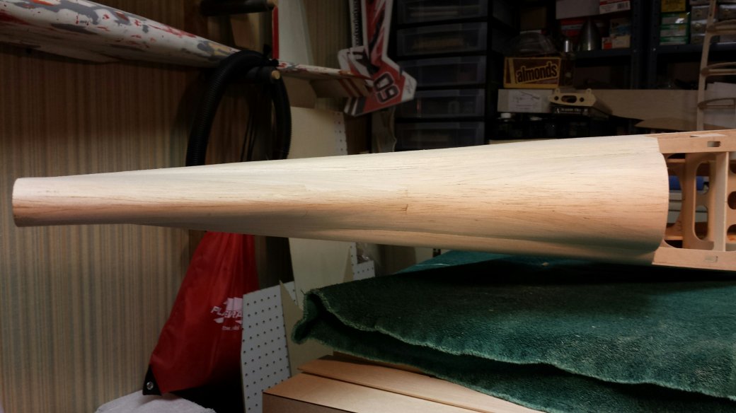

Here are some pictures of the left side of the stab and turtle deck after sanding. Tonight I'll start fitting the rudder.

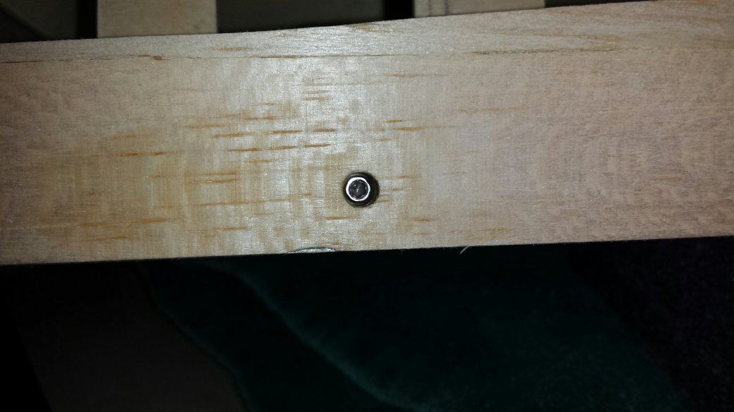

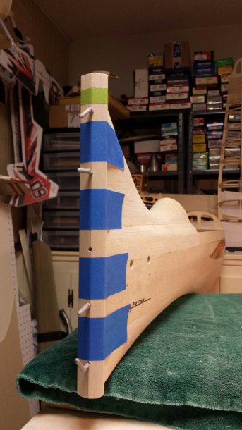

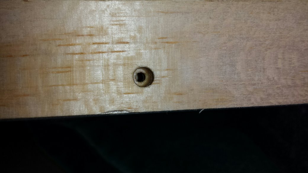

Today I finished sanding the planks on the front of the fuse and drilled the holes for the canopy bolts. I then opened the holes up through the balsa section with a sharpened brass tube so the bolt head will be recessed. I installed the hatch and drilled the holes through the hatch tabs, then removed the hatch, enlarged the holes and installed the blind nuts.
Now that the hatch bolts on I need to start installing the stringers and planking it.
I also need to clean the workbench. As you can see in the photos, I'm down to working at the very end since the rest is buried in junk.
