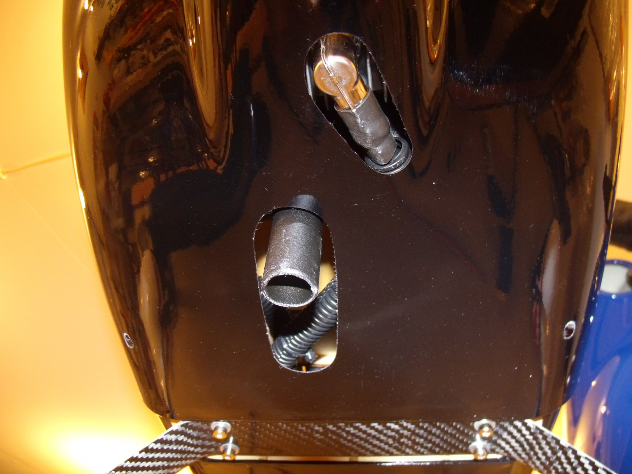

Cowl now finally all fitted. Still didnt have to chop the bottom up too much.. I am impressed with the room it had.
Wow this camera pics up every dust particle !

btw, that cowl really looks awesome, nice job!
Thanks! Boy years ago, I wouldn't have been able to make it look so good. Seems with age comes wisdom, or at least a lot of learning through experiences ;)
Not that I am old, but I have learned a lot in the 14-15 years I have been in the hobby.
