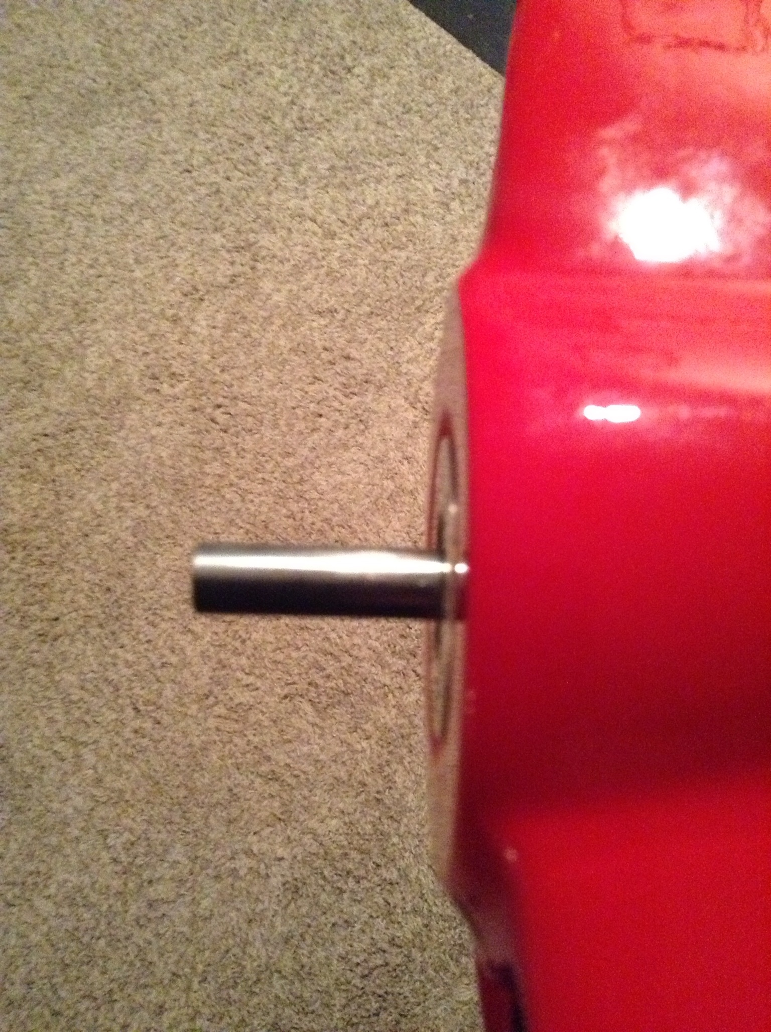

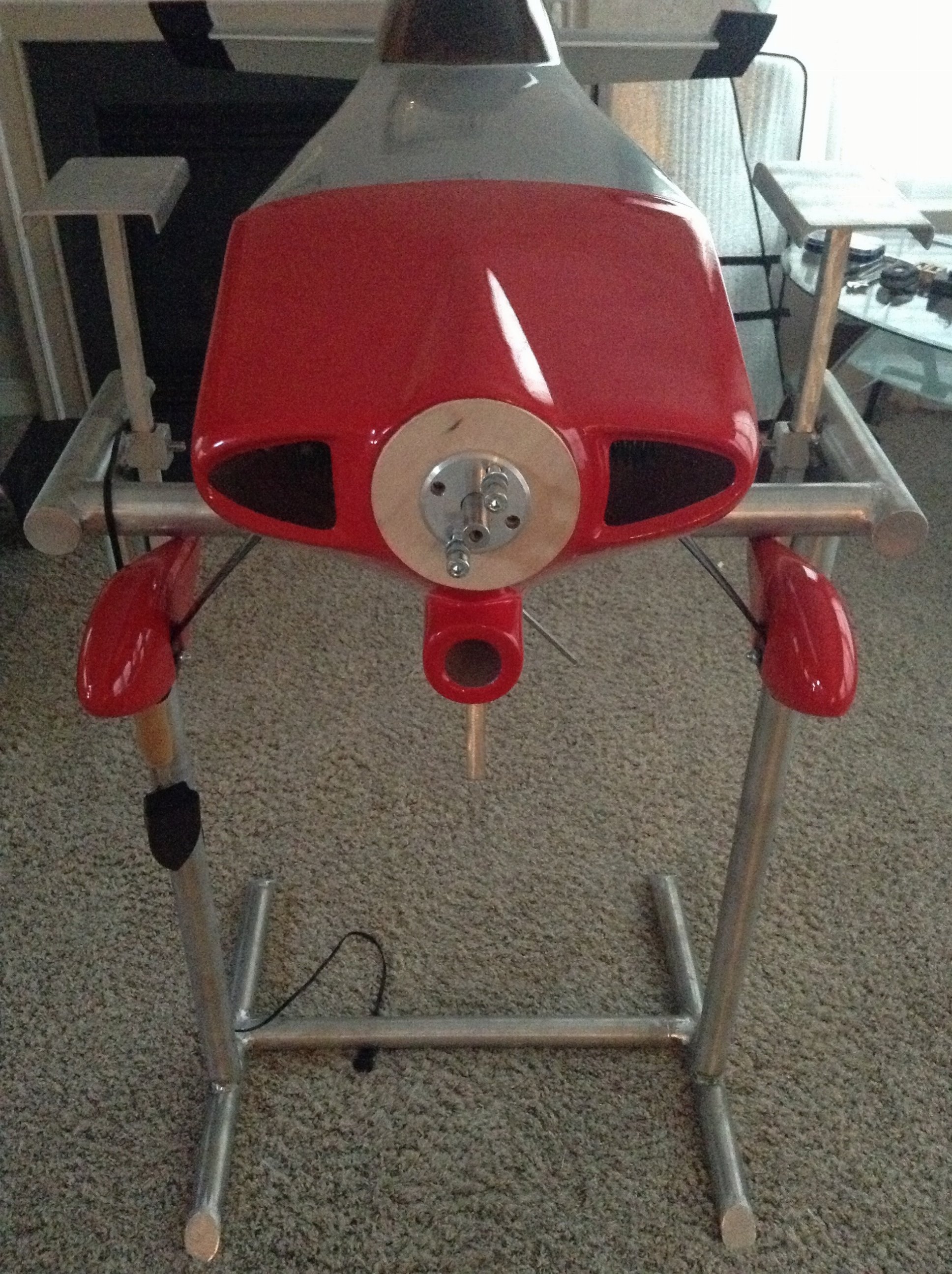

image.jpgI don't have a back plate I'm not using but you gave me an idea to use a 1/8 ply with a hole in it to check tomorrow . I don't think I am going to need that many washers as my cowl and the back plate of the motor shaft are flush with out any so I think if I ad that sheet of balsa to the motor box I should be fine.
View attachment 21289I don't have a back plate I'm not using but you gave me an idea to use a 1/8 ply with a hole in it to check tomorrow . I don't think I am going to need that many washers as my cowl and the back plate of the motor shaft are flush with out any so I think if I ad that sheet of balsa to the motor box I should be fine.
Good idea using the 1/8 ply to check the gap. From the angle in the pic you posted that looks close but if you're going to add a sheet of balsa to the motorbox I would add one washer instead. As soon as you mount the engine and torque down the mounts, the mounts are going to compress into the balsa and possibly not give you the gap you need for the spinner. Just a thought. I would use ply instead of balsa if you're going to add to the motorbox.
I said balsa but ment ply , Sorry still learning all the terms . In the kit they give you a Dle 30cc bolting pattern that fits the I.D to the front of motor box but might just use some washers instead . The only thing i dont like about washers are some mite be different thicknesses from manufacturer or am i thinking to much .
Thanks for the idea,the ply worked great and will use it as a drill guide later.
