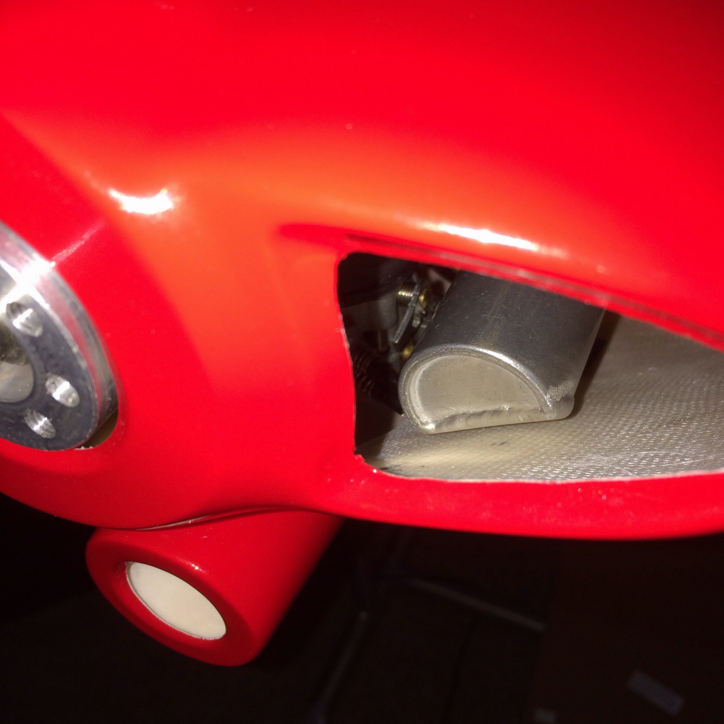

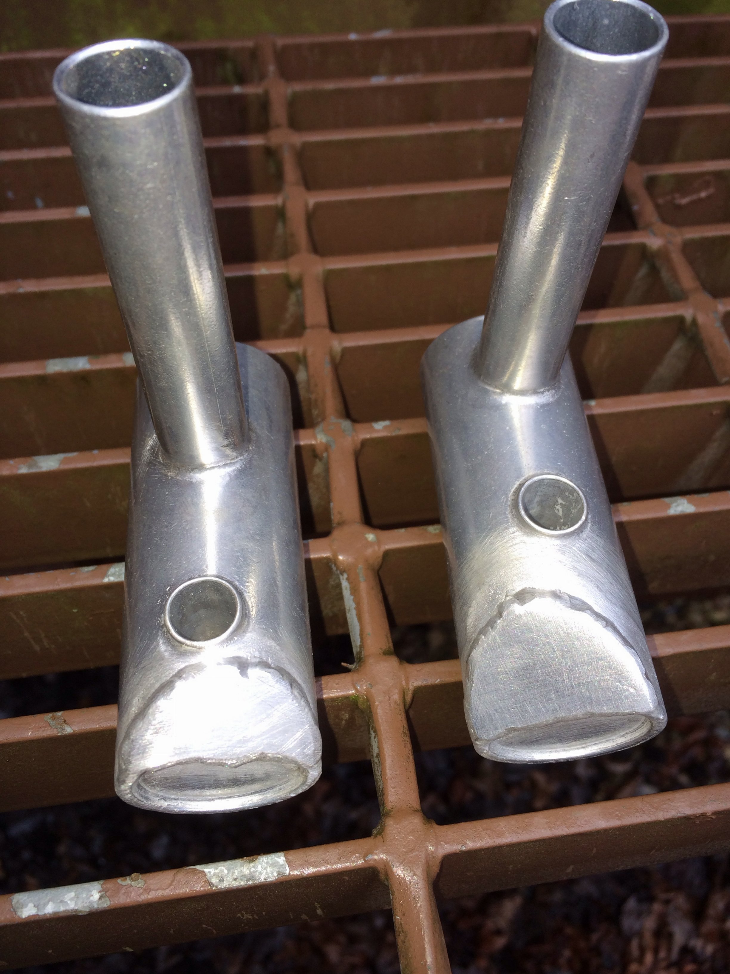

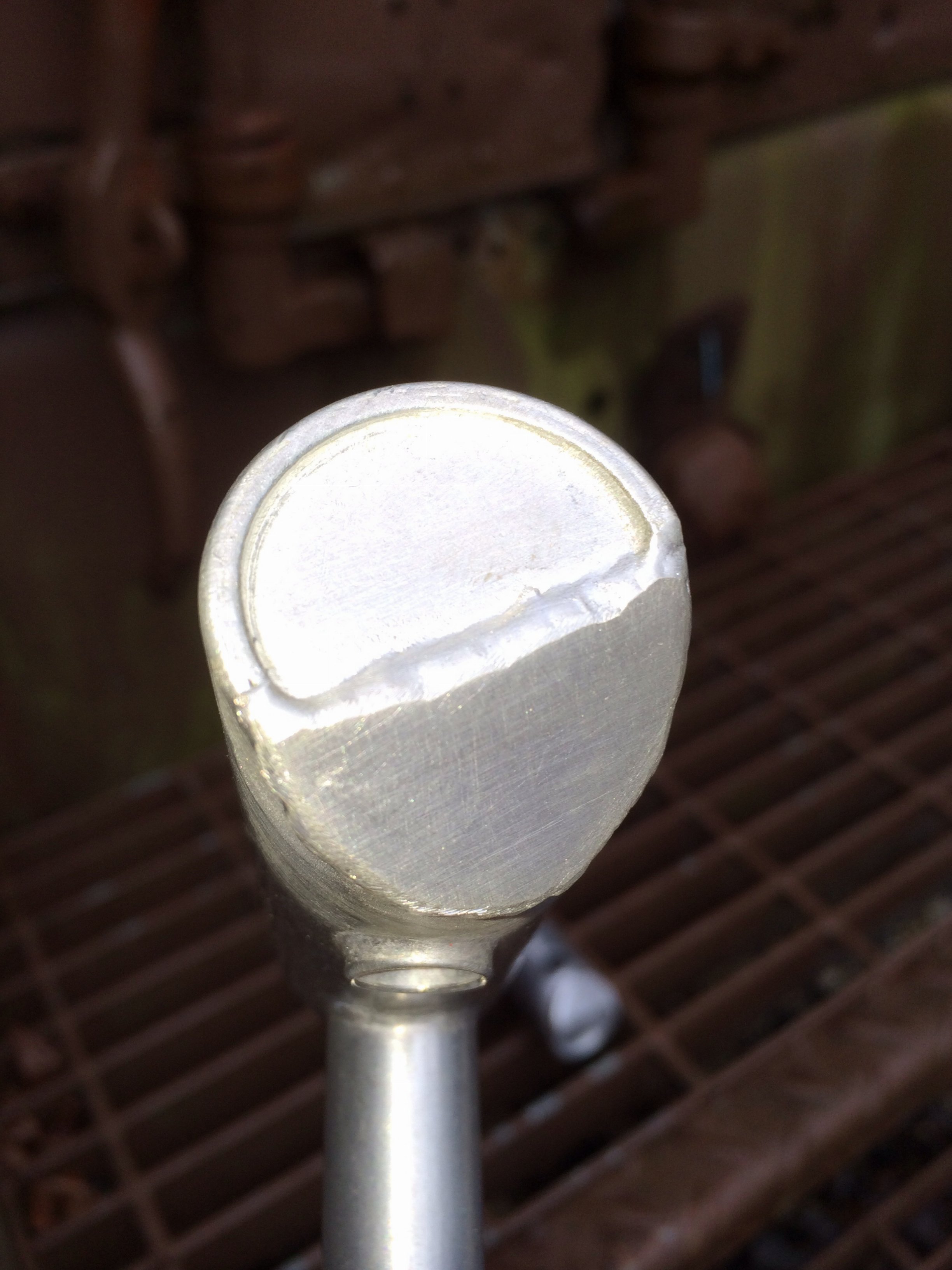

I talked to Tom at VVRC about me tig welding an angle into the exhaust for Clearance in the cowl and he said a few people have already done it and will not hurt anything and he is trying to get the manufacture to put an angle on the exhaust stock. If you would like me to do this for you after you see mine and it works out I will just let me know.
Keep us in the loop on the angled muffer mod. Hopefully if VVRC can get the MFG to put an angle on the mufflers maybe then they can offer an exchange program for a set of the angled version. Does the orientation of how the muffers are mounted determine if they are going to hit the cowl up front? I haven't test mounted mine yet so I'm not sure. Looking at this post on a different forum it looks like the mufflers are not hitting the cowl but I'm not sure if that's because how he has the cowl cut.

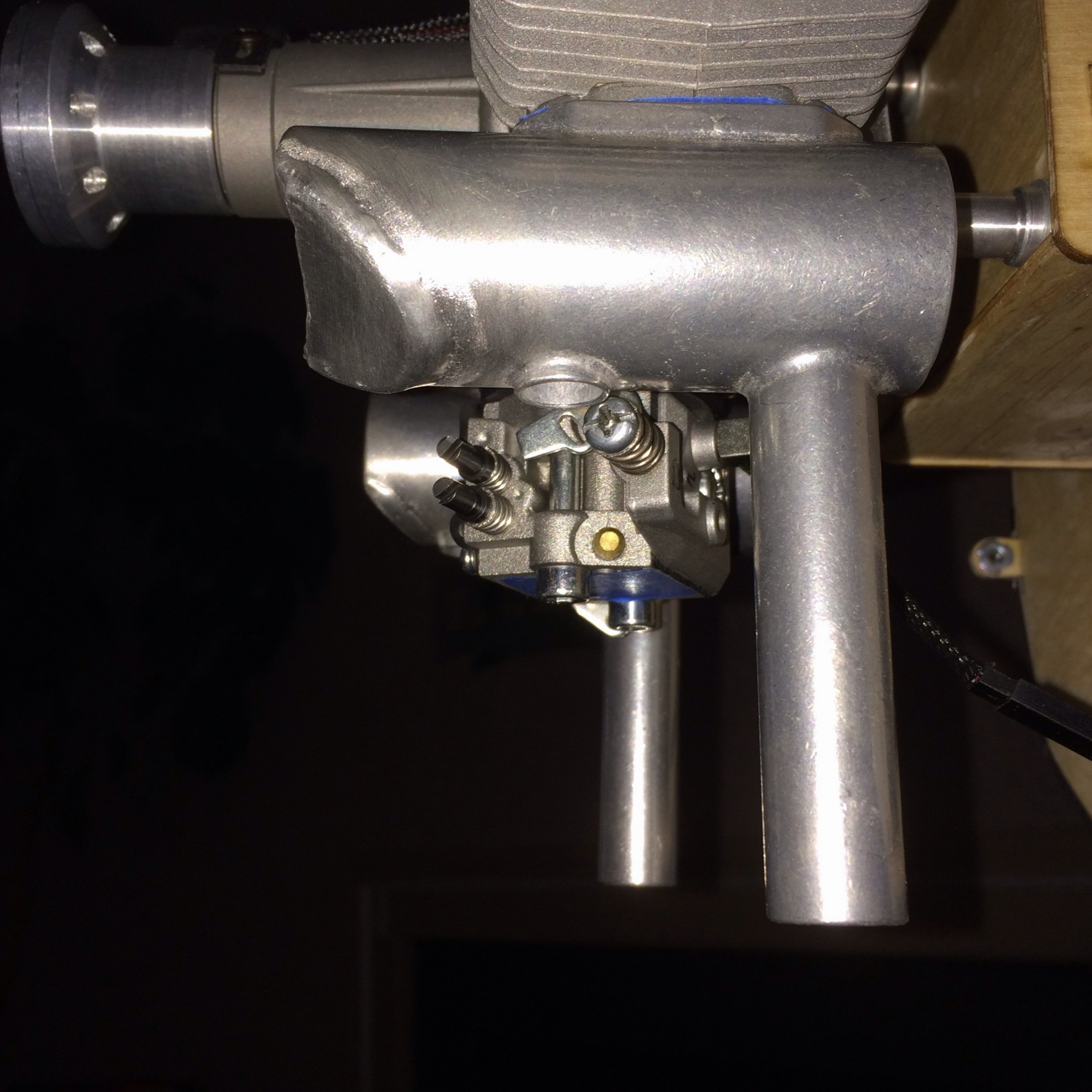

There is not any mods needed unless you want to install the exhaust in the back position they fit with the down tubes in the forward position.heres my angled exhaust. They still need to be cleaned up. View attachment 21323
