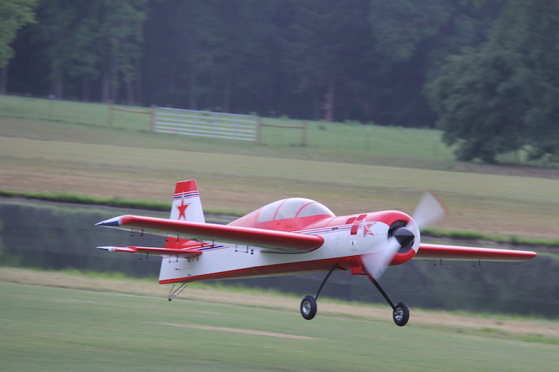

74" Edge 540
Thanks! This 74" Edge has some miles on it. Once I get the twin broken in the motor will go in a 24% Pilot Edge 540.
They are rite up against the back side of the the wing tube. I mite have made a huge mistake,on the way home from wram I was fet up waiting and looking for the stuff to Finnish the plane by the way it was nice meeting u guys and thanks for the help,wish I had met Gary but the kid was getting restless . On the way home I stopped at a hobby shop and he talked me into more redundancy so I purchased a switch ,opto kill and 1 2550 lipo and a 3000 lipo I hope these batteries are not to big but seems ok.
