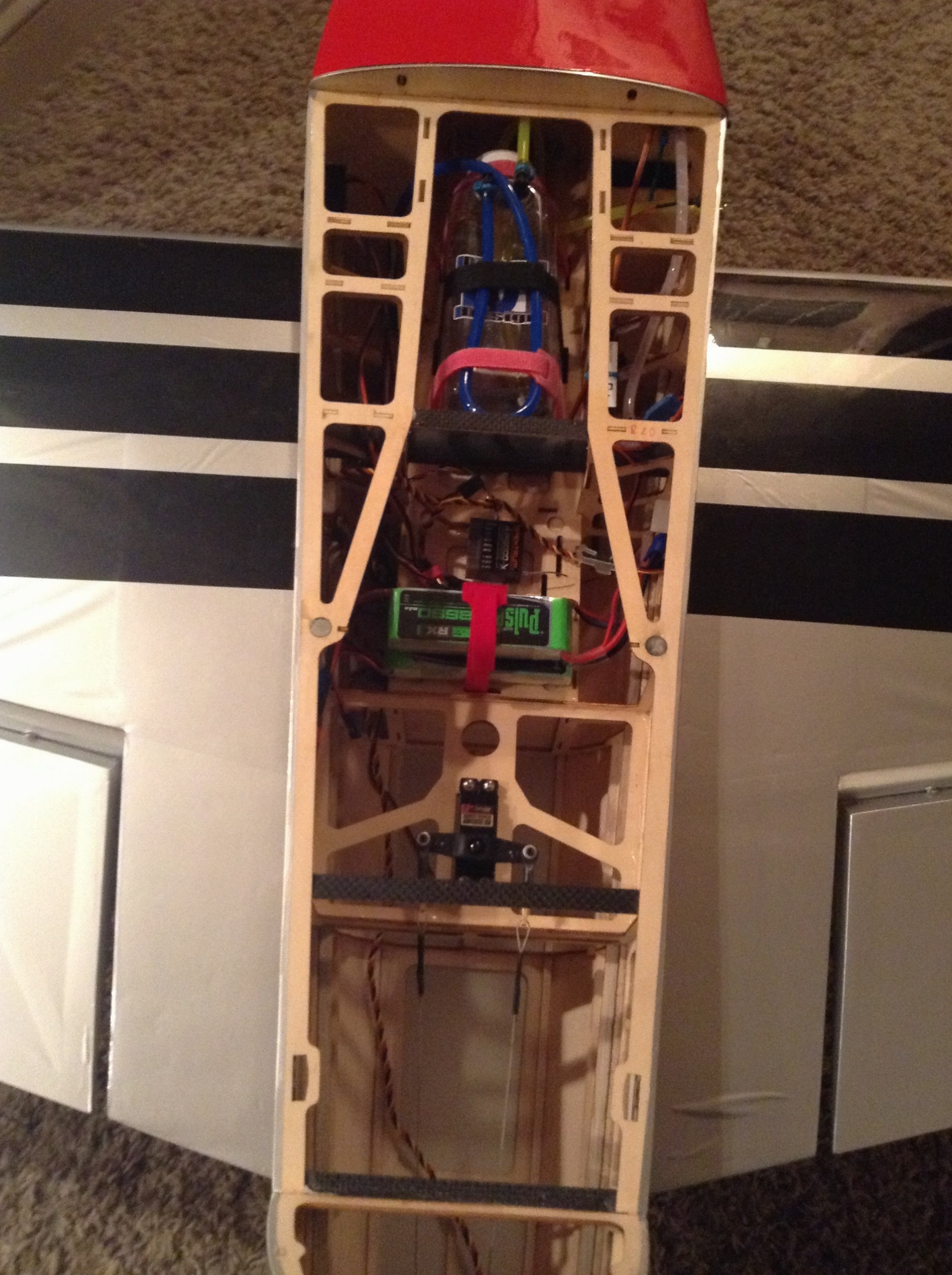

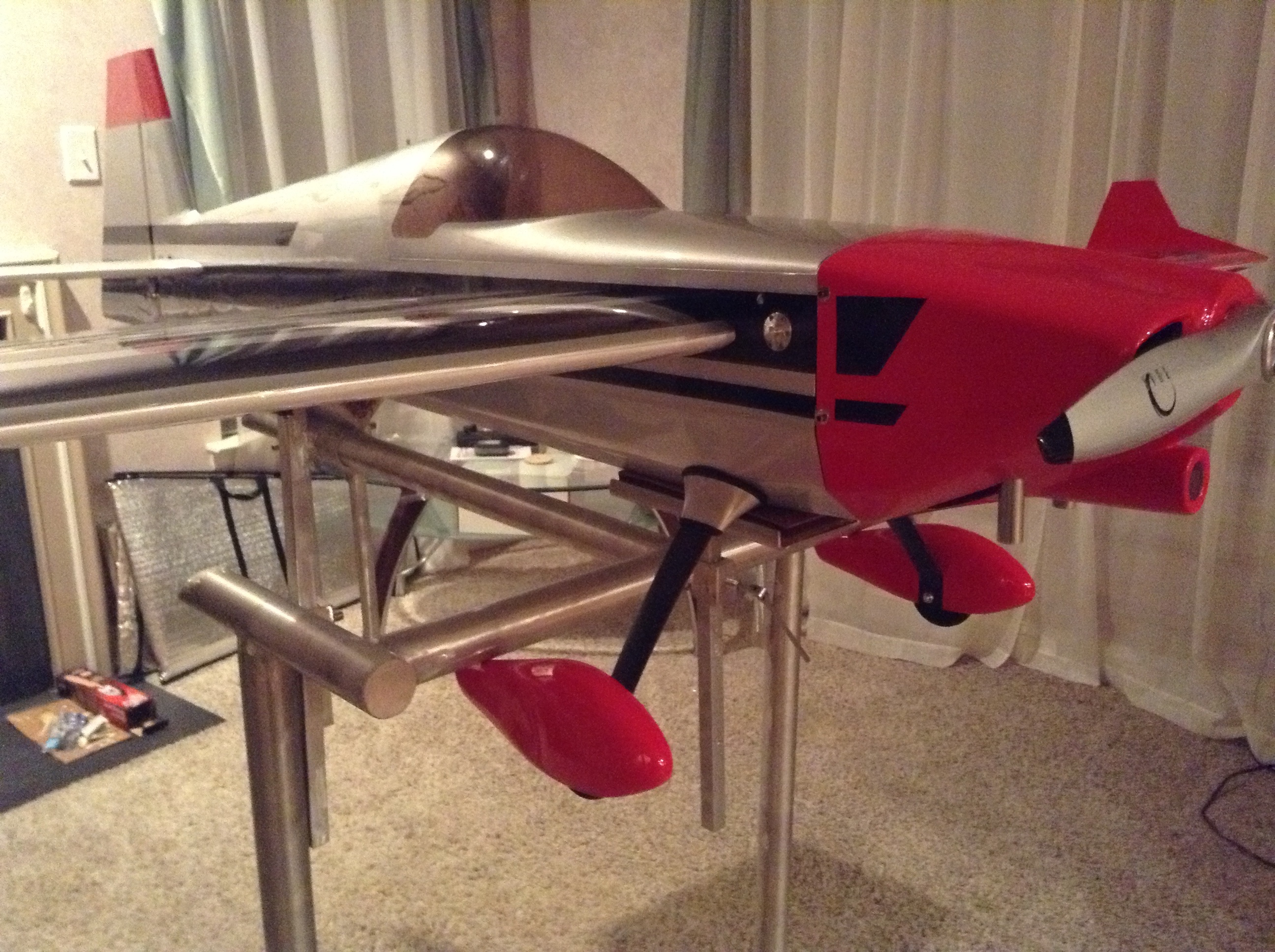

Here's some pics of the progress. Only need to Finnish some wiring and change out the opto kill for a tech aero once its delivered and go with a single battery even though its balanced perfectly with a half tank fuel with this layout so not sure if I will go single batt. Thanks for all the help everyone through the build. Will try and post the maiden flight.
Here's some pics of the progress. ...
It looks like a nice clean build. Congrats.
This airframe was my first gasser. I was worried about how the CG would change as I burned up fuel. But I can't say I even notice it yet. I only have about 25 flights on my plane so far, but I fly quite a bit inverted and I don't really feel much difference in the CG between beginning and end of flight. You may be at a much more advanced level than I am, but the airframe seems pretty tolerant of CG in my experience. In my smaller electric, I could definitely feel a difference if I moved the battery pack 1/2" one way or the other.

Thanks Marc and thanks for the info on cg. with this beeing my first gasser i didnt know what to expect with the fuel wieght .
Well i just got the dx9 because i didnt like the throttle after starting the twin with the dx6i with no throttle curves. The engine started very easy and idled great but was at full throttle at 3/4 stick. Now i can also go 150% on servos and dont need to buy longer arms. Now just need to figure out programing and should be ready to maiden this weekend.
You will not be sorry for changing your radio. There is very little different in the DX-18 and the DX-9. The ability to do 4 servo wings, balancer, idle down mixes, knife edge mixing all make the experience so much better.
Ya I am seeing the huge differences now and trying to figure it out. The dx9 is so easy to program a basic setup but now trying to figure out the speech to switches,my god this thing does so much.
Got the maiden flight done and went perfect. No trim at all needed and the twin started with 5 or so flips and ran pretty good even though really rich so my next flight will lean out a bit. I am so glad i went with a gas setup. Cg is perfect. Thanks to all for answering my questions.
