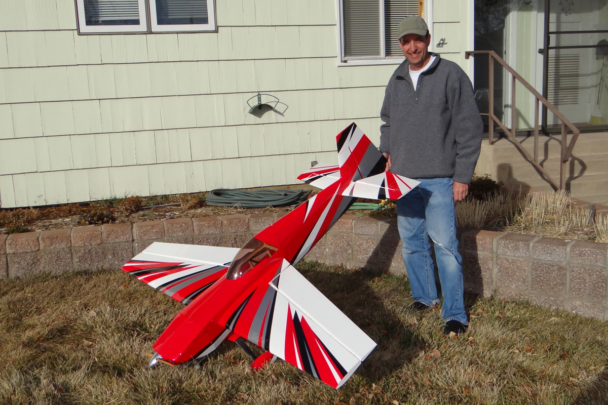

6172crew
Spoke to Noel at 3DHS, says the Red one should be coming in around a month or so. Ive never seen the silver or white ones in person but the red looks awesome, would love to see a blue one.
Two red ones at the same field might just get too confusing. :)
