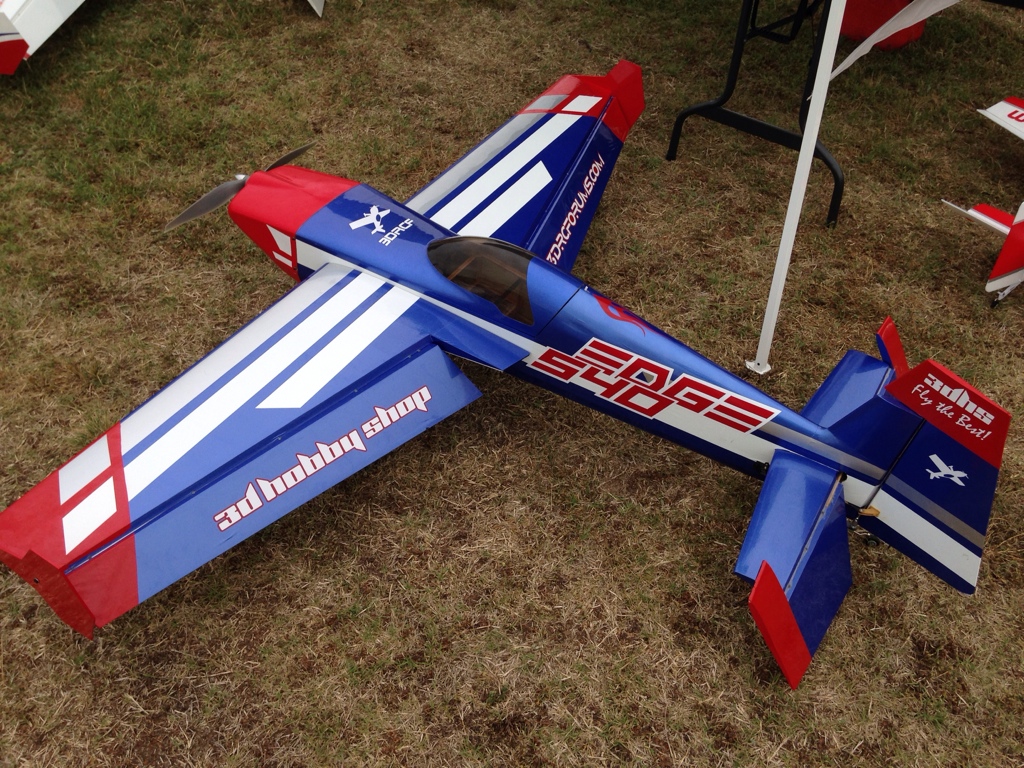

Got 2 flights today in on my replacement 74. VVRC 40 spinning a Vess 20B, 7200 RPM. It balanced perfectly with the batteries where the pull pull servo would have gone. Rudder servo in the second elevator bay. Plane came in at 10 lbs, 12 ounces, full of fuel (16oz). Probably the lightest gasser 30cc plane I have had. My 71 Slick is 11.5 at least.
That thing must have had silly power. Over 2:1 power to weight ratio for sure.

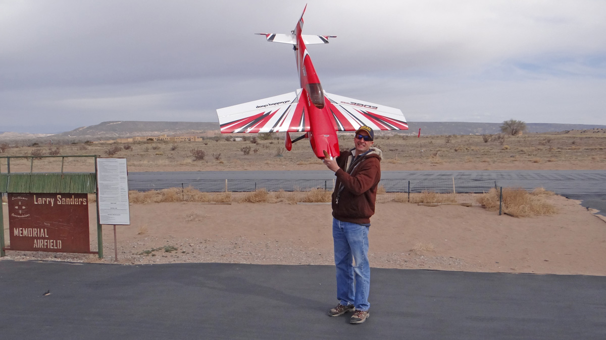

I just finished off the second gallon of gas through my DLE-30. Maybe it was the cool thick air yesterday, but the DLE sure seems to be getting stronger. Most notable pulling out of a hover. I'm still running an 18x8 "break-in" prop but with my flying style I don't really feel the need to prop up.
Credit goes to Aerobeez Pete for the pose idea I saw elsewhere on this forum. ;)
Marc
