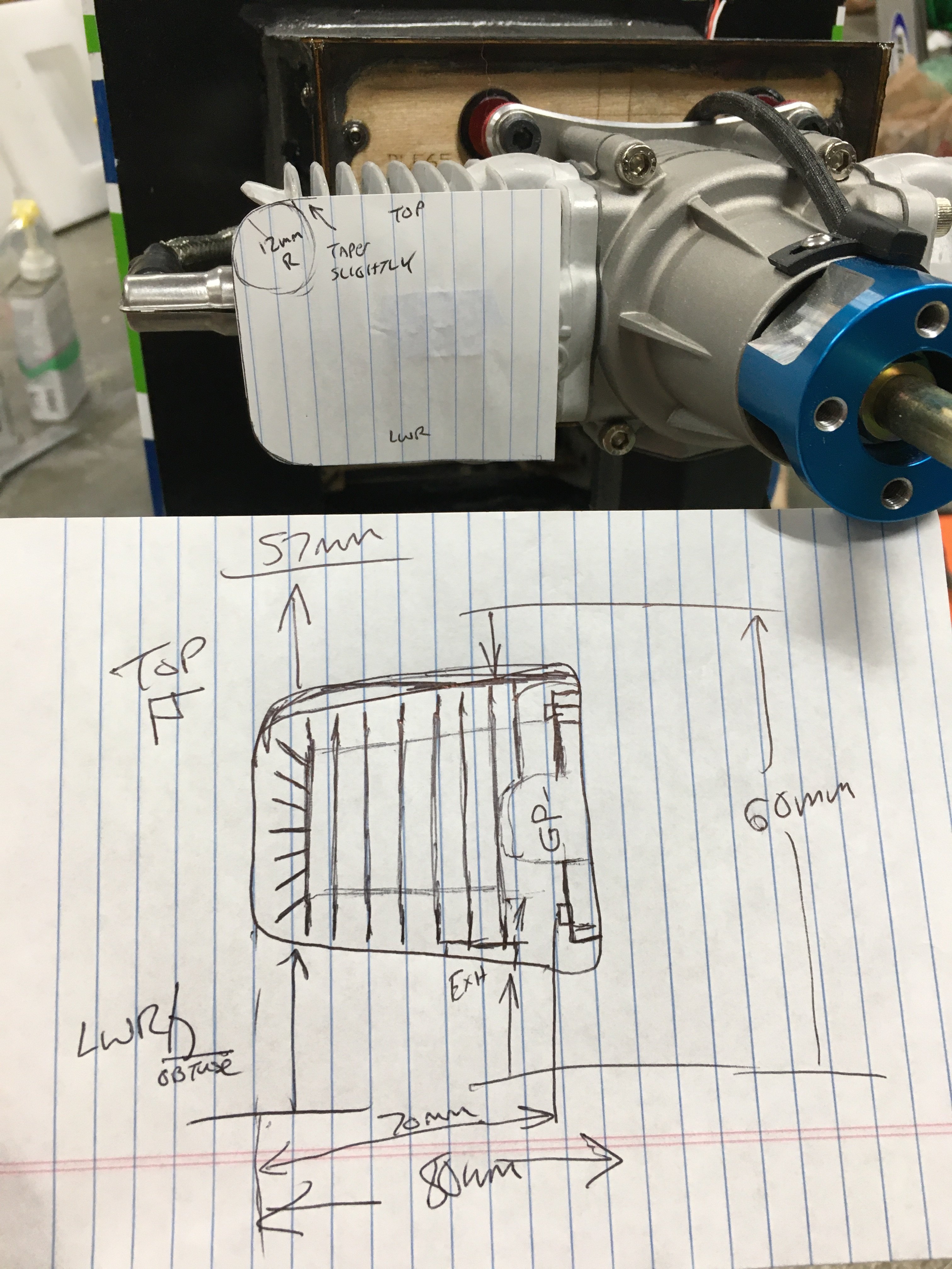

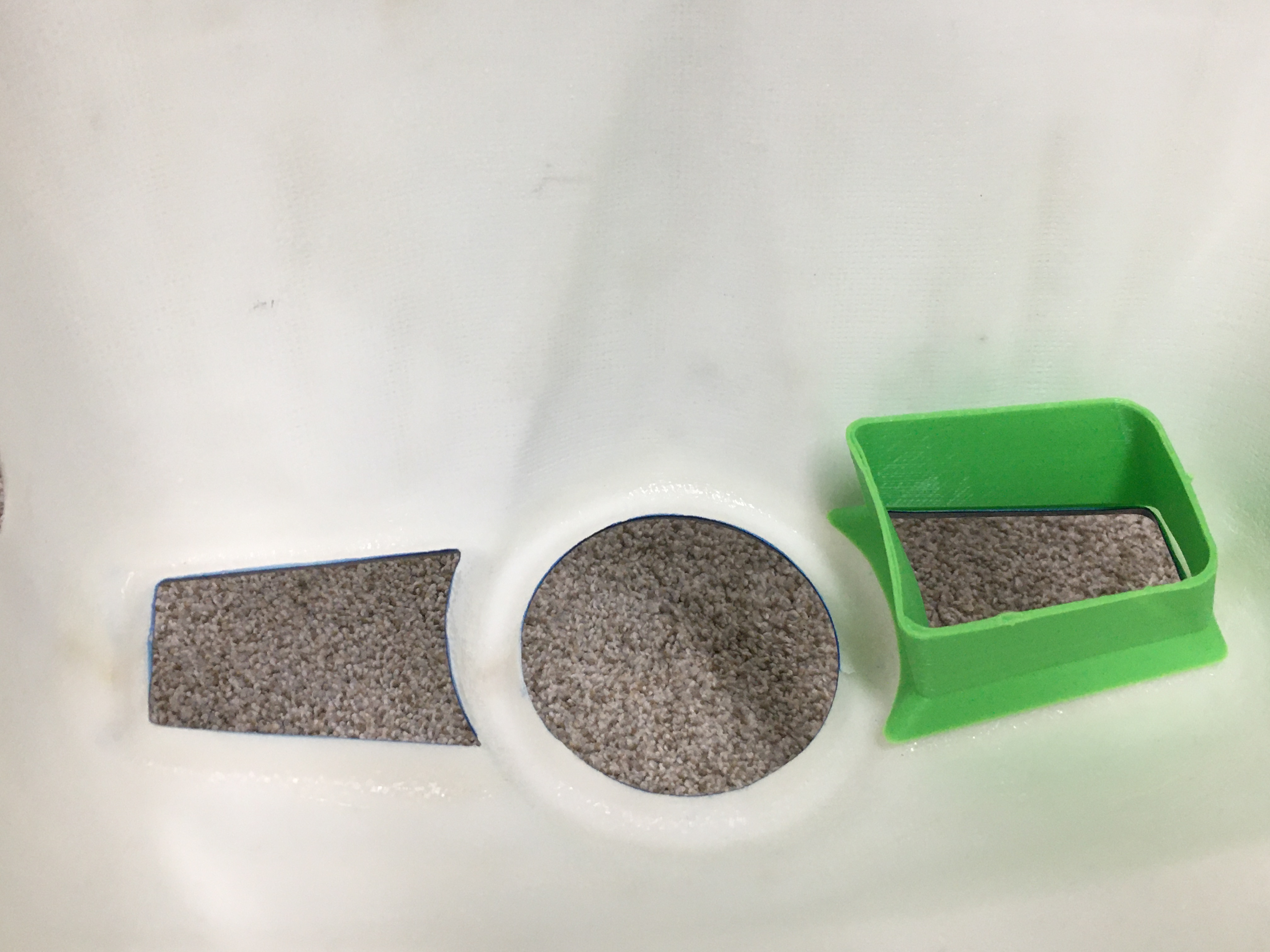

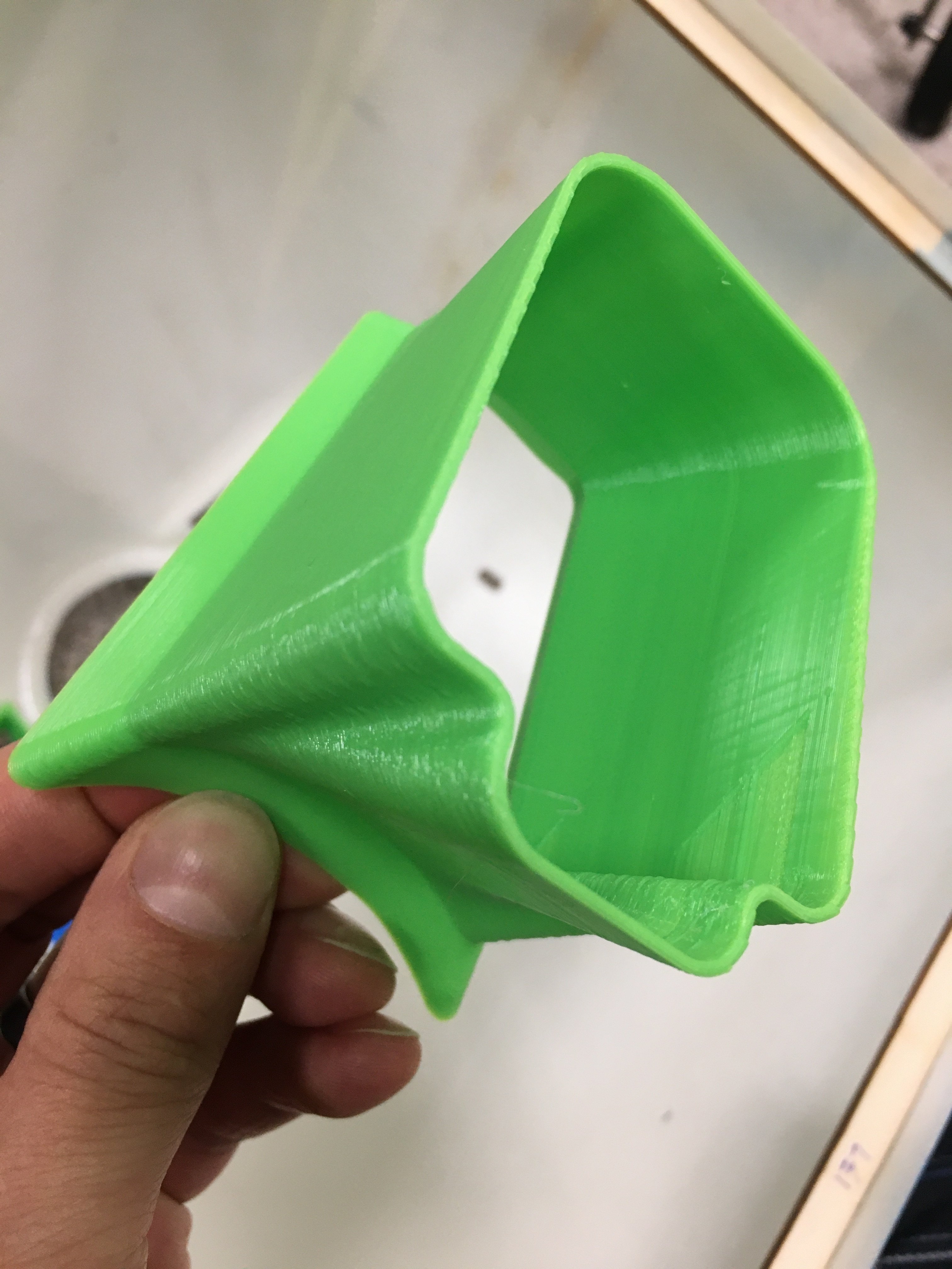

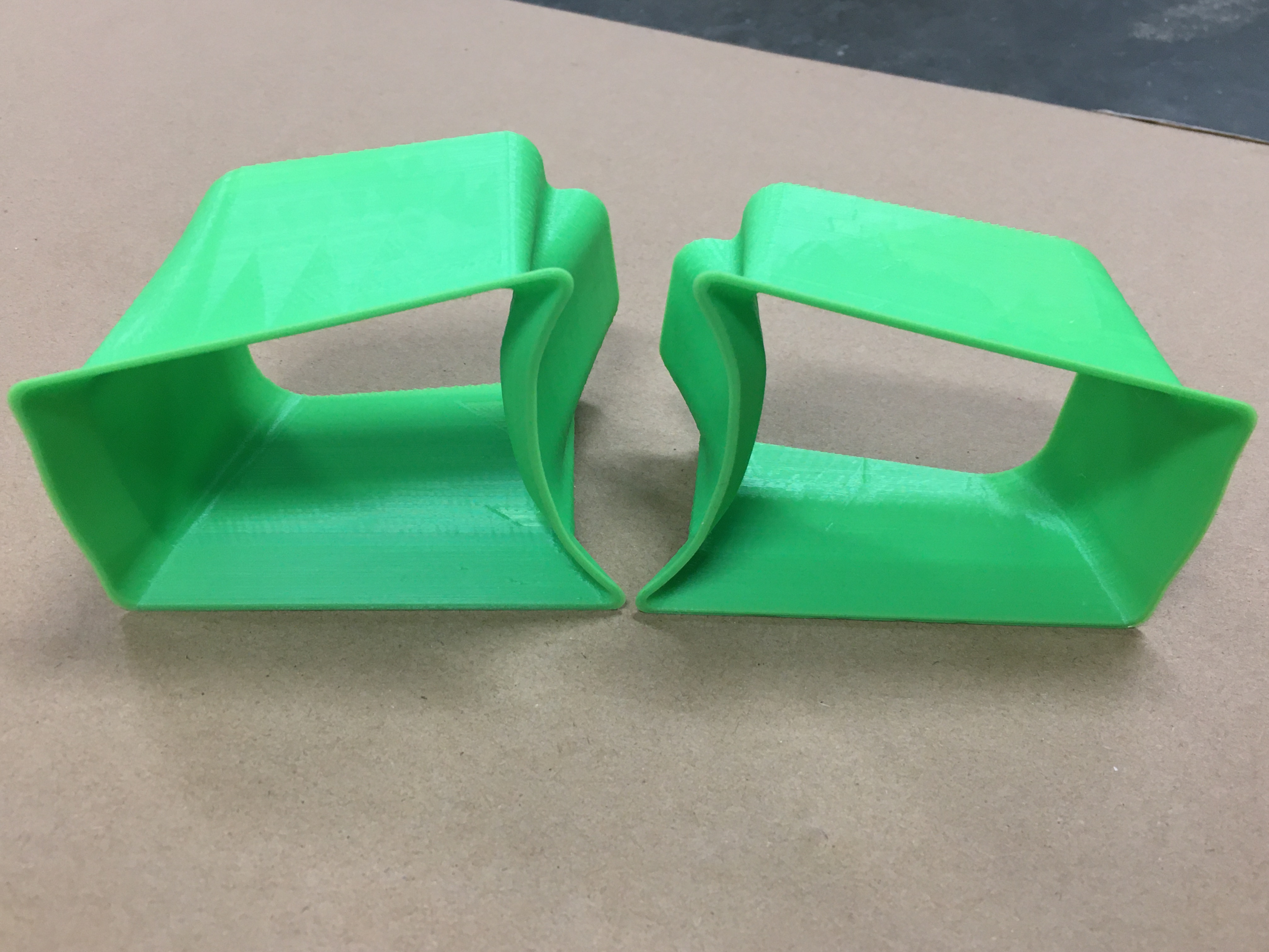

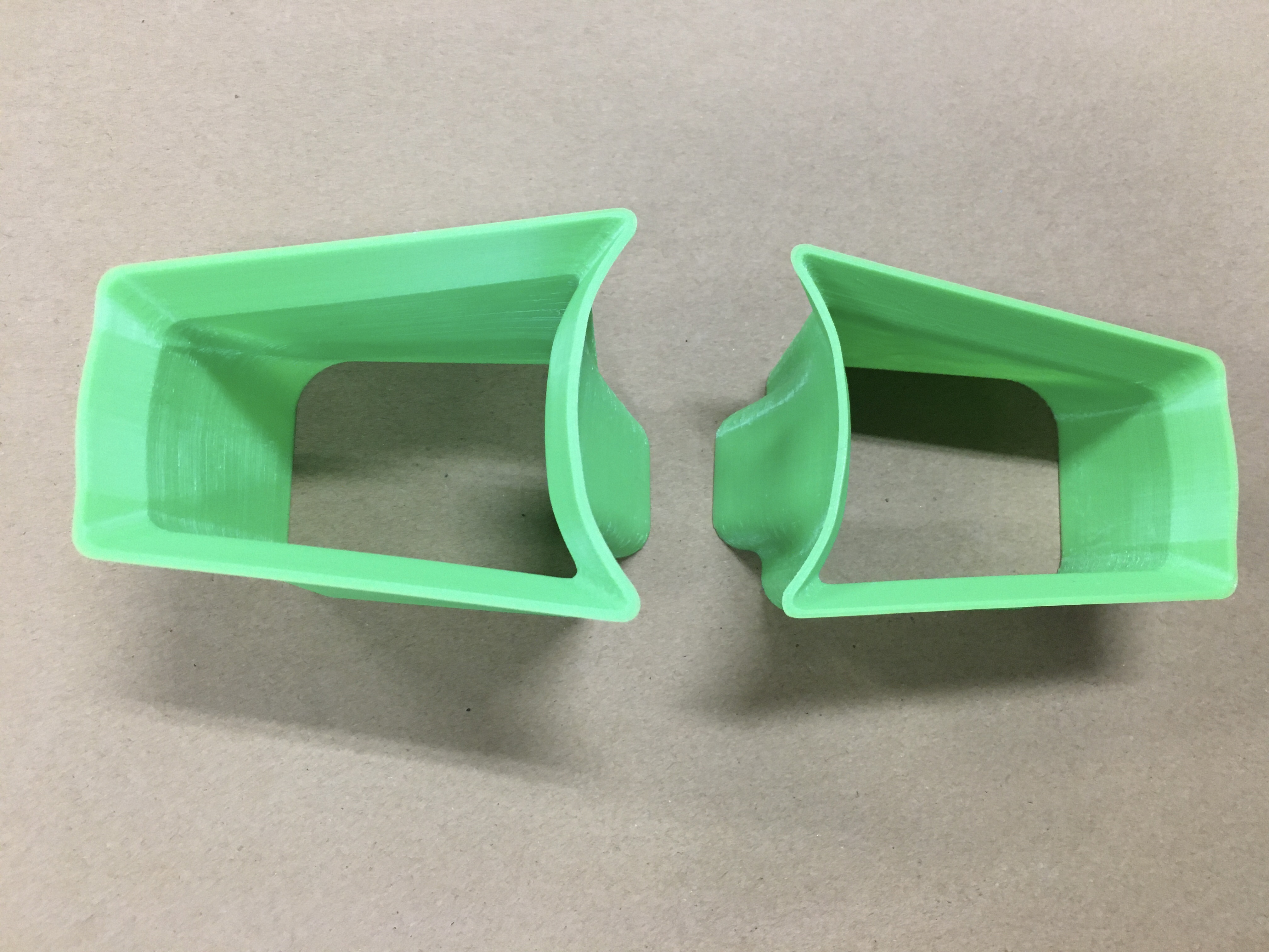

Expanding my CAD skills and teaching myself how to intersect and blend two different objects on different angles is like working in an alternate reality for me. After about ten thousand eureka moments later I have drafted and designed a baffle for the right/rear cylinder.

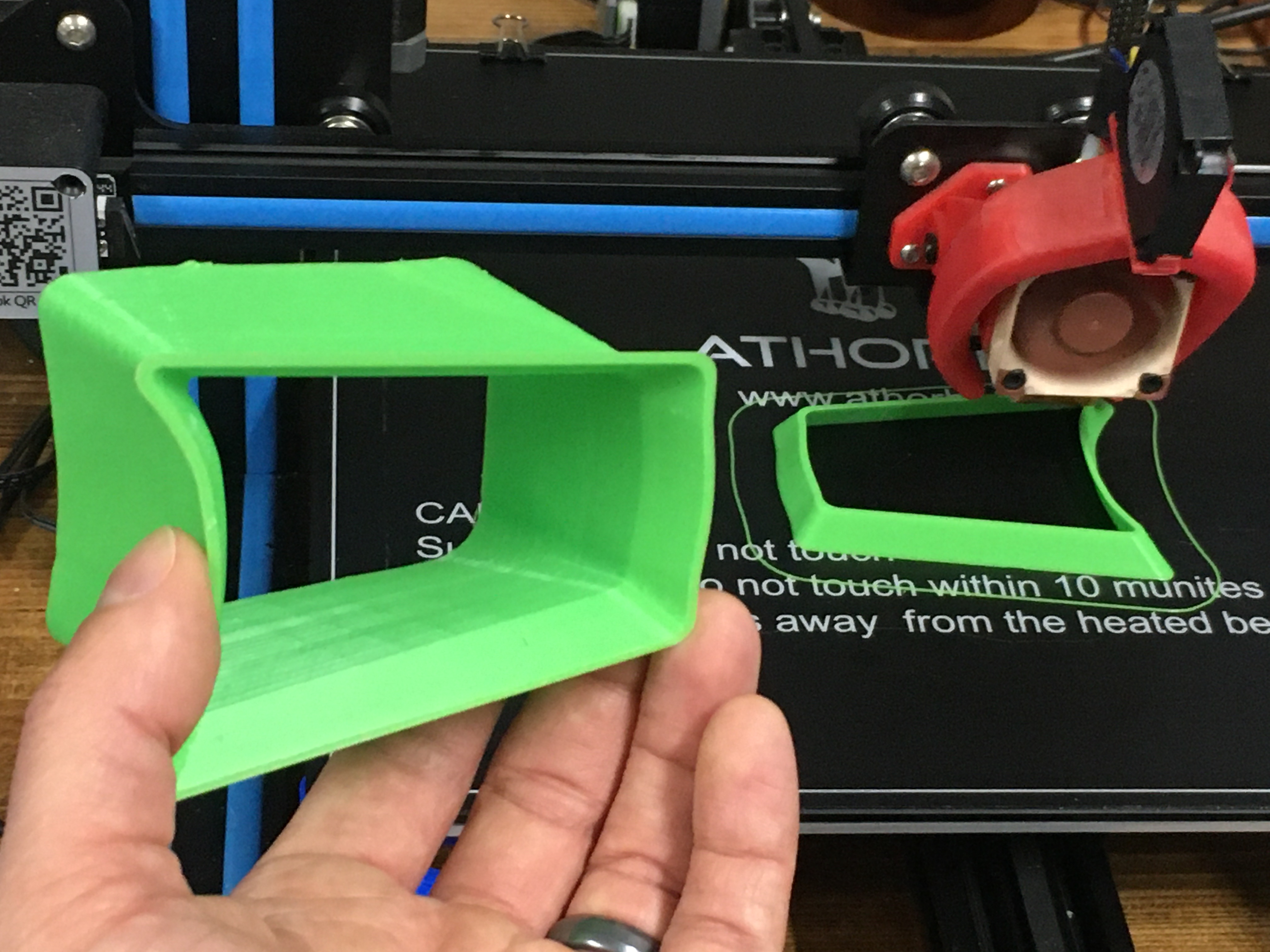

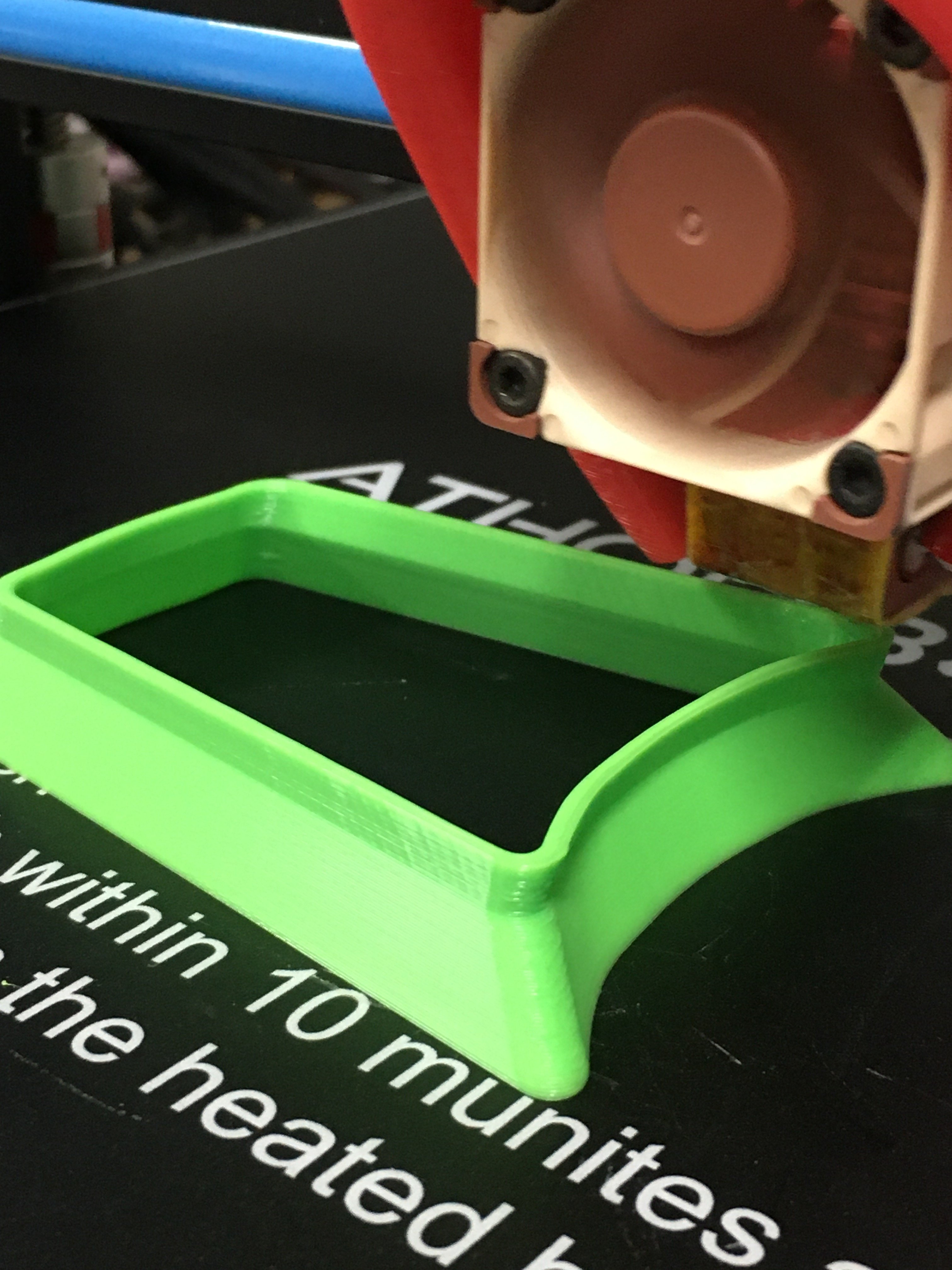

Talk about time consuming.... just use the foam fellas... hopefully it turns out! Printing now.
99D7017C-3AEC-4321-A30C-D6345700339A.jpeg 21D86059-6012-4D03-B733-A78693525D44.jpeg24B59A5F-4433-4DDA-9B1B-372A7B500E20.jpeg
1.6mm is too thick, probably thin it up in my next revision. 5hrs is way too long to wait for this.

Nicely done looks really good. That took some time and work to get it to look that professional.
Thanks! It's very rewarding to design and 3DPrint things like this. hopefully I can bring it to fruition

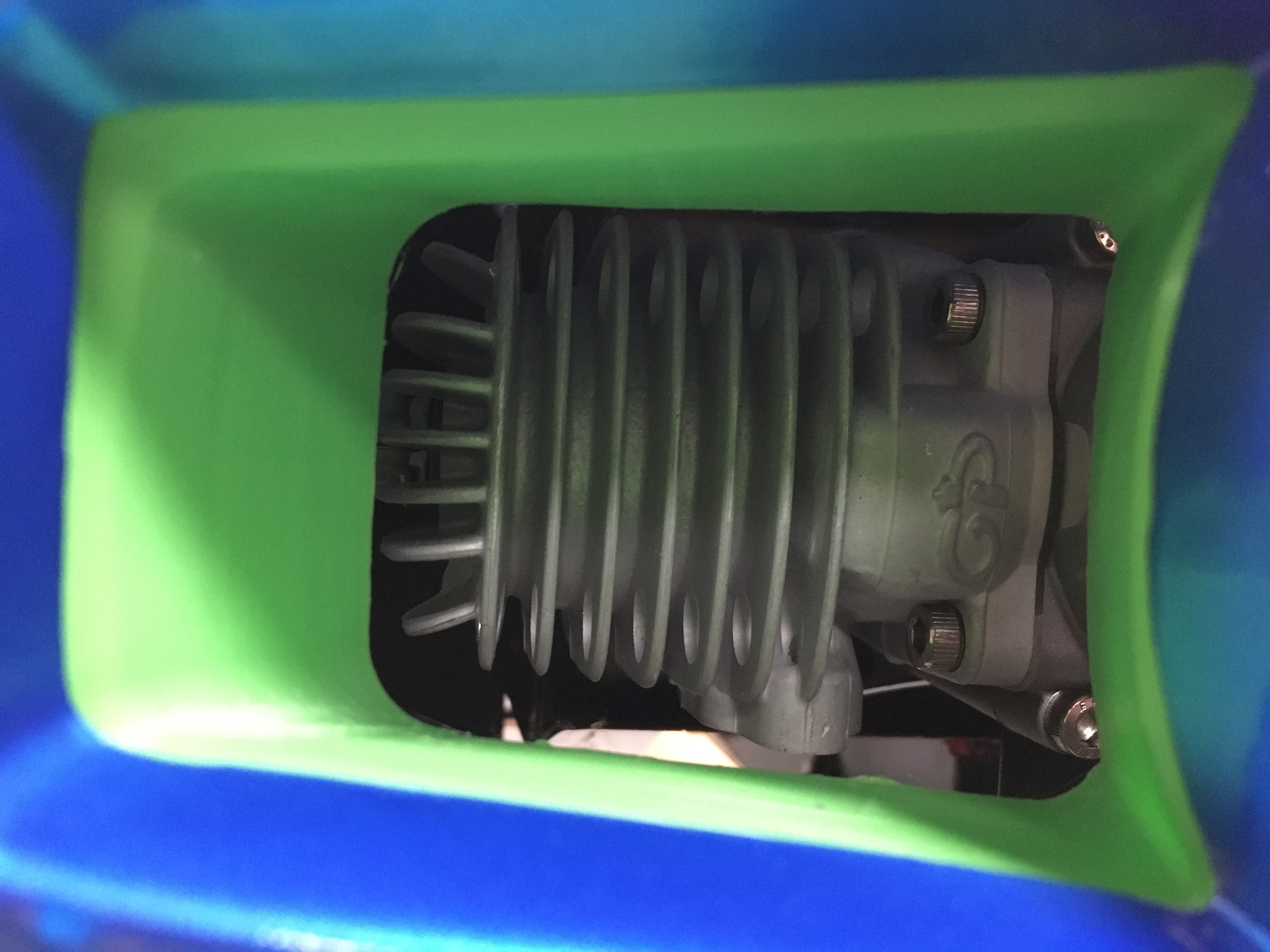

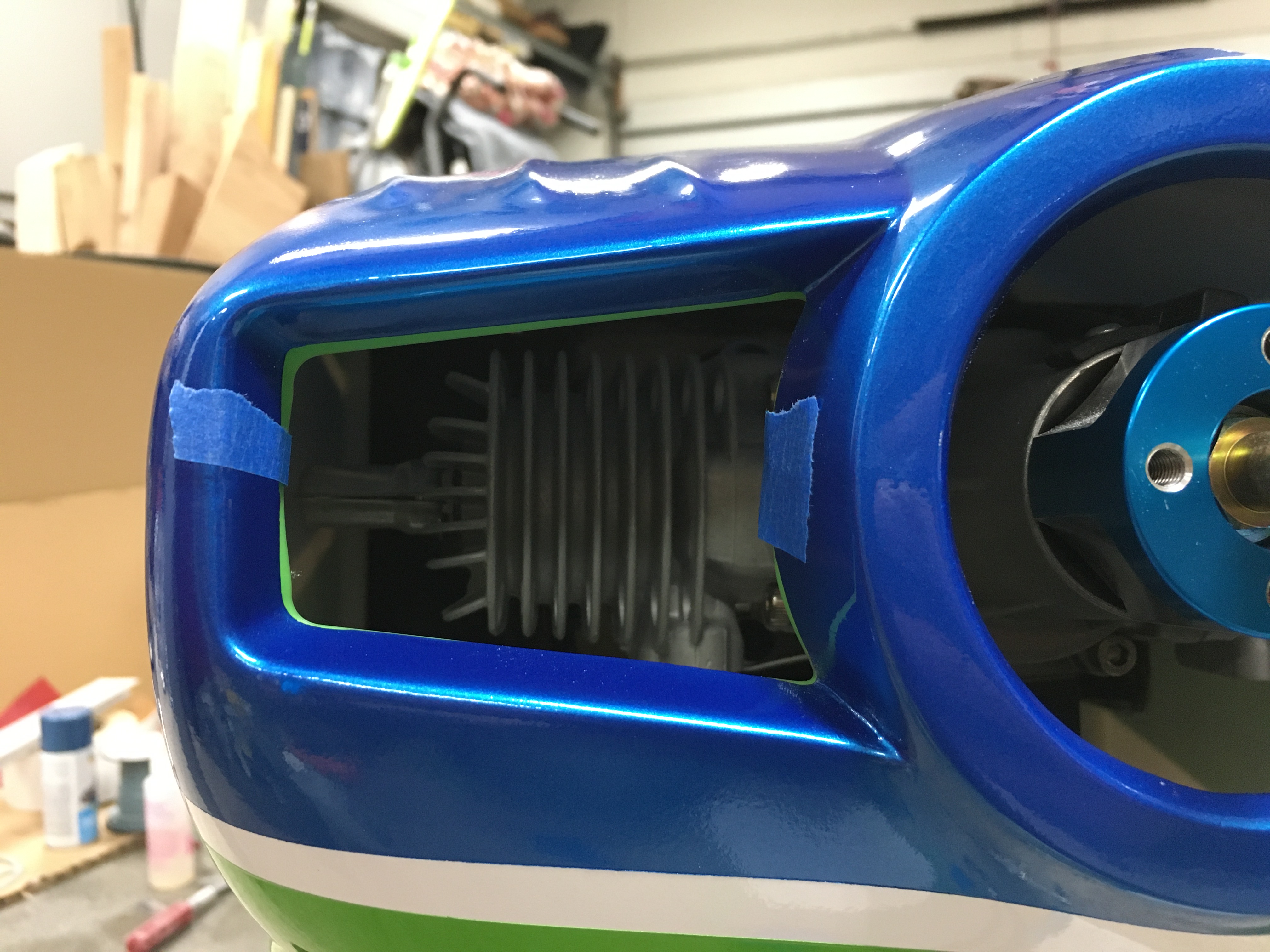

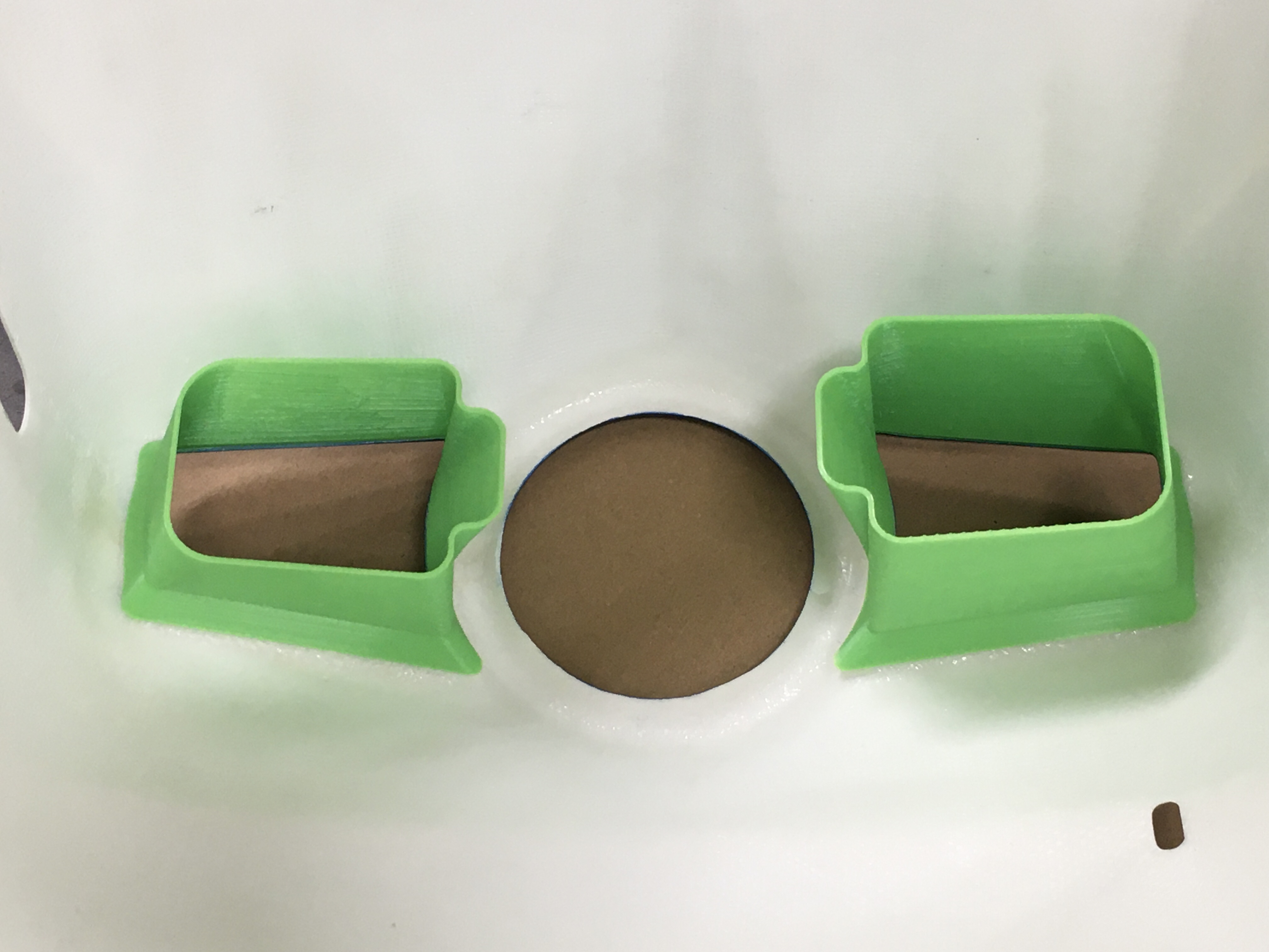

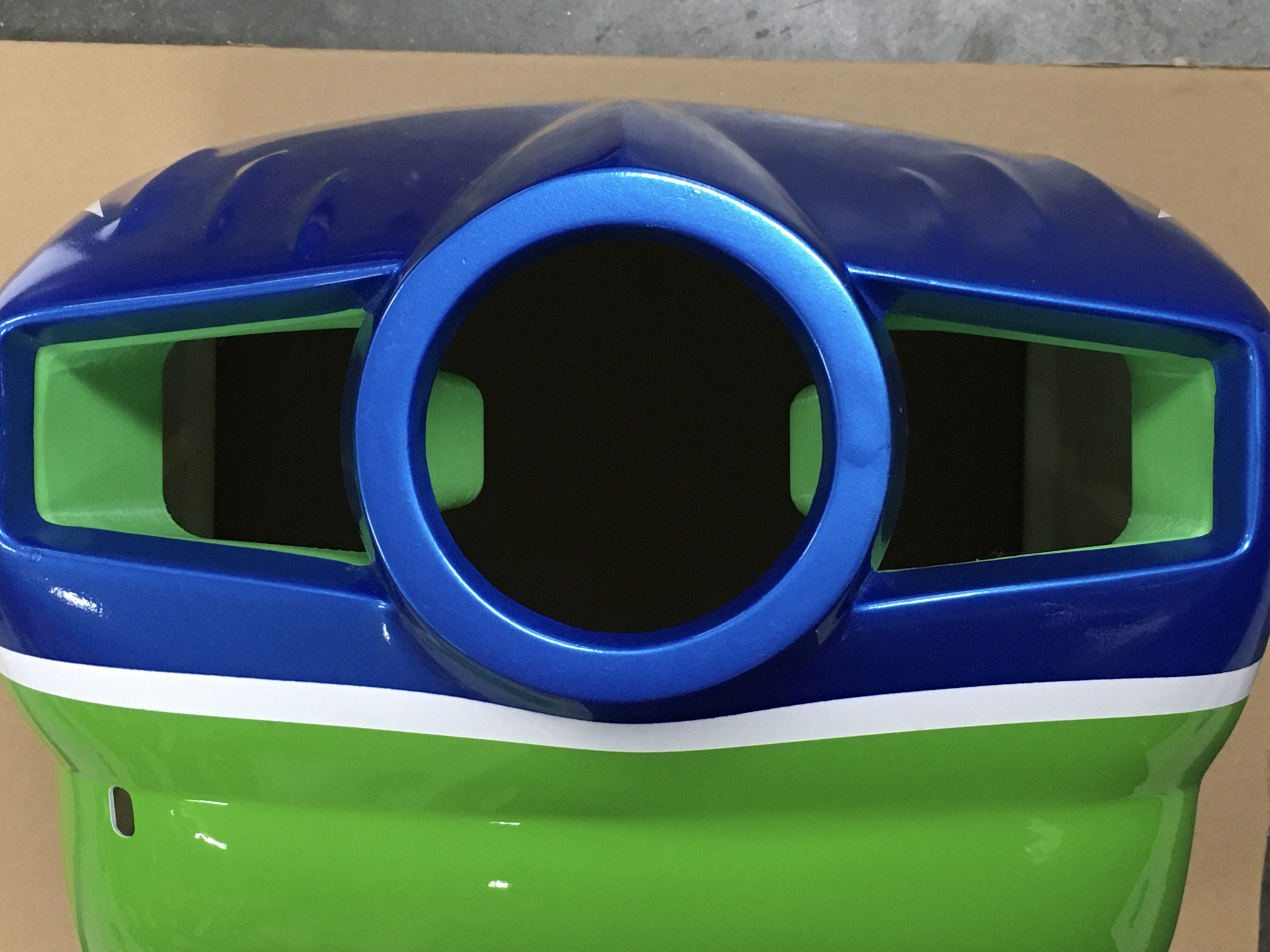

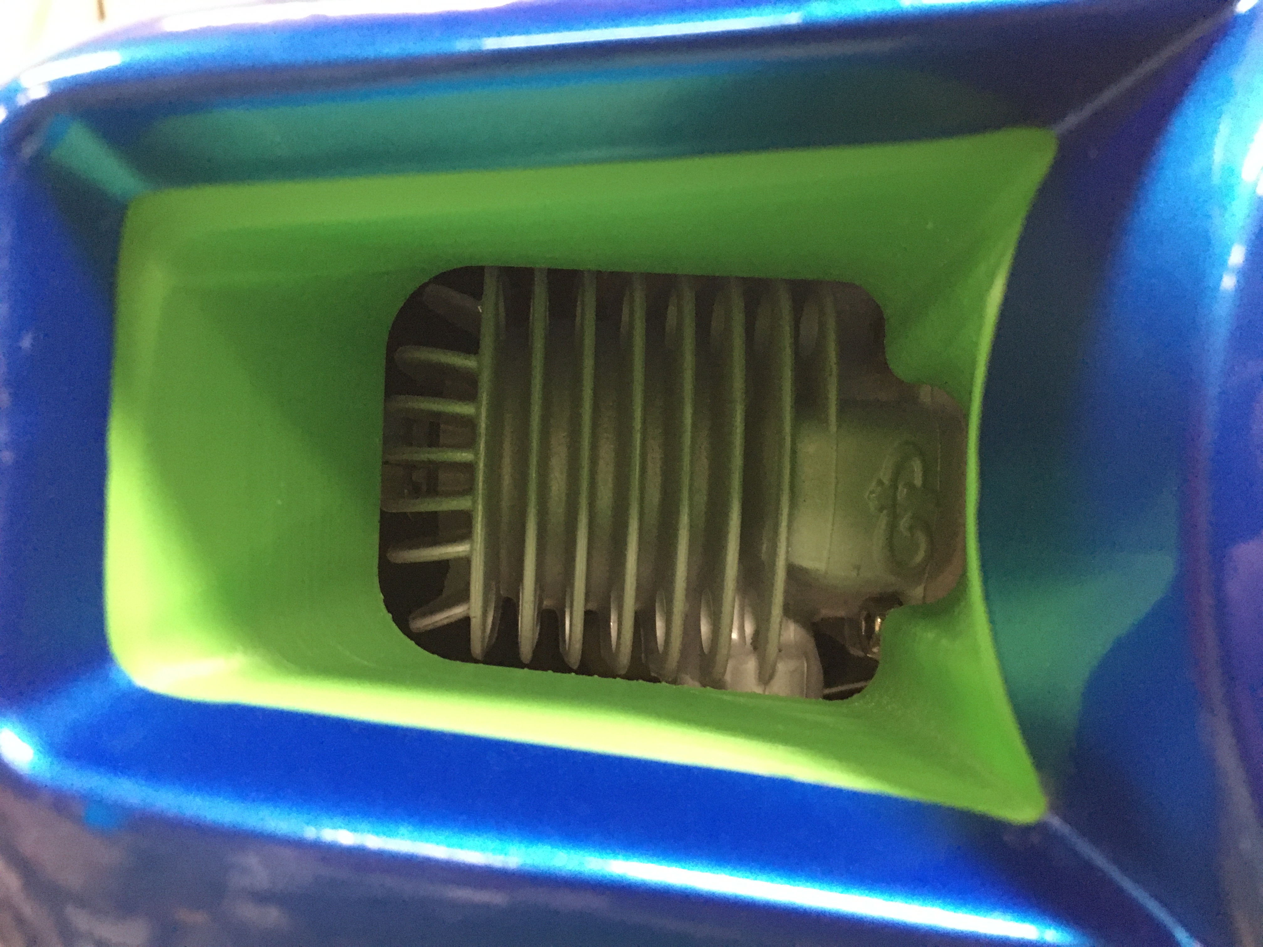

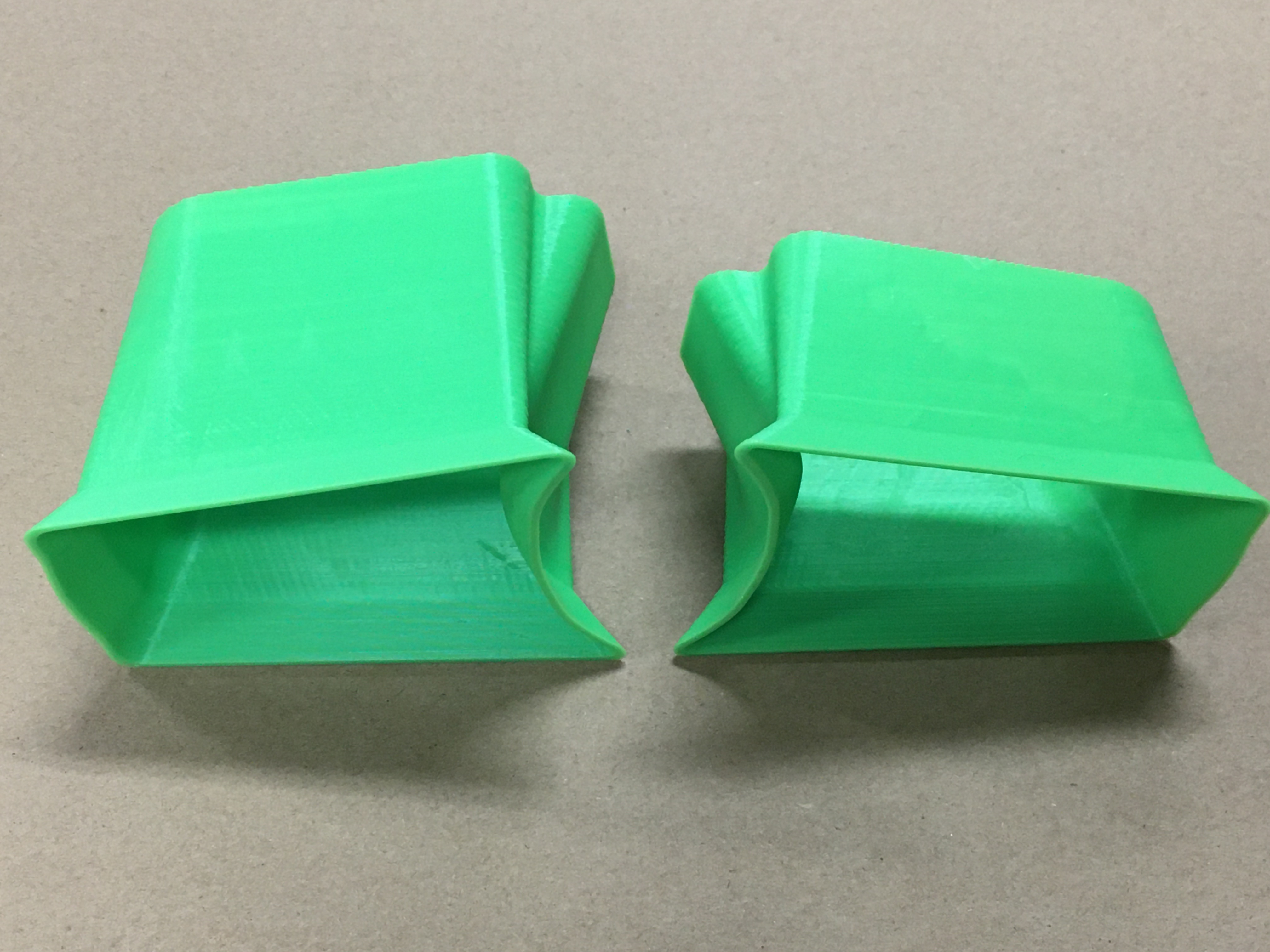

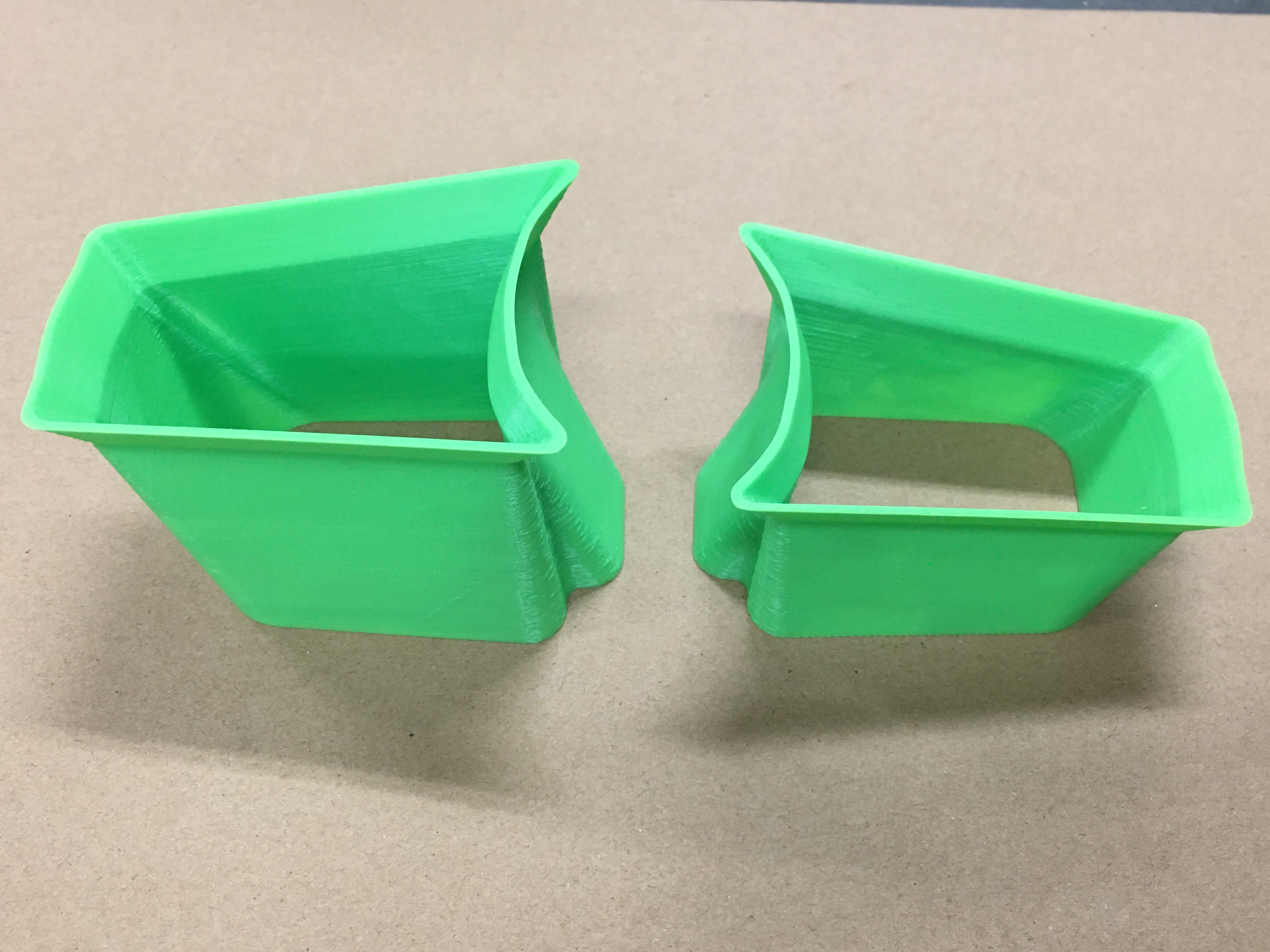

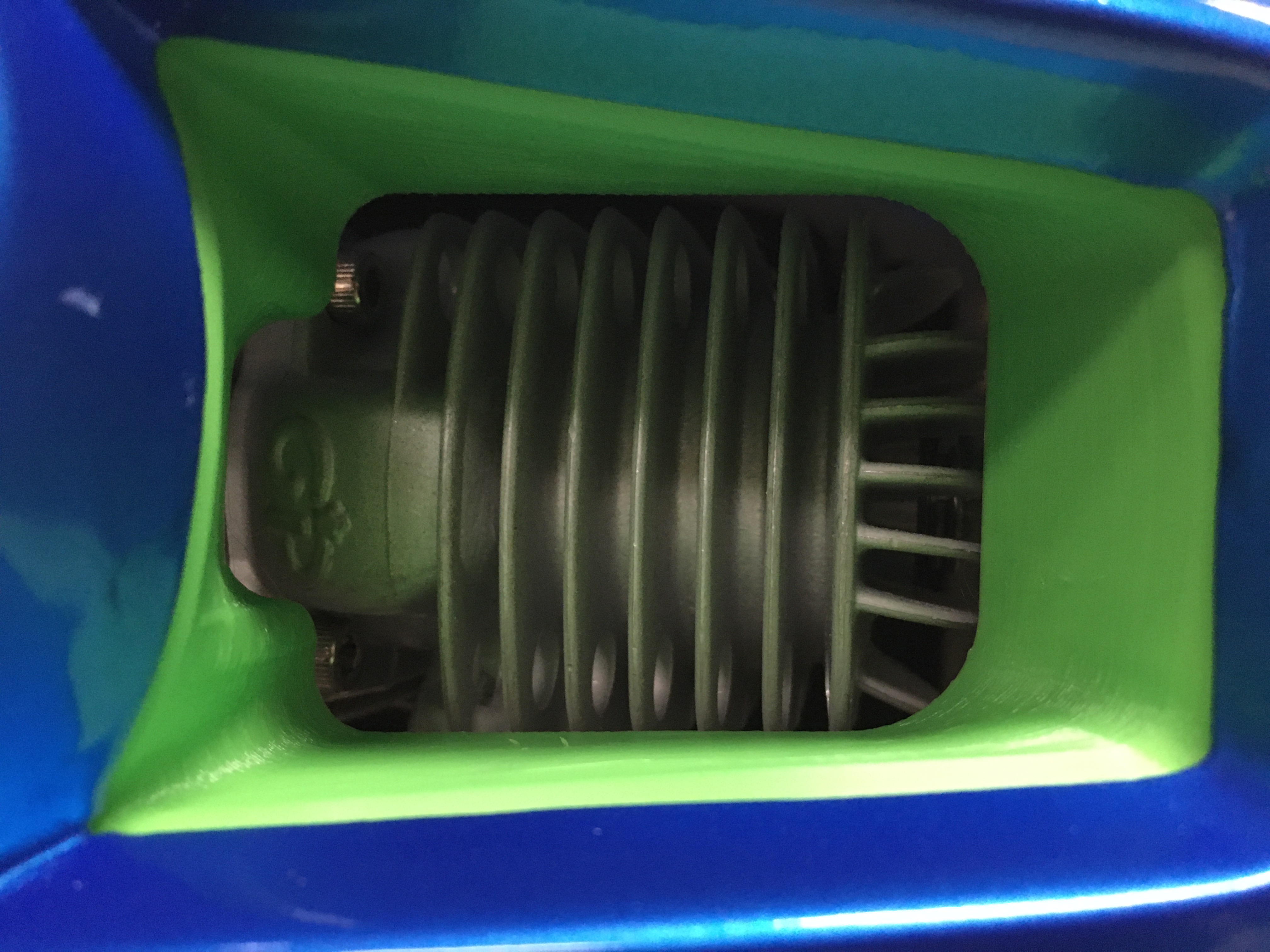

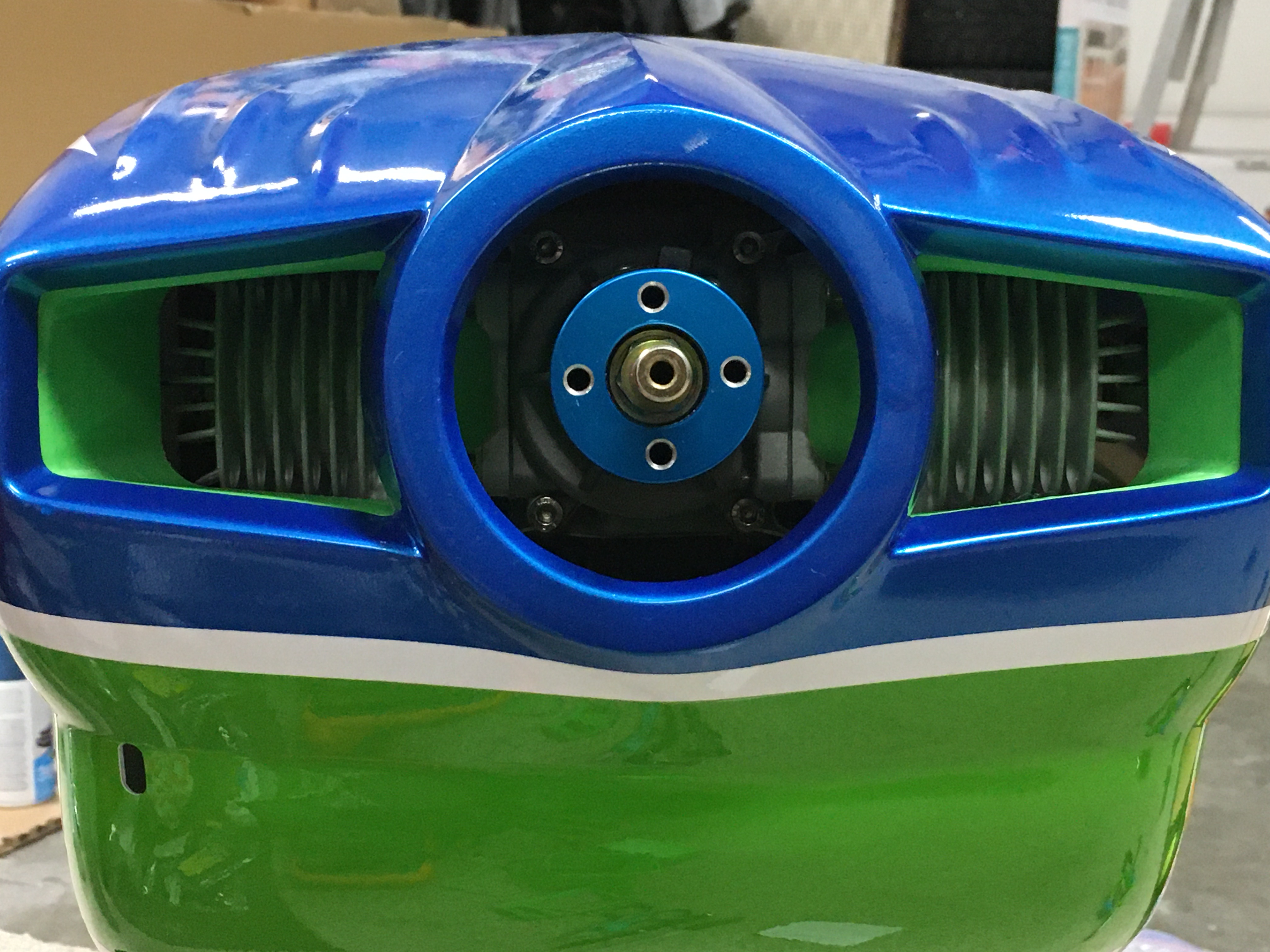

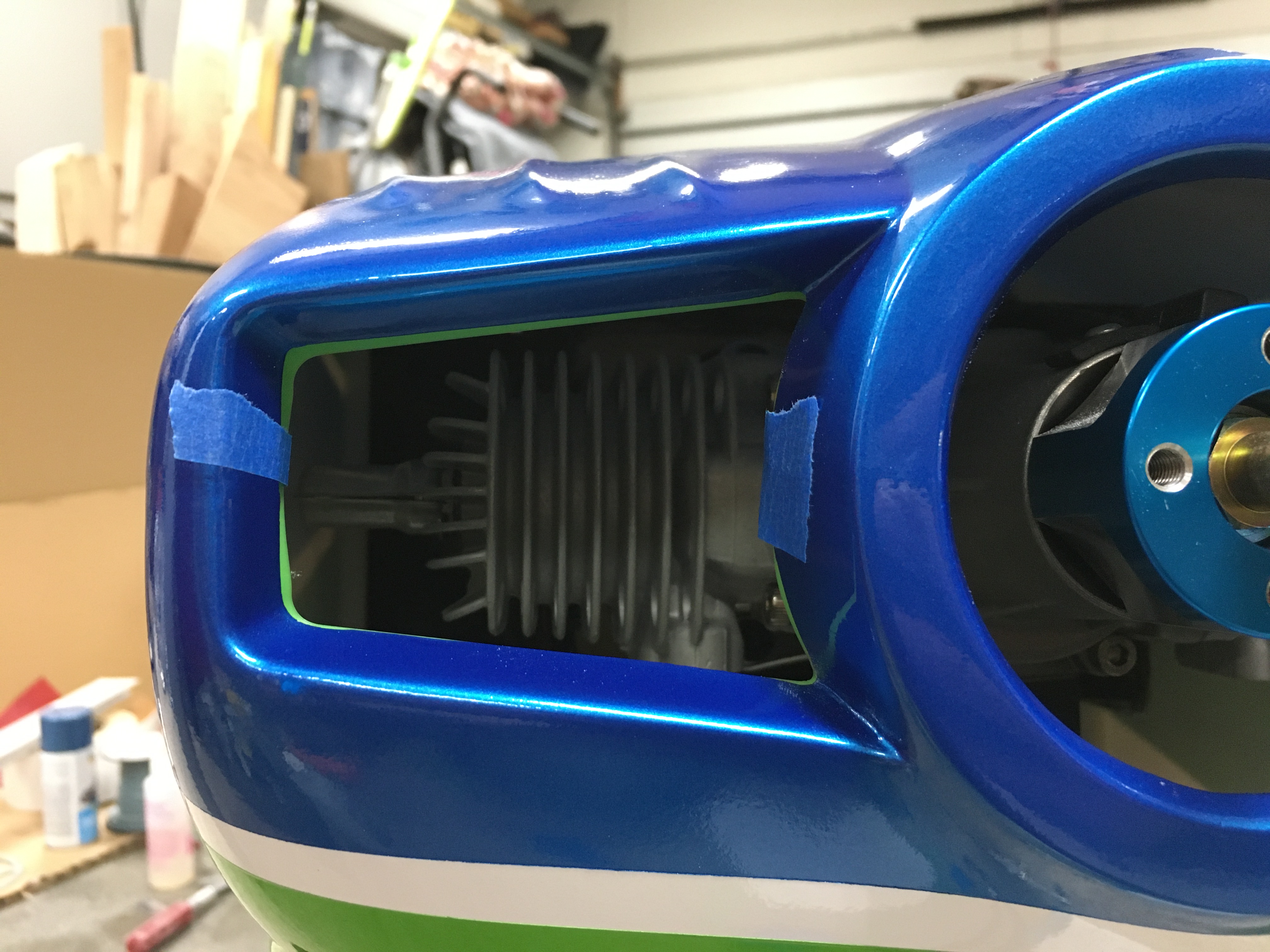

Oh boy! Eight hours of printing and I have a set of baffles custom designed by me that weigh 1.5oz combined. After a few trials I was able to create something that may actually work. I am a little concerned about the PLA plastic getting too close to the cooling fins.
here is a bunch of photos:
View attachment 116314 View attachment 116315 View attachment 116316 View attachment 116317 View attachment 116318 View attachment 116319 View attachment 116320 View attachment 116321 View attachment 116322 View attachment 116323
Nice job brother. And it's color matching! Mikey like.
They look prefect! Should be a cool running motor now. Do you have telemetry to see how much difference they make?
